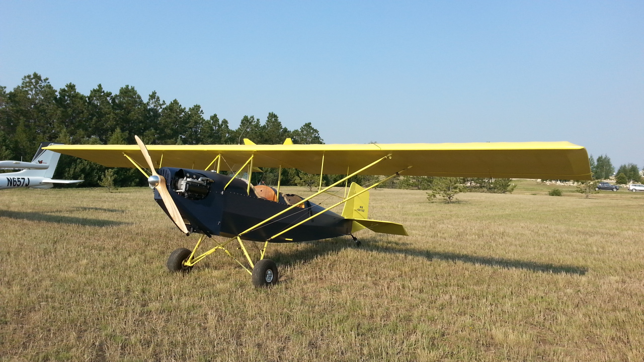

The Corvair is a great choice for the Piet Robert. Have a little over a hundred hours on my Piet/Corvair with zero problems. I used most of William Wynne's Corvair conversion parts and Dan Weisman's 5th bearing. And the 6 cylinder sound is much nicer than any 4 cyl Lyc/Cont. Check out these sites, sign up for the next Corvair College (I attended 3), and come to the Brodhead Pietenpol gathering the week before Oshkosh, you will love it. And yes they sell the manual and parts to rebuild it yourself or complete engines.

Nice looking Piet. I ordered the builders manual for the Piet and it should be here today or tomorrow. Can't wait to read it. I really hope to make it to Brodhead this year. Looks like it would be a great get together.
