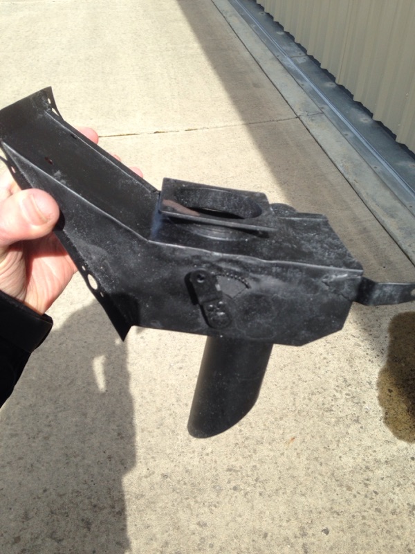

Ron; I have the heat box but need to hold it up to a Stromberg carb to make sure it's the right one. This one has the intake air 'dump tube' that sticks out the bottom to dump excess intake air when carb heat is applied. It works fine but is not new and has had some dents straightened out on it in the past. It's part number 05-01387 in the Aircraft Spruce catalog and it's designed for the Air-Maze 600314 air filter (Aircraft Spruce part number 08-01542). Mine doesn't have the air filter or the quarter-turn filter fasteners installed, but you can get those and rivet them in or else just use machine screws with backup plates and locknuts to attach the filter and it'll just be a bit more work to remove and reinstall the filter after cleaning.
It's not ideal, but if you're trying to get the airplane back together and in the air, it functions fine. If you're looking for a clean and well-detailed restoration, you should probably look elsewhere.

Ron; I would be happy to donate the carb heat box to the cause, just maybe $10 for me to box it up and send it out. Give me your info and I'll send it out to you. Note also that you can remove the tube that sticks out the bottom and just let it dump into the cowling if you don't want to make a hole in the bottom of the cowling for the tube.

Oscar ; Thanks soo much for the heat box! It will work perfect. Ordering an Air Maze filter and all will be good. Thanks again friend. Ron Turner
