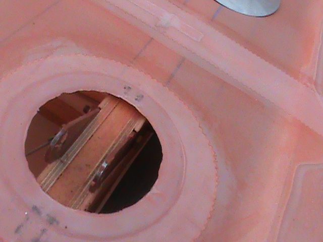

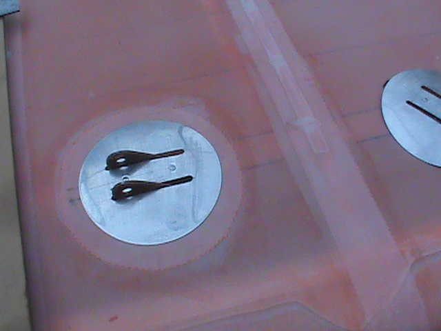

Post by Pappy »
First off use a clevis on all your cables, guys short cut on the bay cross cables in the wings and the thimbles stretch or flatten out and the cables loosen up. I put an inspection hole on each out board strut connection to check the bolts on the spars, little tricky but worth it. and my new piet has better inspection ports on the pulleys see pics
