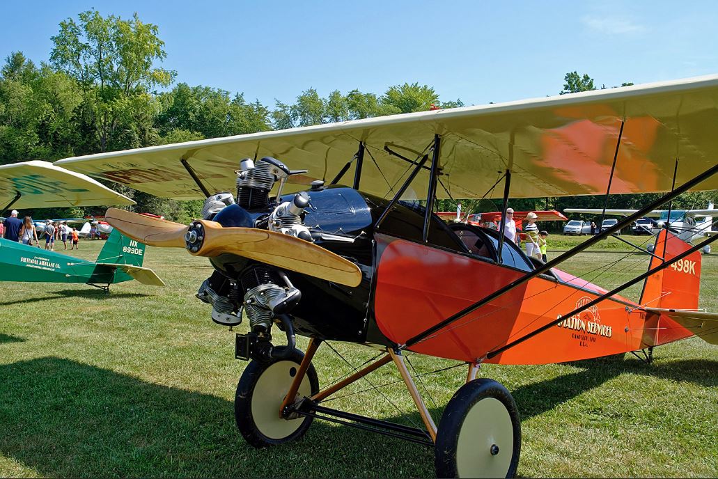

Steve Mather captured 498K in this photo that was taken at the Wings 'n' Wheels event in Warren Ohio in 2015. 5-cylinder 90 HP Lambert radial. Absolutely gorgeous aircraft/engine combination and the cabanes appear to be vertical or nearly so, which would indicate that the weight & balance with this combination worked out well.

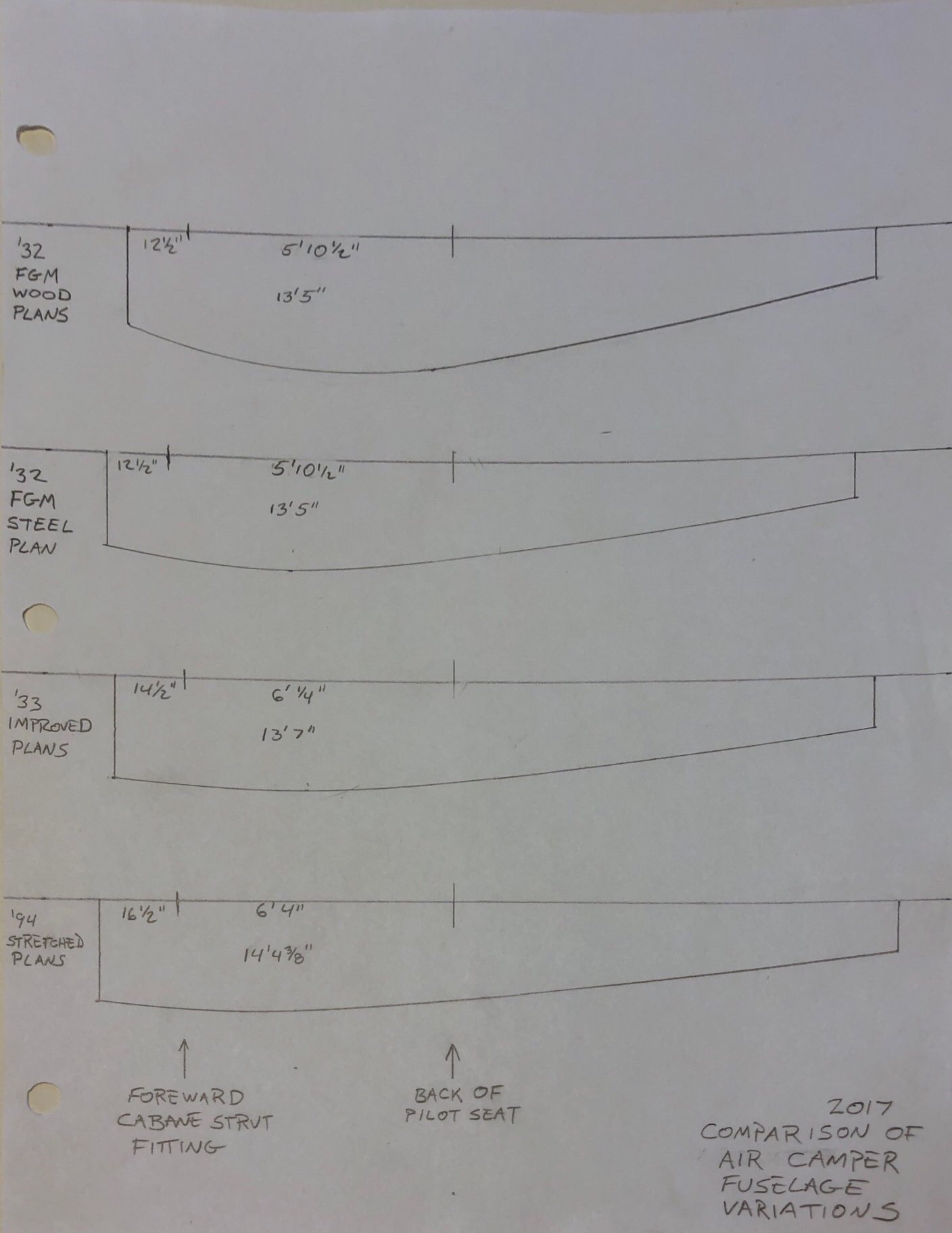

a while ago I drew up this comparison of fuselages. Might be of interest.

I’ve just now noticed a mistake. The measurement from the firewall to to seat back on the steel fuselage should be 6’2-1/2”. Just goes to show that you should question everything you see on the internet!
