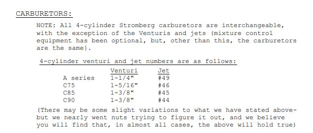

Paul; if you're going to open up the carb, that would be a good time to look at the main jet. Take a look at the comparison table below that shows the jet sizes for the different engine displacements. The A65 takes a #49 jet (the number should correspond to the same numbered drill size, 0.0730") and if your carb was ever run on a different engine, it could be any one of the other jet sizes in that bunch. The #45 is 0.0820", or 9 thousandths larger orifice than the one that should be in a Stromberg on an A65. Also, don't take it for granted that just because your jet is stamped as a #49, that it actually is, because many, many people and shops have drilled them out either so that they can run on a different, larger engine or "just because" they think it'll buy them more power. If you don't have numbered drills in that range, go to a machine shop or find someone with numbered drills and check the orifice size. If your jet is good, that will be an easy "no, that's not it" possibility you can eliminate. And if you do have a larger jet and need the smaller one, I just looked at Aircraft Spruce and they are listed as $12.50 for the one for the A65... very reasonable.

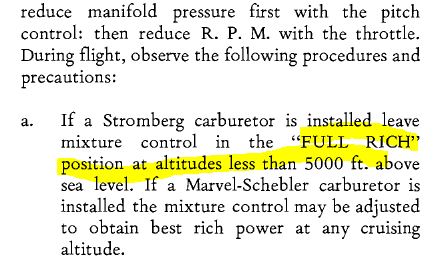

As stated, the Stromberg carb is typically wired in the full rich position, and according to a few old timers, that’s because the Aircraft Sales guys never thought anyone would fly above 5000 ft, and that leaning wouldn’t provide a tangible benefit. While the attached article was written for the C120/140 group, the same applies to all of the A series engines using the Stromberg carb. As the article attached explains, the sales guys were wrong.
