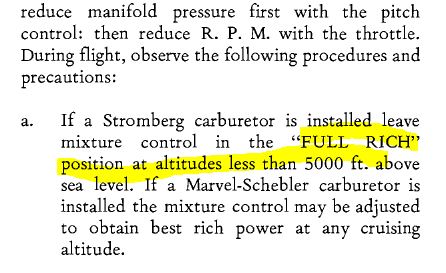

Paul; I'm assuming that your Stromberg doesn't have a functioning mixture control? The NA-S3A1 carb was designed with a mixture control; the -S3B was blanked off. Some of them have the mixture control 'guts' removed and a blank-off plate over the place where the mechanism goes, while others simply have the lever wired at full rich. If yours has the guts still in place, you can work with it to improve your mixture at your altitude. If you'd like to discuss it off-list, email me at taildrags@hotmail.com , but there are resources out there for mixture adjustment on Strombergs. If you read the ops manual for airplanes that were certified with the control (Cessna 120/140-?), the book will say not to adjust the mixture on them below 5000', but there is no logical reason to that. Hearsay has it that people have killed the engine trying to adjust the mixture while close to the ground, but that's no excuse in my opinion. If you know how the control works and you use it correctly, it's there to be used.

As stated, the Stromberg carb is typically wired in the full rich position, and according to a few old timers, that’s because the Aircraft Sales guys never thought anyone would fly above 5000 ft, and that leaning wouldn’t provide a tangible benefit. While the attached article was written for the C120/140 group, the same applies to all of the A series engines using the Stromberg carb. As the article attached explains, the sales guys were wrong.
