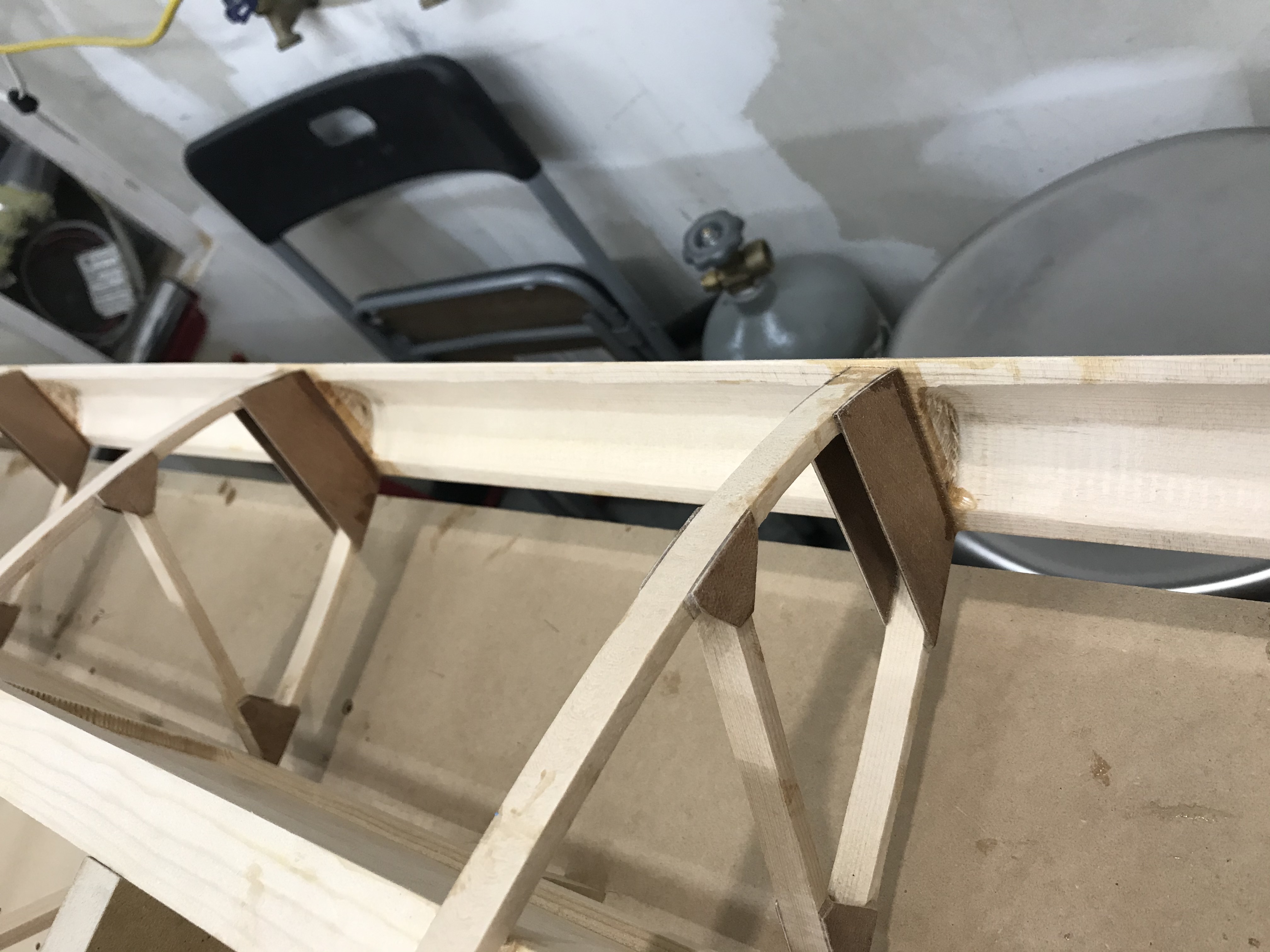

Also I see there has been some discussion about reducing the rib width from 1/2" to 3/8" (still wider than even the Pitts uses which much heavier wing loading) but has anyone ever actually done that. One thing I don't see in the Piet wing is the number of compression members that are seen in other designs. The Piet seems to have fewer so maybe the much heavier than typical ribs are handling this compression load.

I concur that there are some things that can be changed or sacrificed to bring down the weight. Example: my Air Camper has 6.00x6 Cleveland wheels with hydraulic brakes and corresponding tires and one could easily build with 5" Azusa wheels and smaller tires and no brakes and save some weight right there. Good point.
As far as the wing ribs and spars on a Pitts vs. an Air Camper, be very careful when comparing the loading on a 1625 lb gross weight biplane with a 20 ft wingspan and interplane struts to that of a 1080 lb gross weight strut-braced high-wing monoplane with a 29 ft wingspan. There are a lot of variables involved.
Re: Actual Empty Weight of Pietenpol
Another thing to consider is that the Pitts employs the NACA M6 airfoil and has a 36" chord. The M6 is a 12% airfoil so that makes the depth of the wing ribs about equal to that of the Piet airfoil (12% of 36" = 4.32" for the Pitts) but the Piet airfoil is about an 8% (4-3/4" deep spars and a 60" chord = 7.9%) so it's much flatter and the rib caps must resist bending over a longer span. As I say, there are a lot of different factors to consider if you want to start reducing the cross-section or aspect ratio of structural members.

Yes that's a good point that the rib is longer and thinner.

Most of your weight savings will come from engine/prop choice and using oratex. A couple weight saving ideas not discussed yet:
It's pretty common not to use nails on any of the gussets since they are just there to hold things in place while the glue sets up.
I routed out material from the wing leading edge. I suspect you could route out some material from the aileron spars too. You could also eliminate the front cockpit controls. Wing tanks are a little heavier than cockpit tanks for the same volume since they are shallow whereas the cockpit tanks are closer to a cube also they require shorter fuel lines.If you could find some way to make a rotational molded plastic tank that would probably be the lightest. I saw someone who eliminated some of the turnbuckles by tensioning the wire rope before crimping the sleeves.

ArtherD- where did you route out material on the leading edge?
This is a riblett airfoil so the leading edge is larger than the normal pietenpol airfoil.
- Posts: 368
Ken Perkins did the same thing to the leading edge of his wing. His has the Pietenpol airfoil.
