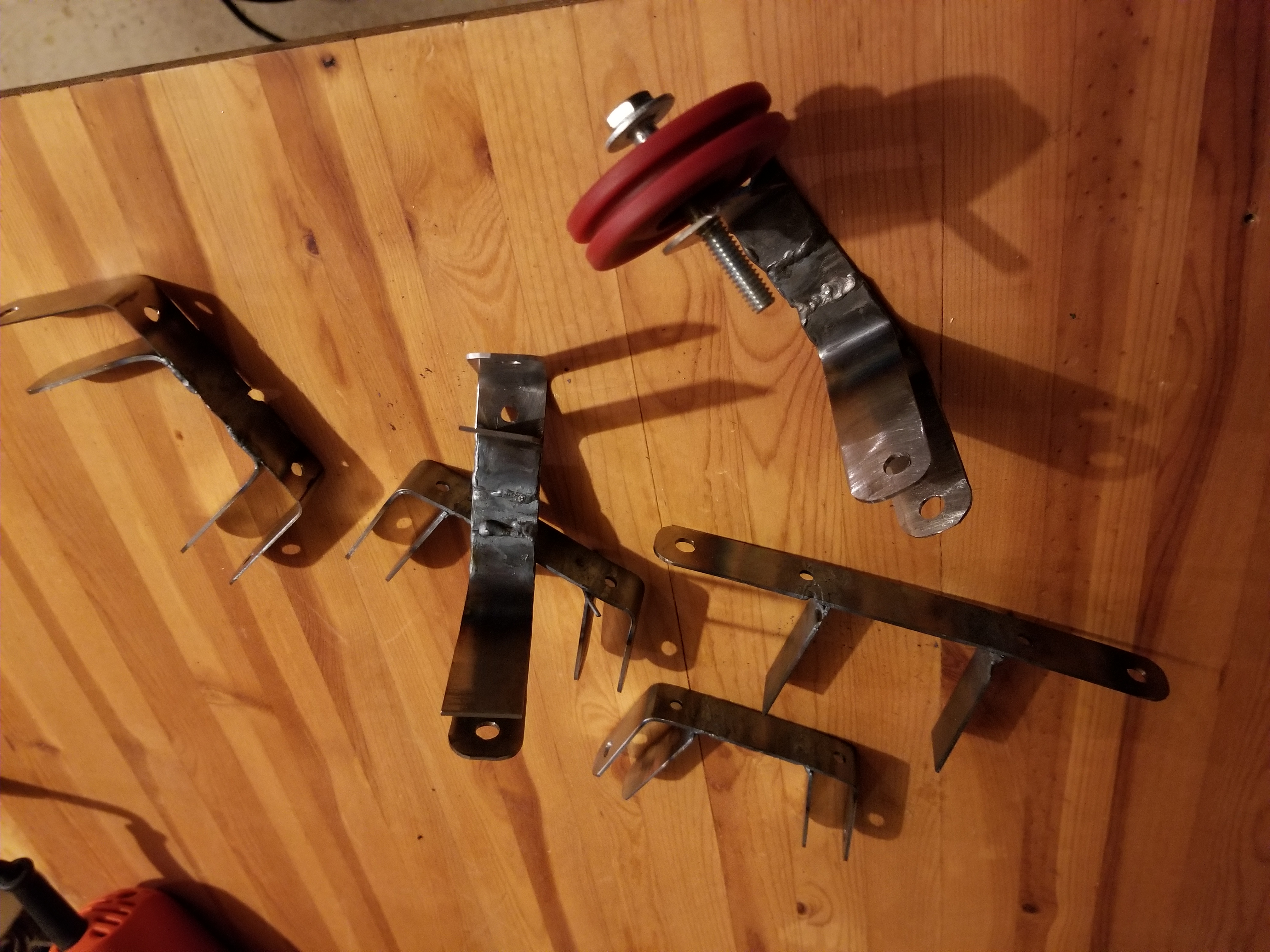

This is a horrible mess.... none of these are airplane parts. Just me trying to figure out how to make the part and work on my welding skills....
The best I got to is a backwards L that I flat weld in place.

I have two winners! the "L" version worked well and I am ready to powder coat the parts tomorrow.

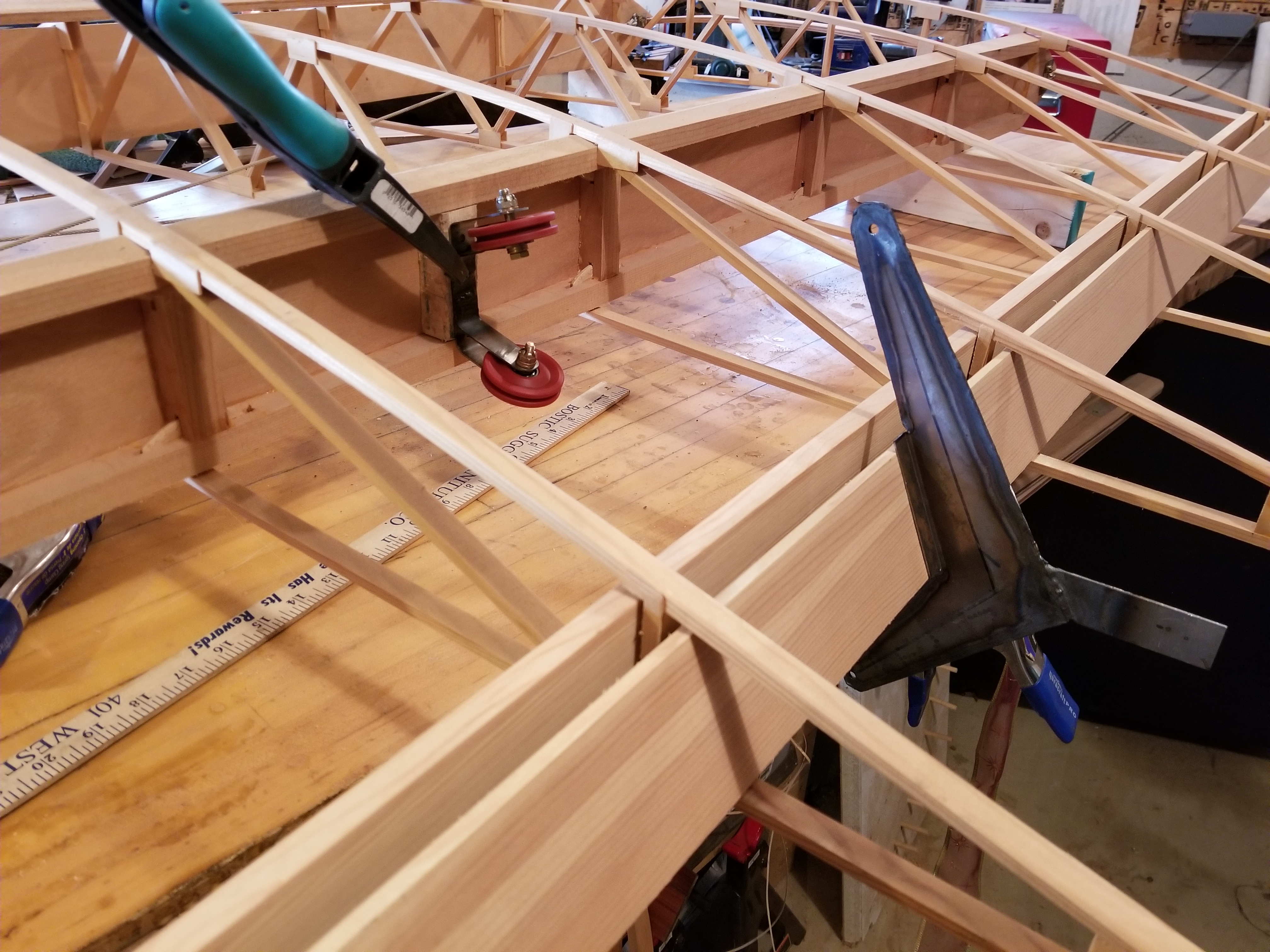

Here are some more photographs of how I make the bracket.
As usual It took me a days to figure out how I would finally make the part. now that i have made it I can make it in about 30 minutes.
However I still cannot make two identical parts. They are really similar, but hand made parts still have slight variances.
Peace

Made the two bends in the outer strap (verifying equal angles with an angle gauge), then drilled the 3/16" holes for the AN3 bolts, these holes were angled and reamed slightly to allow the bolts to be inserted at a slight angle from perpendicular (and then rotated to perpendicular for mounting to the spar). The two hoIes for the pulley bolt were then drilled at each end based on the pulley radius (measured with the AN3 bolt inserted, you don't want the edge of the pulley dragging on the bolt head after all this work). Cut a small piece of wood to be clamped between the outer strap and the inner strap to be welded, welded with a tig welder. Then match drilled the hole for the pulley bolt into the end of the inner strap perpendicular to the outer strap on a drill press.
