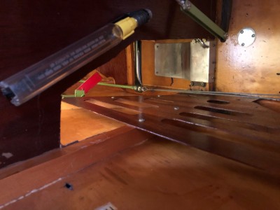

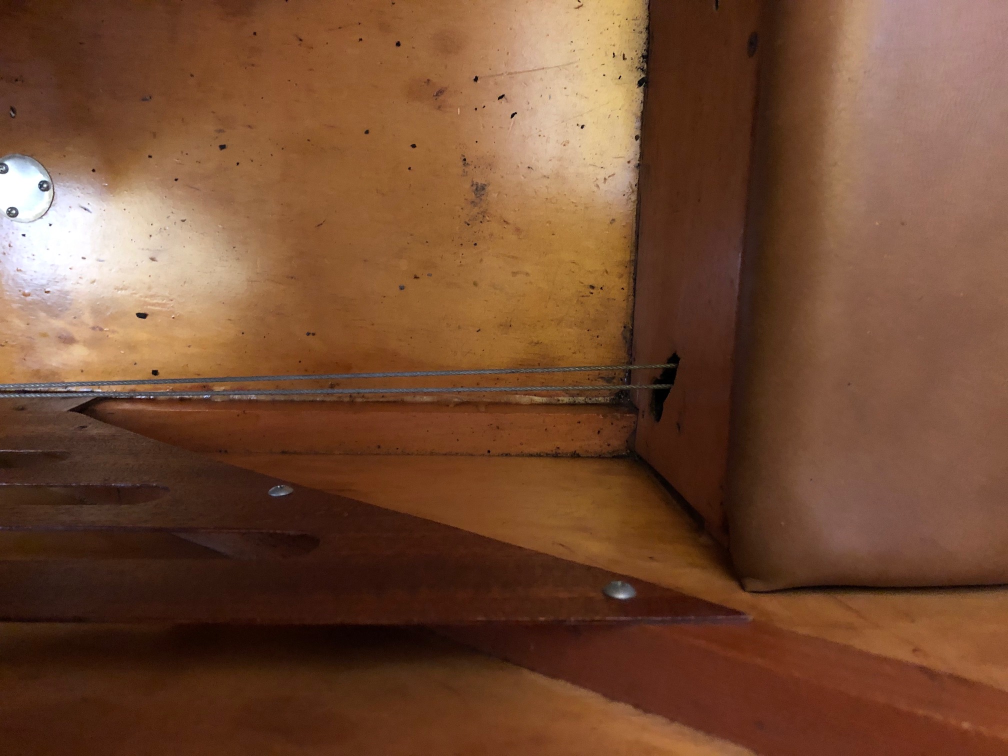

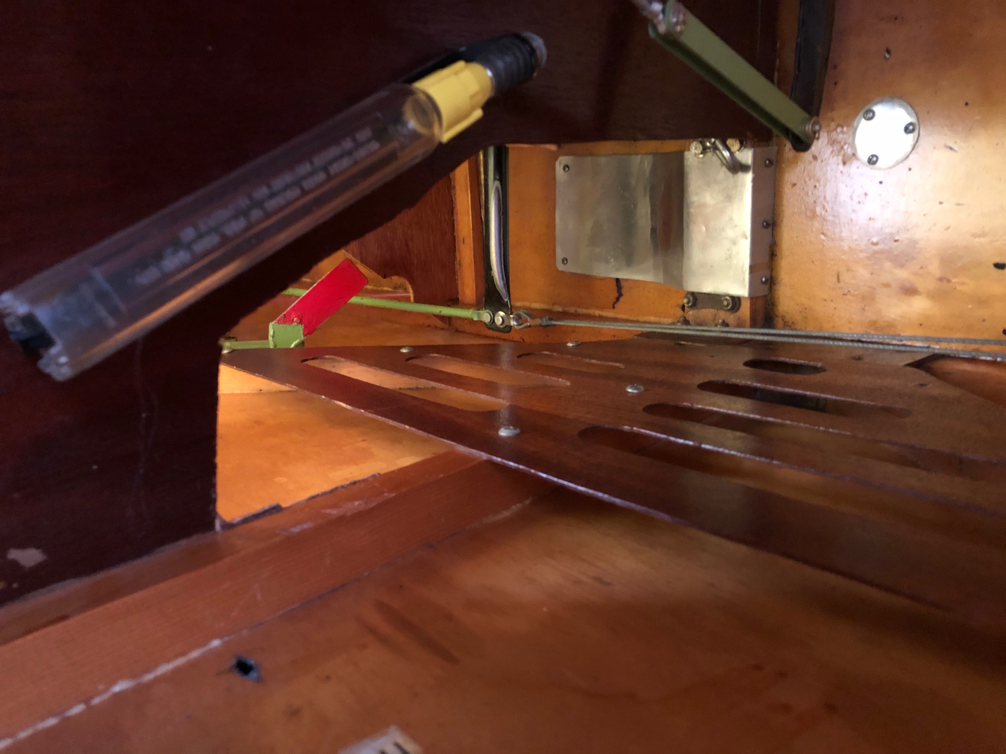

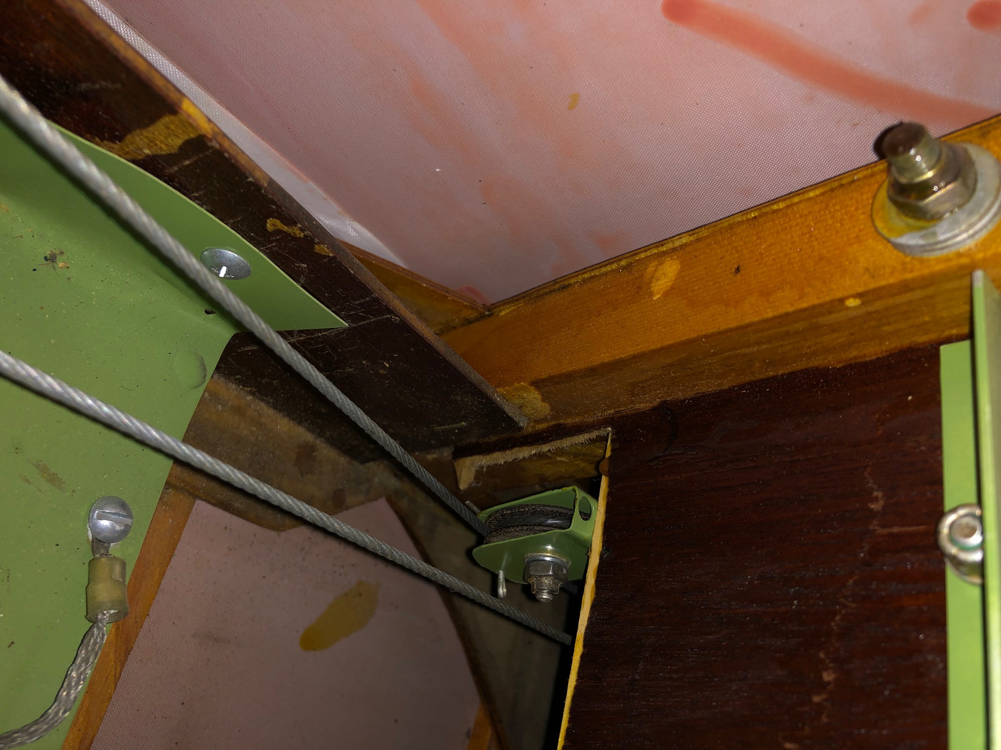

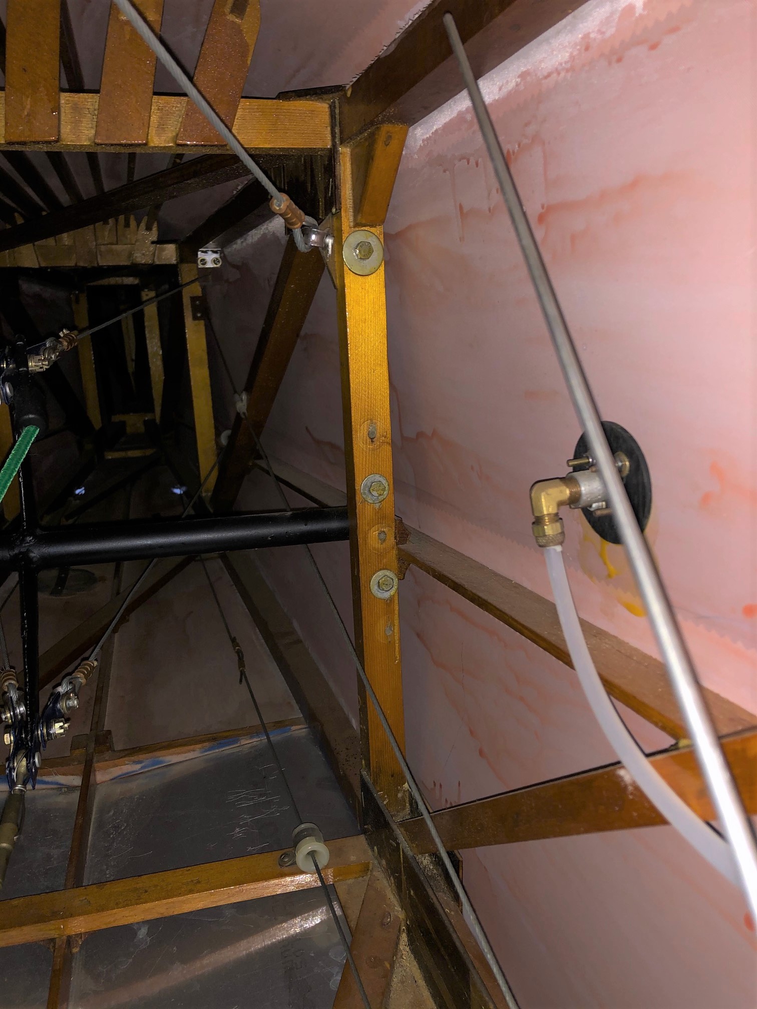

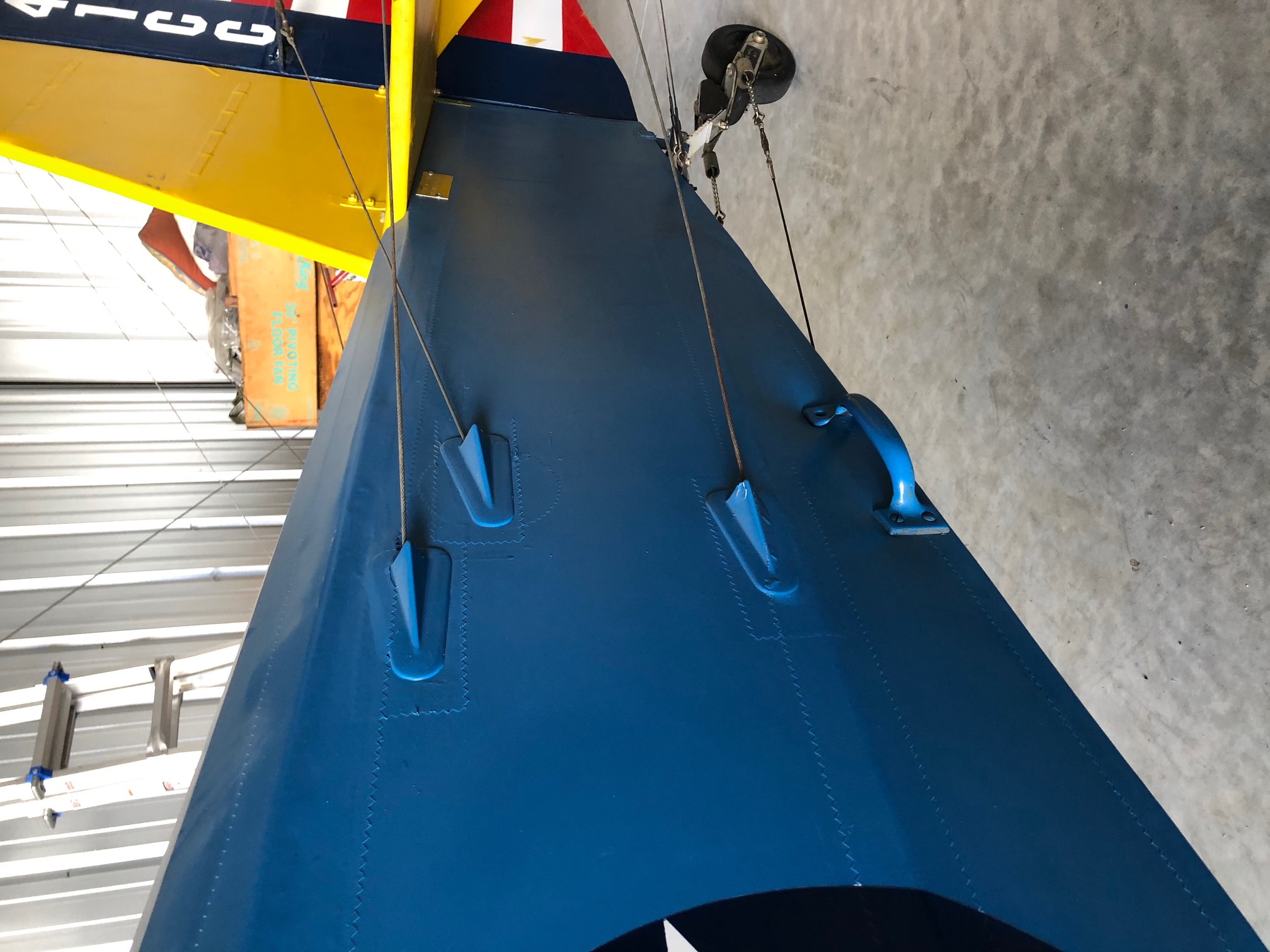

Here's how the rudder cables are routed on 41CC. Series of five pix below. I'm not sure why or how the server manipulates the pictures, but despite my best efforts, some of them get rotated a different way than I want them to. Sorry about that.
First shot is looking at the left rudder bar, where two cables come off the end of it. One goes to the rudder, the other goes to the tailwheel horn. The red thing in the picture is the toe brake pedal on that side, and of course on the right side is a fuel sampler in a spring clip on the backside of the passenger's seat.
Second shot shows the cables running aft and then disappearing under the pilot's seat. No, that's not coarse ground black pepper on the floor... it's crumbled insulation that fell off the wires of an old headset I was trying to make work but couldn't. I'm a hopeless collector of old stuff.
Third shot shows where the cables emerge from under the aft edge of the pilot's seat. There is a direction-changing pulley for the rudder cable since it has to start upwards after passing under the seat, while the tailwheel steering cable doesn't need a pulley and continues aft. Grounding cable is from the VHF COM antenna that is mounted to the metal ground plane (green color) behind the pilot's seat along with the ELT whip antenna sharing the same ground plane.
Fourth shot shows the two cables headed back into the tailcone. The rudder cable passes through a nylon fairlead on the diagonal member because the cable has to be offset a bit to miss the elevator bellcrank walking beam. Then right before it exits the side of the tail, there is a Micarta fairlead that steers the cable to the outside of the fabric to clear the wood upright. The tailwheel steering cable also passes through a fairlead on the floor crossmember before heading out the bottom of the tailcone where a small patch of light is visible.
Last shot shows where the rudder cable exits the tailcone on its way to the rudder bellcrank, clearing the leading edge of the horizontal stabilizer.
