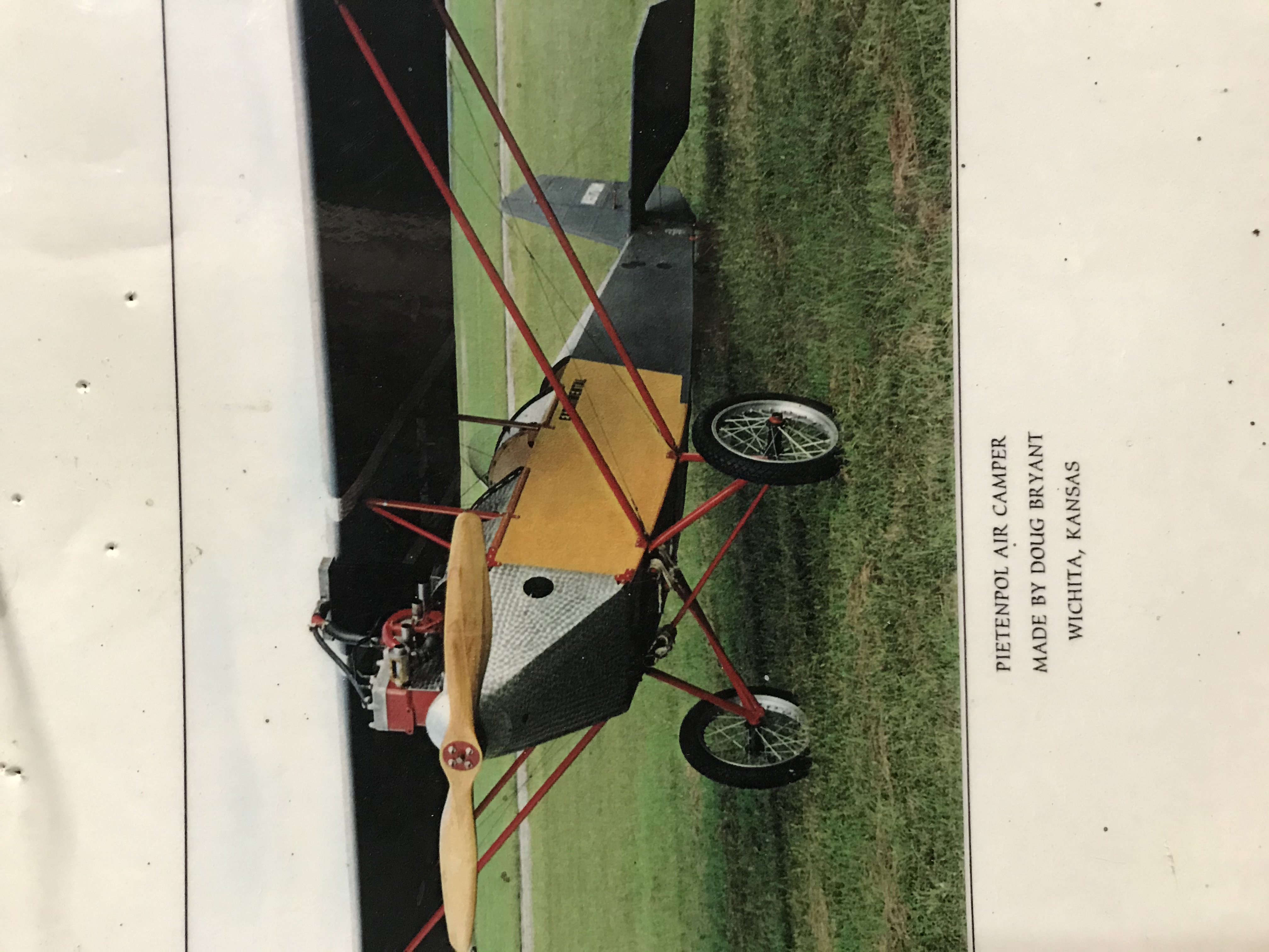

Richard: I don't know if all Grega GN-1s are setup like this, but Ernie Moreno's is. See pic.

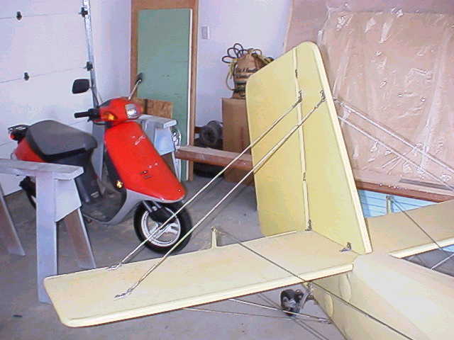

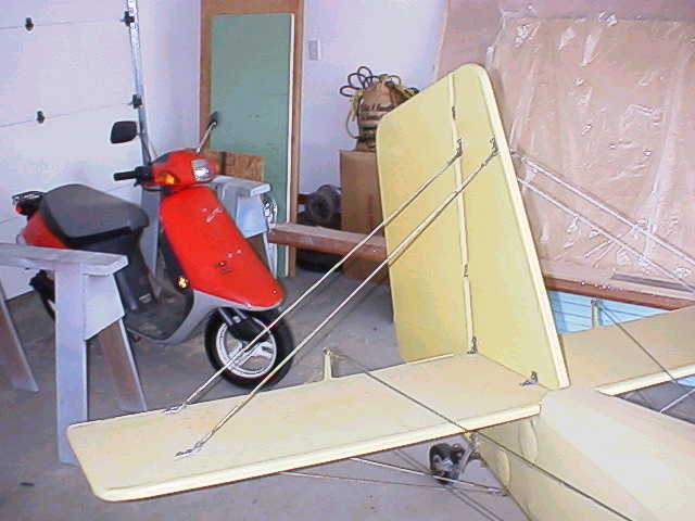

Andy; your pilot should consider himself lucky to still be around. That thing could have flown apart at any moment, especially if there had been bumpy air. As far as a fix, I would say that 90+ years of experience of Air Campers flying safely and successfully without structural failures of that sort would point to nothing more than a simple repair & reinstall, or replace with a new VS, and go fly again. It may be that a glue joint or three broke loose and that's what precipitated the fluttering... not the other way around.
I repaired my VS after it broke in a nose-over incident. It's flying without any problems such as your video shows. Some pix of my repairs here- http://flysquirrel.net/piets/repairs/repairs.html , about the middle of that page. Fun and educational, not at all difficult.

Re: Vertical Stabilizer flutter
Andy,
Does anyone in your chapter have a set of plans? On page 7 of mine, the wires from the Vertical Stab to the Horizontal have a common point at the Vertical, one going towards the leading edge, one going to the hinge edge of the Horizontal.
Your plane, in contrast, has two unique wires, one towards the front of the Vertical and the other towards the rear. While I don't know what the exact effect of this may have had on the life of your Vertical Stab, there could have been a destructive vibration that was caused by the two sets of wires.
Please chime in if y'all have seen other Piets with this same split wire setup, as I've only looked at around 30 or so Piets, and I can't recall seeing the wires split on any other aircraft.
Hi Tom Kreiner
Yes we have a set of plans. We bought a wood kit and plan to remake the stab to the plans. We'll see how it goes.
Your probably talking about the picture of the yellow Piet.
Take a look at the video above. Our Piet is blue. The wires are per the plans.
Be safe
Andy
Be safe
Andy
