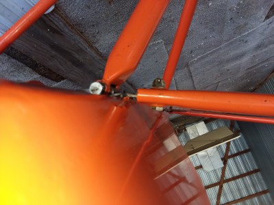

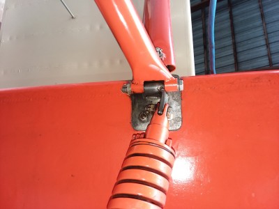

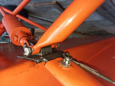

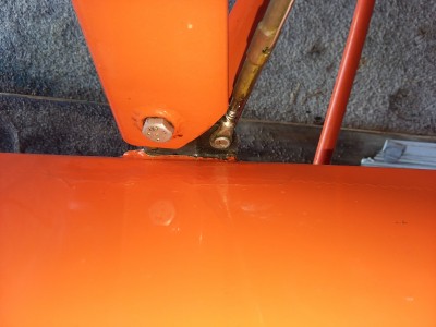

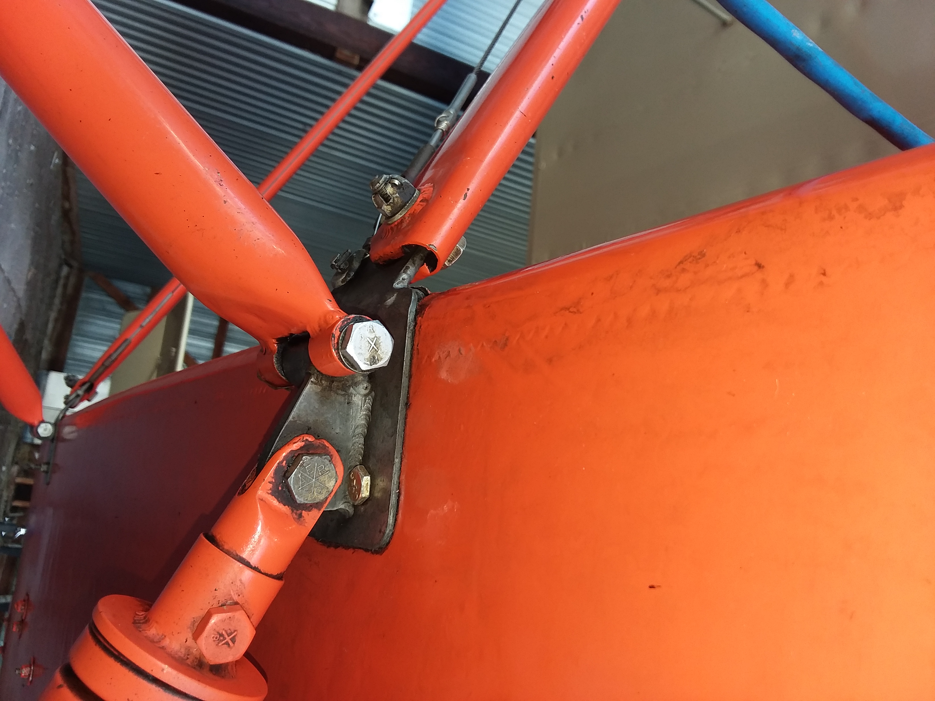

- Posts: 338
Re: strut attach fitting angle
Phone photos. When clicked on they will be upright. This is the right side, forward strut attach point.
Nice pics. Looks like a faithful following of BP's plans. I'm welding my gear up using an idea of William Wynne and Earl Brown- definitely heavier, but stronger as well. A good set of pictures of Earl's gear can be found on the Pietvair forum- it's kind of quiet these days, but still lots of good stuff for when you pull the trigger on your build (the "vair" refers to Corvair engines.). John
