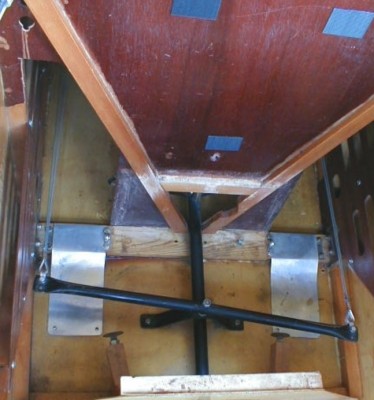

Just finished the controls and test fit in the fuselage and I notice when the control (stick) is all the way to the left, the tube that connects the two control sticks hits the cutout in the back of the front seat. I can't really cut out the opening any because it will cut into the wood bracing. Everything is being made to the plans (long fuselage) and the dimensions are correct. The stick movement to the right is considerably more as the tube is not on that side. Am I to assume that the left throw (distance) is enough as is? If not, any suggestions on a fix?
Re: control stick travel
JimBob; this has come up before and is not a new issue. My airplane has a half-round notch taken out of the side you're referring to, and I think others have done that as well. See pic.

I moved the connecting rod to the right side of the sticks. My hand hits my knee before the rod hits the seat back.

Jimbob;I crossed the for from front to back. Put the front on the right and the back on left. No notch needed.

Jimbob;I crossed the rod from front to back. Put the front on the right and the back on left. No notch needed.

I looked at 34KP. It looks like Ken built it to the plans in reference to the seat cutout. I set in it and the stick hits my legs before it hits the cutout. There is no sign of the tube hitting the cutout.

In a series of emails with Oscar sometime ago together we determined that indeed the stick is stopped by your knees prior to touching the stops.
In other words, the design does not permit for full aileron travel unless you’re not sitting in the aircraft!
If Anyone reading this has a different bellcrank that provides full aileron deflection when in the airplane, I’d be very interested in seeing how this was achieved.
