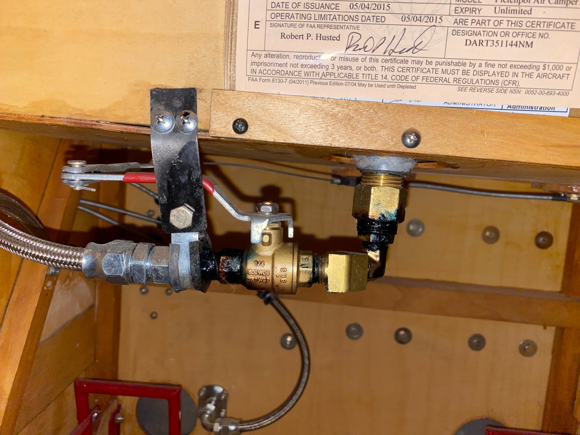

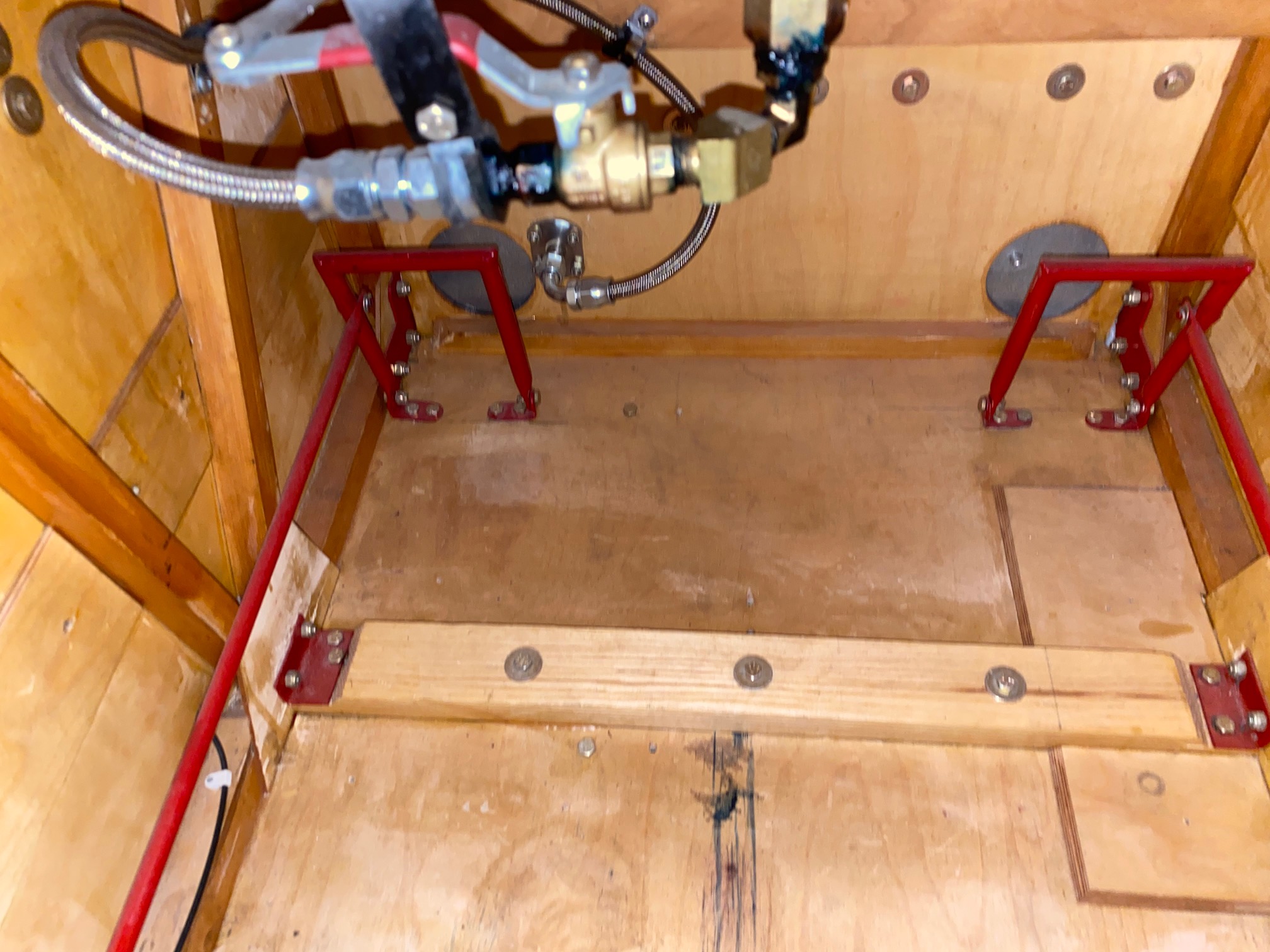

This is a pirep on fuel sealants. About 4 years ago, I had my fuel tank out and reinstalled it with EZ Turn Lubricant at each of the threaded joints. With winter temps, the Piet has been mostly sitting the past several months. As I began the condition inspection, I discovered slow weeping of 100LL at each of the threaded joints in the fuel system below the fuel tank. I've attached photos with the tell-tale blue dye at each joint.
After some sleuthing on the internet, I found mentions of this same problem. What I found is that, as the name suggests, EZ Turn is a lubricant. It is not a sealant. Loctite 565 or, if in a high temp environment, Loctite 567 is a preferred sealant to use (there are other products also mentioned).
It's kind of pain in the backside to dissemble all these bits, but I'll be doing that this weekend to get them good and clean to reinstall with Loctite 565. Hopefully that will work better for the future.

Thanks for this information. It appears that over several years, the 100LL slowly dissolved enough of the EZ Turn to allow it to weep its way along the threads. Were it not for the blue dye in 100LL, I doubt I would ever know it was leaking.
My source tells me that Loctite 565 should work just as well as 567 in the cool air of the front cockpit. Maybe I'll pick up a package of the 567 and use that instead.
