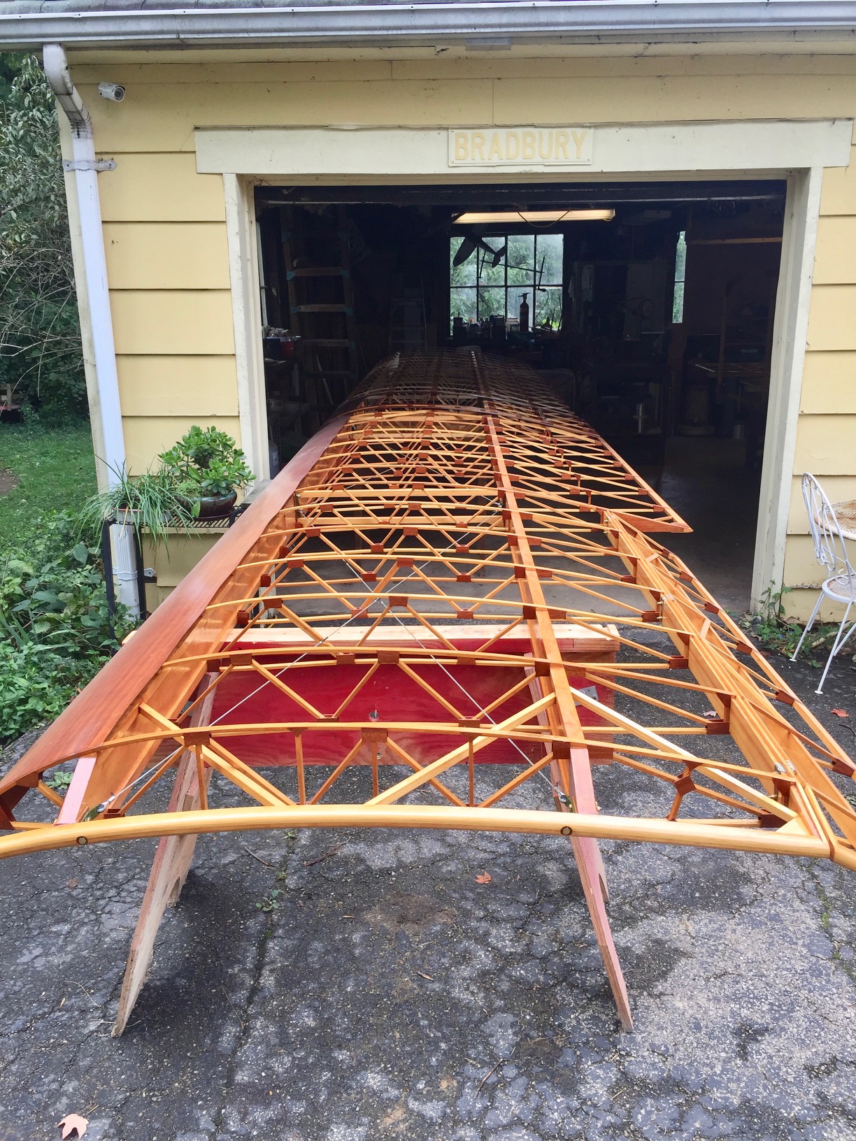

Re: status of current build
these are the hardest parts to make on the entire airplane; but got them done
These are beautiful builds. It's almost a shame that we have to cover them to make them fly.

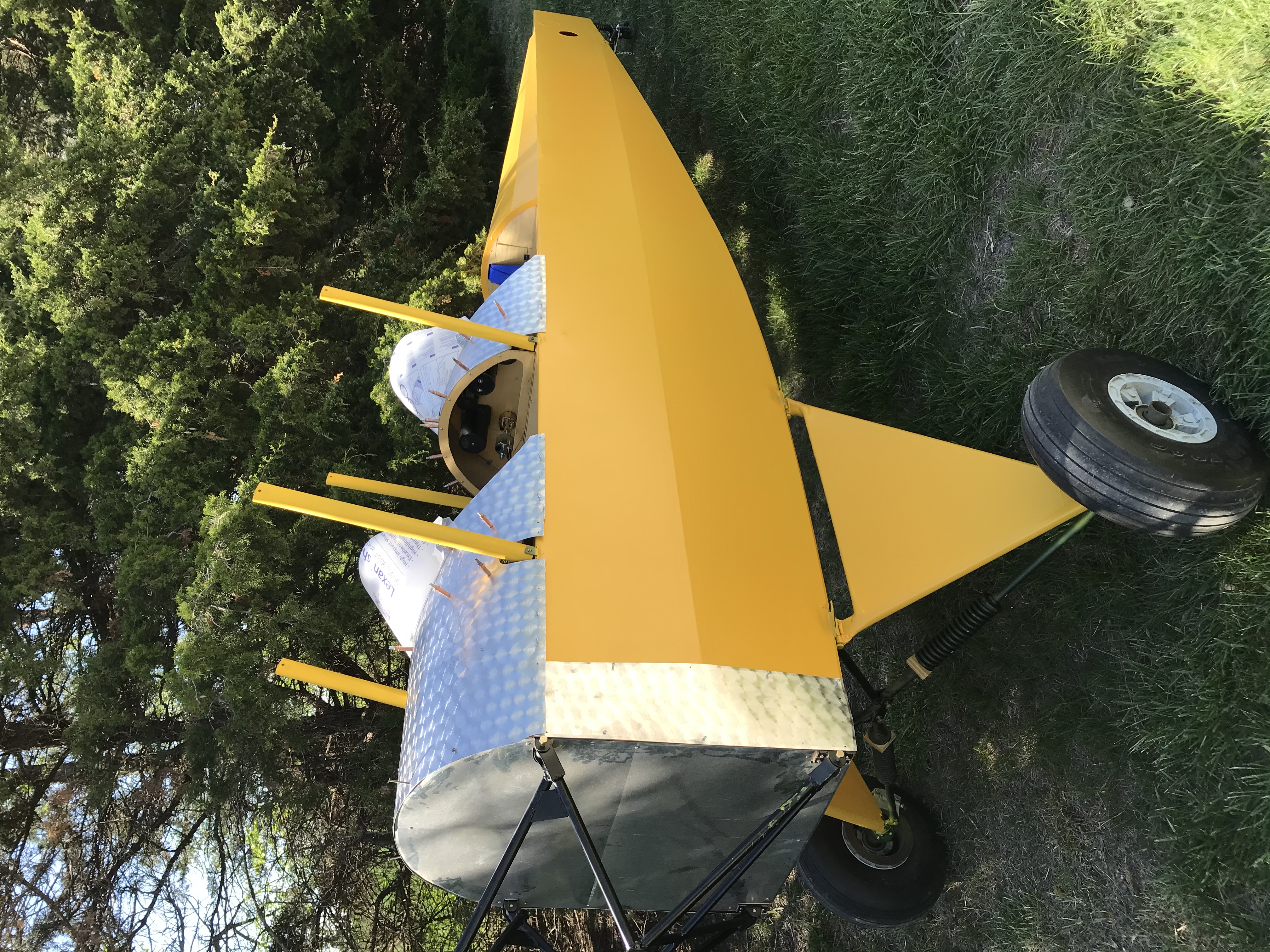

completed tail feather fitting and rigging today. it was a productive day.
- Posts: 46
Congratulations!! It's a great feeling to be at the covering stage. Suddenly the light at the end of the tunnel seems much brighter.
- Posts: 46
all true! its a fun build!
- Posts: 46
Careful... I see you've got that plane inverted. Note that the Air Camper is Normal category and only good for negative 1.52 G ;o)
-Oscar Z.
-Oscar Z.
- Posts: 46
sure is easier to cover the bottom upside down though
