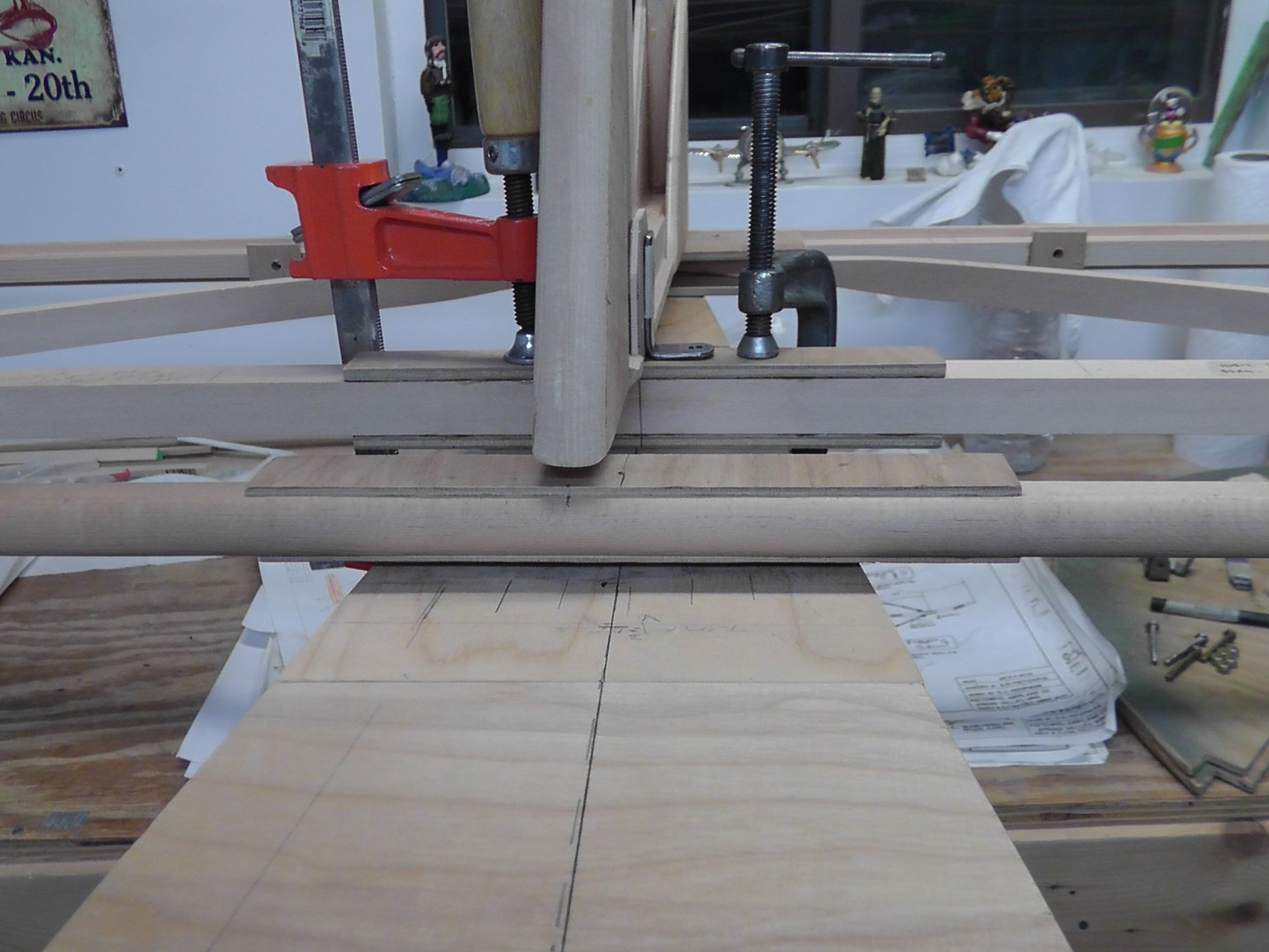

I'm positioning the horizontal stabilizer onto the back end in preparation to drill holes to attach it to the fuselage. I already drilled the holes to attach the vertical stabilizer to the HS. My plan was to offset 1/2" for the Corvair engine.
I noticed right away that one of the VS holes will mostly miss the longeron due due the offset.
I did make sure the HS was square to the fuselage using my marks (checked several times), a large square ruler and running a string from both back outer corners of the HS to the top front where the engine will mount.

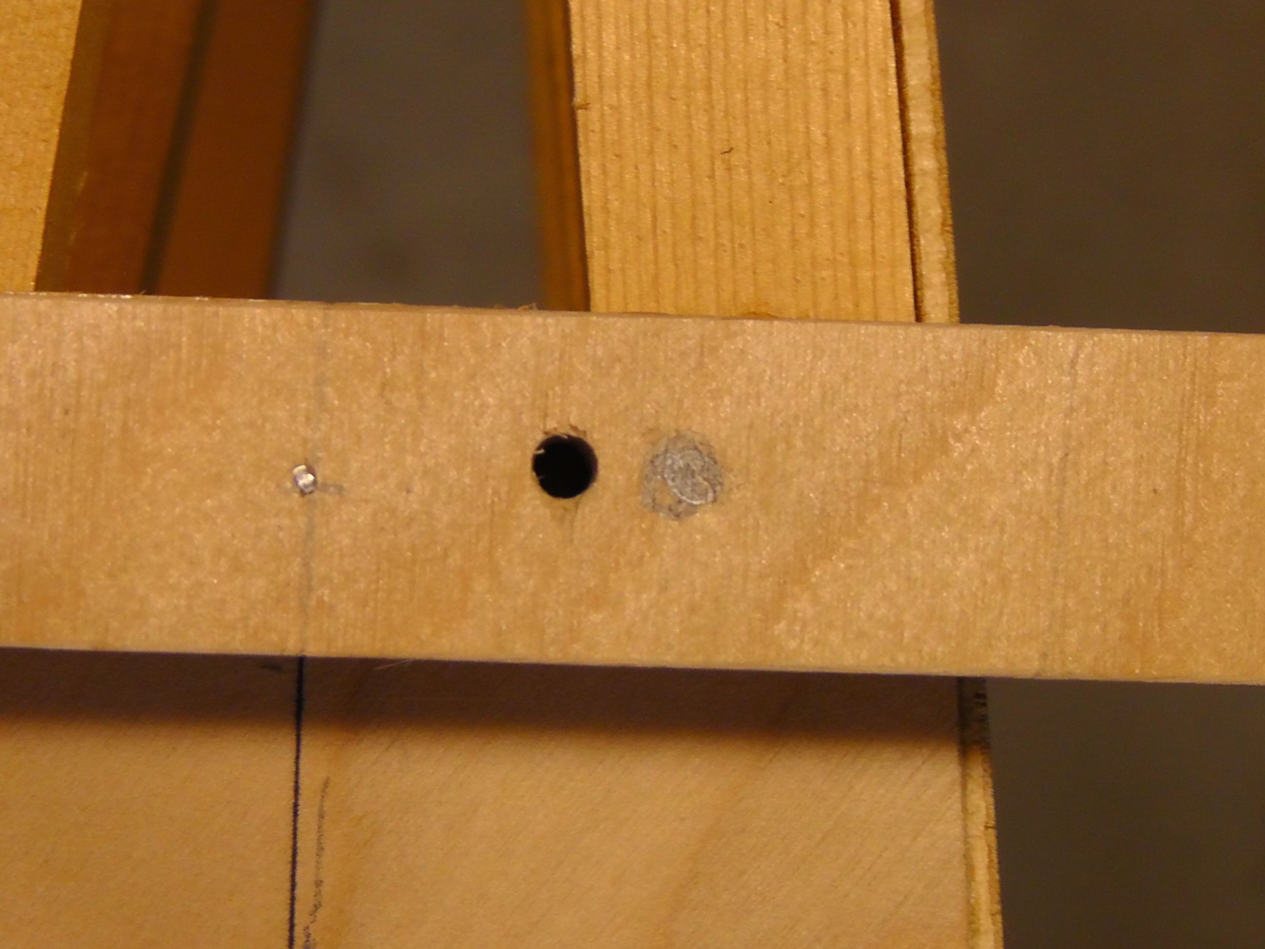

I'm wondering if I should stay with the offset idea and glue a block of wood under the plate (a 1/8" gusset glued on top of fuselage in the area) and glue another 1/8" plate under it, OR mount the VS straight, glue a dowel in the existing HS hole and drill a new hole next to it.
Here's a couple of photos. One shows the offset. The other shows the existing hole and where the new hole would be if I did not offset. The hole on the other side is on center with the offset and will be near the edge without offset similar to what you see in the photo. I would have to glue a dowel in that hole also and drill a new hole if I remove the offset.

Here it is 3:23 in the AM. I think I have an idea. I can put a dowel in that one hole and drill a new hole where the pencil mark is. I can use spacers on the two bolts going through the VS. I won't have to touch the hole on the other side of the VS.
OR
I can also make a new bracket there to get the hole lined up with the pencil mark
I really would like to go through the longeron since it's the main beam and seems like that's where the load is.
OR

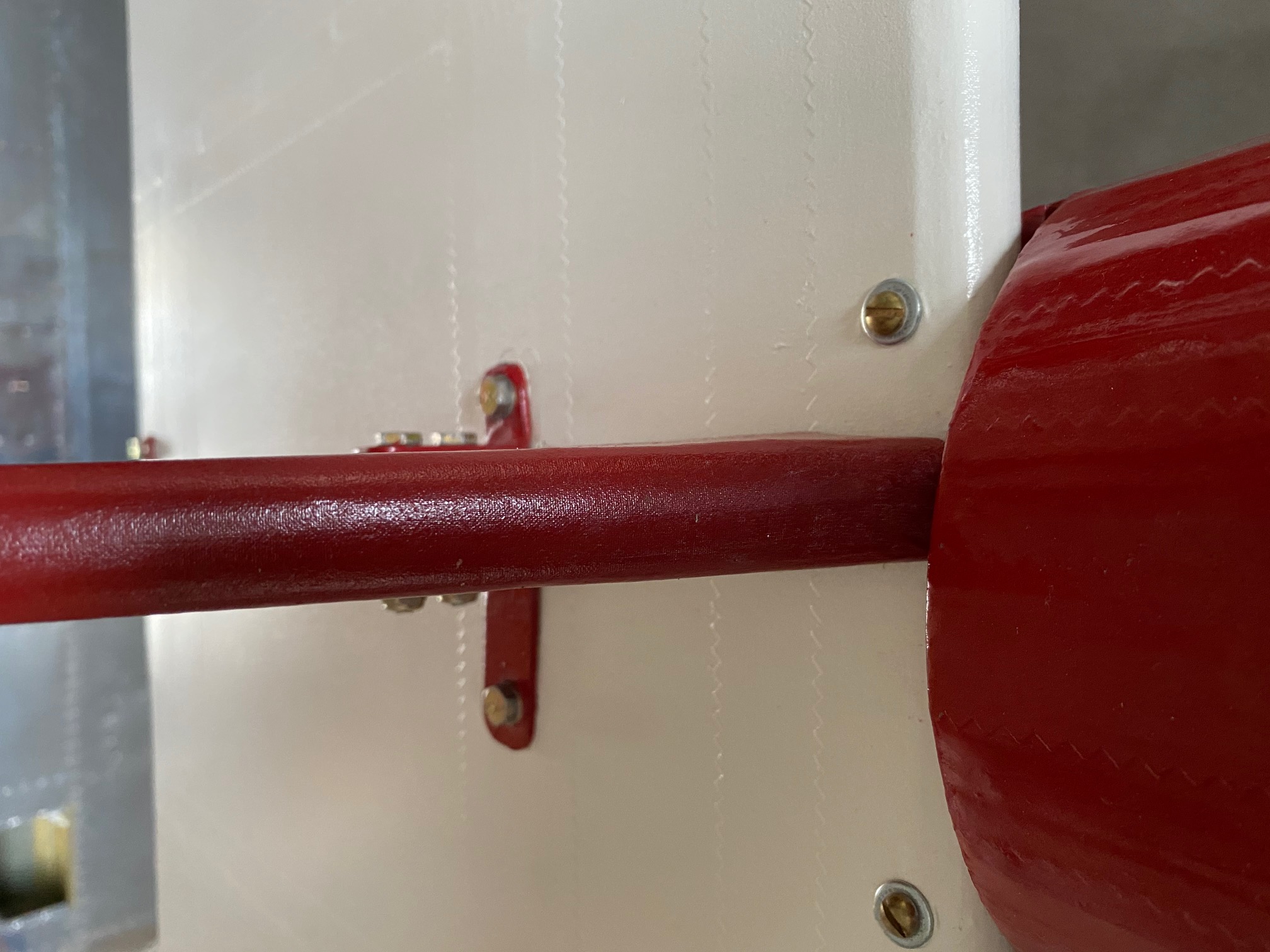

I've attached a photo of how I did mine. The vertical bolts are centered through the longerons. I made each bracket different lengths to sandwich the rudder with the desired offset. Actually I originally had a Corvair on my Piet, later swapping that out for a Continental O-200. When I did, I just swapped the two brackets to shift the offset from the right to the left.
I've seen some super-slick ways of doing this with small brackets on both sides and stacks of washers used to create the desired offset. I didn't see that approach until mine was already done. The advantage of that is the amount of offset can be dialed in by shifting washers from one side to the other until you have exactly the amount you want.
