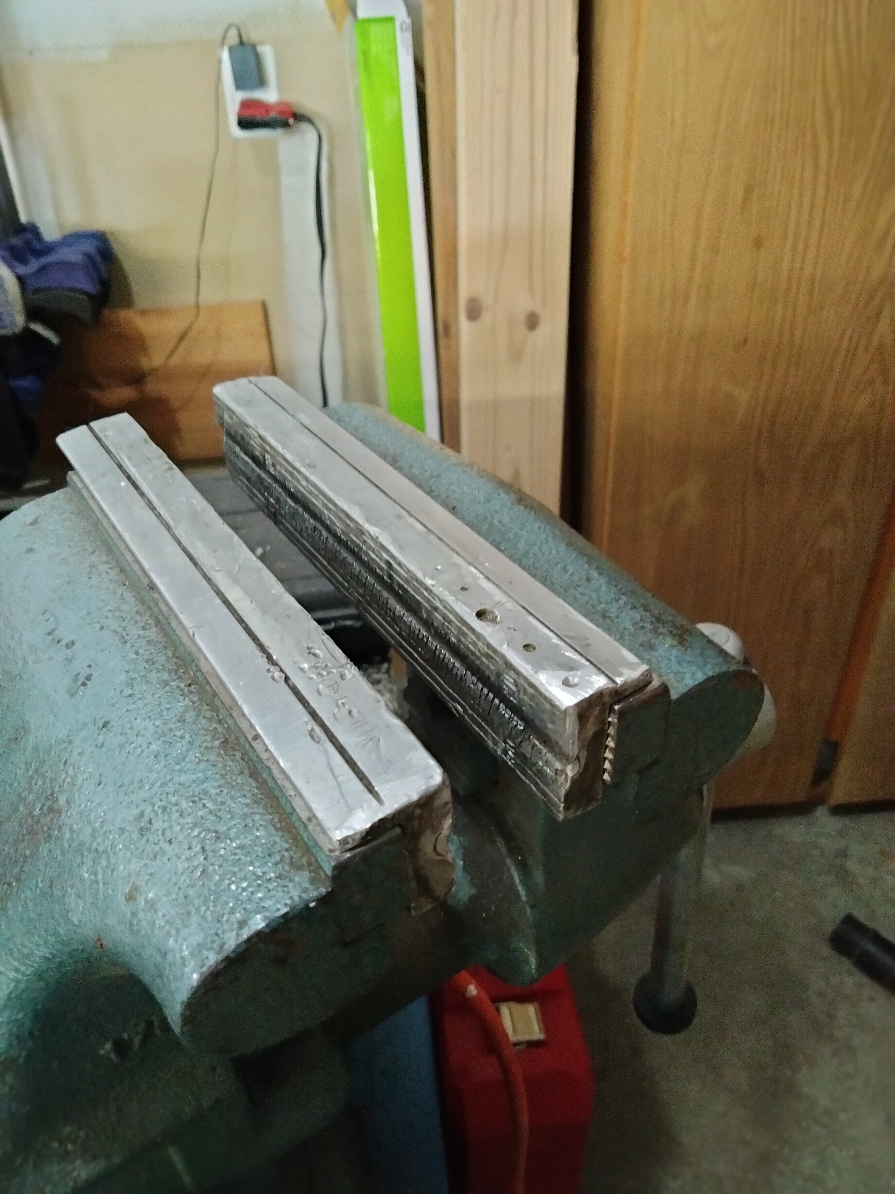

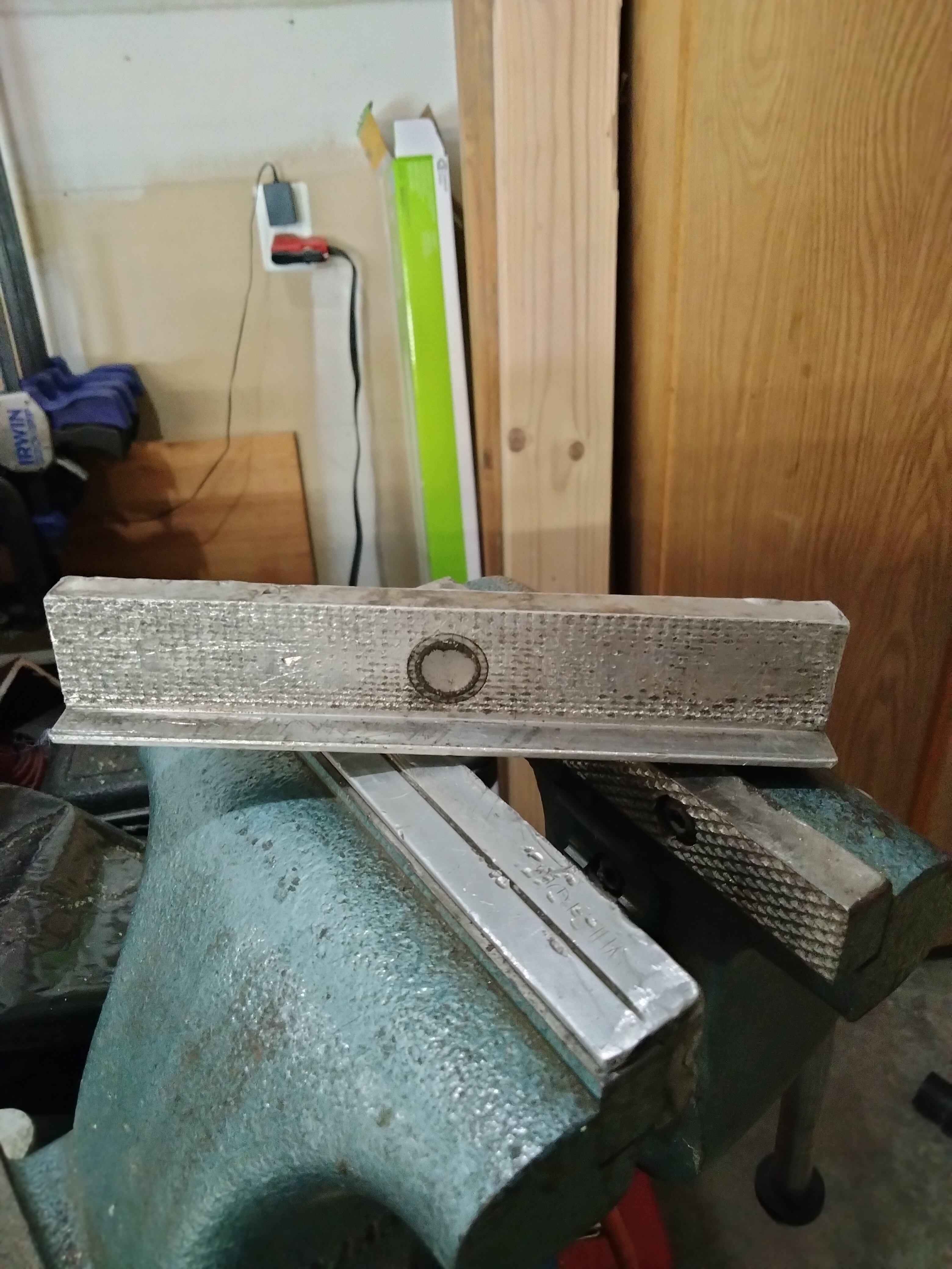

Posts: 356
Re: bench vise jaw protection
Magnetic attachment. Well used, as you can see.
Posts: 719
Egg-zactly! I've been too lazy to do this right, and have marred a number of clean shiny pieces of metal due to my laziness. Let's do this right!
