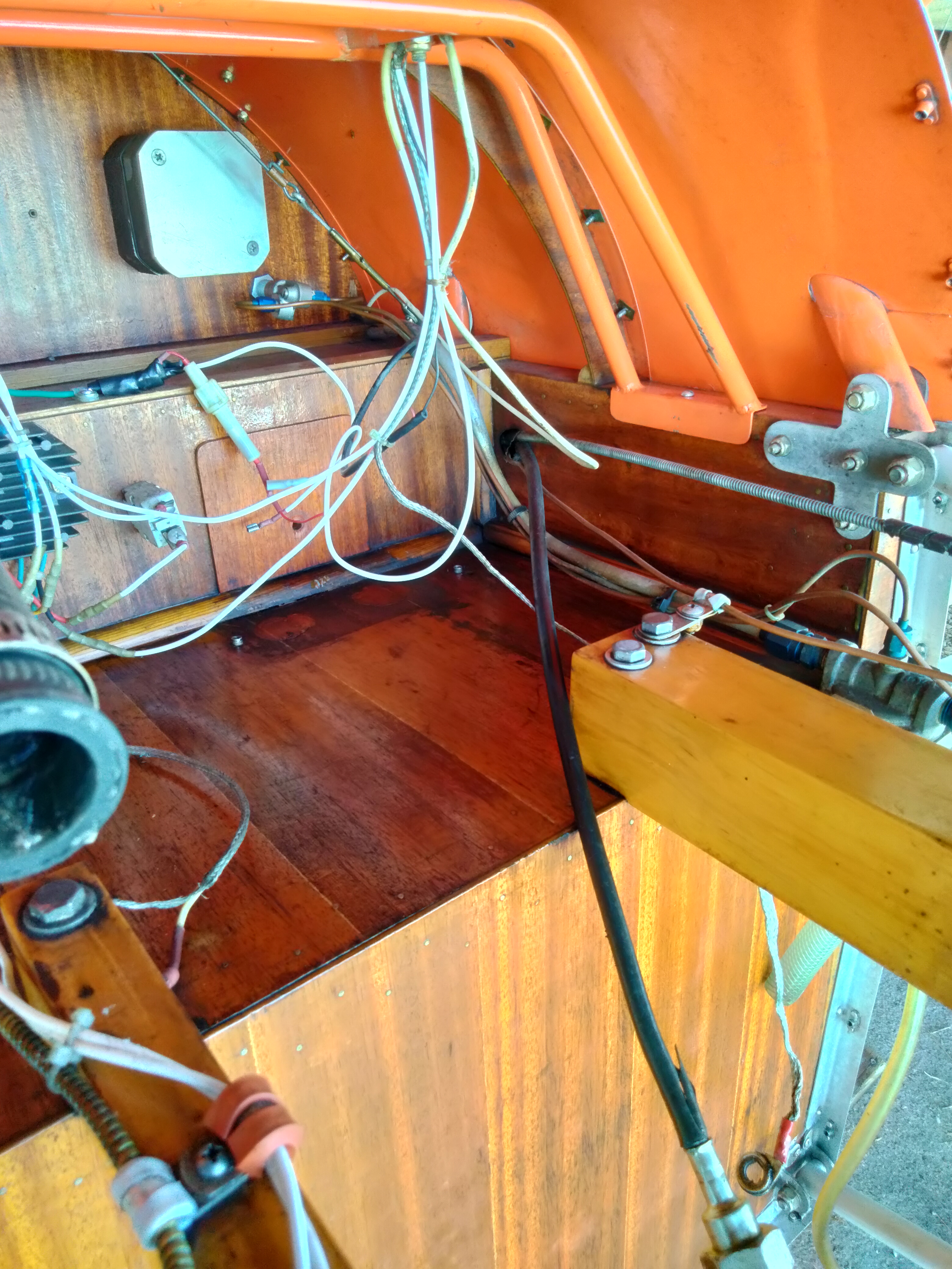

Re: Gascolator Installation
I had the same concern so I used the braid-shielded fuel line material with AN hose fittings on both ends to make it as robust as possible. However, on my plane the penetration through the firewall is around mid-firewall where the passenger's feet would be on either side of it. This is with a tank up front, not in the wing.

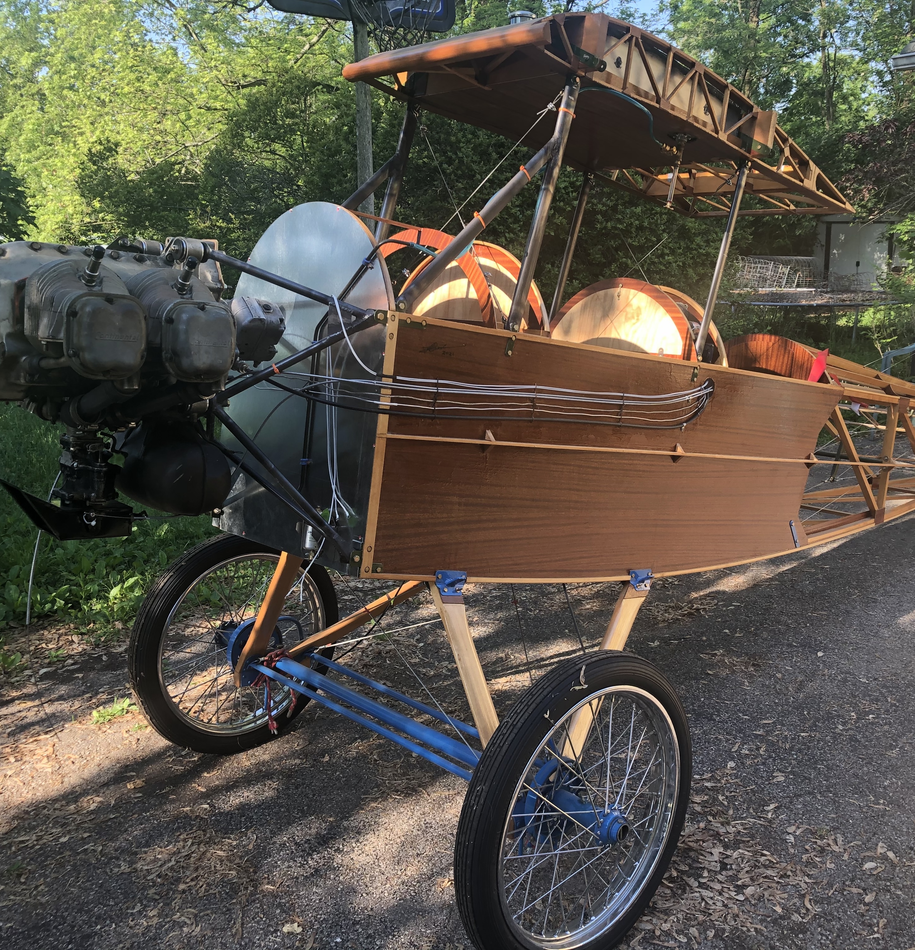

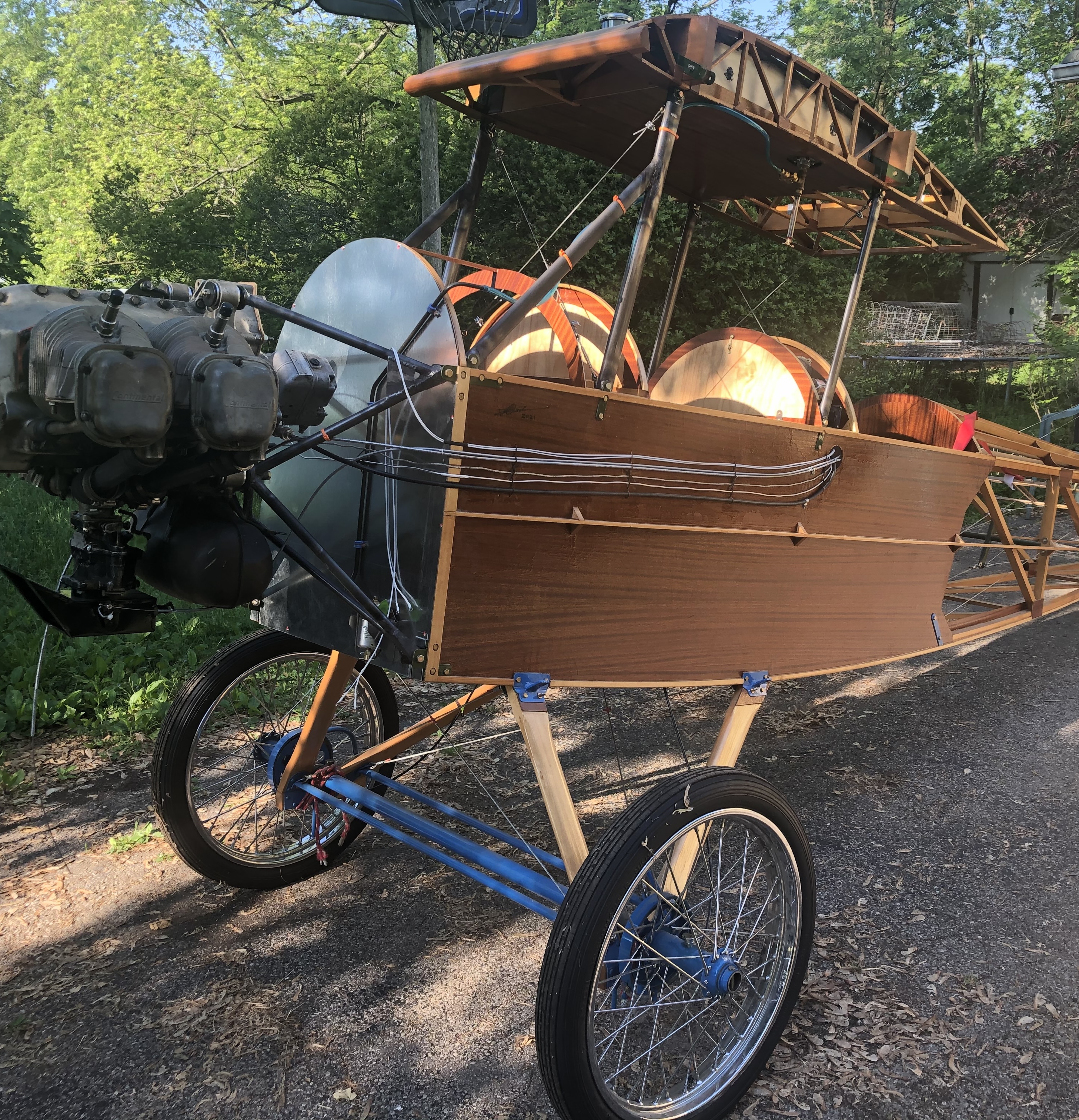

Posts: 95
Could you mount it with a couple spacers and then use an elbow fitting? Then you could run your fuel line from anywhere you like. I built my Air Camper with no penetrations through the firewall and no junk cluttering up the passenger compartment.
In the photos you can see the gascolator mounted to the bottom left of the firewall, and the fuel line entering from the top left.
