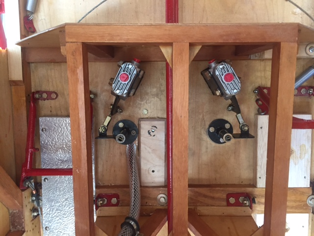

I’m still in the building stage so who knows how well my setup will actually work but for what it’s worth here’s a couple shots of how I did mine. The design is inspired from pictures on West Coast Piet of Charlie Miller’s design.
It’s really hard to get a good picture under there.
And here’s the mess makes underneath.

Dan; does the brake cable go around a pulley to change direction before entering the outer sheath? Looks that way but I can't be sure.

Dan. Are the red straps control stops?

Oscar, the cable does not currently go around a pulley. It just bends 90 degrees around a wood curve. I figured that would be a simpler installation (always on the quest to reduce parts count). However, I made the dimensions match that of a pulley so that if it proves to be a problem then it would be relatively easy to add them.
Richard, yes the red straps are my rudder control stops. I was going to add the wood blocks in front of the rudder bar as stops but they would of been like an inch and a half deep. looked like a lot of block! So I decided to try straps instead. The only thing I could think of that might be an issue is if the strap slid in or out on the bar then your travel would lessen. That's why you see the safety wire clamping them in place.
None of this stuff has been tested in the field mind you.
I posted mostly just to point out that heel brakes can also be installed sideways.
Another cool sideways set up is pictured on West Coast Piet under Alan James.
