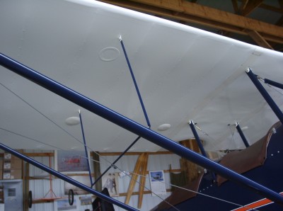

I think there is agreement in saying that the jury struts should not intersect the lift struts in the middle, mainly because that just looks too much like something that could set up a harmonic vibration. Other than that, just look at photos of other Piets to see where others have placed them, especially examples that have been flying for a long time. I like to look at the pictures of Mike Cuy's airplane on Westcoastpiet.com because there are lots of them and they are detailed, plus he also has construction photos in there. Check out the one I've attached and you can get a good idea of where his are placed since you can count ribs by looking at the stitching.
