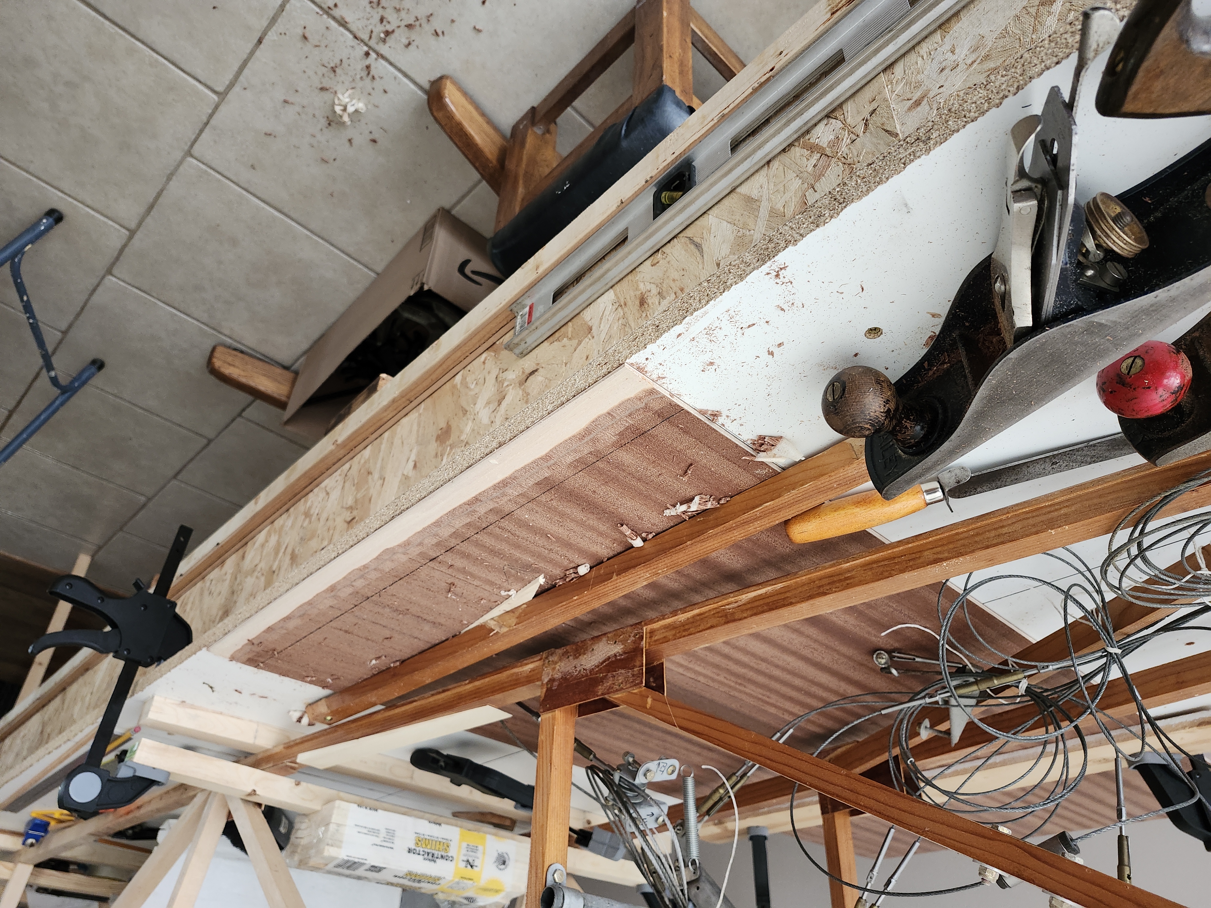

Re: N34KP's rebuild
The glue up on the floorboard worked well. I've planed the edges flush and removed the staples. Several staples broke while trying to remove them. Glued in I guess. I'll have to think about this a little.

Re: N34KP's rebuild
I'm going to ignore the broken staples. They broke off flush with the plywood, and I can't get hold of them short of digging away some of the plywood.

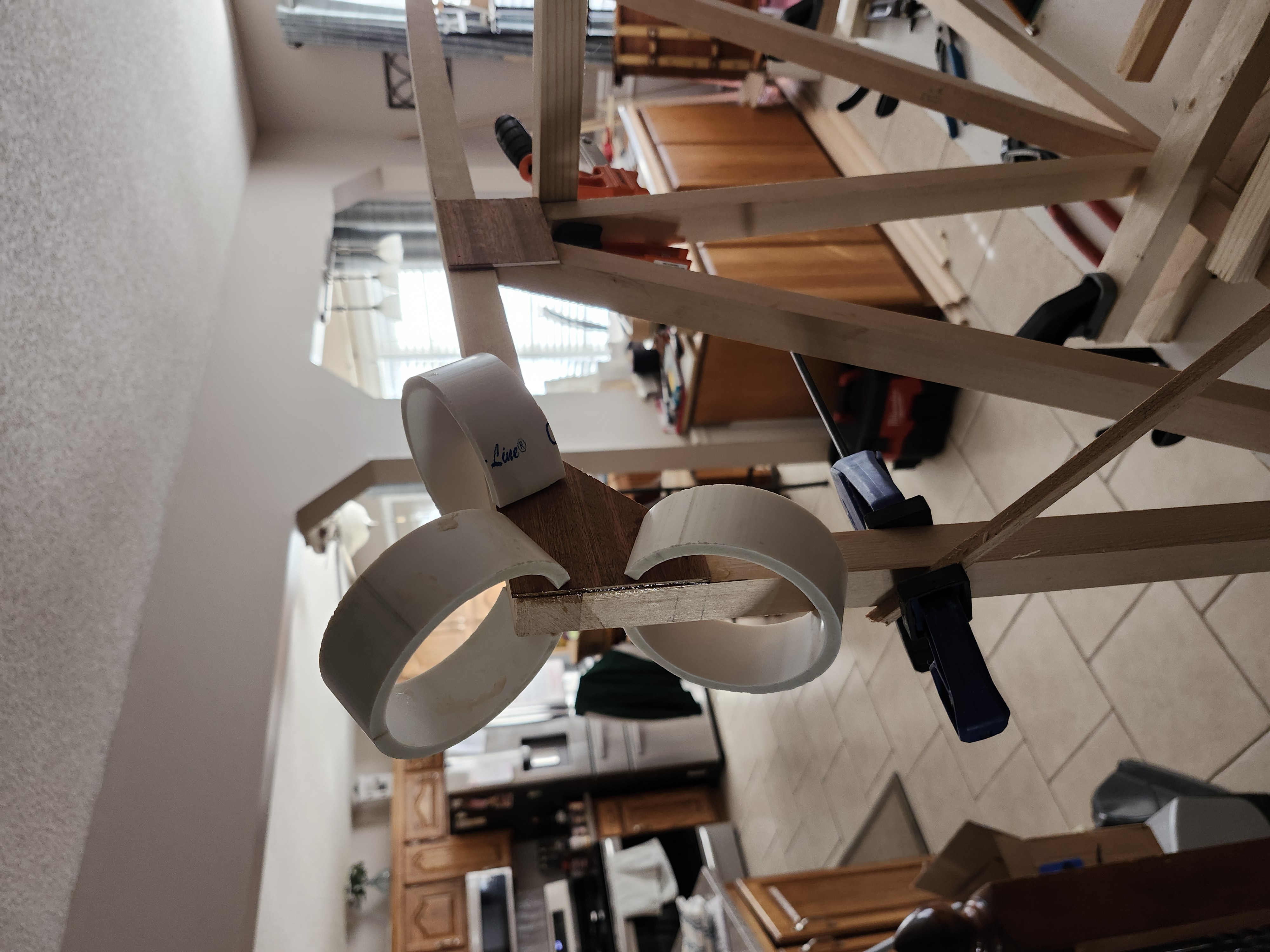

Re: N34KP's rebuild
Slow progress. I've flip the fuselage back upright and started the last gussets. Currently glueing the last two inboard splice doublers.

Re: N34KP's rebuild
I decided to block the corners of the firewall station truss.

Re: N34KP's rebuild
I'll bet that fuselage frame is stiffening up nicely, what with the blocking and crosspieces and gussets getting installed. One of the most comforting things about a Piet is the robustness of its basic structural 'cage'.
