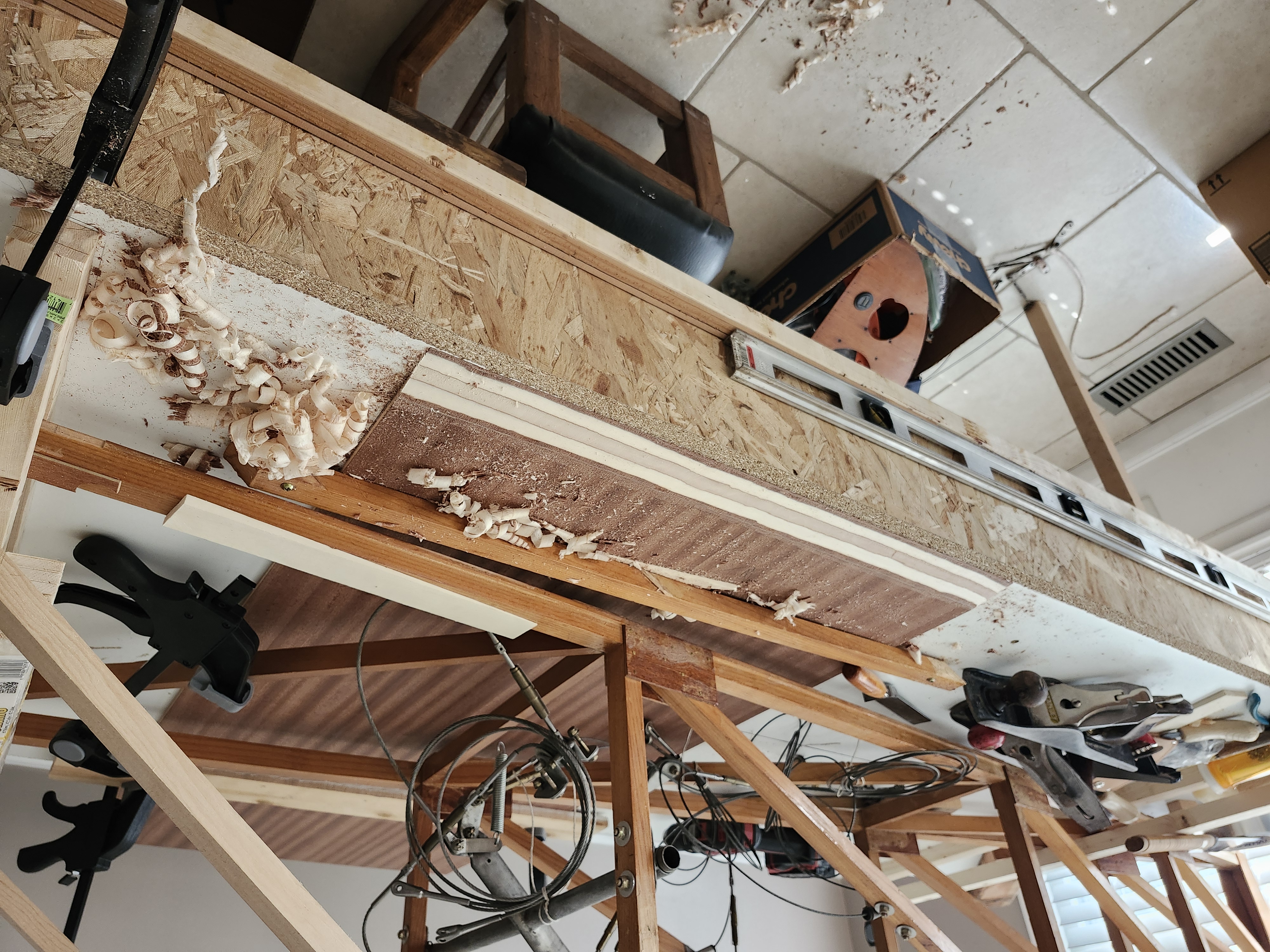

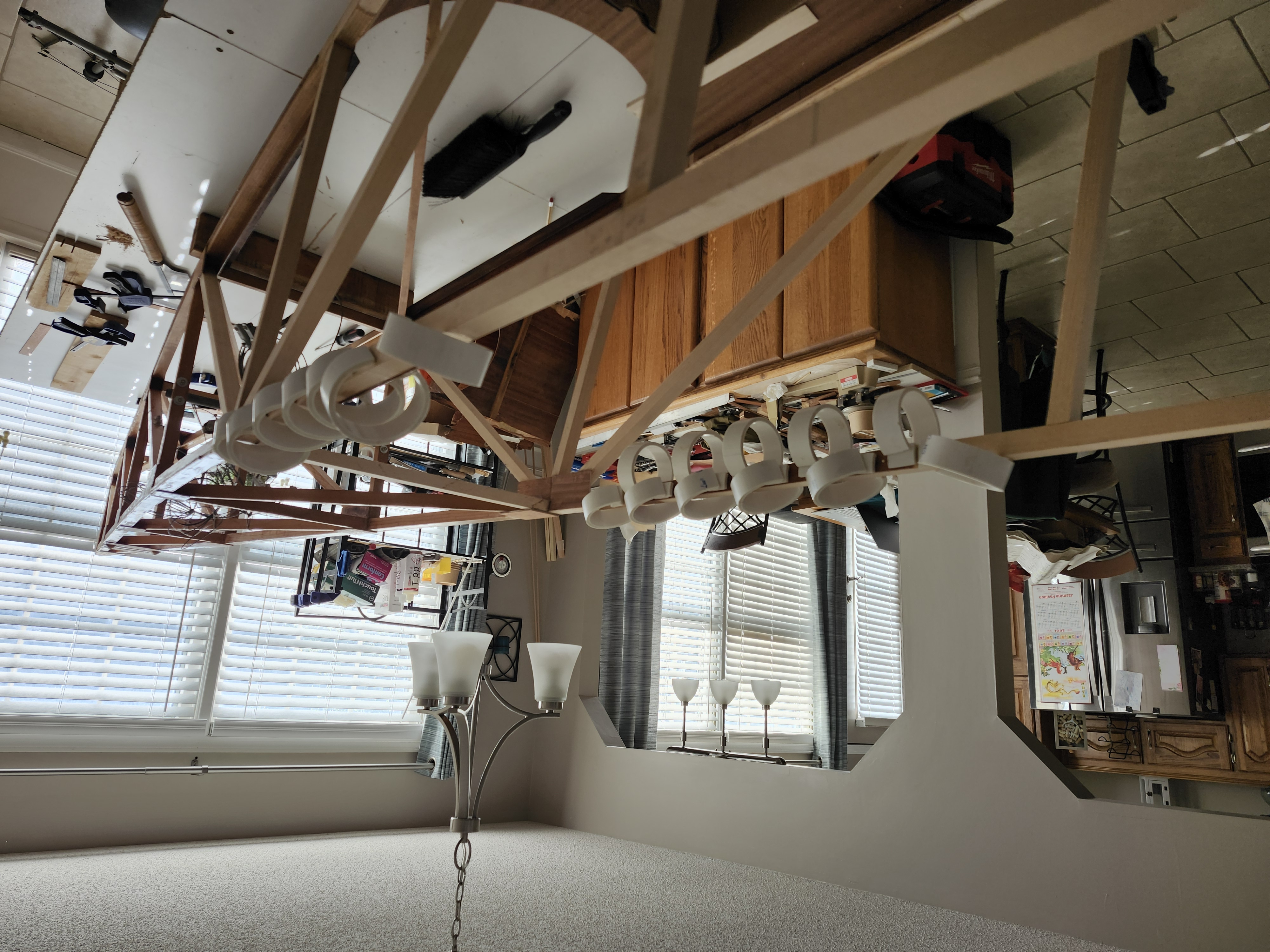

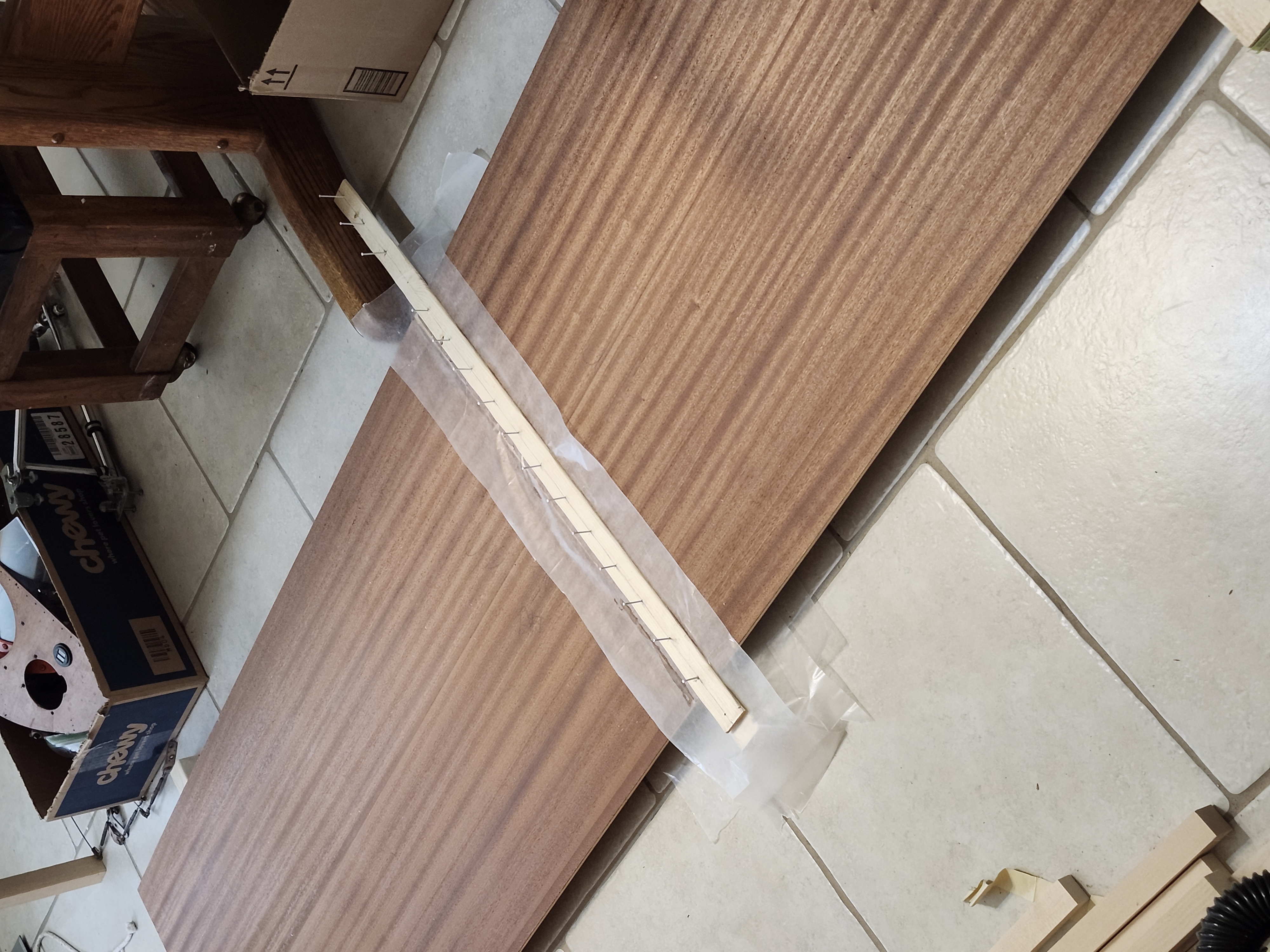

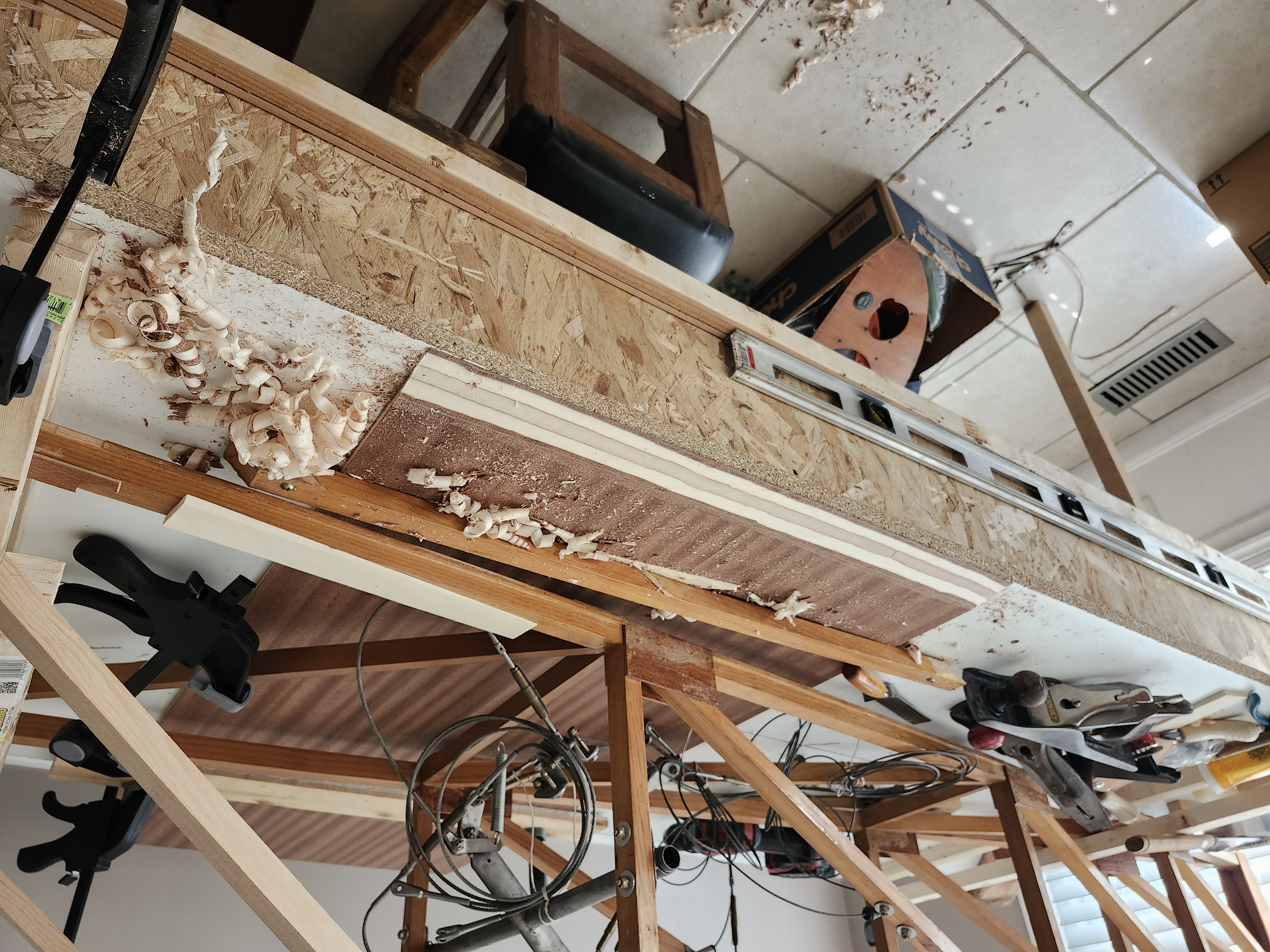

I have to scarph 2 pieces together for the floor board. Here goes nothing!

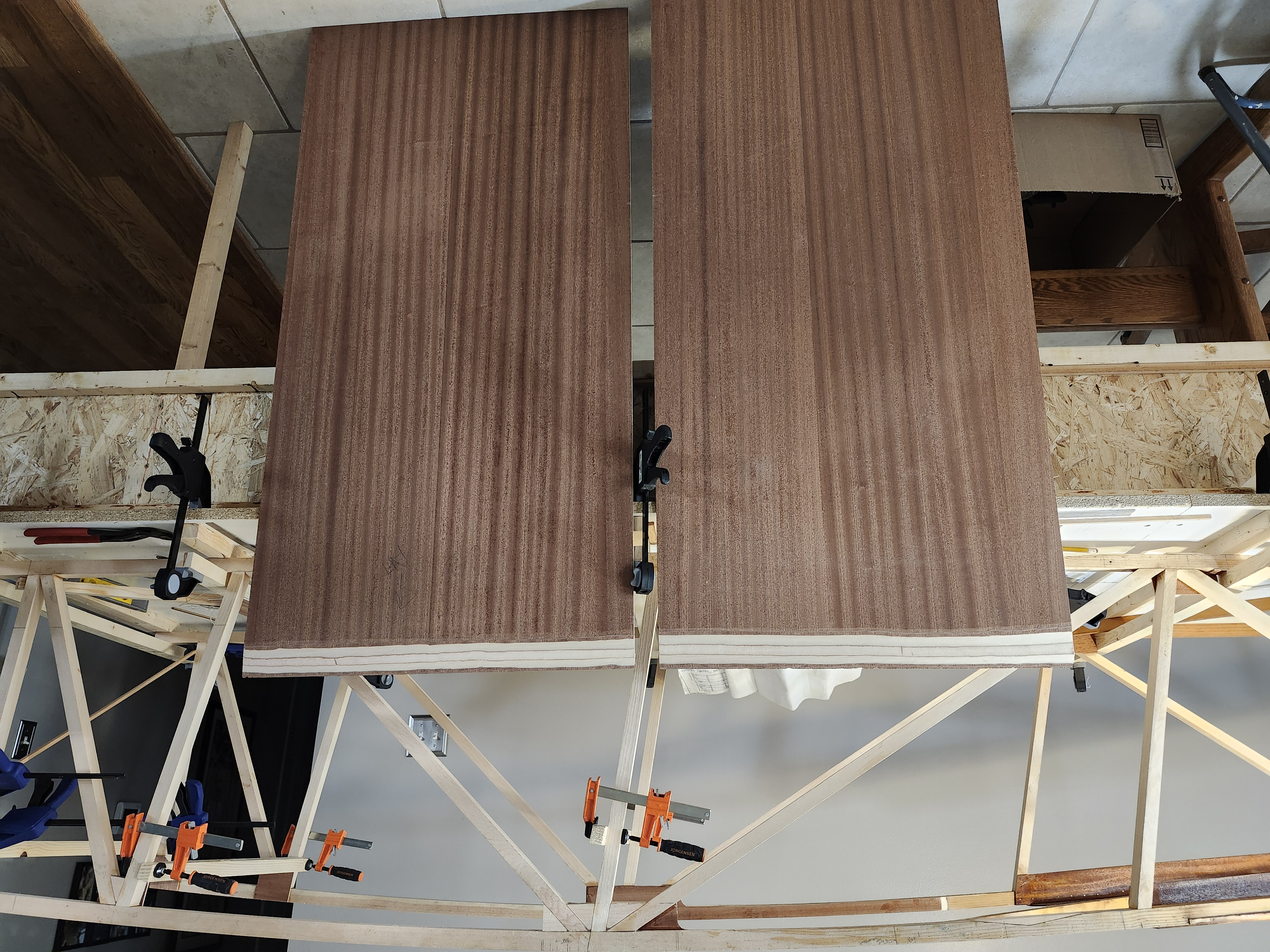

The second one (left) turned out nicer than the first. I'll clean up the first one and glue tomorrow.

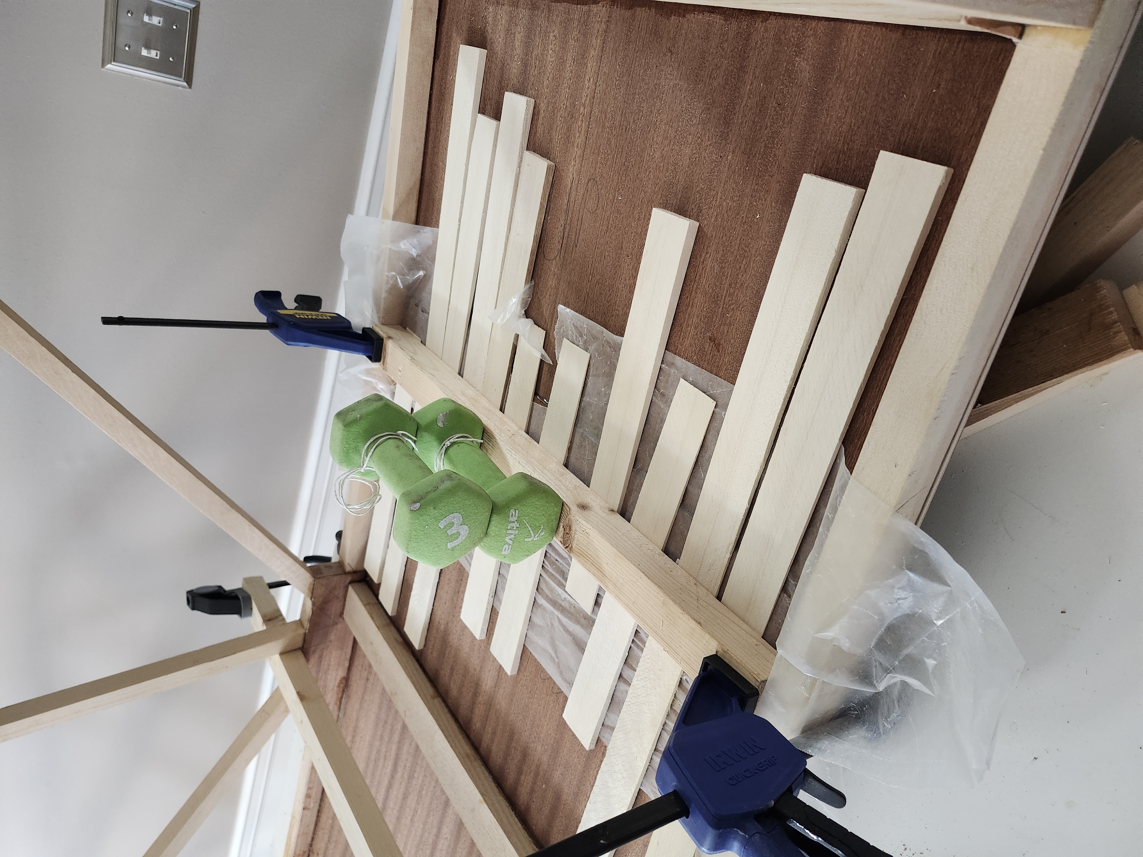

Posts: 348
Re: N34KP's rebuild

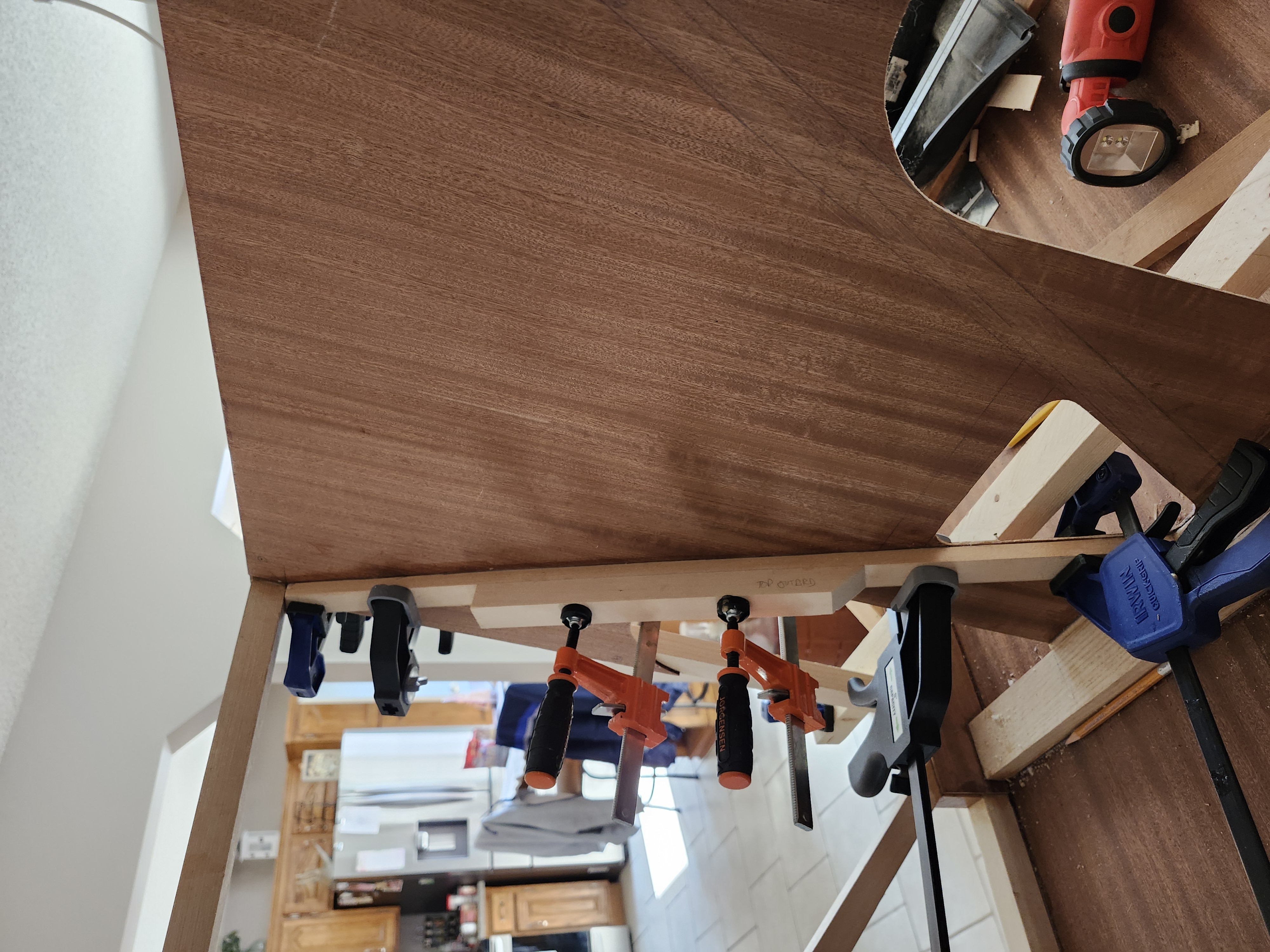

Attempting to glue the two pieces together.

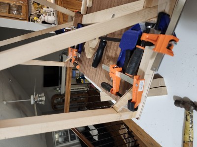

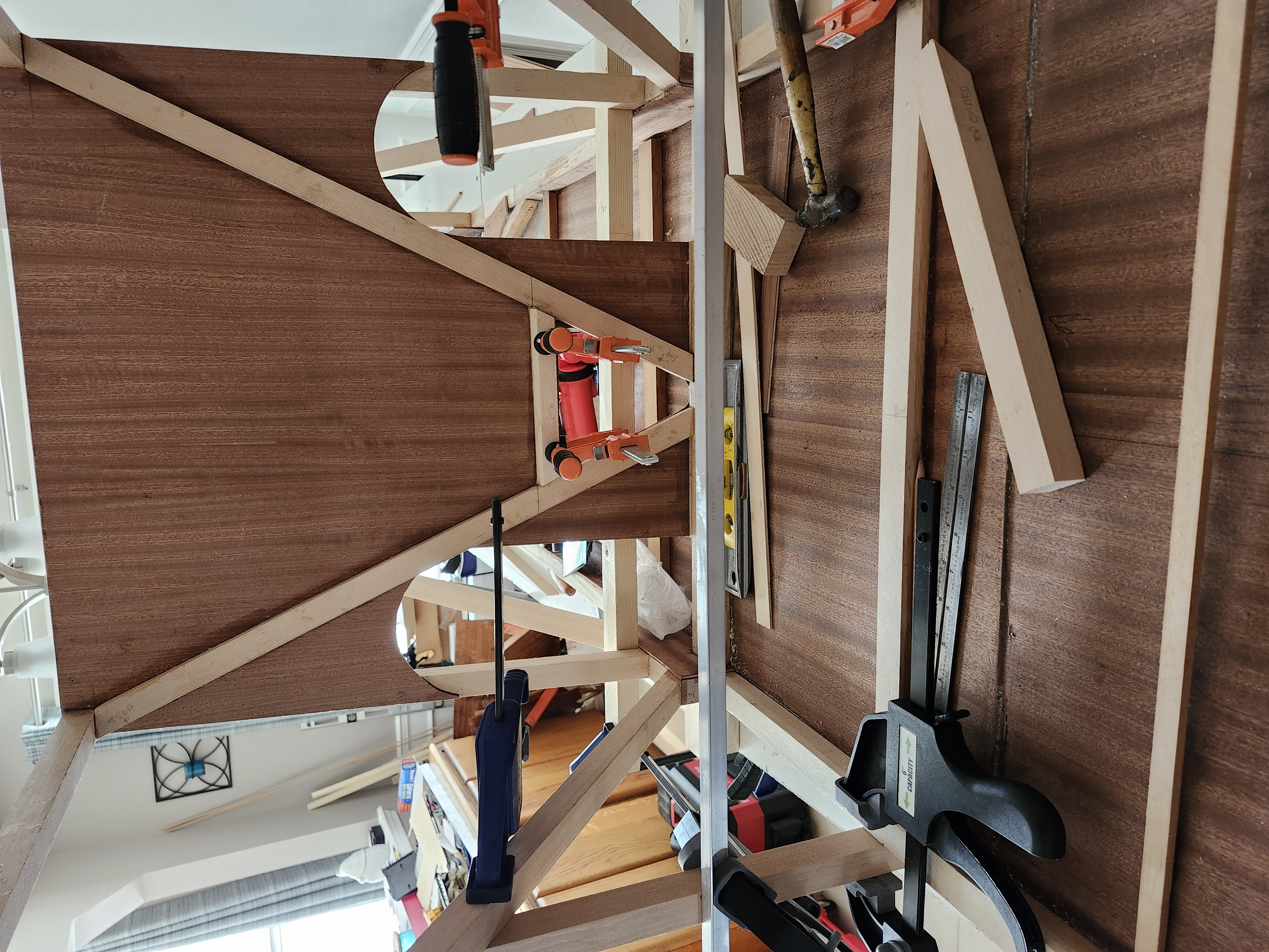

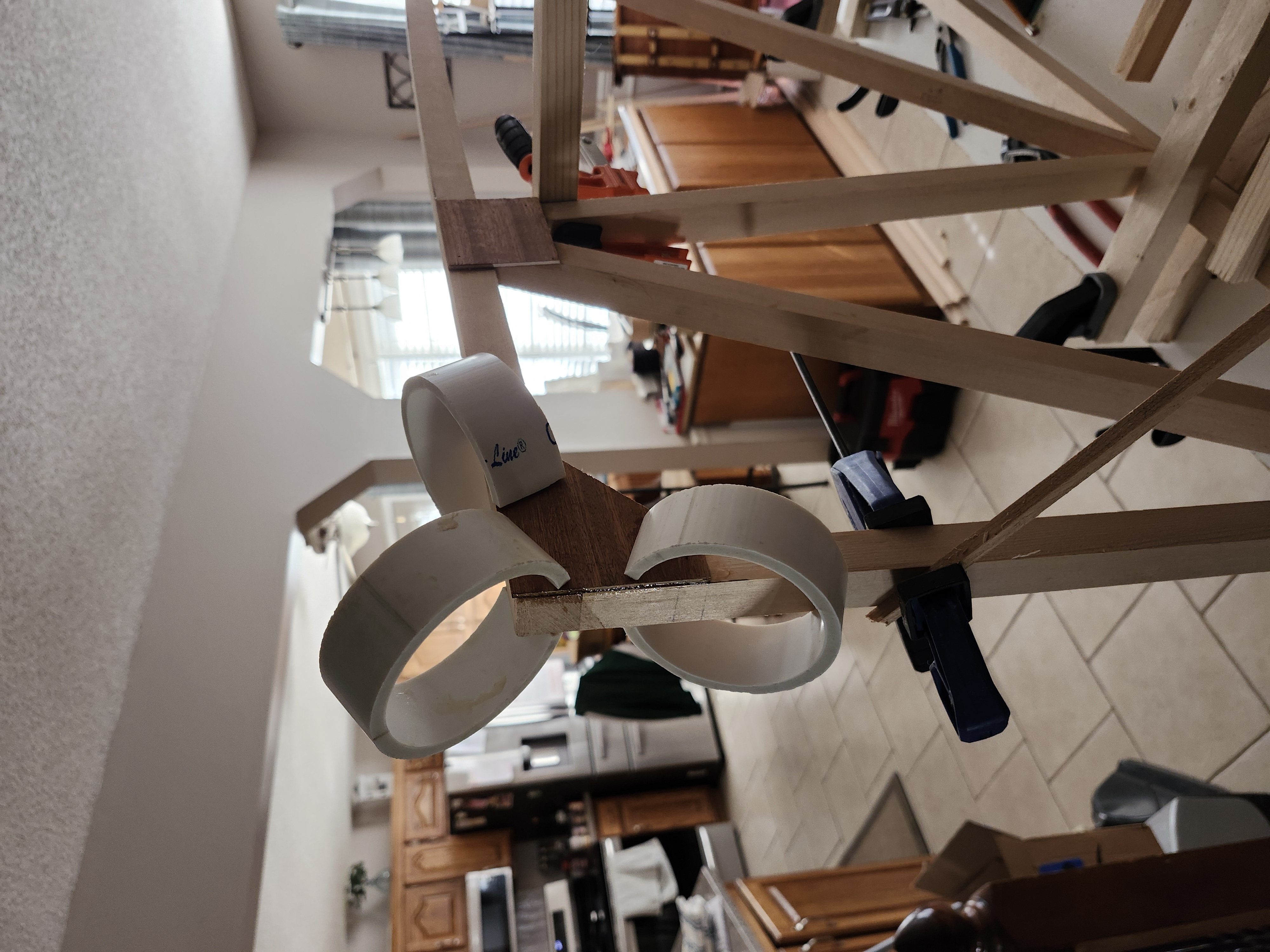

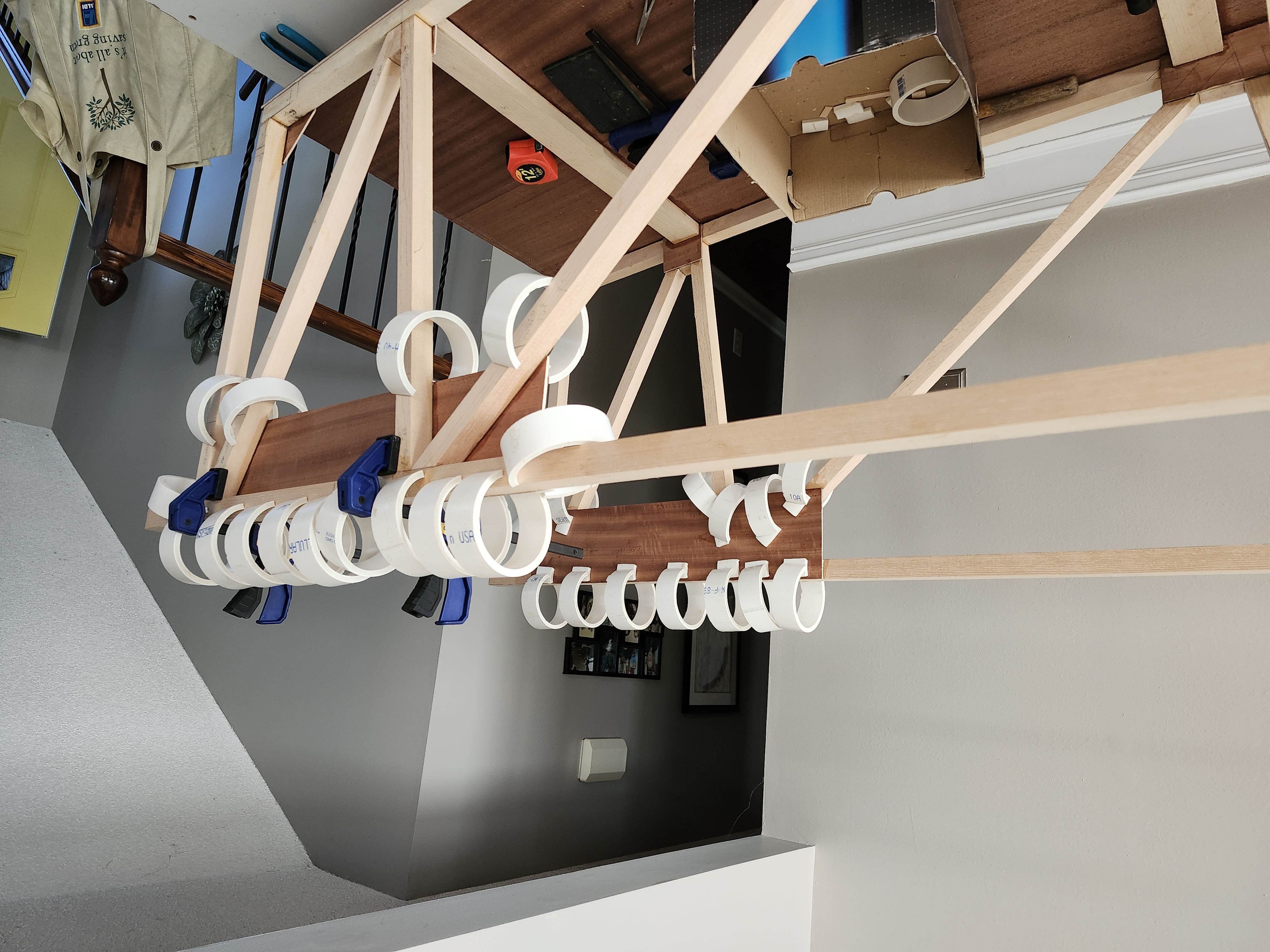

I was mulling over a change to the engine mount brackets at the firewall. I've decided to increase the brackets bolt patterns by one bolt, both horizontally and vertically. So I pulled the existing corner gussets off and I'm gluing new ones on sized to the new bolt pattern. This is in case I decide to change the engine installation down the road.

Re: N34KP's rebuild
Years ago I redrew the steel tube drawings stretched to the long piet length. My thought was to use a 60° V6 on it. I'll probably never built it. But who knows, a V6 on 34KP?

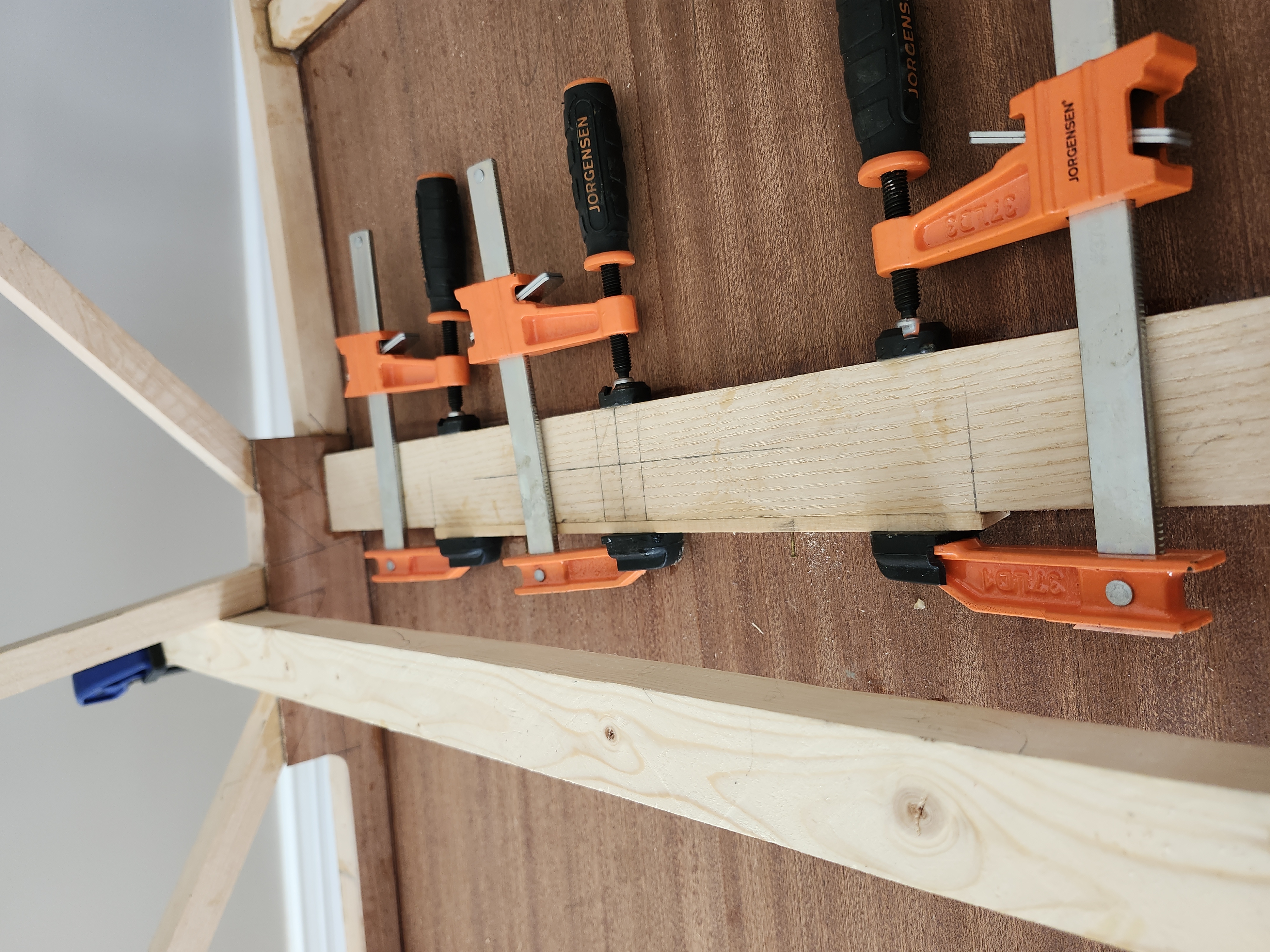

Posts: 348
Re: N34KP's rebuild

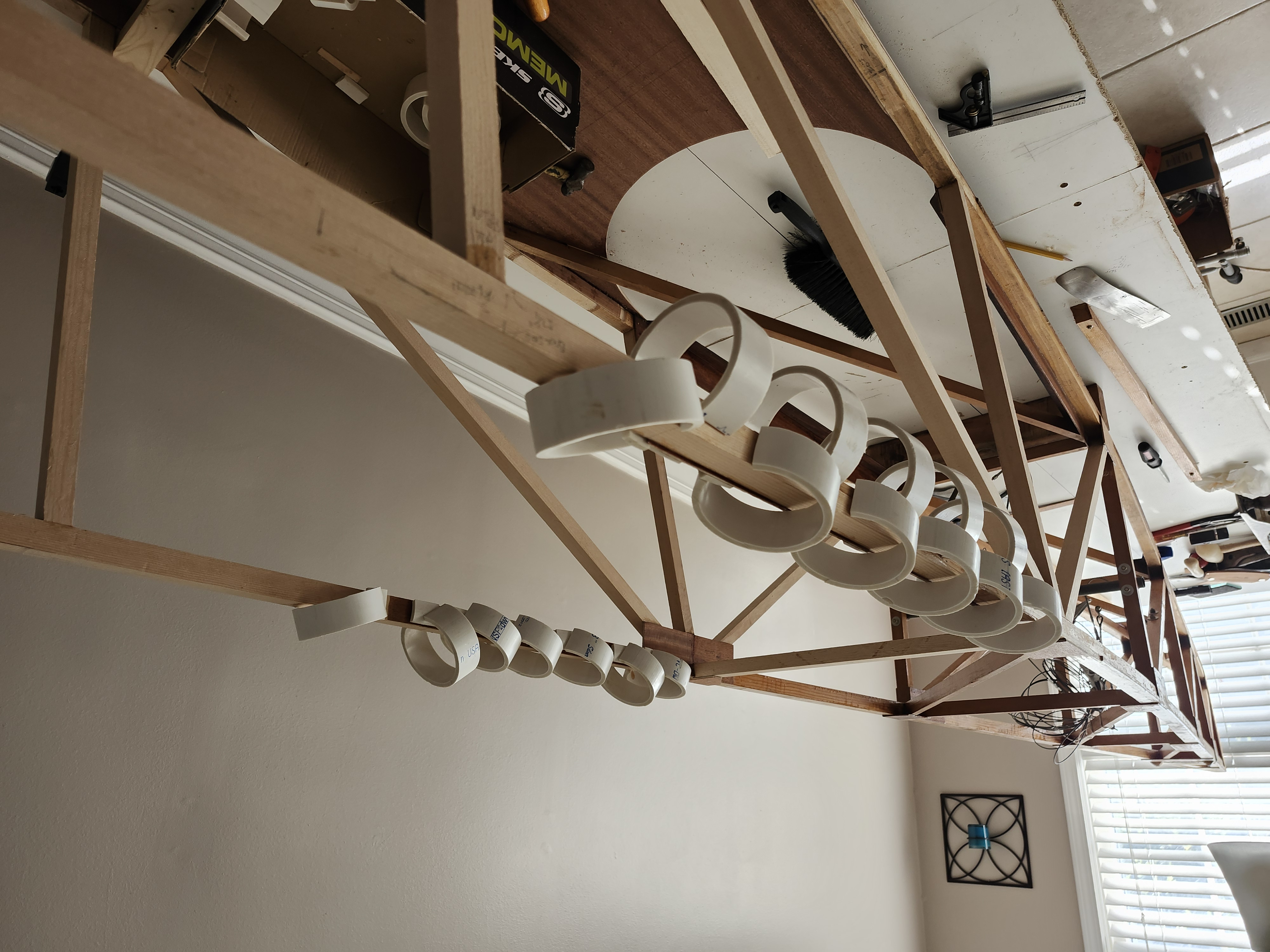

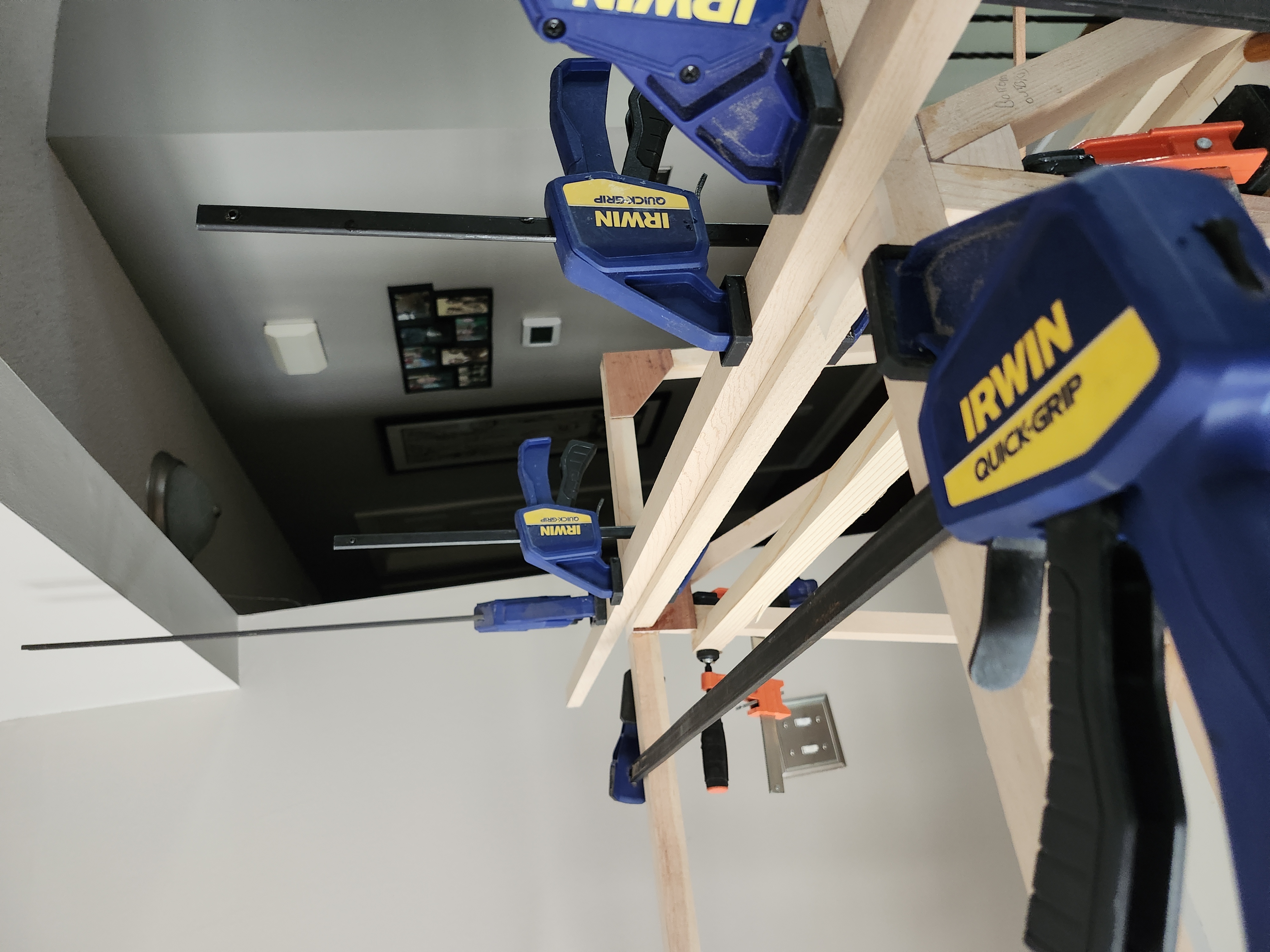

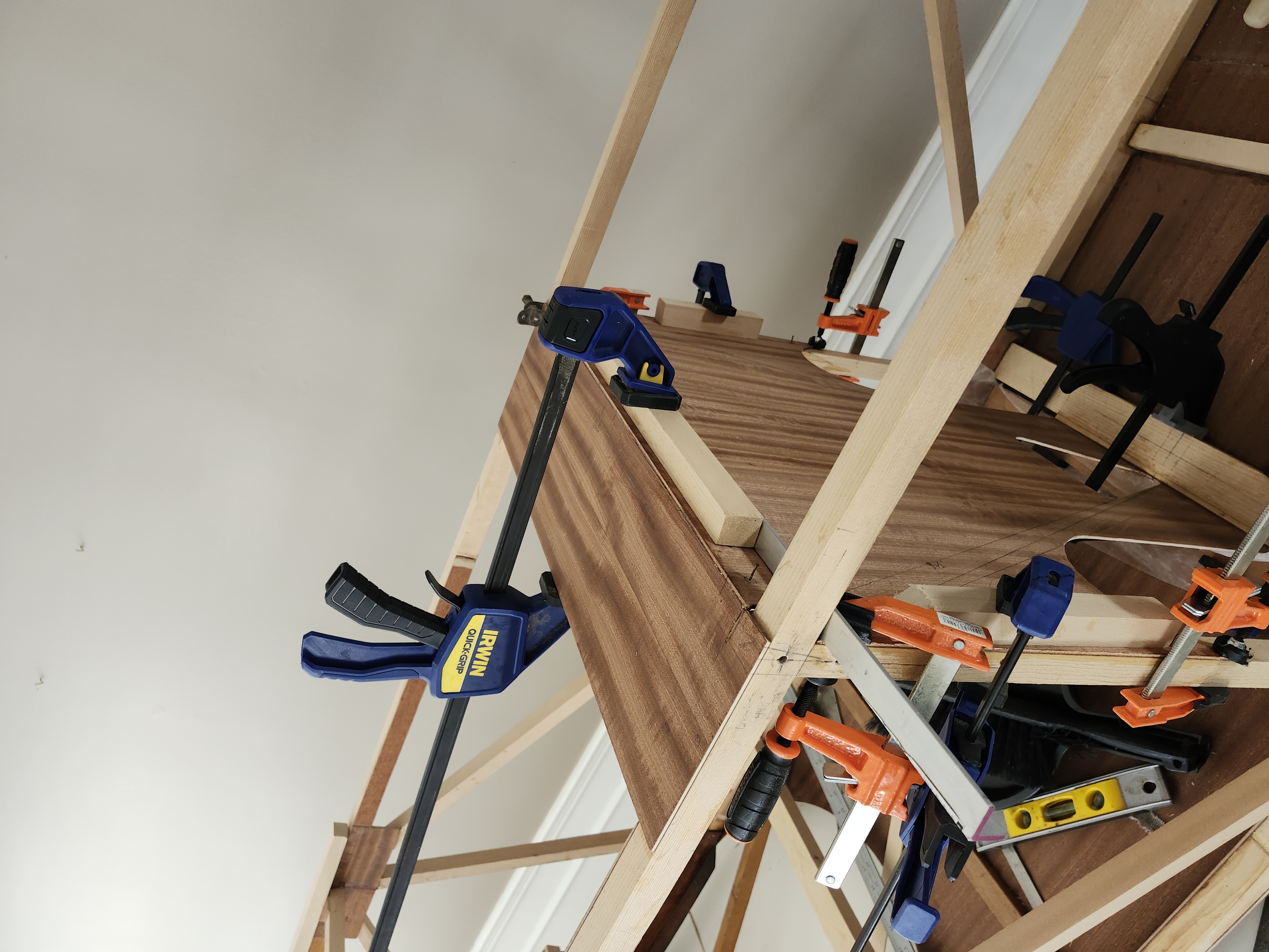

I forced myself to do something today on the Piet. I cut out the ash cross members for the landing gear and started the glueing of the forward cross piece. The floor board is ready to glue on as soon as I get the rear one in.

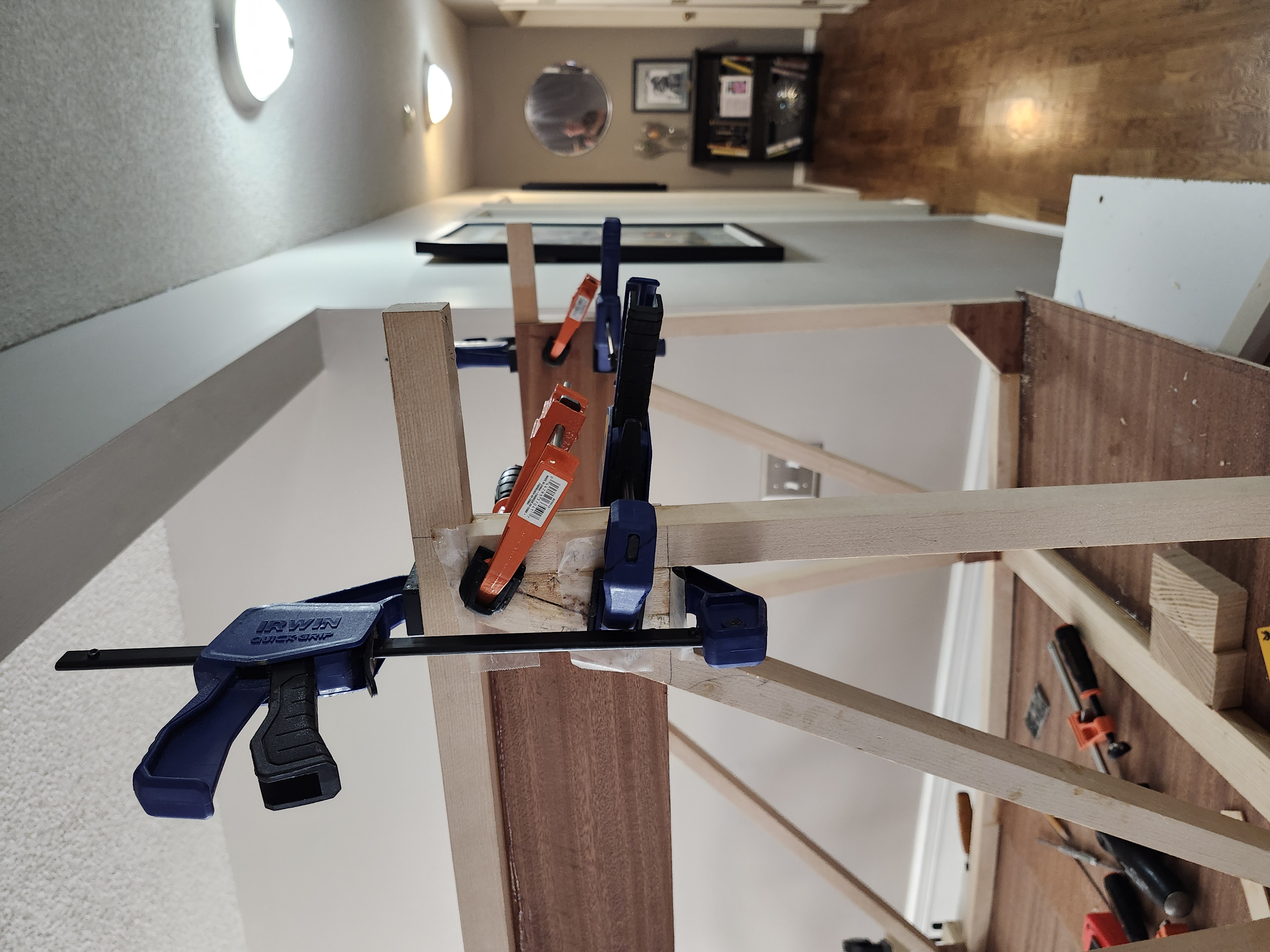

Posts: 348
Re: N34KP's rebuild
Forward cross piece glued in.

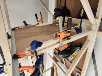

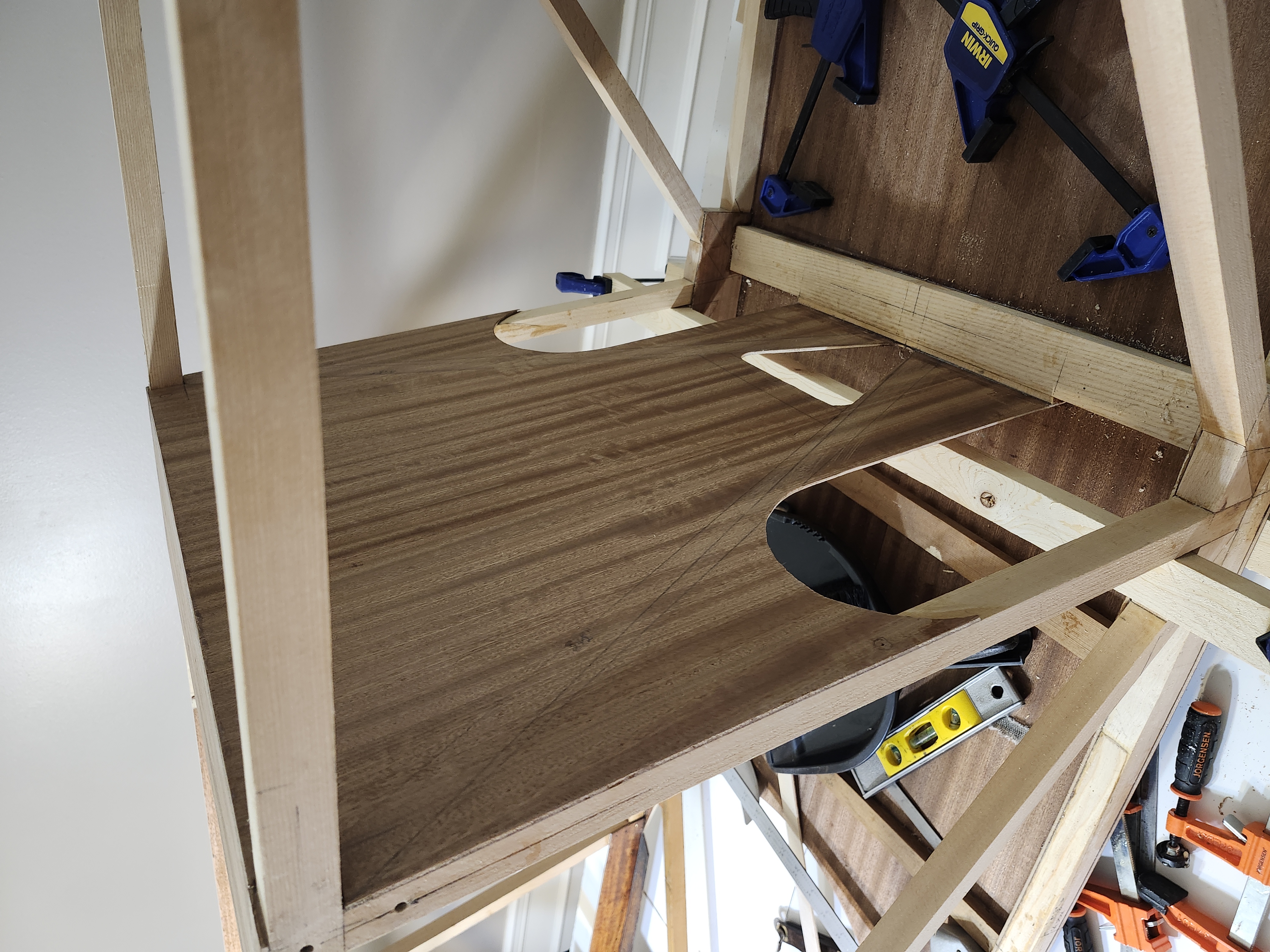

The rear cross piece is in and I'm fitting the floor board.

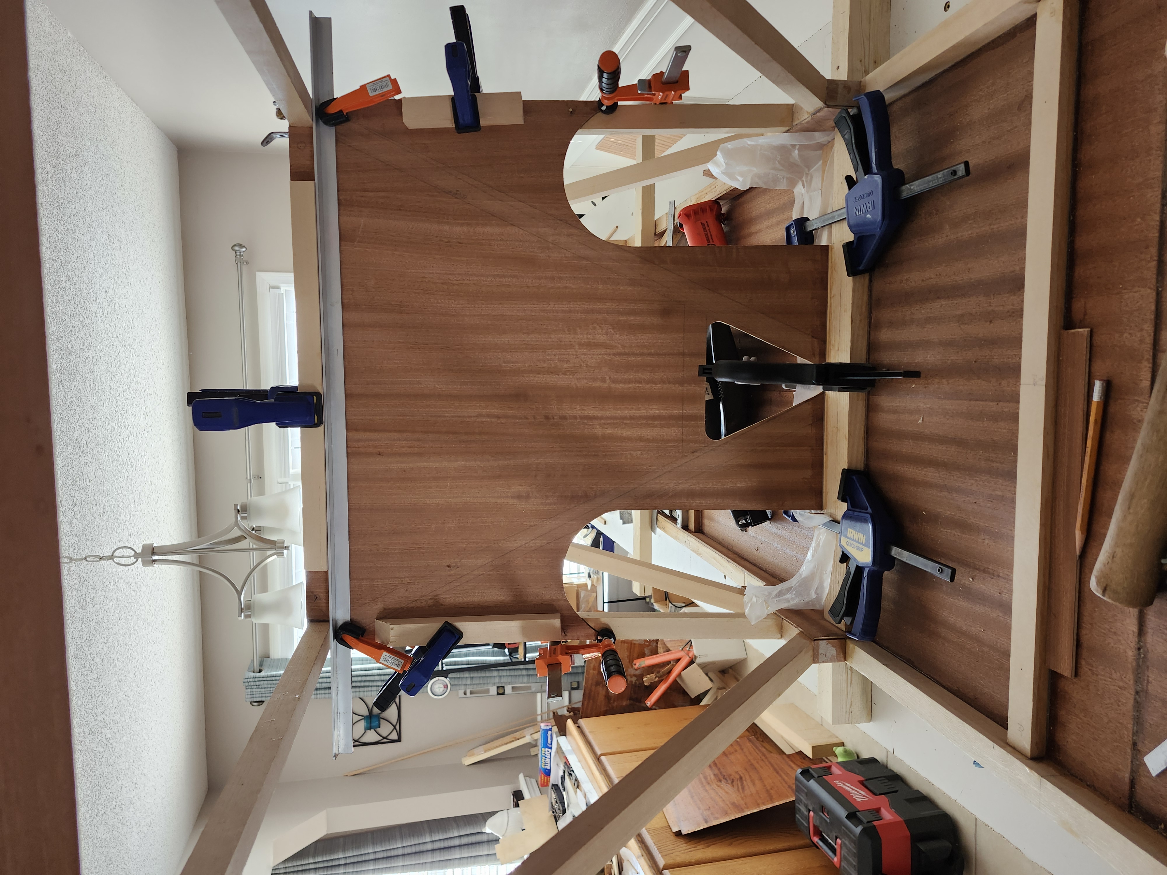

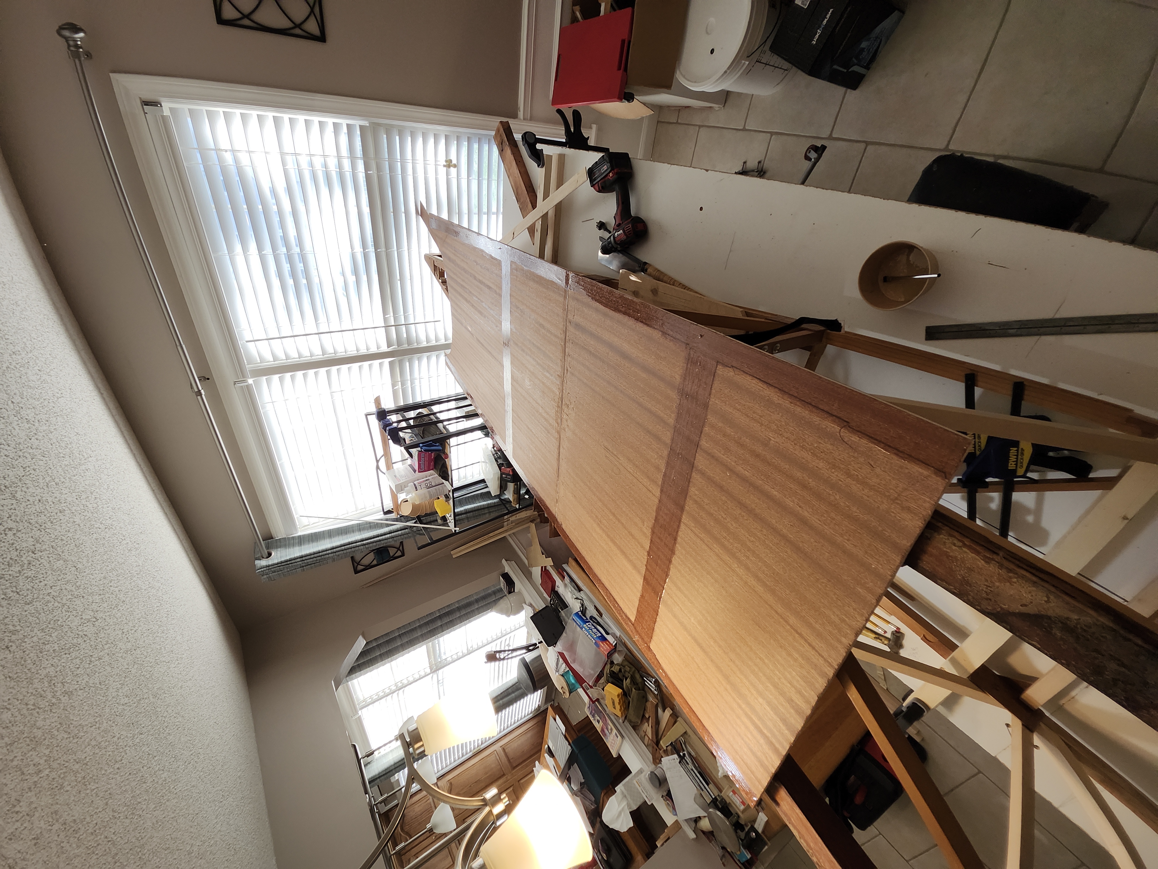

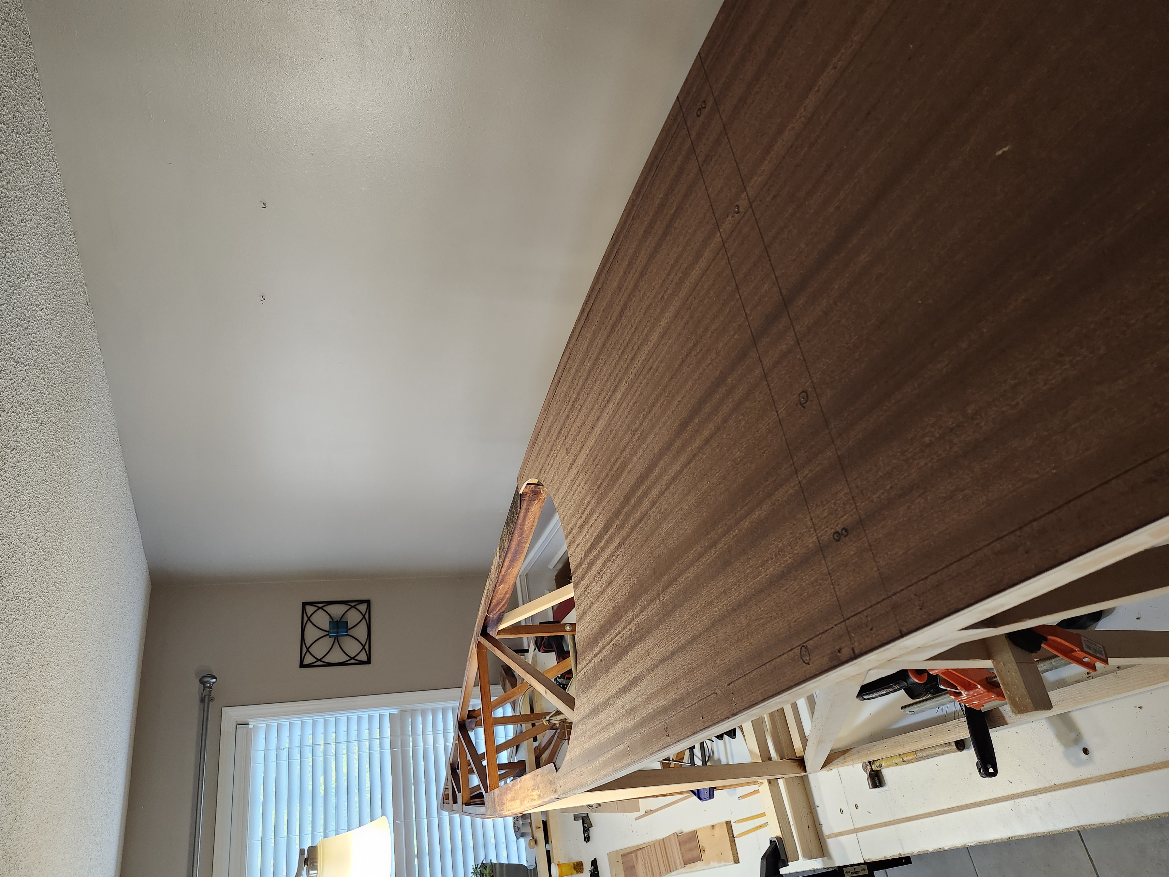

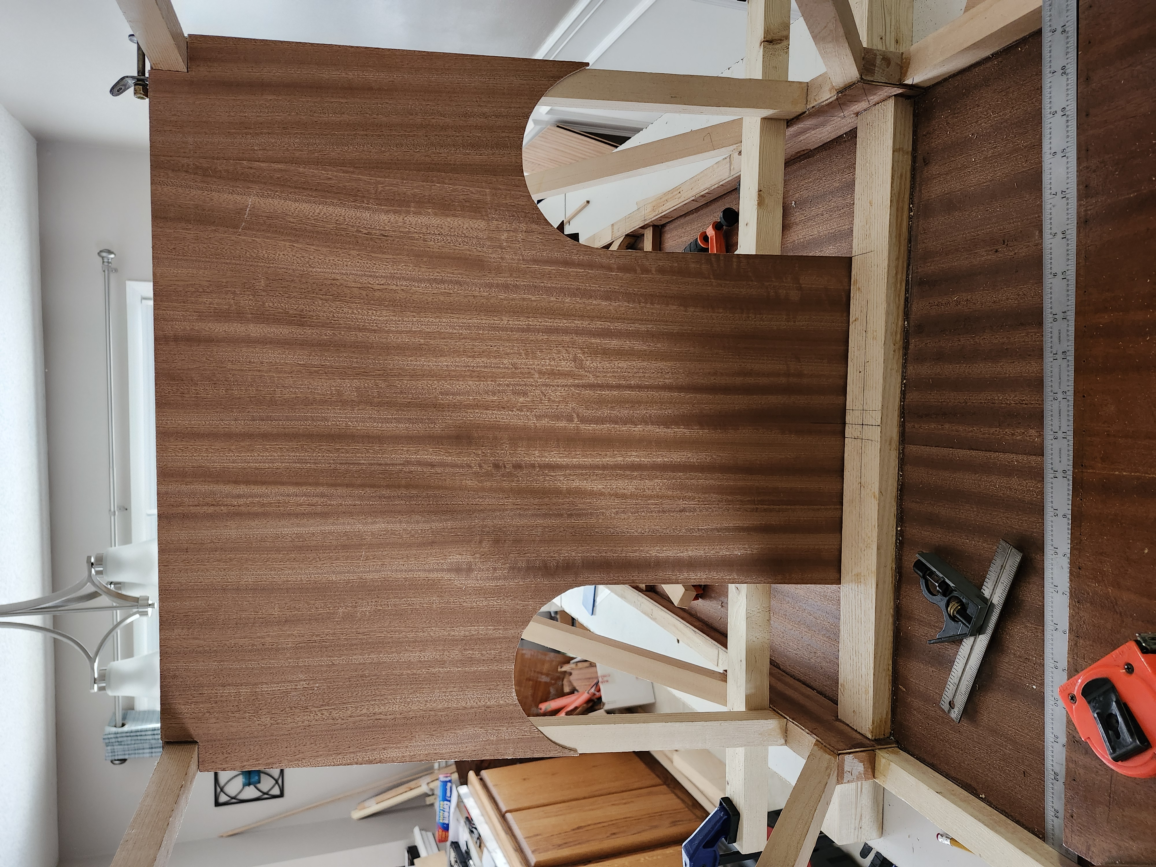

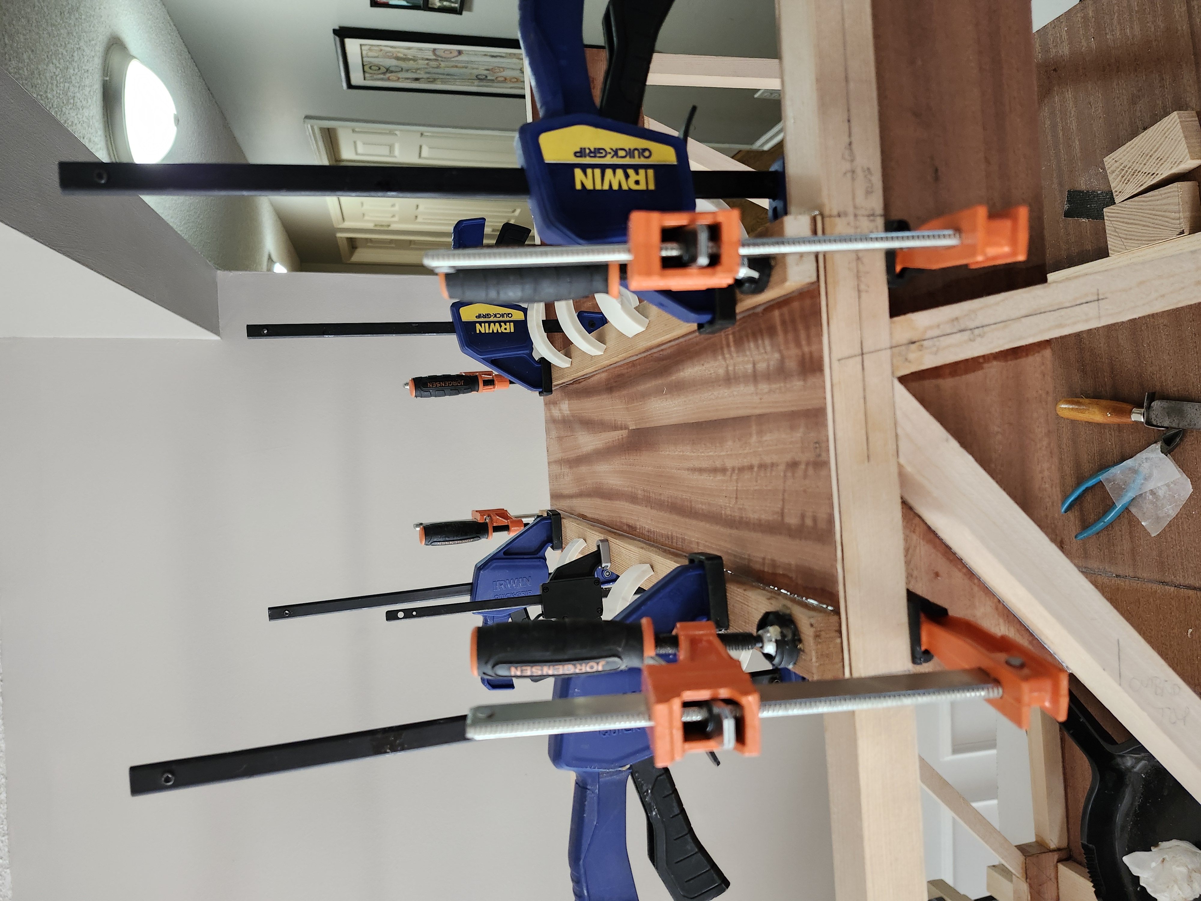

Posts: 348
Re: N34KP's rebuild

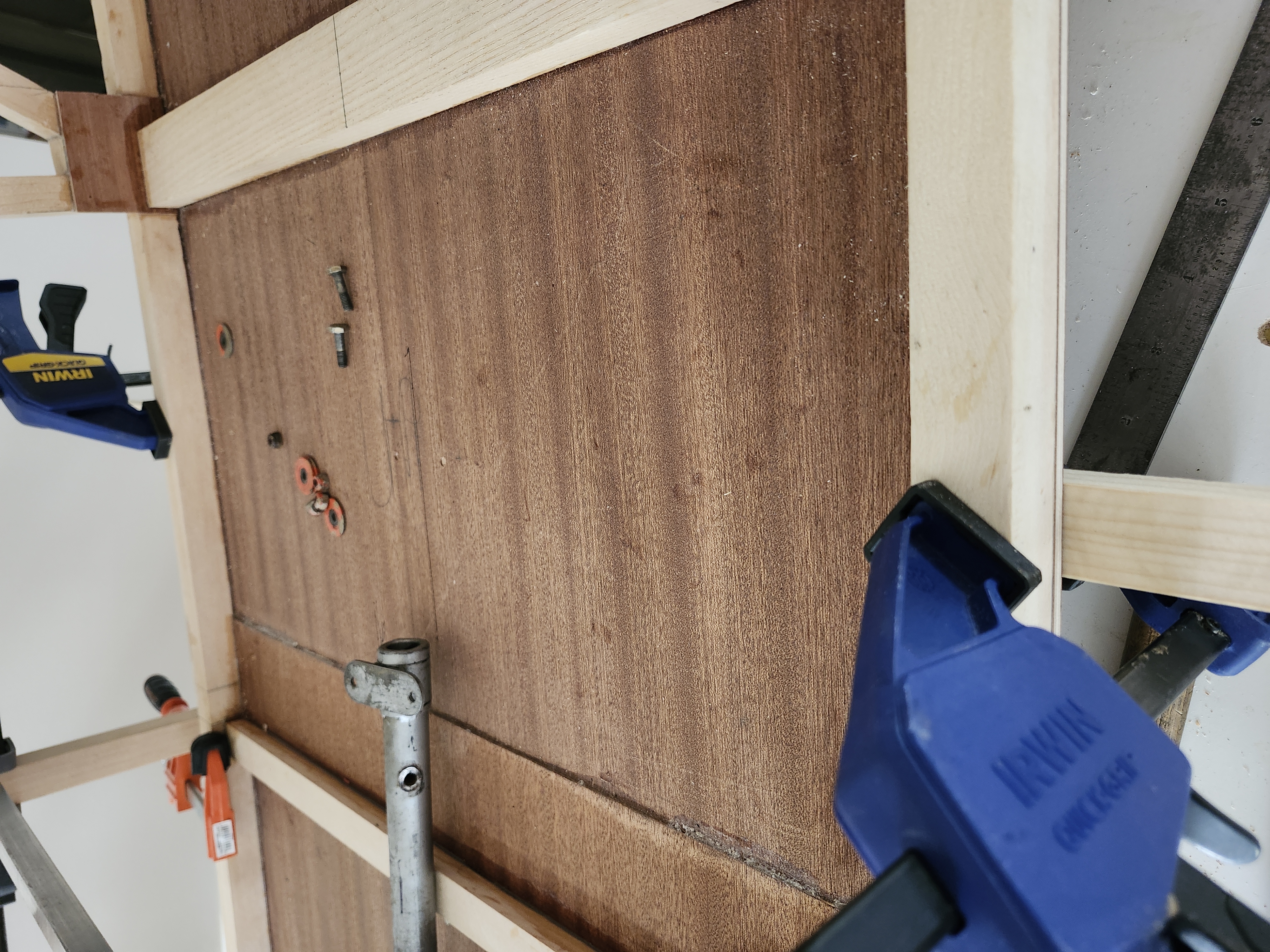

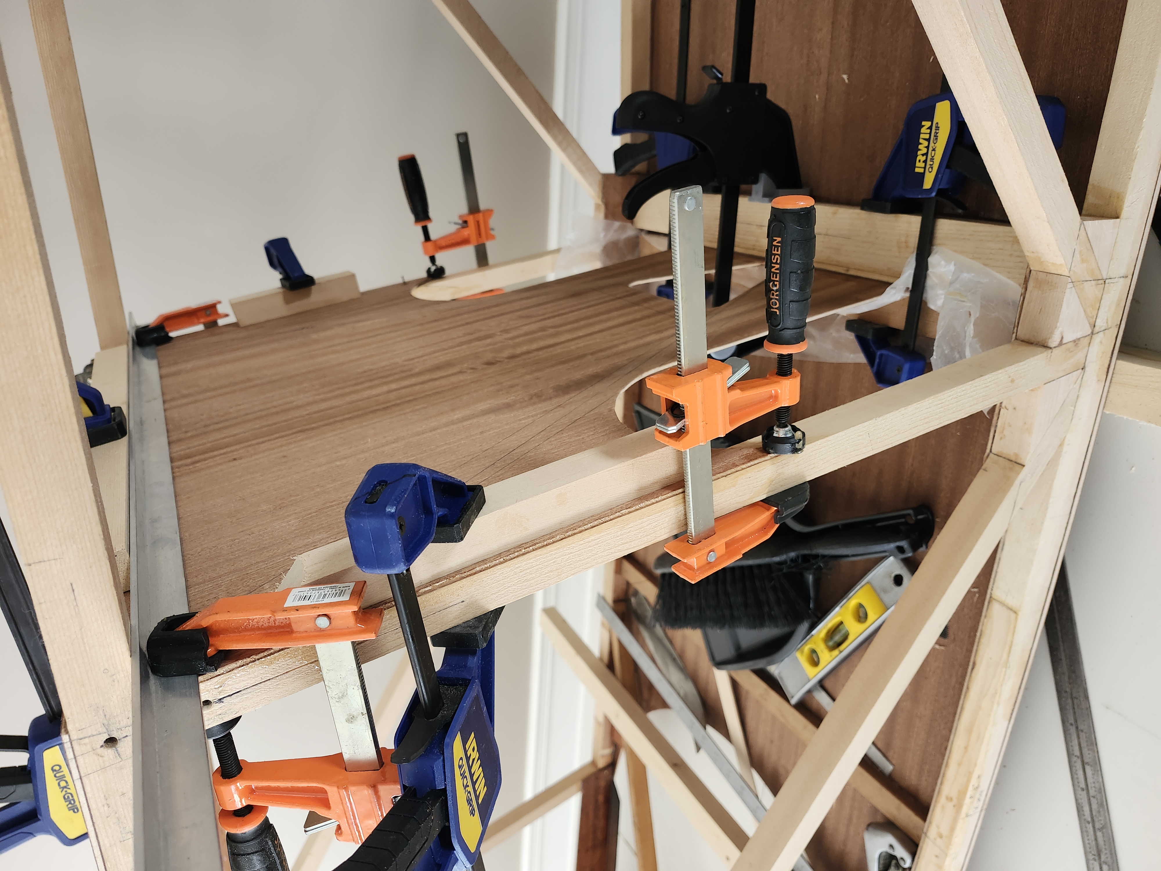

Glued the floor board on just now. No help, that was a busy 30 minutes!
Posts: 713
Re: N34KP's rebuild
They don't call it "working time" for nothing. Spread and smooth on all glue areas for all you're worth... you can feel it starting to get a little tacky... get it into place... lift and shift, align and clamp, unloosen and readjust... hurry! Hurry!. Then it's past the point of no return and you just have to clamp and staple and figure you can shave any little overhangs and squeeze-out later. Don't you love it?

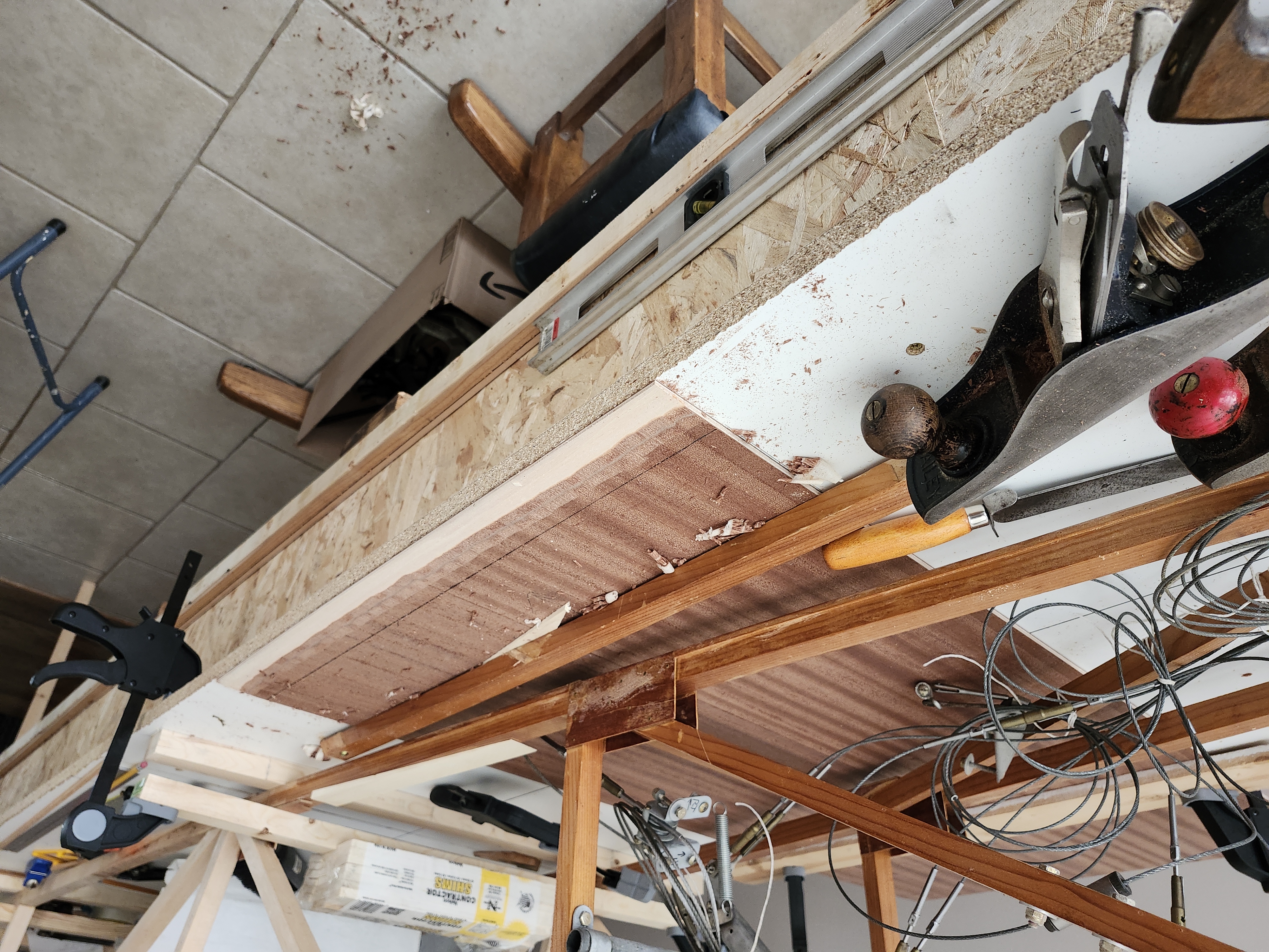

Posts: 348
Re: N34KP's rebuild

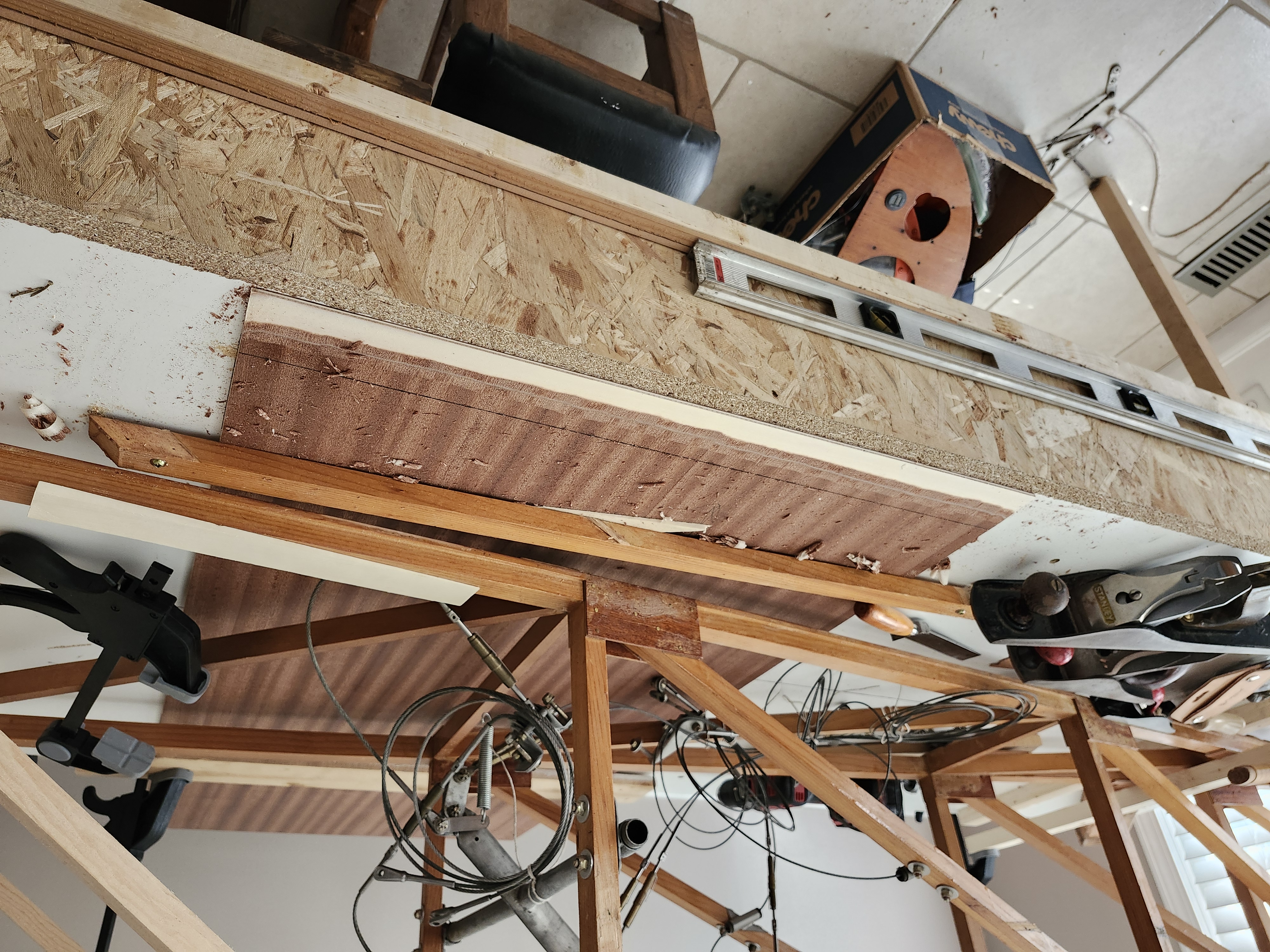

The glue up on the floorboard worked well. I've planed the edges flush and removed the staples. Several staples broke while trying to remove them. Glued in I guess. I'll have to think about this a little.

Post by Chuck in Indiana »
I wonder if you could heat the staple with a soldering iron to soften the epoxy locally?
Posts: 348
Re: N34KP's rebuild
I'm going to ignore the broken staples. They broke off flush with the plywood, and I can't get hold of them short of digging away some of the plywood.

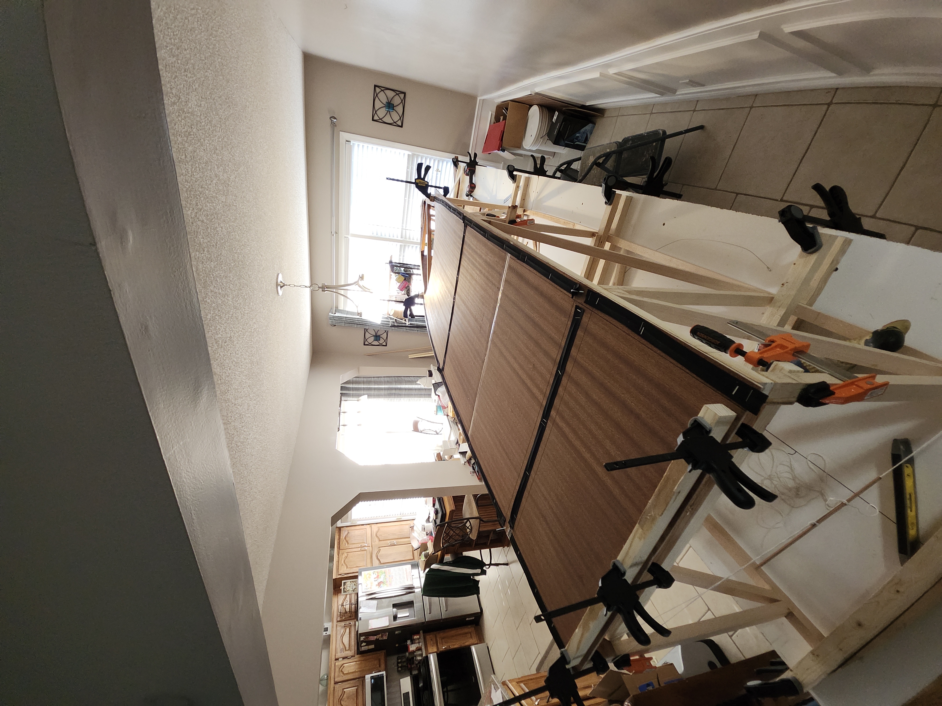

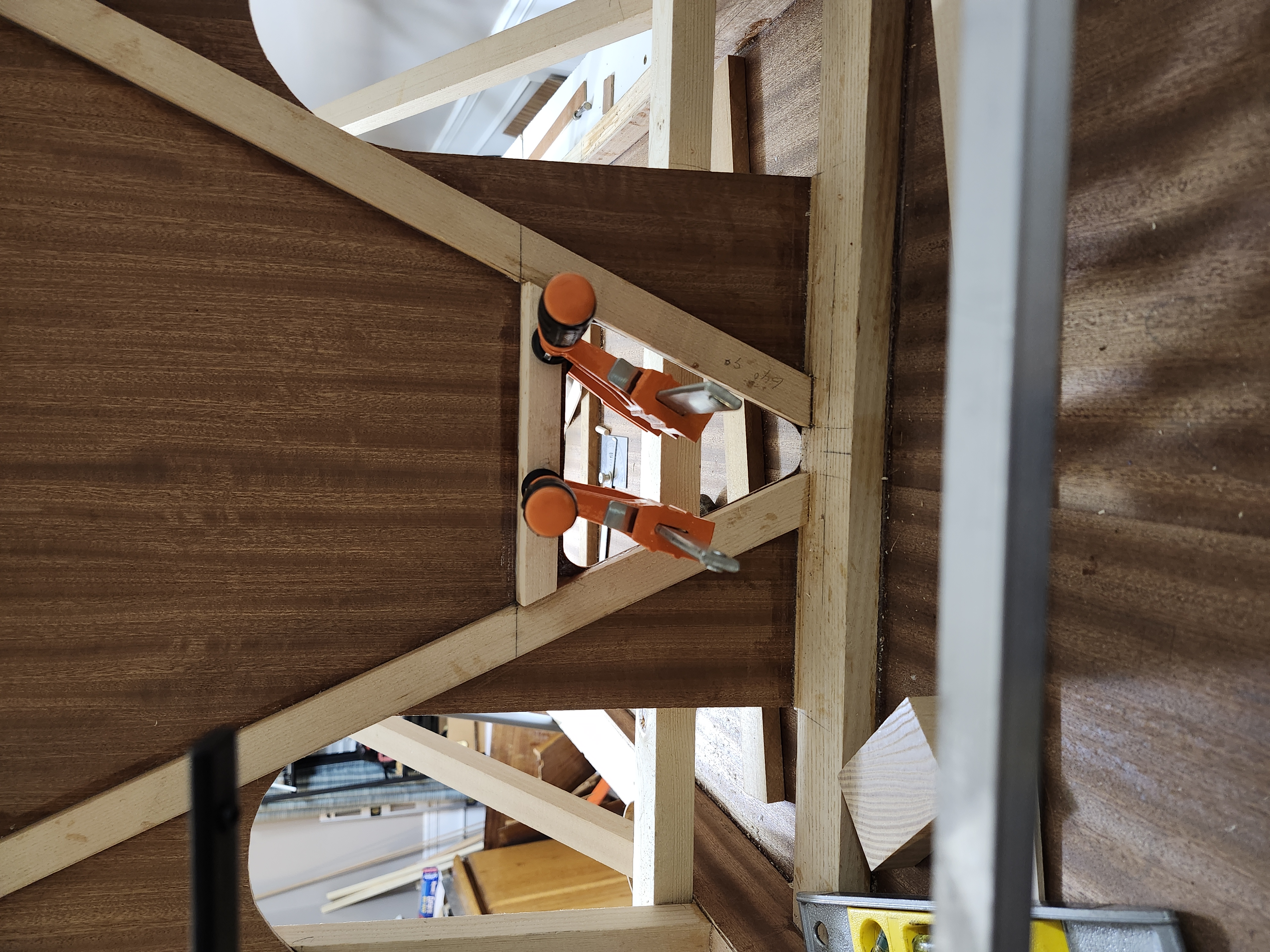

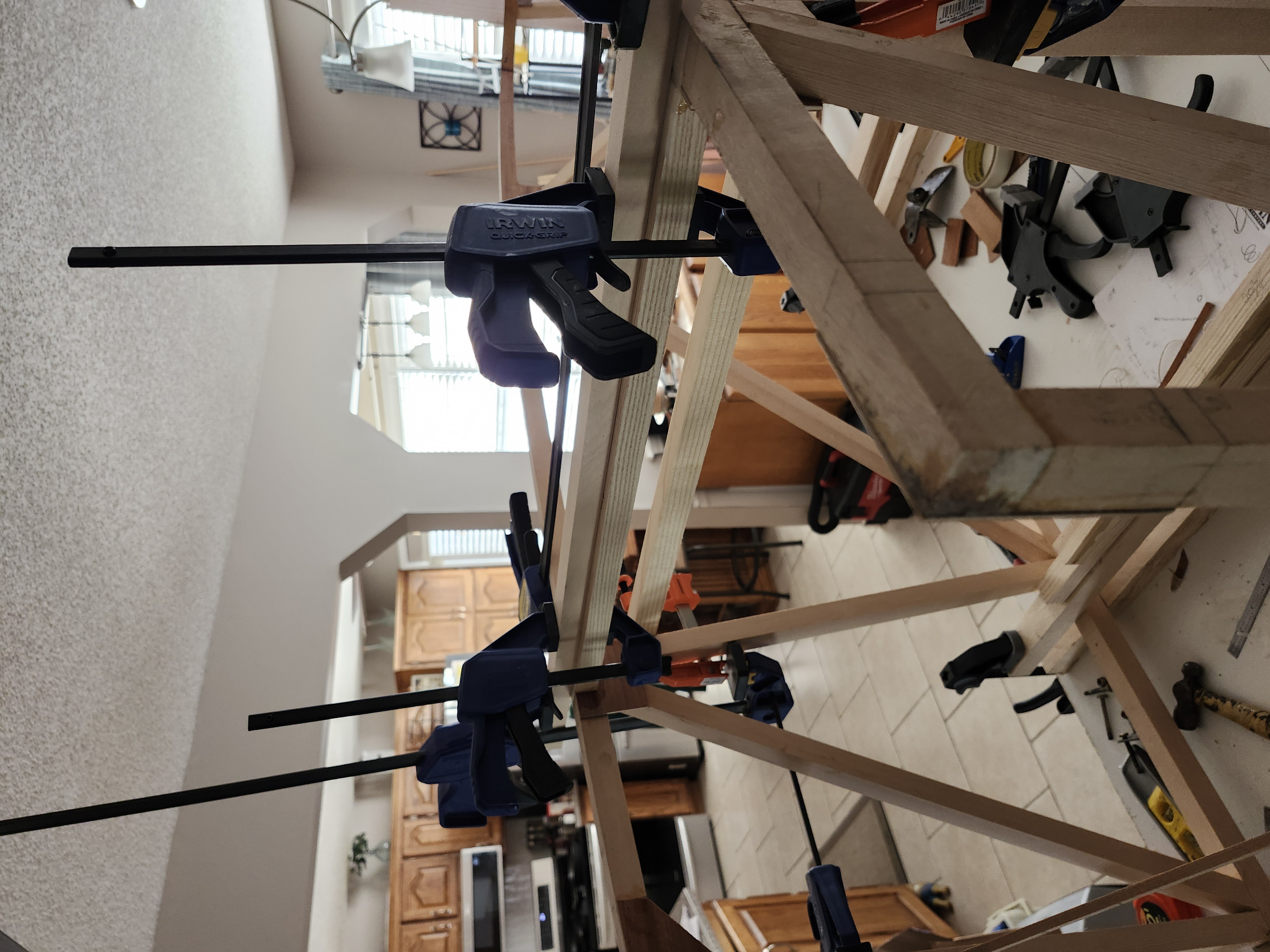

Posts: 348
Re: N34KP's rebuild

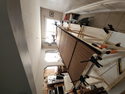

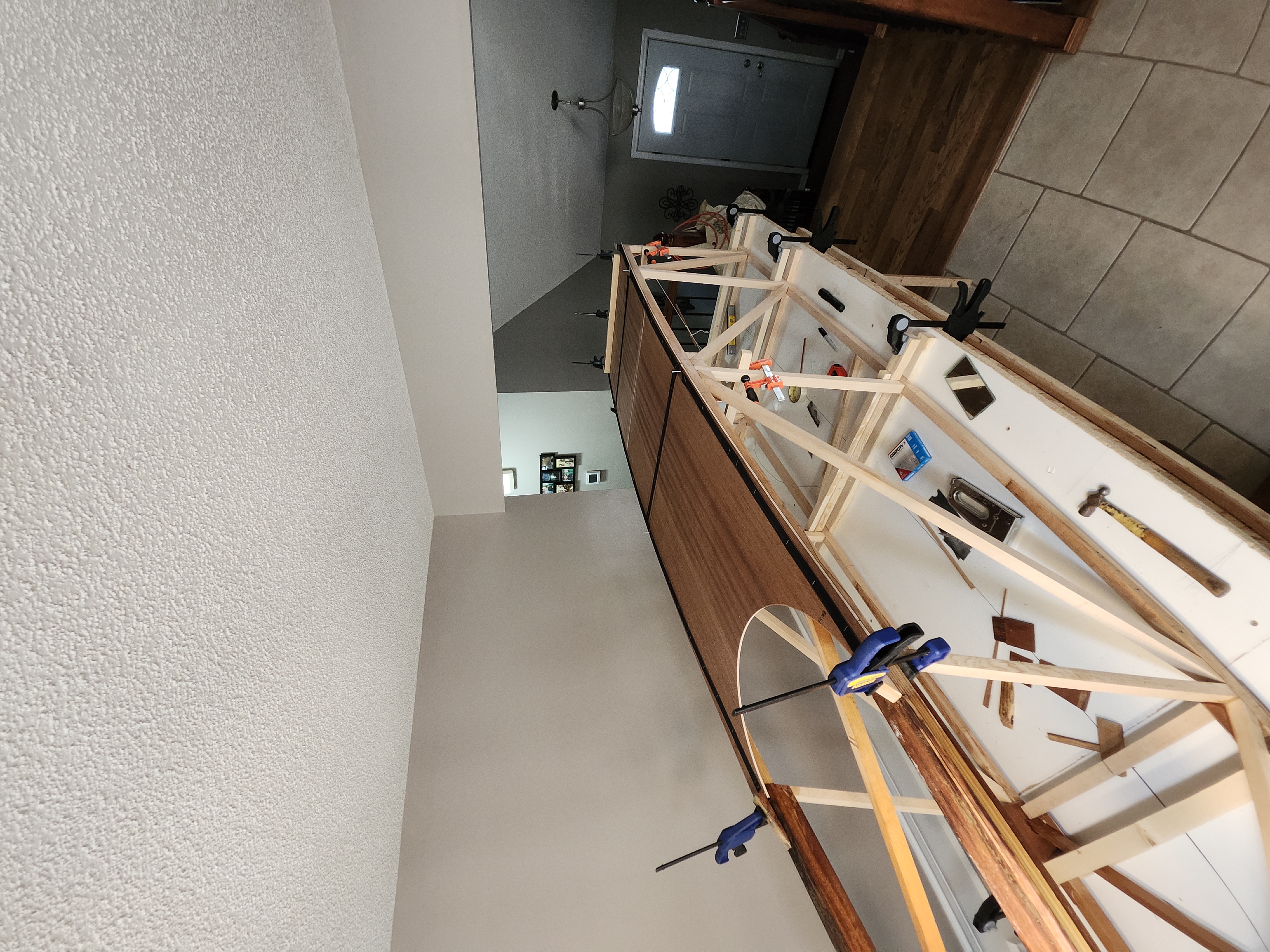

Slow progress. I've flip the fuselage back upright and started the last gussets. Currently glueing the last two inboard splice doublers.

Plugging along.

It's a wonder that the entire world isn't held rigidly in place with gussets. Got to have them!

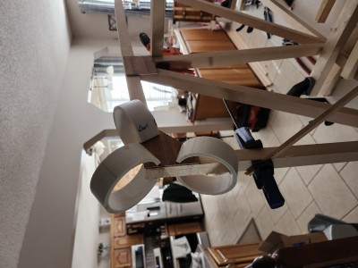

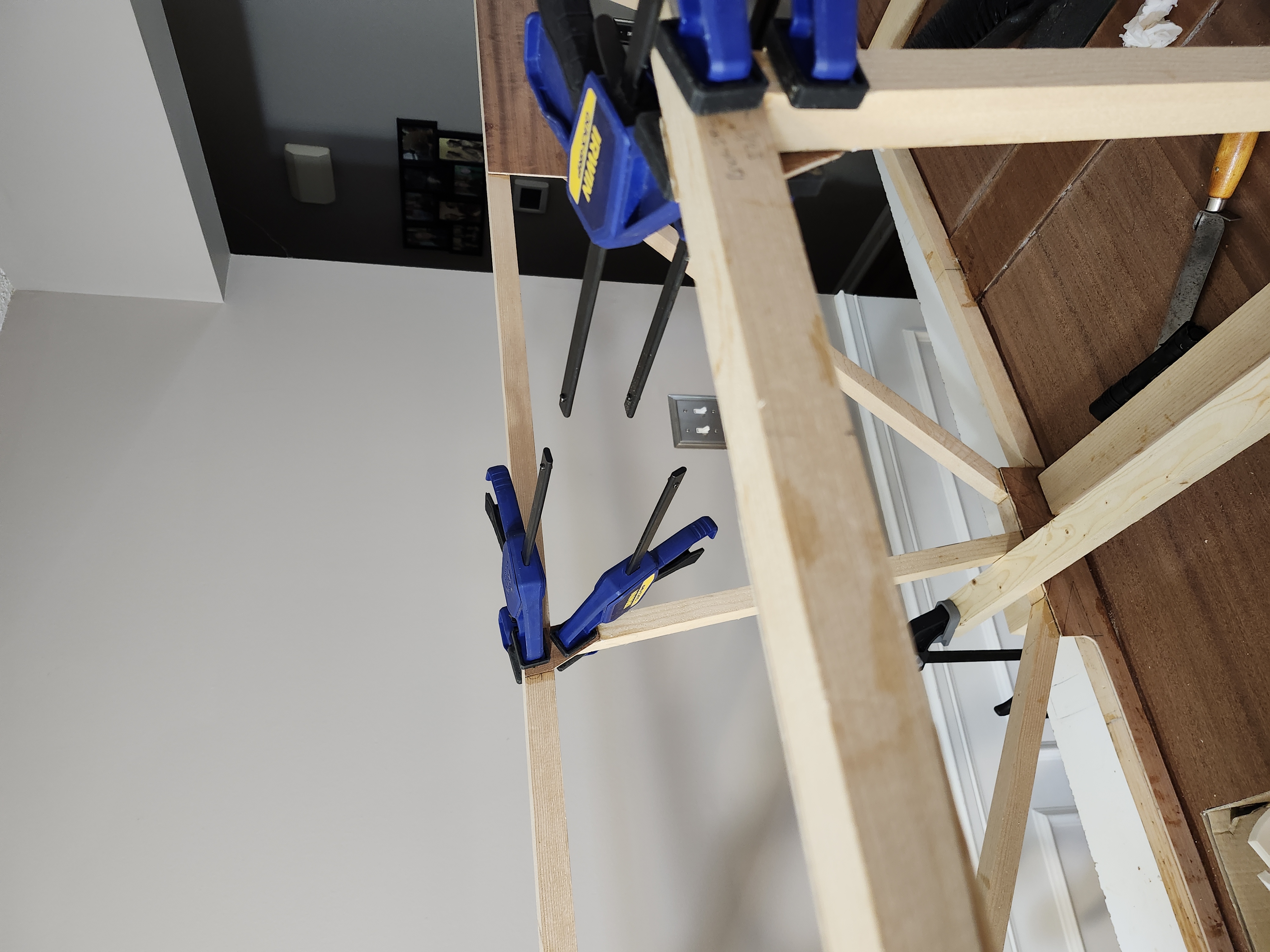

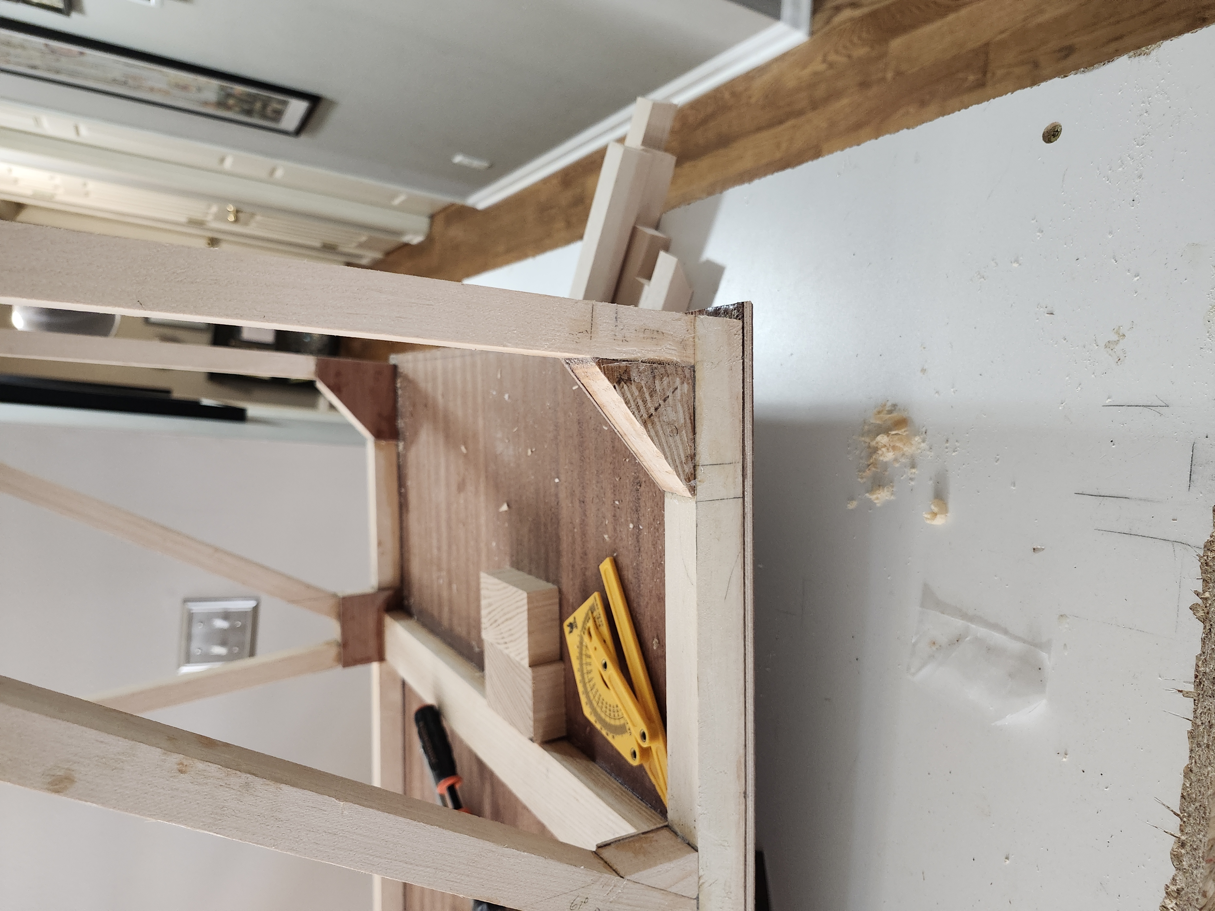

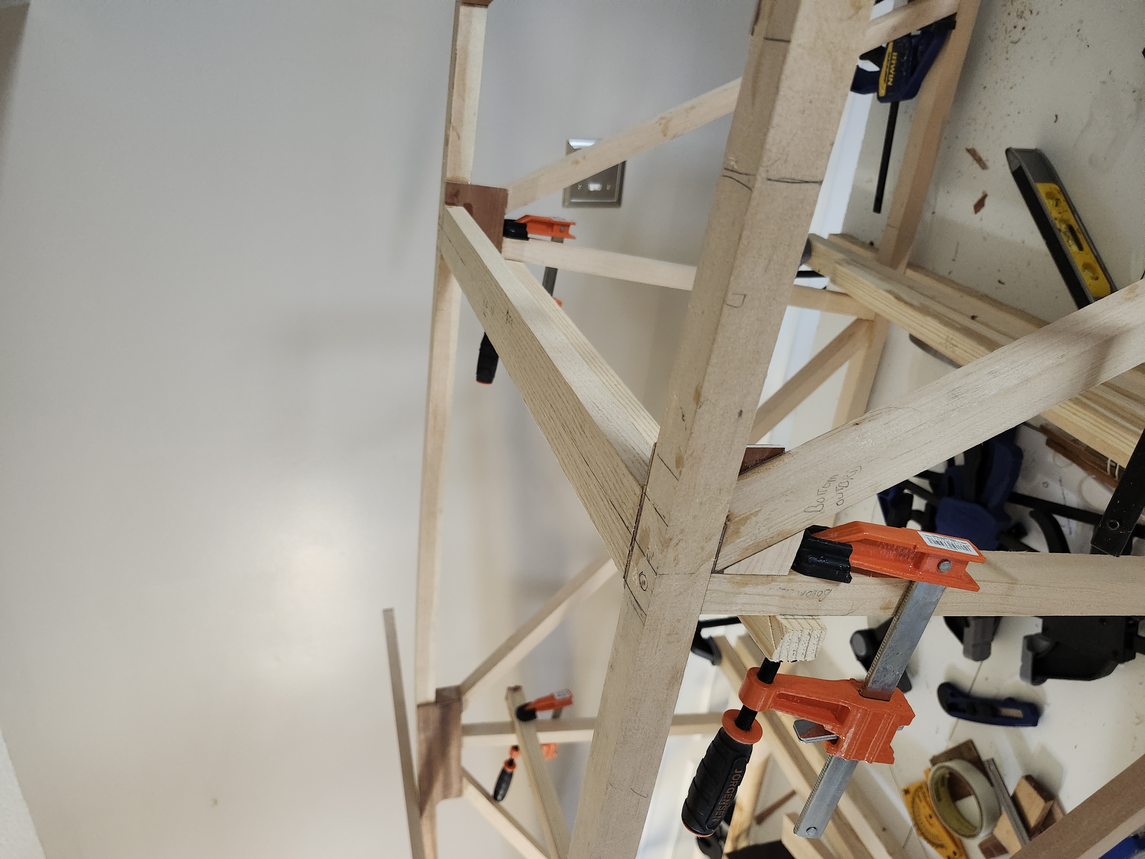

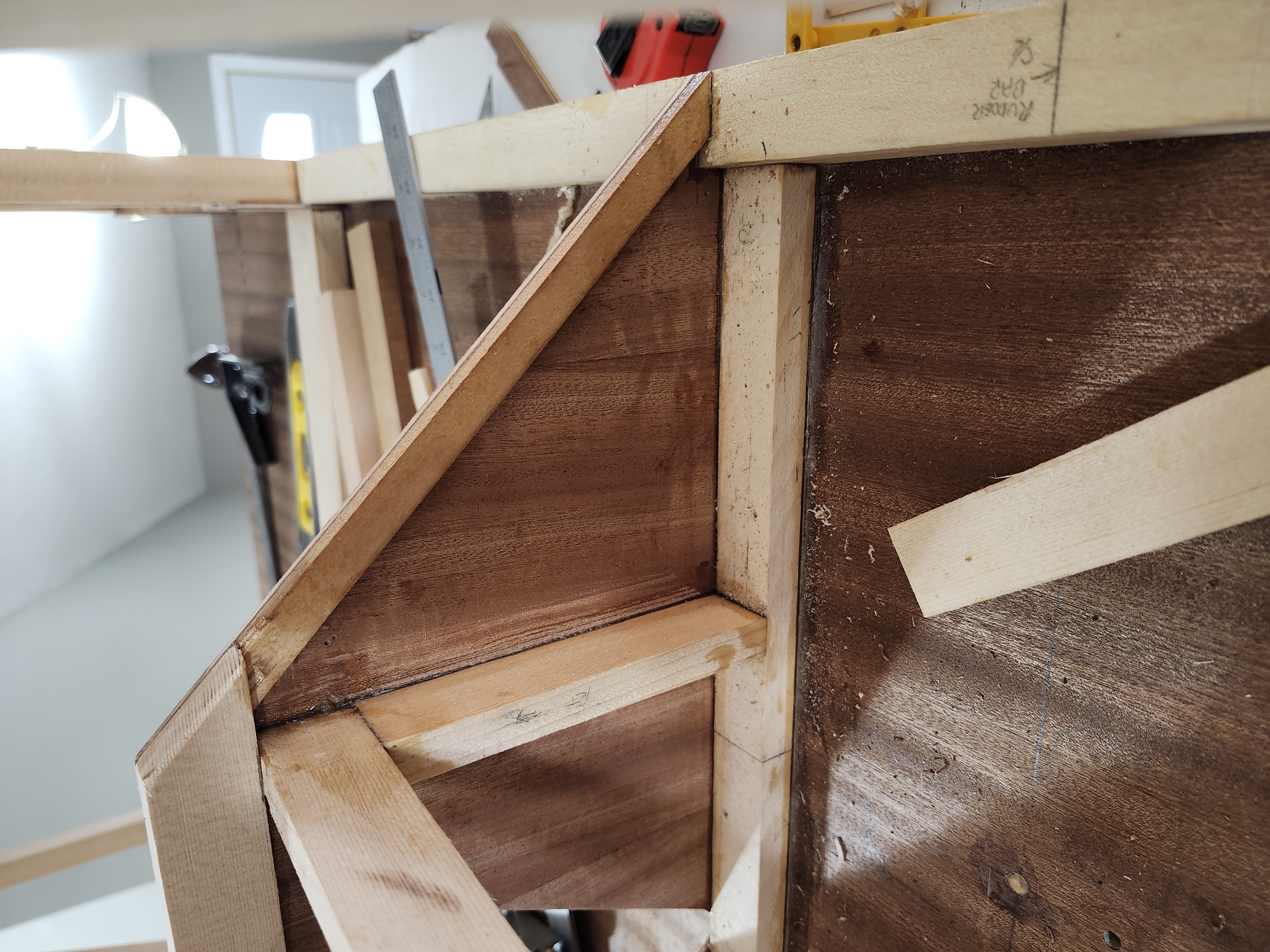

I decided to block the corners of the firewall station truss.

Re: N34KP's rebuild
I'll bet that fuselage frame is stiffening up nicely, what with the blocking and crosspieces and gussets getting installed. One of the most comforting things about a Piet is the robustness of its basic structural 'cage'.

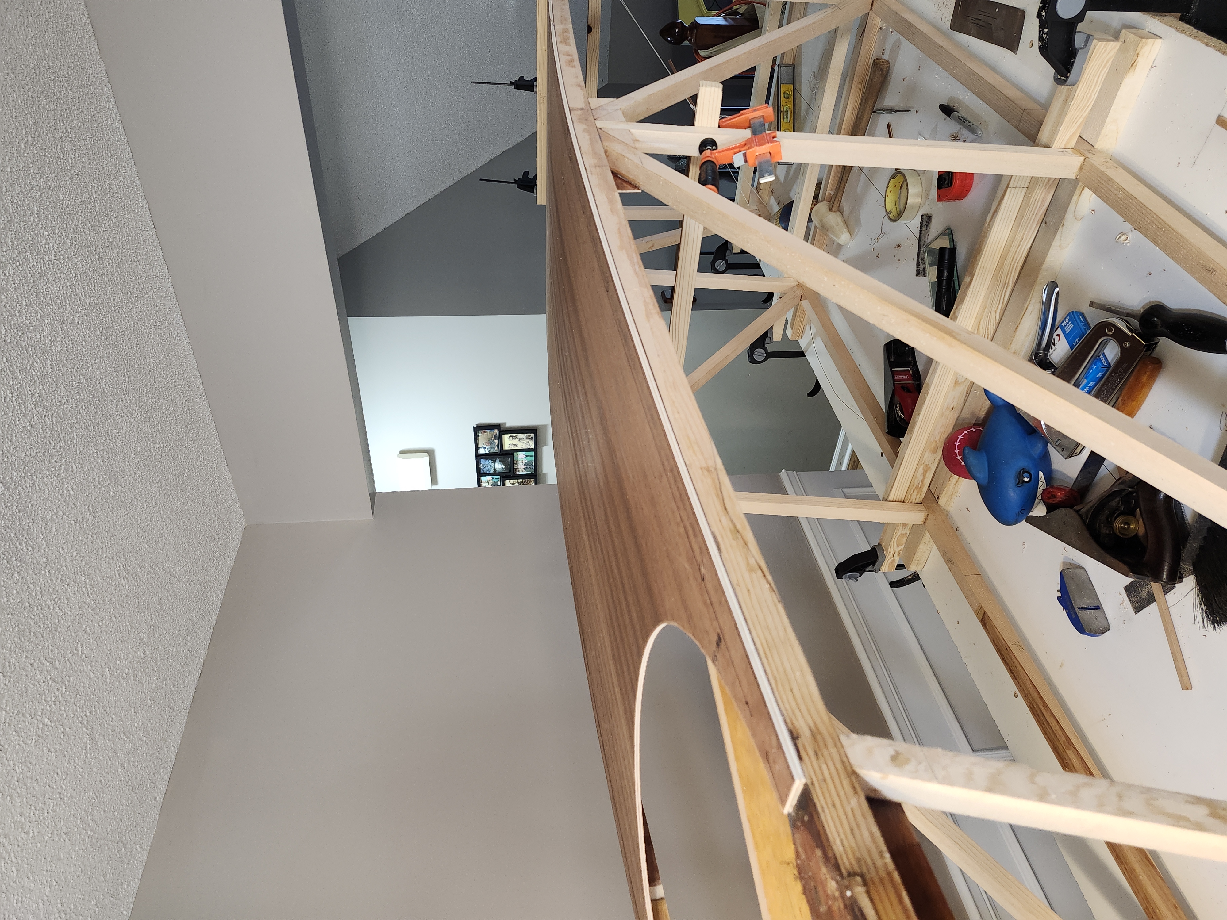

Re: N34KP's rebuild
Yes. It's getting pretty sturdy even without the side plywood.

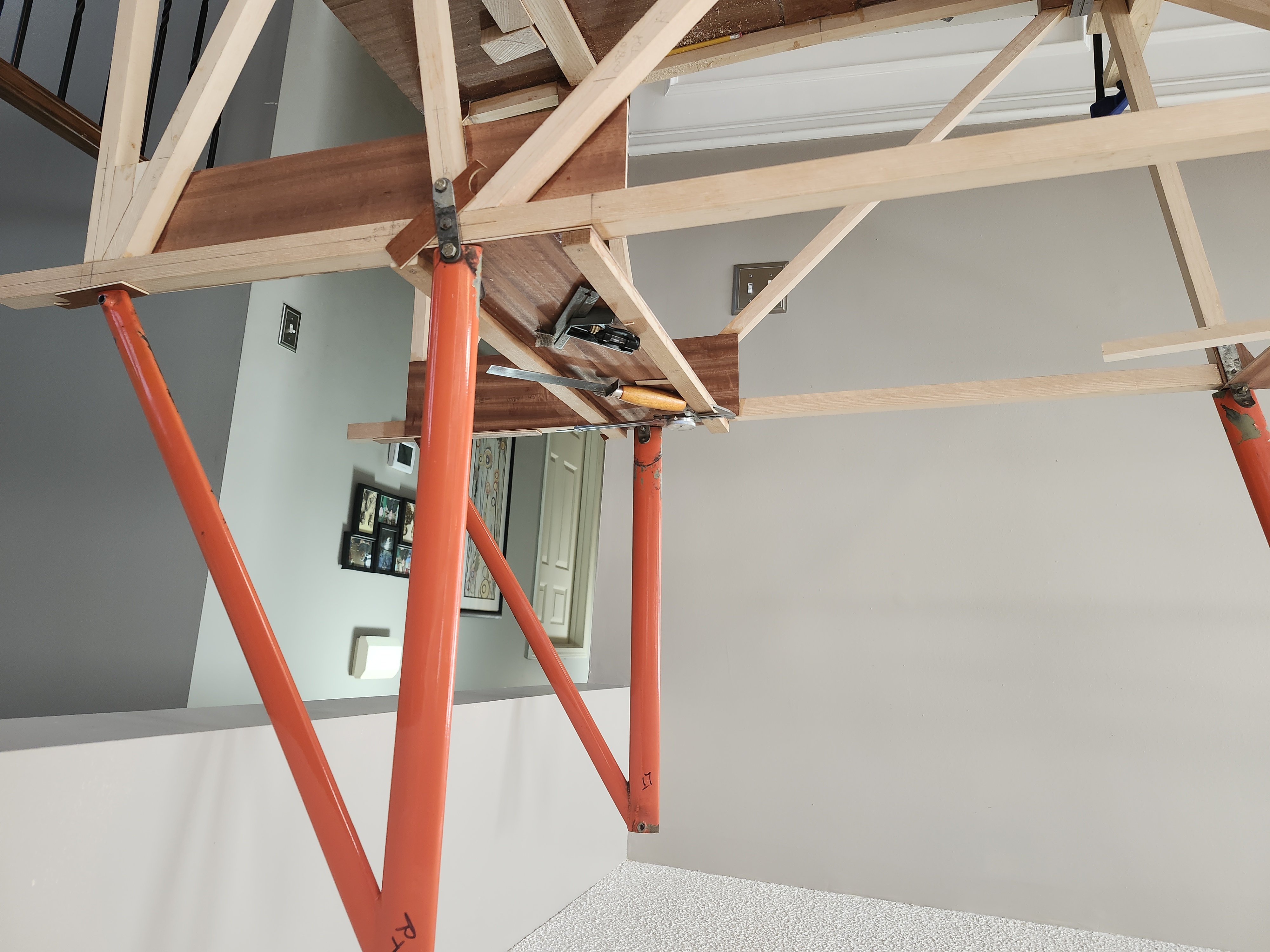

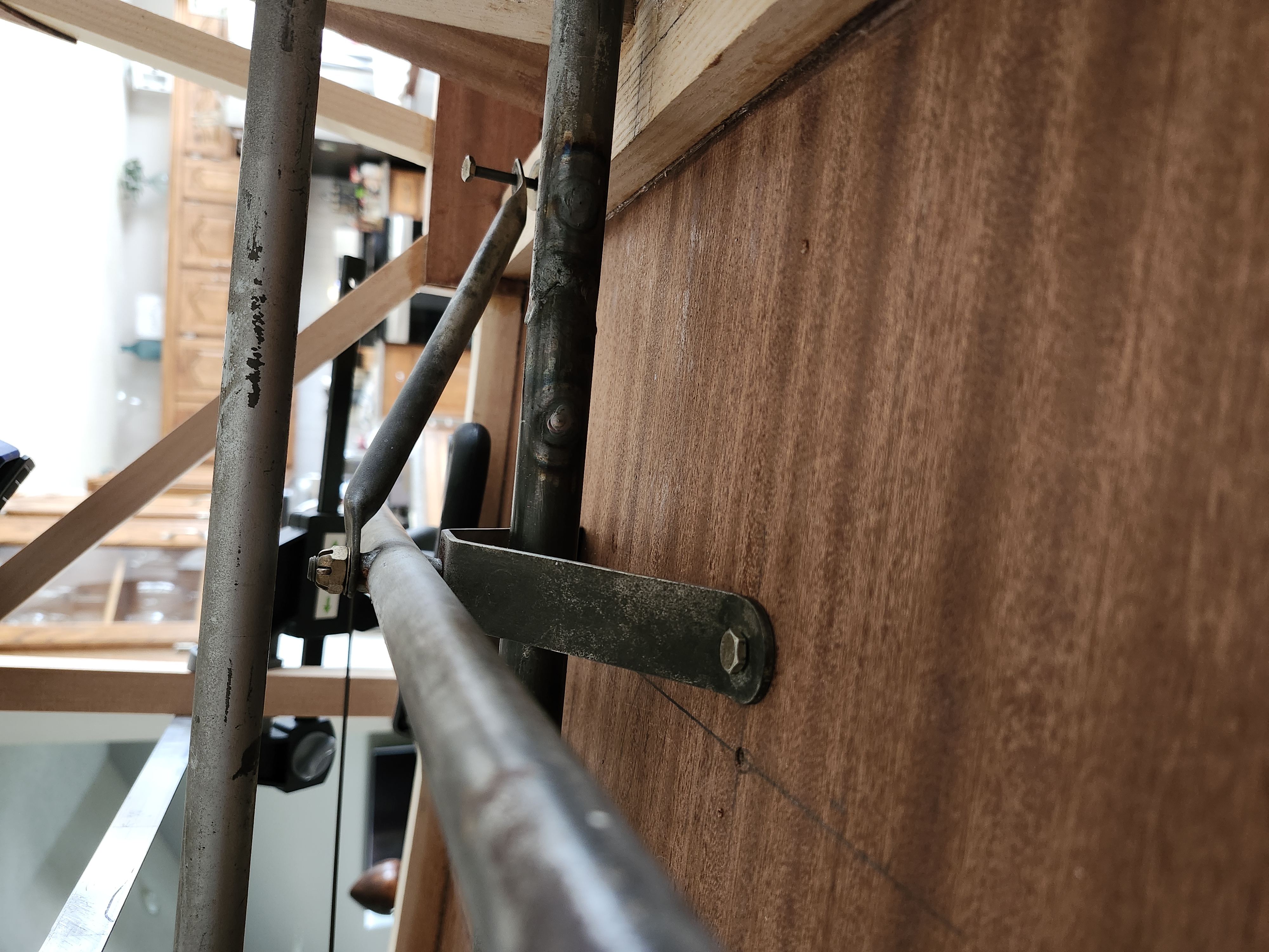

While test fittings controls today, I discovered the aileron torque tube between cockpits was bent a little in the crash. Always something.

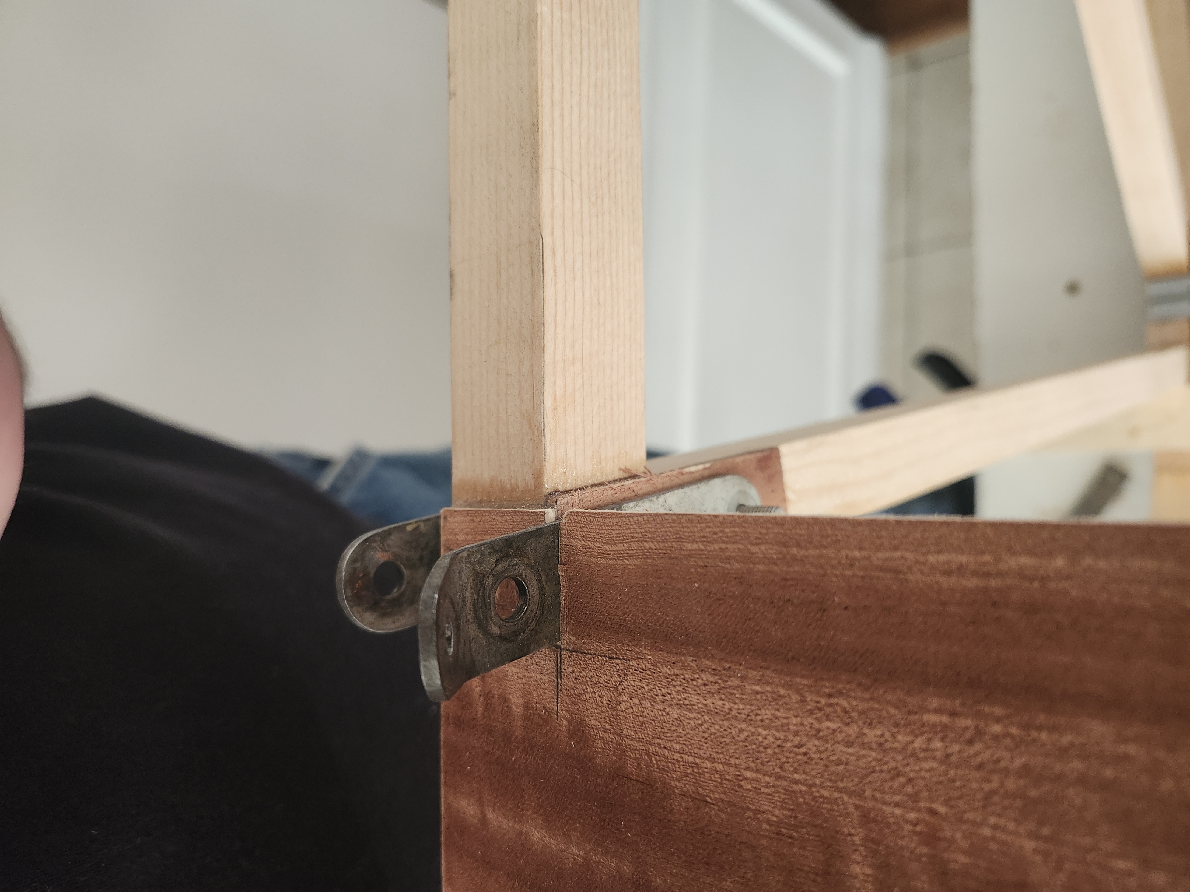

Re: N34KP's rebuild

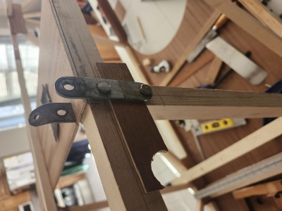

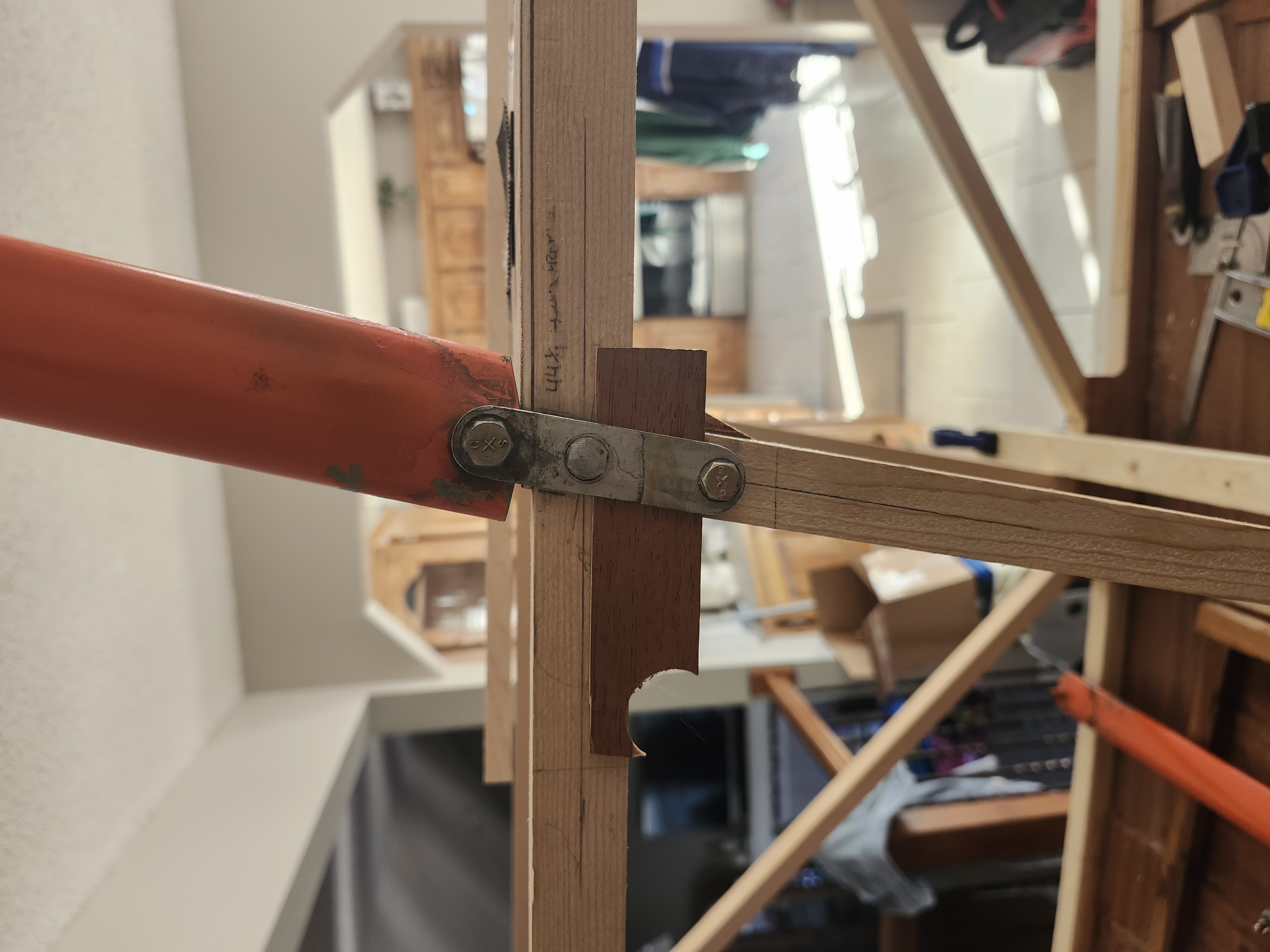

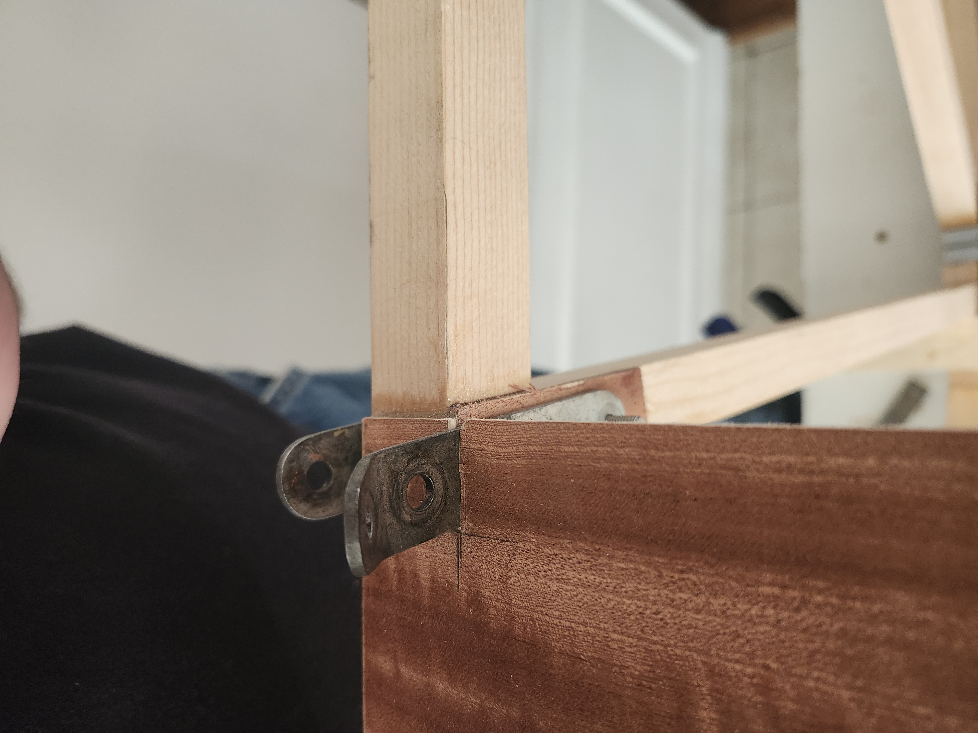

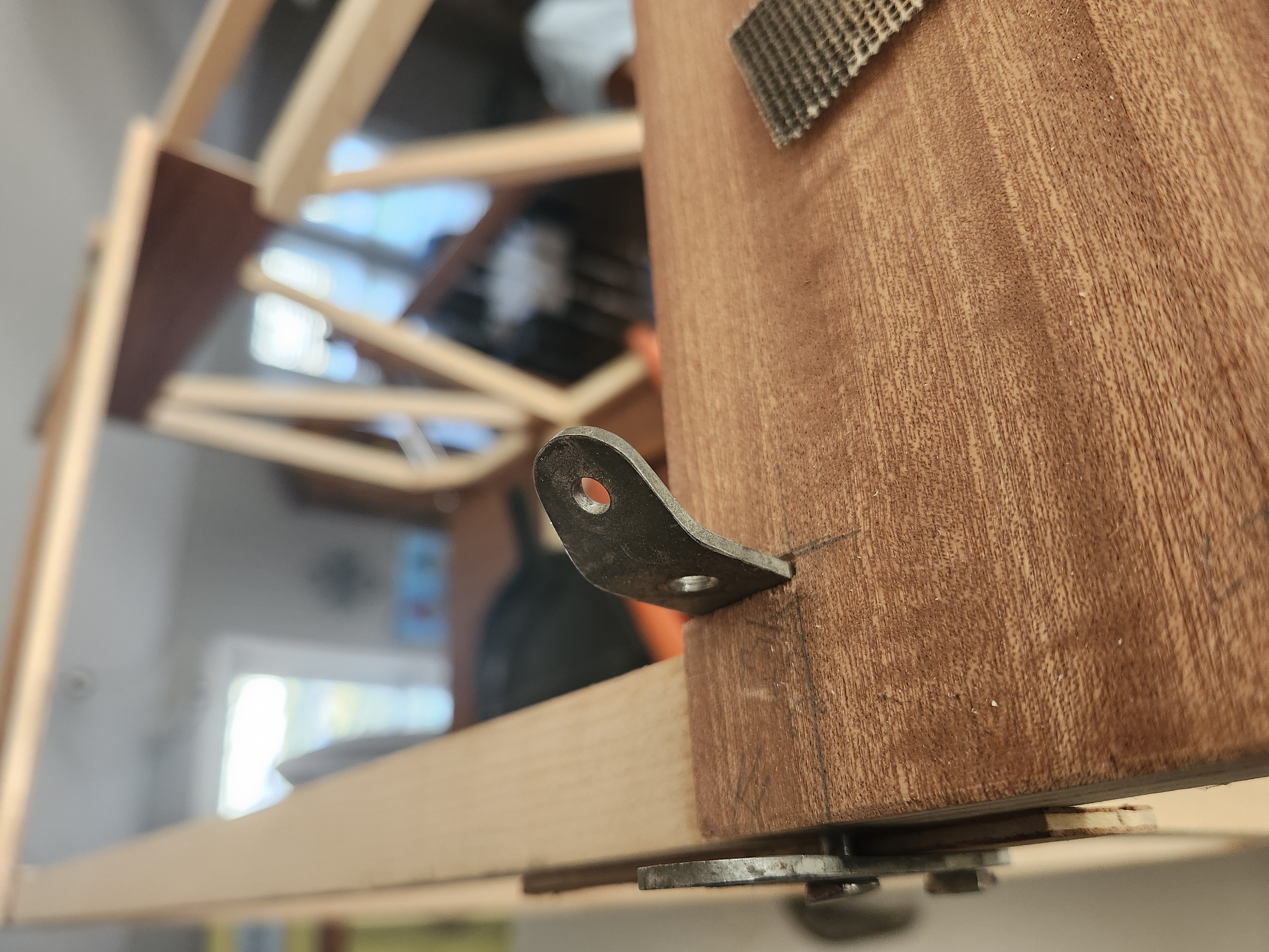

Test fitting rear cabane attach fittings in the upper longerons. Nice fit.
Posts: 348
Re: N34KP's rebuild
Test fitting cabane attach fittings in the upper longerons. Nice fit.

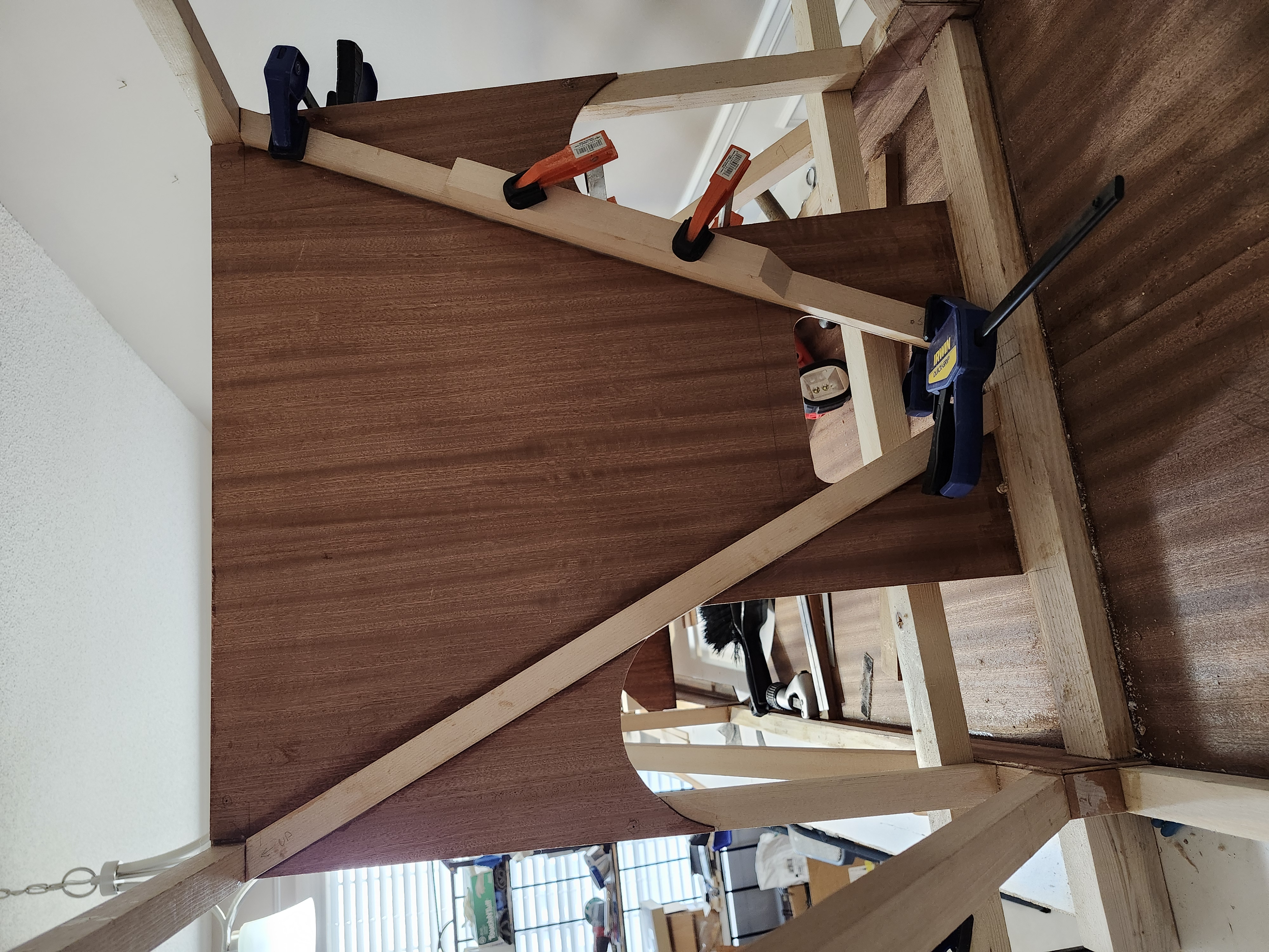

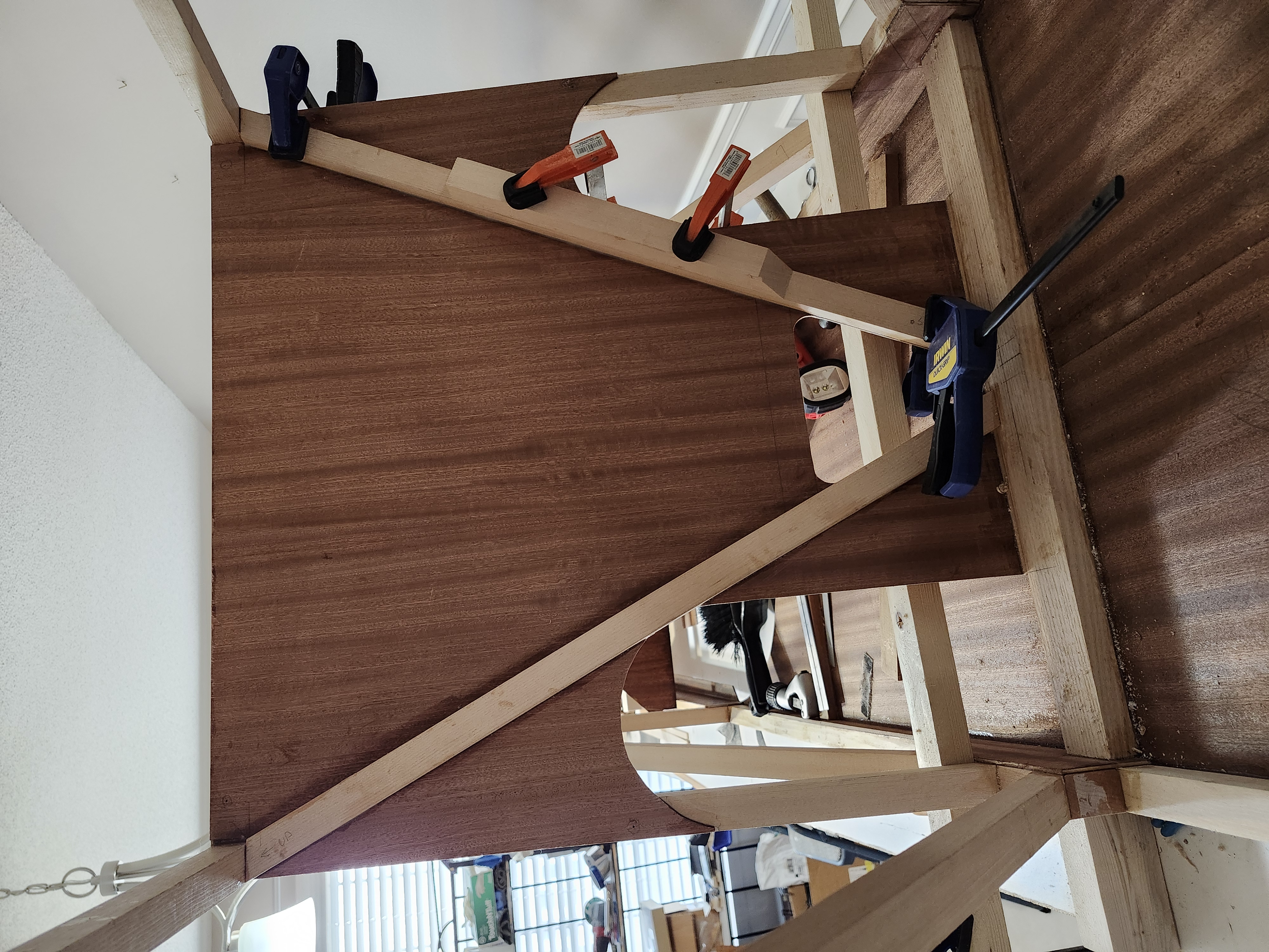

Posts: 348

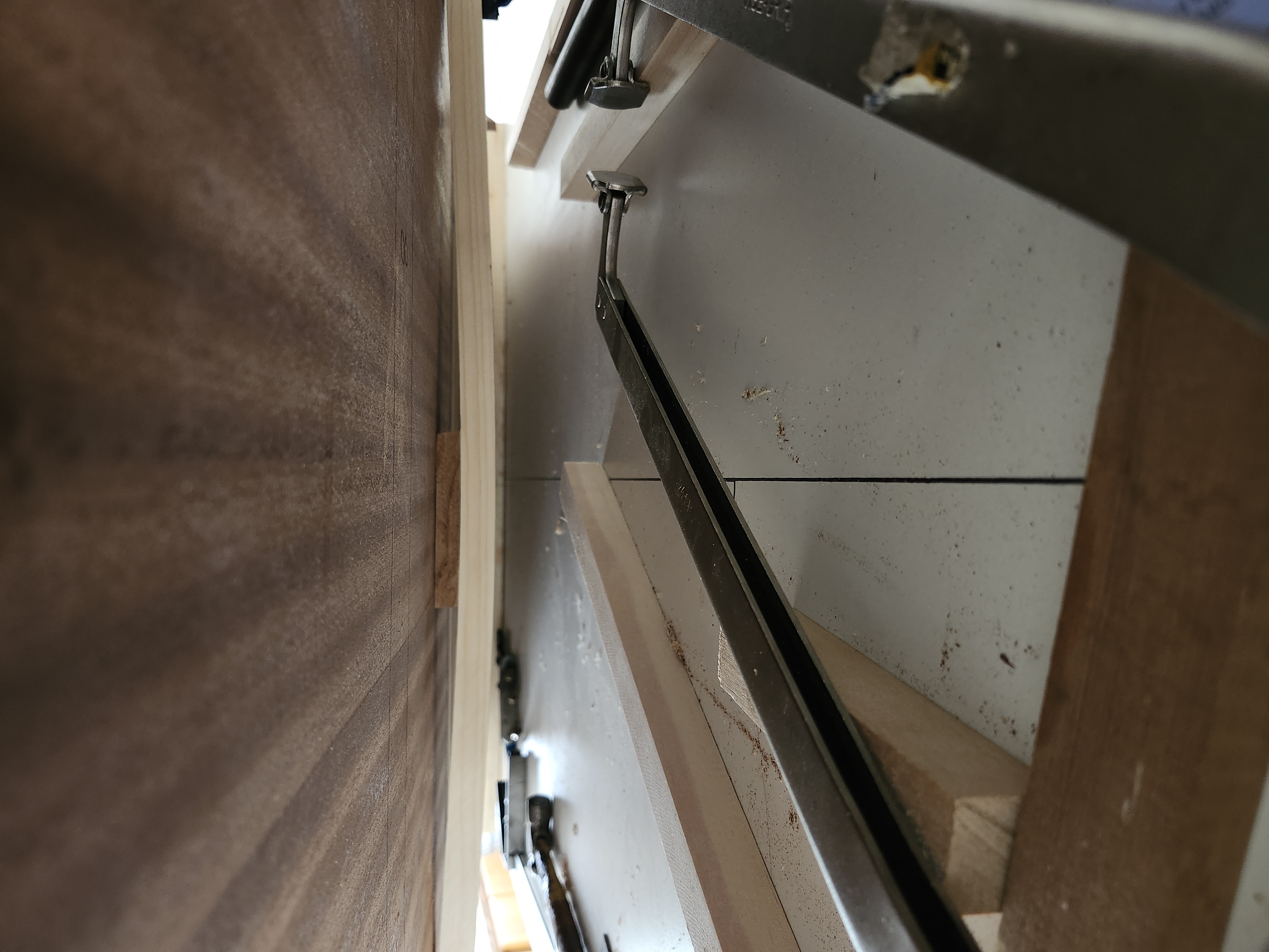

Re: N34KP's rebuild

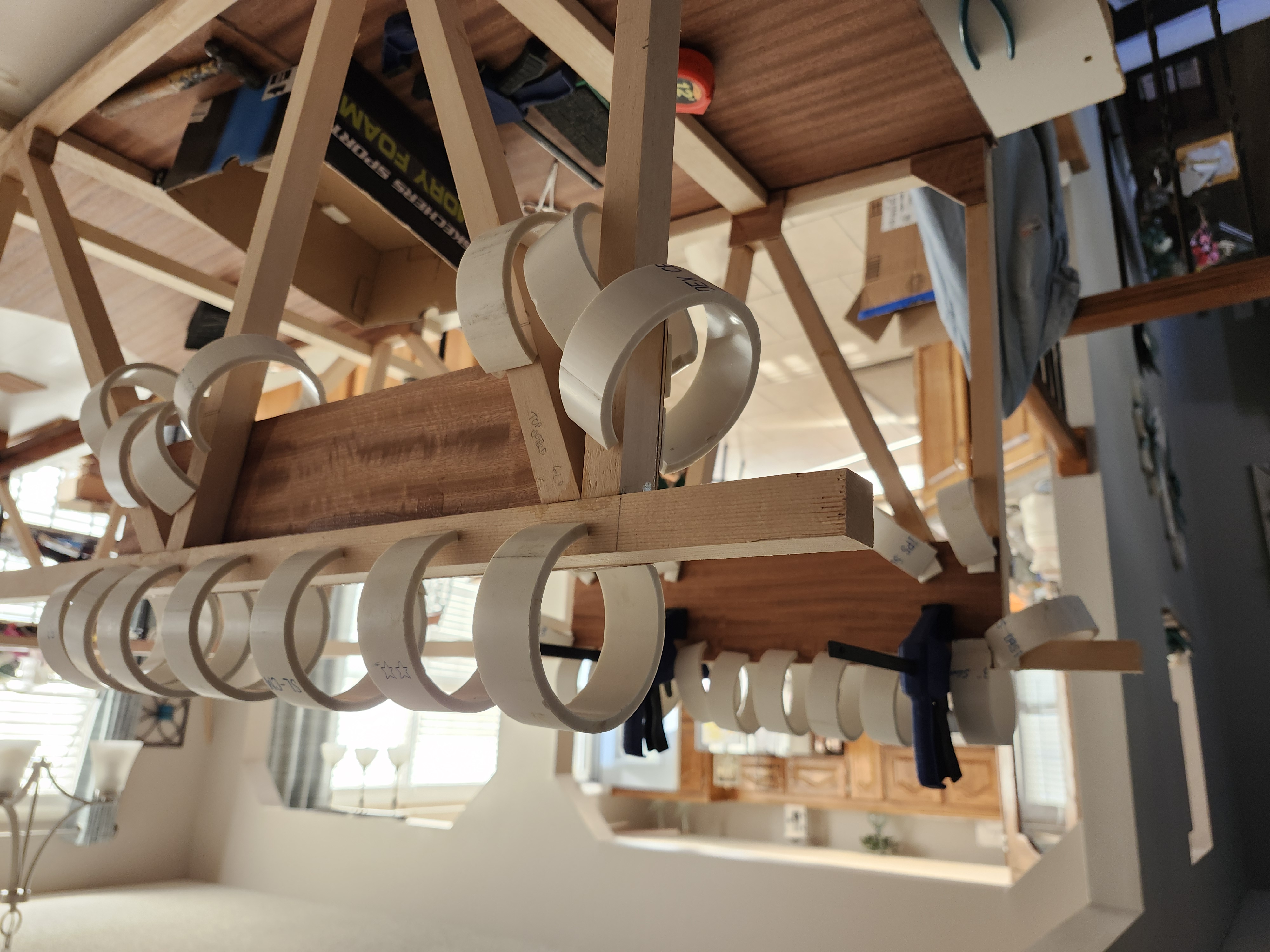

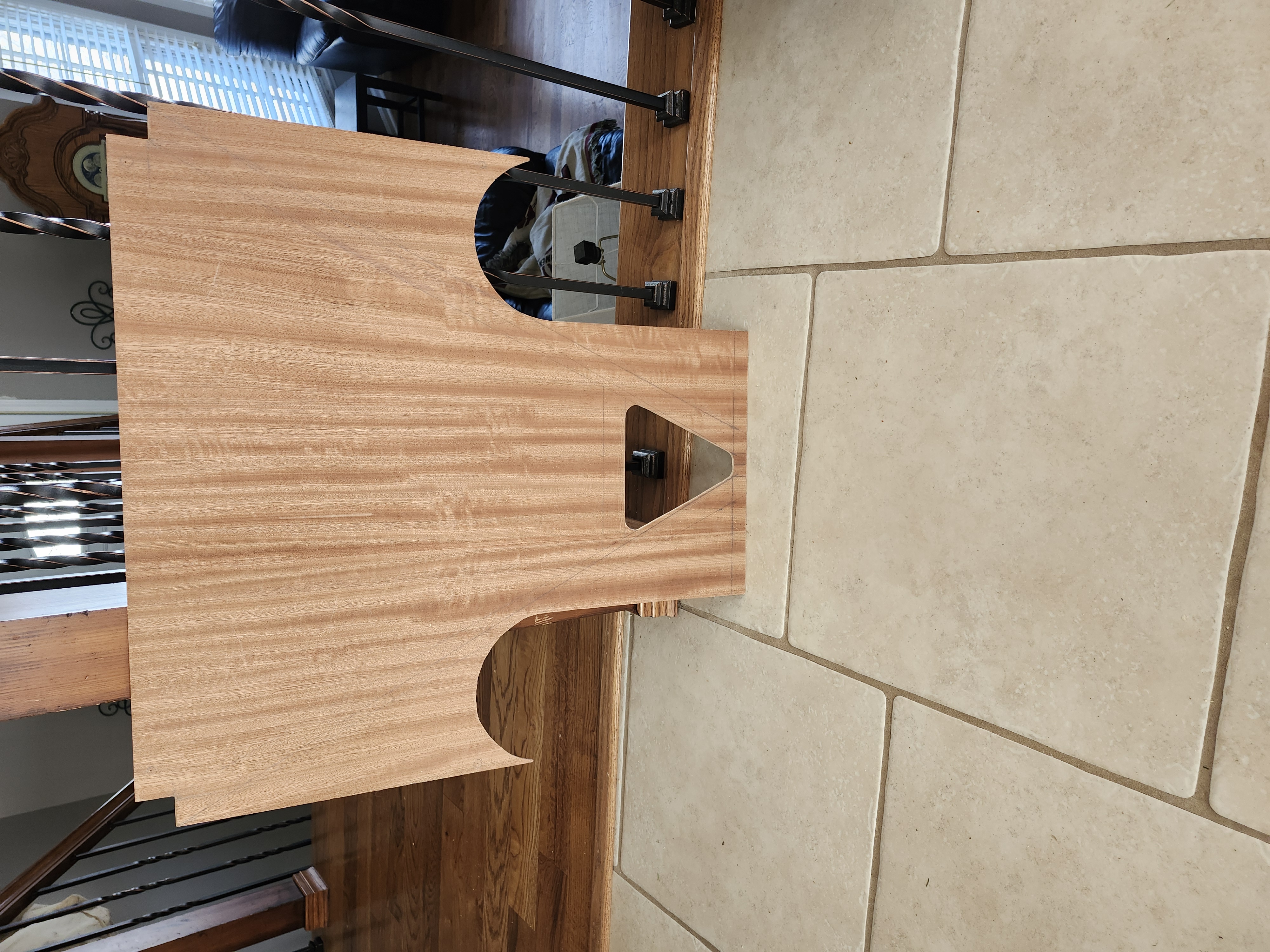

Test fitting the front cockpit seat back.
Posts: 348
Re: N34KP's rebuild
I glued a wedge into the area of the seat back to the gear/liftstrut carry though. Also cutout the torque tube opening.
Posts: 713
Re: N34KP's rebuild
Richard; the area that I had some problems with over the years that I flew N41CC was the front seat's front face vertical support plywood. On more than one occasion it got kicked by the pilot hard enough to break the plywood free (not by me though). I finally ended up tearing out the entire assembly including the passenger's seat bottom, which didn't have adequate uprights to hold it up, in my opinion. Especially as I had a passenger over 200 lbs get in and out of the front by stepping onto the seat. It didn't give under his weight and strain to climb in, but I didn't want it to. For the front face plywood, I added a block outside the front face of it, secured to the floor.
Posts: 348
Re: N34KP's rebuild
Glued up and curing.
Posts: 348
Re: N34KP's rebuild
Done.
Posts: 713
Re: N34KP's rebuild
I see that little wedge shim filler at the bottom ;) Nice work.

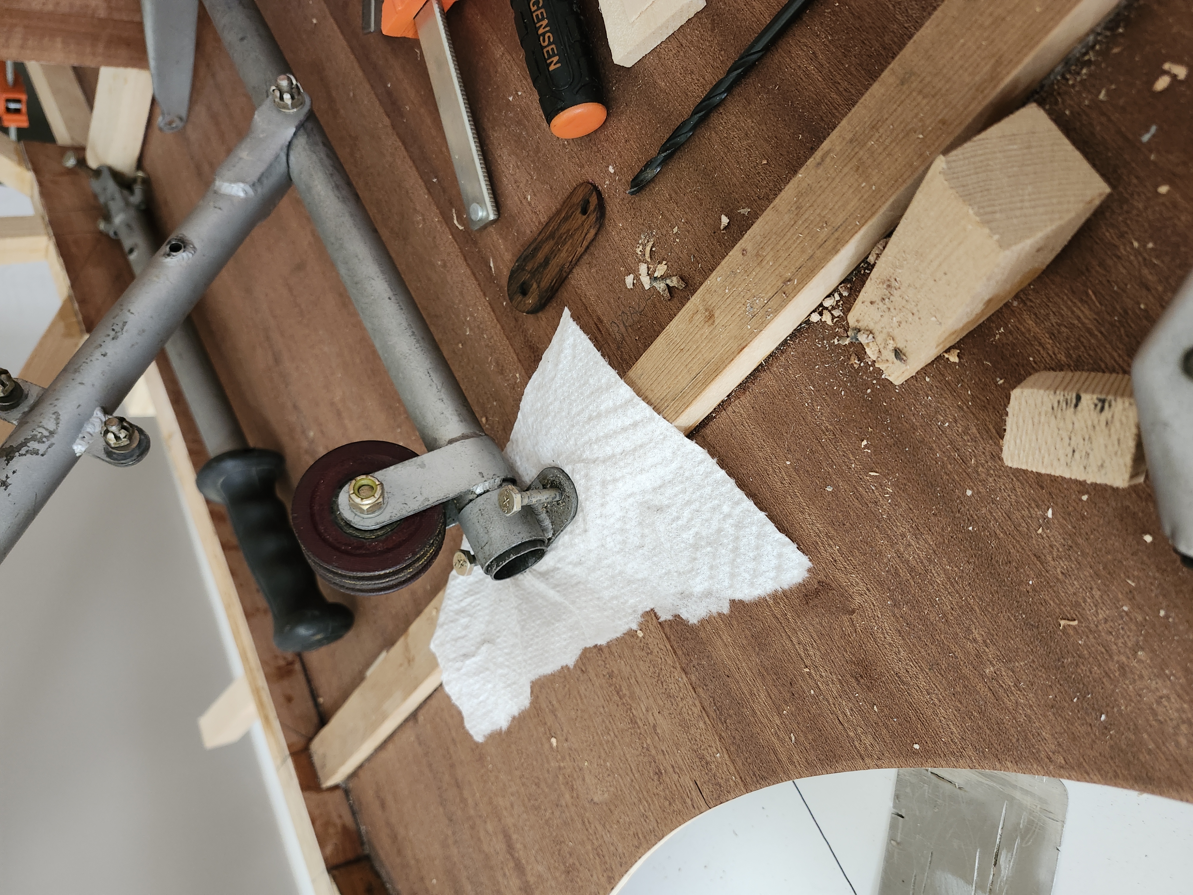

Posts: 348
Re: N34KP's rebuild

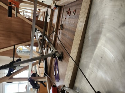

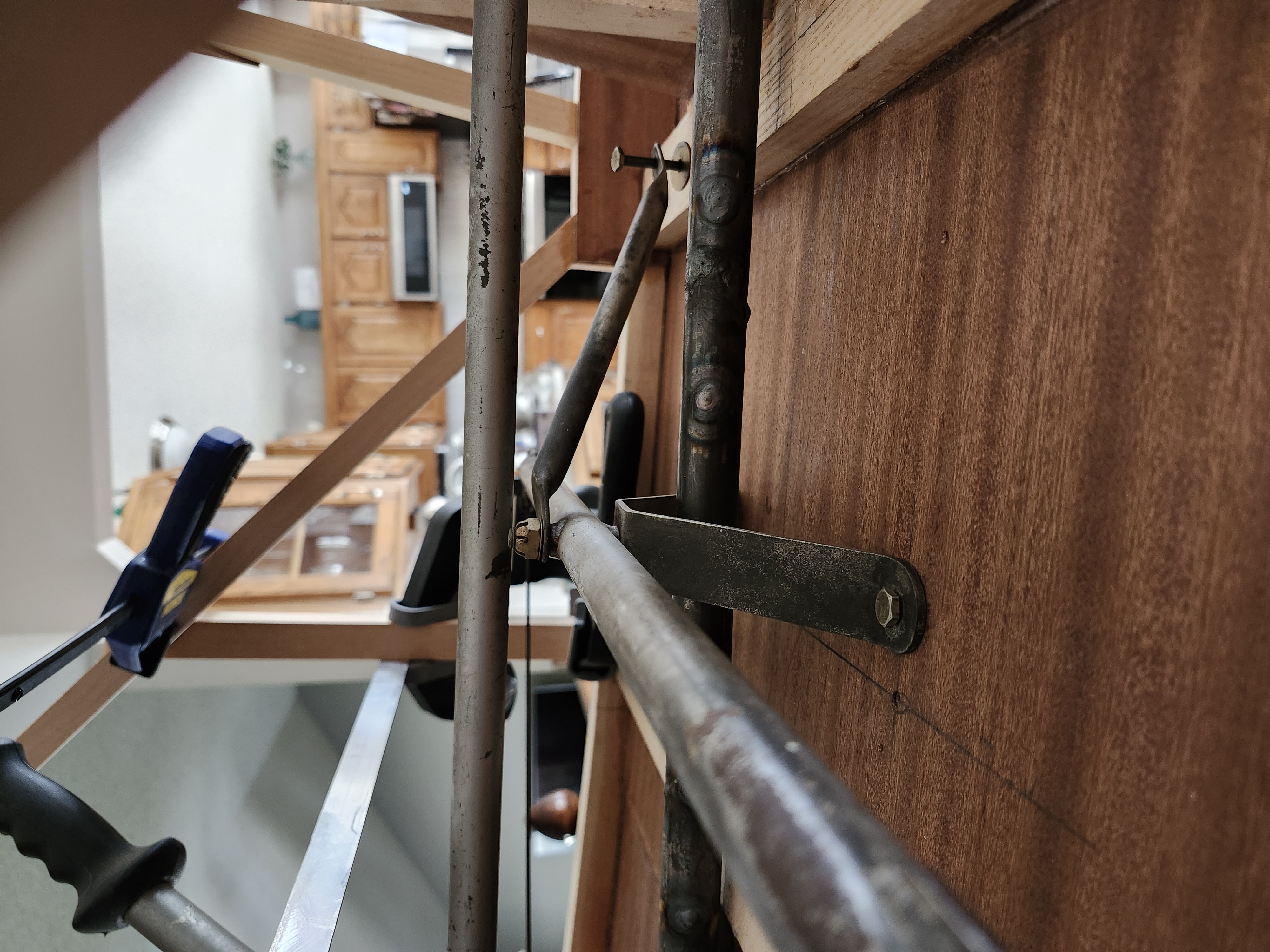

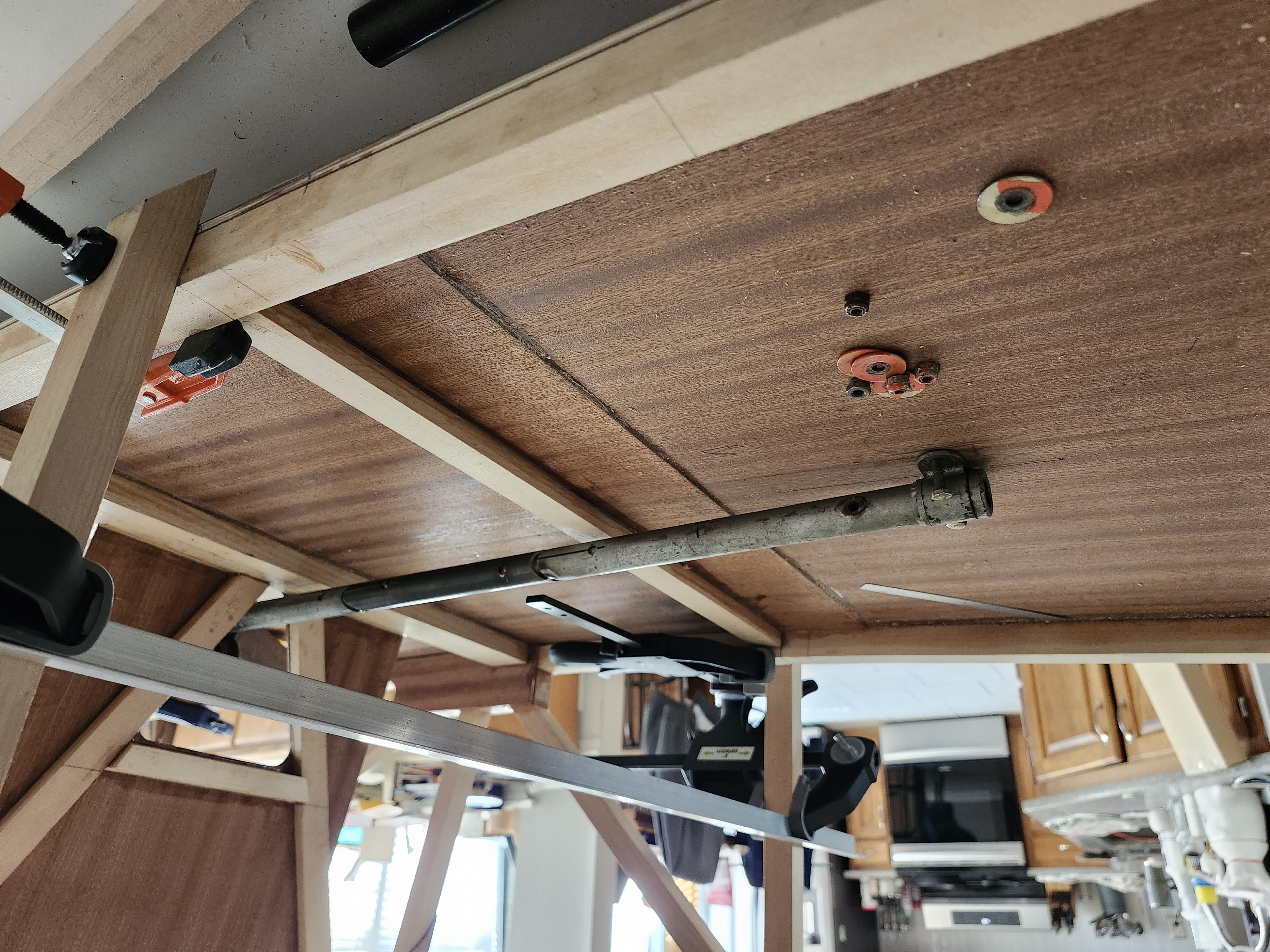

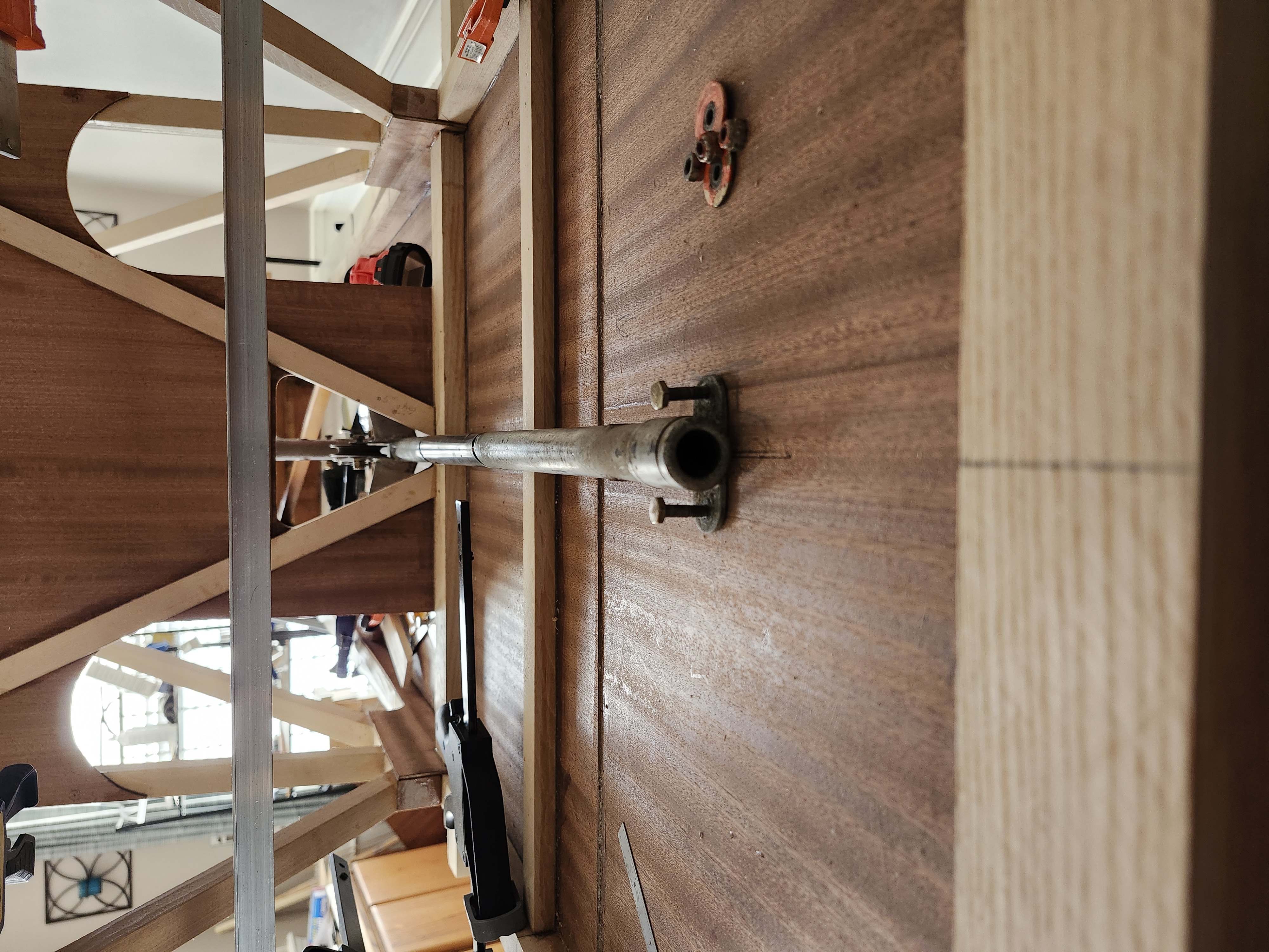

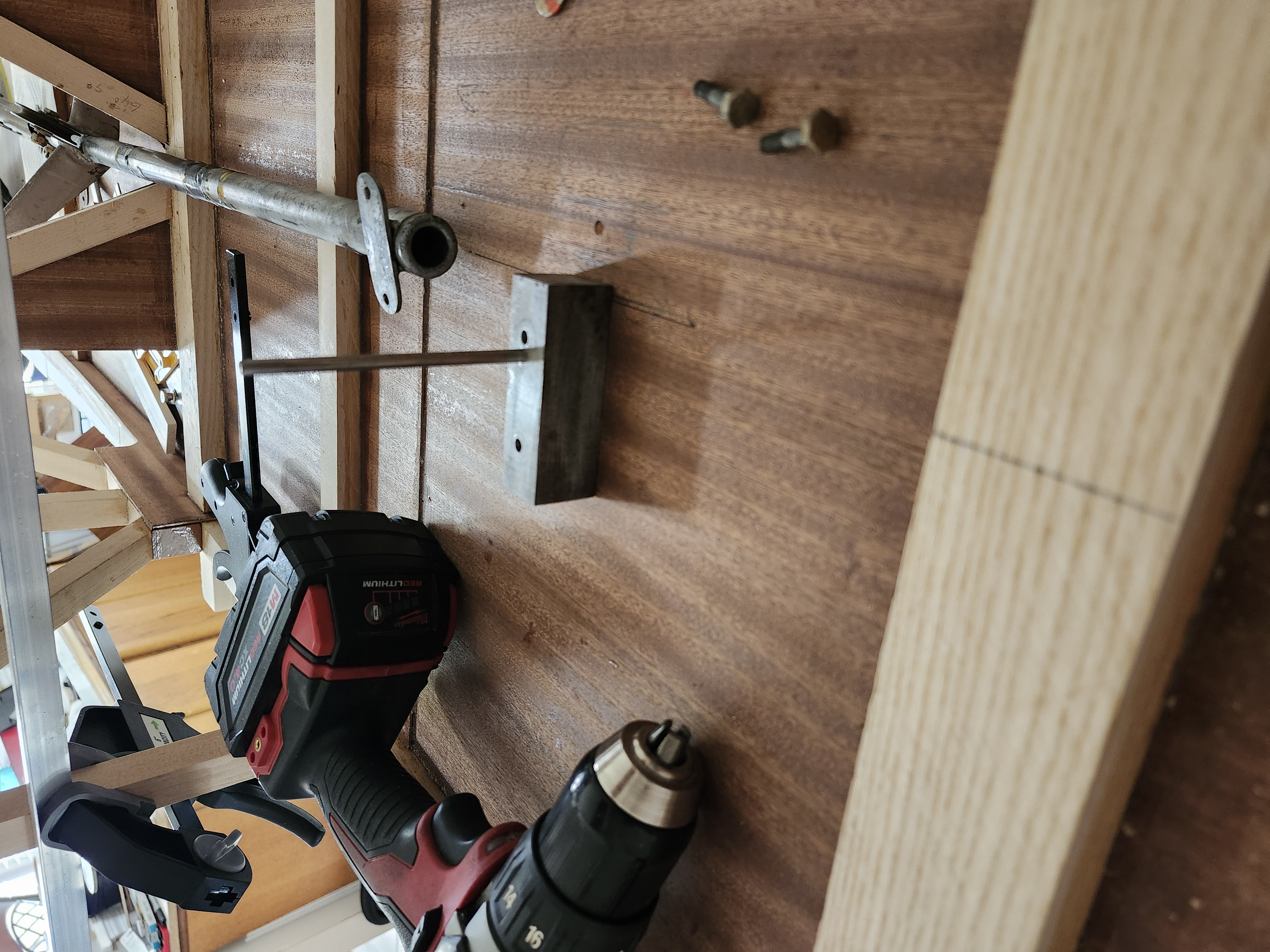

A test fit of the control torque tube after cutting out the bent part. The new tube is just tack welded at the moment. Nice fit and no binding (yet) when I move it left to right. It appears to have bent where it hit the rudder bar mount when the front end collapsed in the crash. There is a nice dent in the tube where it hit the rudder bar pivot bolt head.
Posts: 348
Re: N34KP's rebuild

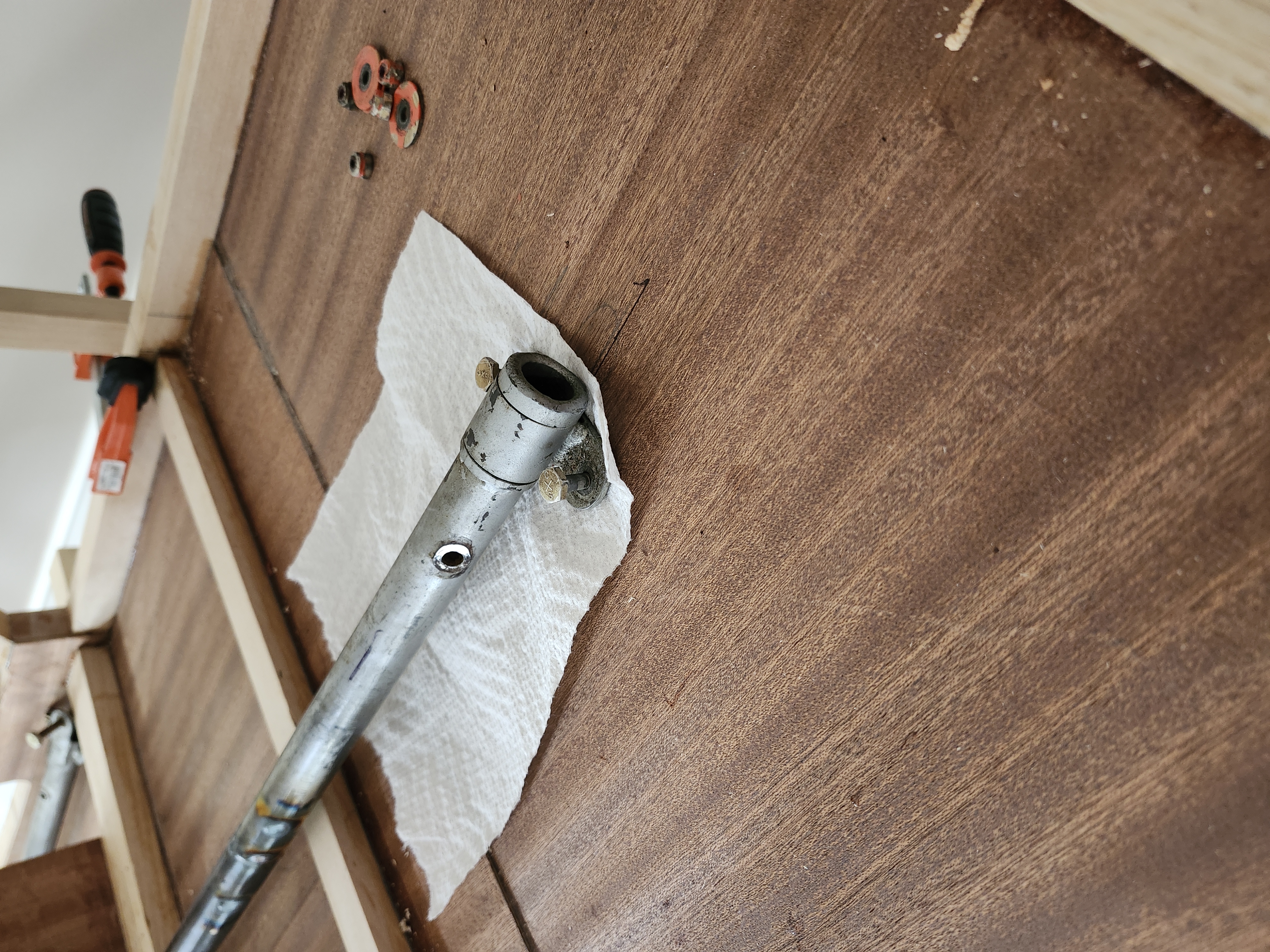

I finished welding the repair into the aileron torque tube yesterday. Today I drilled the mounting holes, using a guide block and backup wood blocks.
Posts: 713
Re: N34KP's rebuild
Looks like you're going about it the right way, which is "do it right the first time and you won't have to do it again". Steady as she goes!

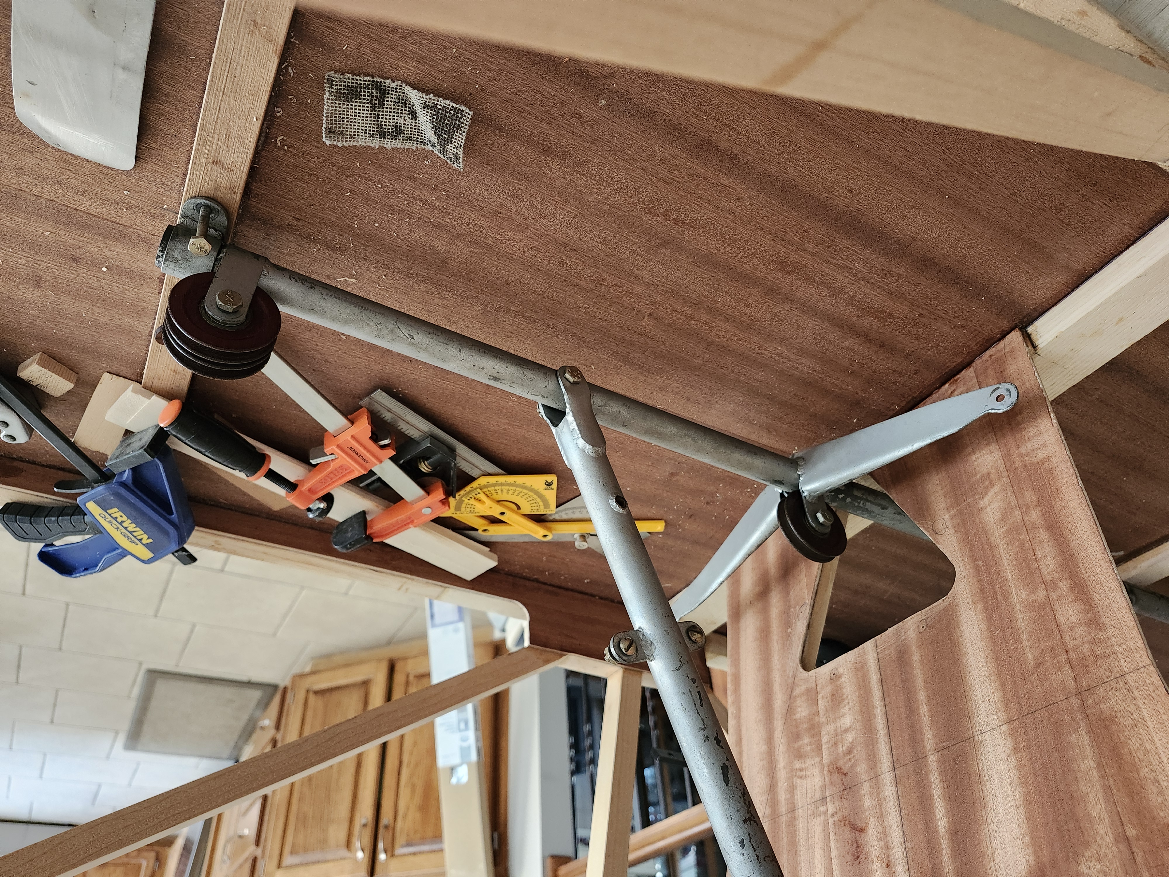

Test fit of the rudder bar and aileron/elevator controls.

It looks like an Air Camper rudder bar ;)

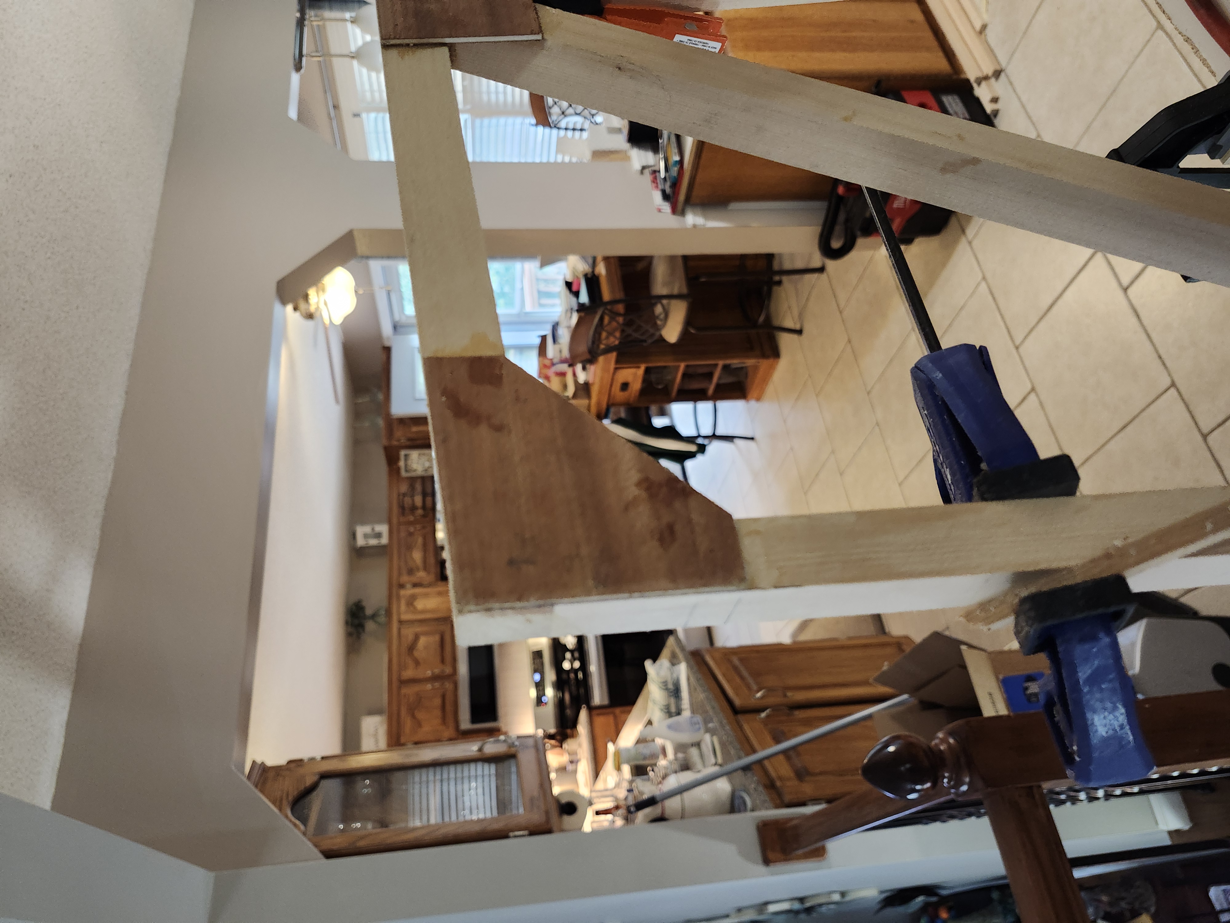

Posts: 348

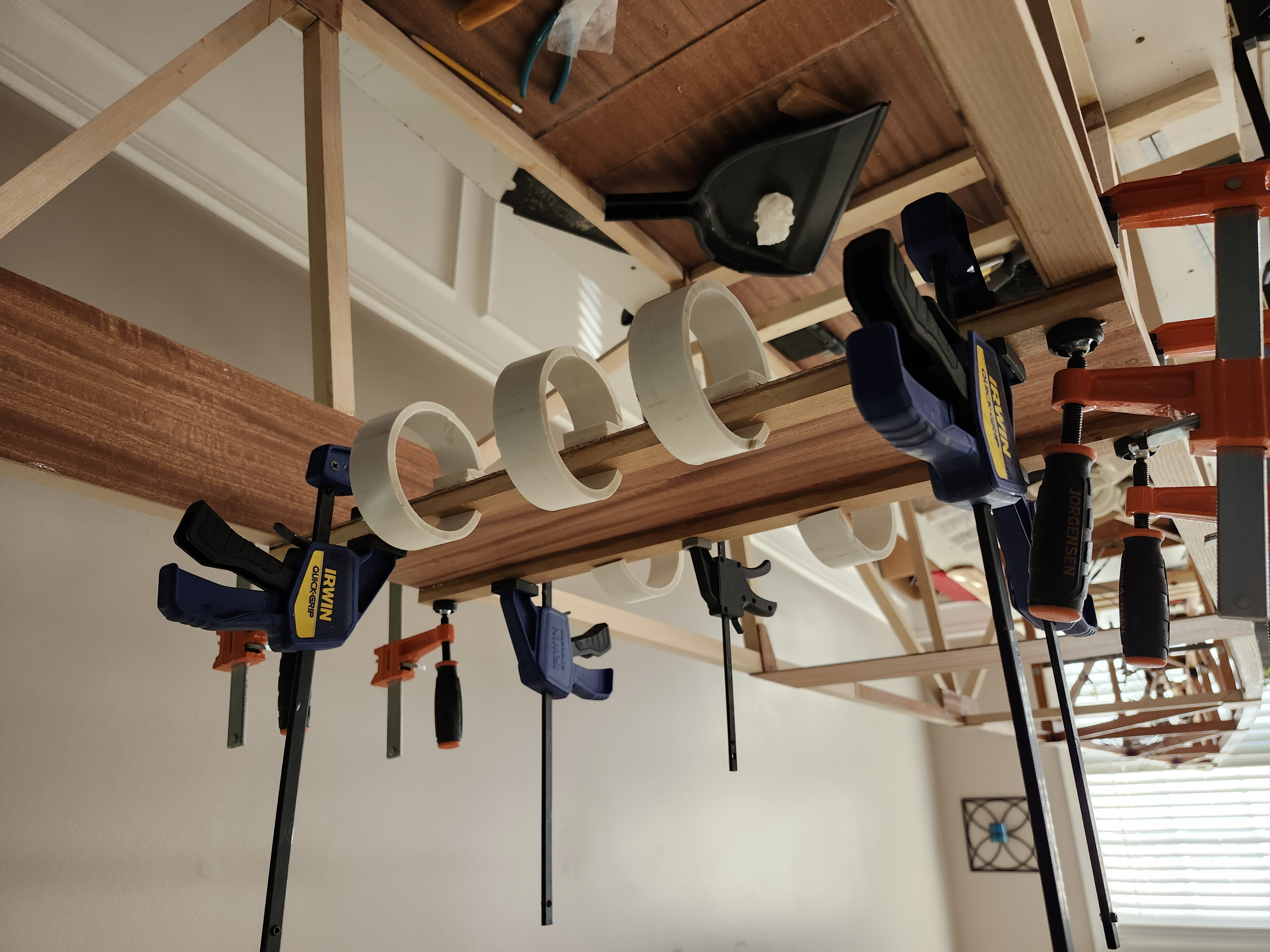

Re: N34KP's rebuild
Over 23 years of flying N34KP was damaged a couple of times when the copilots seat front plywood support was kicked. I've decided to reinforce the edges during the rebuilt. We'll see if this helps. It is much stiffer. Of course, I may have made it easier to kick off the glue line!
