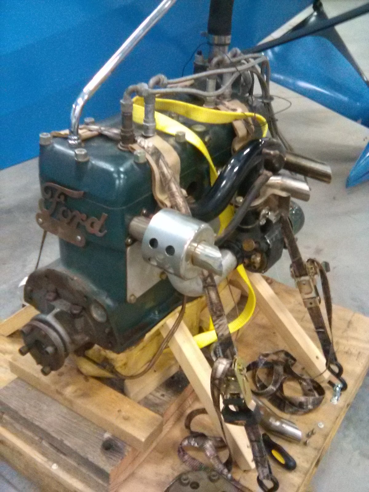

Update, I found a model A engine, but still know very little about it. Supposedly, a "Brodhead guru" did the conversion 20+ years ago, and it has been stored in Arizona for most of that time before it found its way to Iowa and now Arkansas. It appears to have very little if any run time, the previous owner did run it about 30 minutes last month. I will try to add some pictures. Does anyone recognize any particular components that may shed light on who actually did the conversion work? It seems pretty unique to me to have 2 slick magnetos, the second being installed backwards on the left side. I have so many questions, but will start off with a couple:
1. When using a dual ignition setup, what head should be used? I believe some people are using the Lion Speed head or the Secrets of Speed head, but as far as I can tell, both of these are made of unobtanium. Is it acceptable to drill/tap a second spark plug hole in the head? Or is there someway to have dual ignition all the way up to the spark plug, with only a single plug?
2. What oil should be used? Is everyone using the normal Aeroshell/Phillips or something else? I imagine it might depend on whether it has insert or babbitt bearings. I intend to take the oil pan off and take a good look around before bolting to the airplane.

That engine was done by Ken Perkins, at least it has a lot of components that he made. It looks like a Forrest Lovley radiator. I have Ken's Pietenpol, N34KP.
Ken built several engines with dual ignition. I'm not sure if any of them have flown. He talked about doing it on his bird, but never did. Several dual ignition Piets fly to Brodhead. Dan Helspur has one of them. He might be able to tell you what he uses. I believe Dan used one of Ken's side drives for the second magneto. They are essentially govenor drives from the industrial engine version of the Model A. He had gear clearance problems with the magneto drive and ended up stripping the teeth off the cam gear. He still uses a dual plug head, but now uses a mag pluged into the distributor drive hole. A Vertex mag, I believe.
Ken used a mix of 10 and 30 weight non detergent oil. I never could get a good reason for that from him. I use Valvoline VR1 20w50 detergent oil.

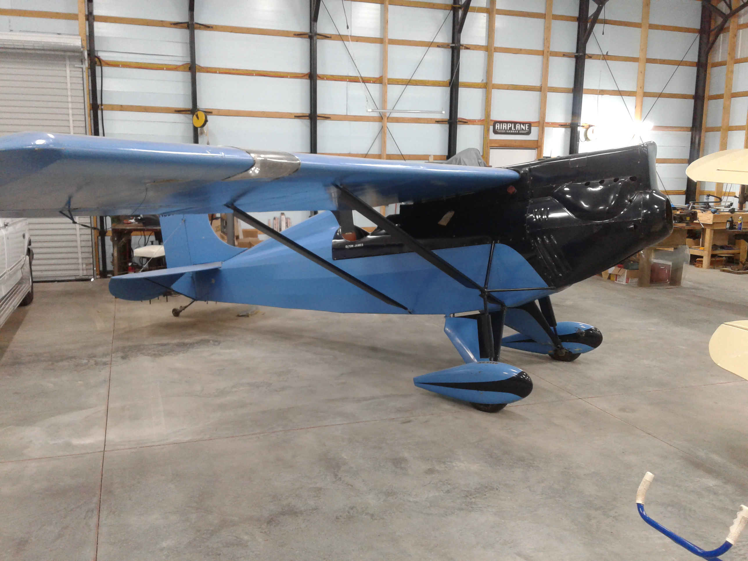

Update on this project. I know it's not a Pietenpol, but it has more in common with a Pietenpol than any other group. The engine is on the airframe, and running. It mostly uses the standard Pietenpol conversion that was already done, with a few modifications:
1. Side mounted water pump. Pump is from a 1995 Jaguar with the serpentine pulley removed and replaced with a V-belt pulley.
2. Underslung radiator. Radiator is a 4-row aluminum radiator, from a 1992 Honda Civic.
3. Custom intake manifold. Due to the relative low position of the wing, the carb needed dropped in order to acheive sufficient fuel pressure. Also, due to the tight fitting cowling, the carb heat muff around the exhaust would have looked out of place. The solution was to make a jacket around the intake manifold, that is filled with circulating hot coolant.
4. Thermostat housing. A thermostat was added to the exit (top) side of the engine to help it get up to temperature and to ensure hot coolant to the intake manifold. I purchased a cast iron thermostat housing from a model A car company but it weighed over 5 lbs. I took careful measurements and made a new one from billet aluminum. A 160 degree thermostat is installed.
5. Air Filter. A K&N air filter is mounted behind the engine and attached to one of the coolant hoses. I figured a little bit of heat going thru the carb couldn't hurt.
