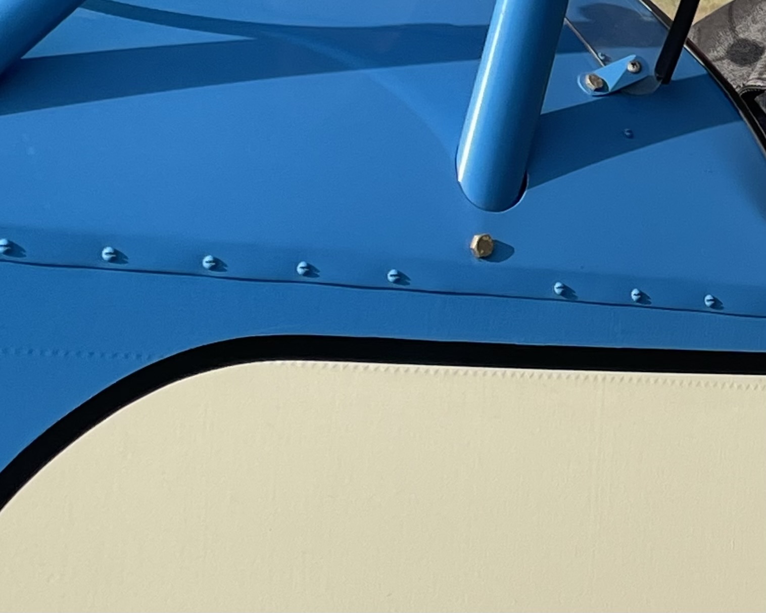

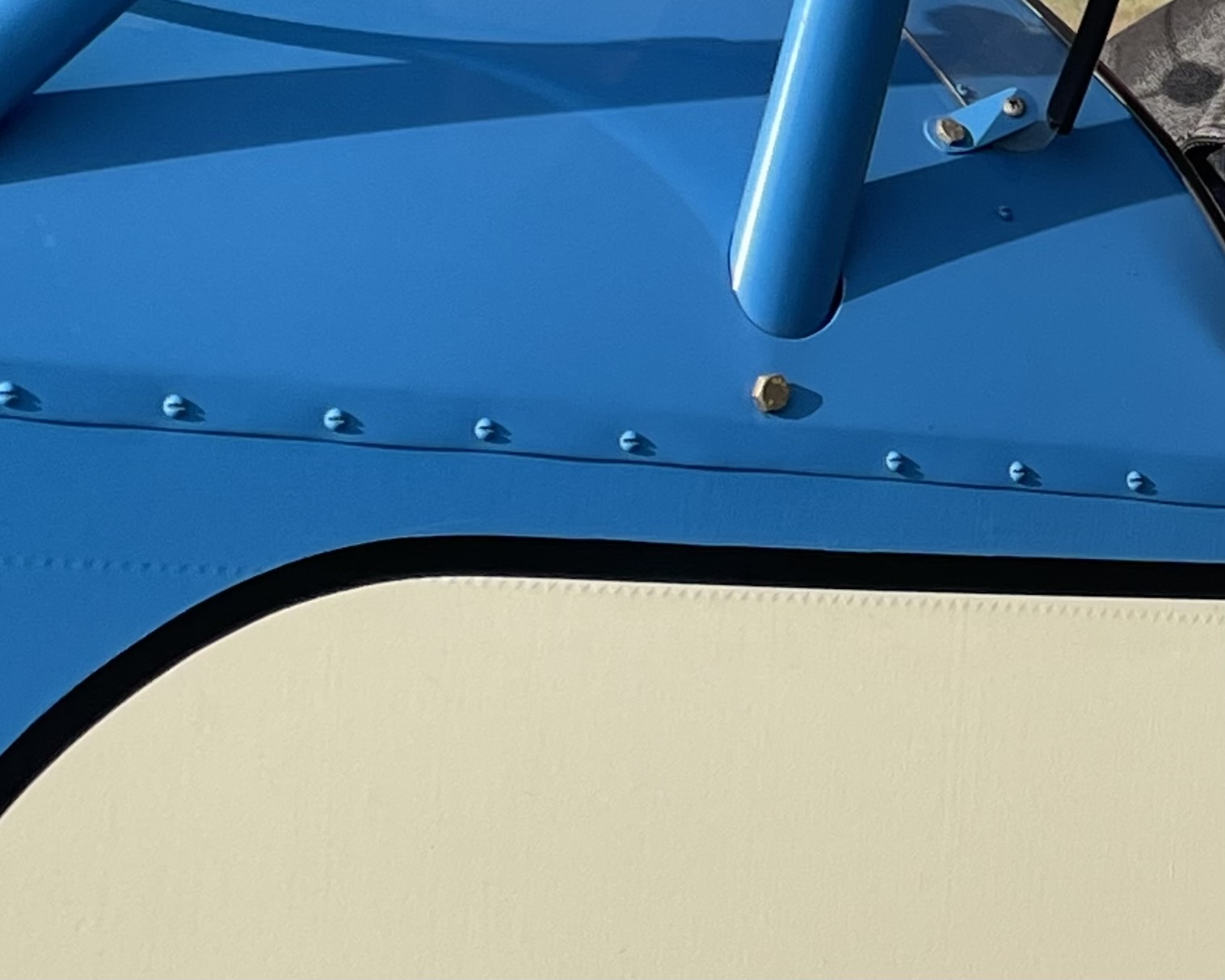

Same, just used brass #6 wood screws. If you go with flat heads and line up all the slots in the same direction then you can see if any are backing out at a glance.
Posts: 714
Re: Cockpit Cowling
The workmanship on that plane looks impeccable, Dan. Talk about a perfect fit of the cowling aluminum around the cabane tube!
