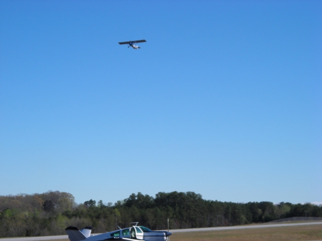

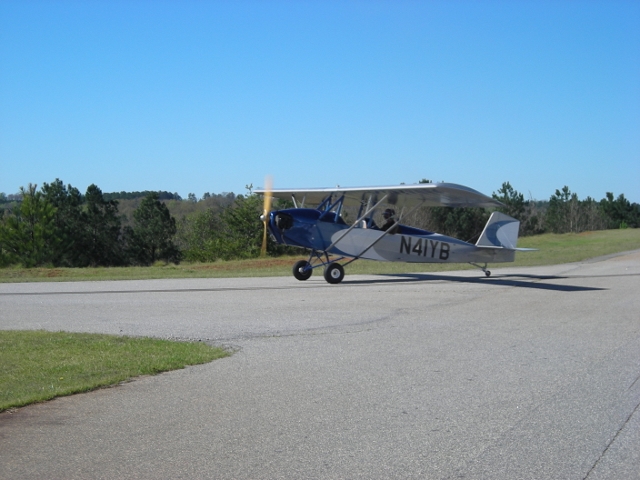

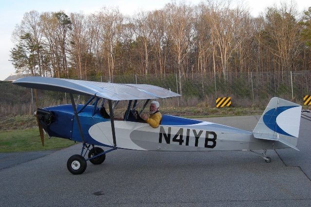

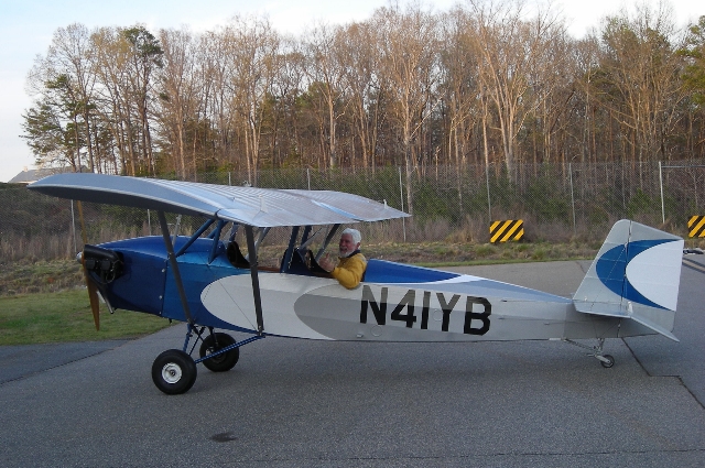

My initial Tailwheel SOLO 2 Apr 2017, in my personal creation, N41YB. Long fuselage, 3 pc wing, 2-3/8 dihedral, Carlson alum struts, 4130 cabanes & diagonals, C-150 gear and brakes, MATCO tailwheel, Cont A-75-8 by Don's Dream Machines of Milner, GA, Sensenich Experimental 70 X 42, Turtleback raised to Inst Panel height, 24" width carried aft to pilot's seat back, plus other mods, EWT 667#. Can carry up to 198# pilot within 20" aft C.G. CFI had flown it twice before and pronounced it straight with no bad manners. Initial (accurate?) instrument readings at 3,500 MSL: 95 mph @ 2,450, stall 35, oil temp 150, oil press 40. All welding and fuel (13 gal wing & 2-1/4 gal header) by local professionals. I'm initially operating on grass, at LQK (Pickens County, SC). Thanks to EAA 249 and Pickens County Pilots Ass'n, Pat Weeden for this Builders Forum, Matt Dralle for MaTronics site, WestCoastPiets for photo archives, Oscar Zuniga for advice, engine & fin offset photos, and used eyebrow scoops, Peter Johnson in Australia for his build/photo archives and advice, Mike Cuy for his elevator trim photos, many others elsewhere who helped in this 6 yr build, and the 3 other PIET flyers in SC (Beck, Harper, and Fastnaught) for advice and parts. Finally thanks to John Leupp and the 3 other CFIs who put me in the Pilot's Seat. Don Youngblood, a.k.a. planes&bikes.

Congratulations Don, thats a fine looking Pietenpol you have there!

Don; I'll add my congratulations to those of the others who cheered you on, and it's great to have another Air Camper flying. I'm very interested in your performance stats since our airplanes weigh within about 30 lb of each other empty and both have recently-overhauled A75s. My prop is a 72x36 and yours is a 70x42, and the 95MPH at 2450 RPM that you've reported bears out the fact that mine has less pitch because the only way I can hit 95MPH is to point the nose down and hold on with the engine at redline till I have to cry 'Uncle' and ease up on it. At 2450 I'm probably only seeing 70-72MPH. I have not flown any time-to-climb runs since changing out the A65 and Hegy prop to the A75 and Culver prop, but I hope to get out and run some test cards pretty soon.

The performance numbers should be considered preliminary, as I have personally flown it only once (2X prior by C.F.I. Test Pilot), and have not checked airspeed against GPS. 95 mph indicated felt uncomfortably fast, but engine builder recommends 2,450 rpm break-in, so I'll hang on and get GPS or other confirmation of accuracy. 70 X 42 prop was engine builder's advice, and I followed it based on his having built/flown a PIET. Short ground run, almost pattern altitude by end of 5,002' runway, and fast cruise seem to confirm good decision. I'll compare time-to-climb #s with you (Taildrags) when available.

Your numbers appear a little optimistic. But for the Pietenpol numbers are just for reference. the only really important ones are approach and stall speeds for safety and normal cruise with fuel burn for planning your trip to Oshkosh.
