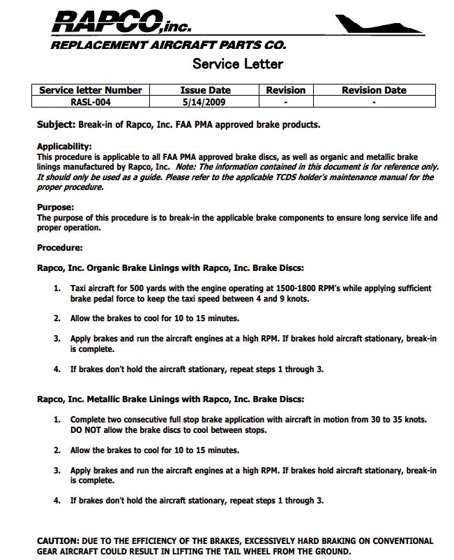

Was there a break-in routine specified for the new brakes? When I replaced the pads on my brakes with new Rapco linings, there was a procedure that basically involved some fast taxi while dragging the brakes to heat them up. May be different for other brakes, other pads. Here's what Rapco says about theirs. "If brakes don't hold the aircraft stationary, repeat steps 1 through 2." Mine did.

Yes there is a break in routine and they are getting better as I taxi.

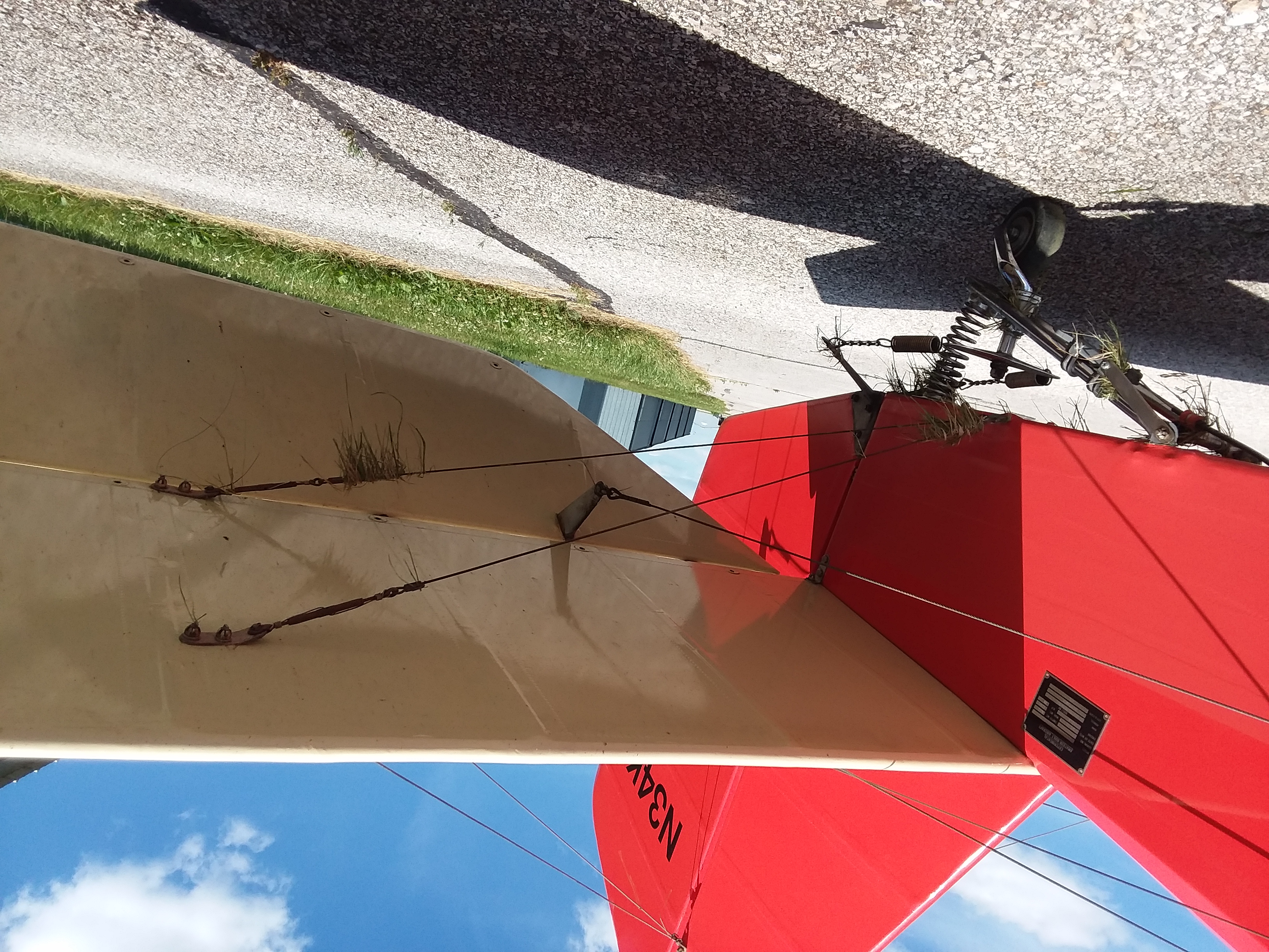

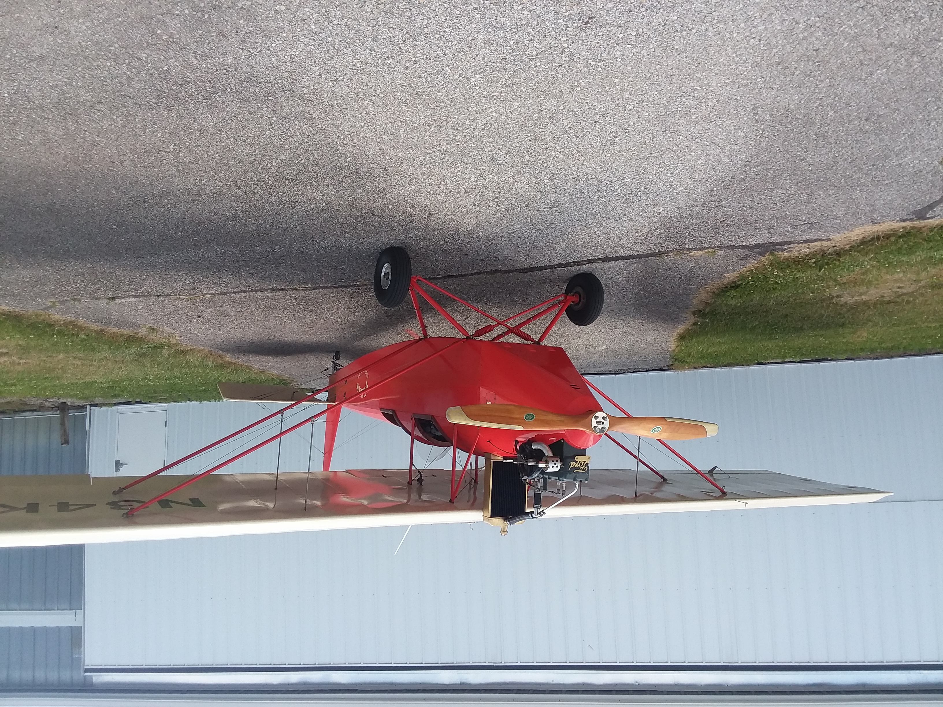

N34KP flew again today! The new wheels and brakes worked well, they track straight. I did cut the grass while I was at it.
Re: Brake master cylinder mountings
Richard; I take it from where the grass is way up on the tail brace wires that you're glad the airplane is painted a bright color? Otherwise, you'd be so deep in the grass when you stop that you might lose the airplane in that tall stuff ;o) Good heavens, man-! If you're landing in stuff that tall, you sure shouldn't need brakes!!
Posts: 368
We've had a lot of rain. They finally got a chance to mow yesterday and today. Maybe they should bale it.
