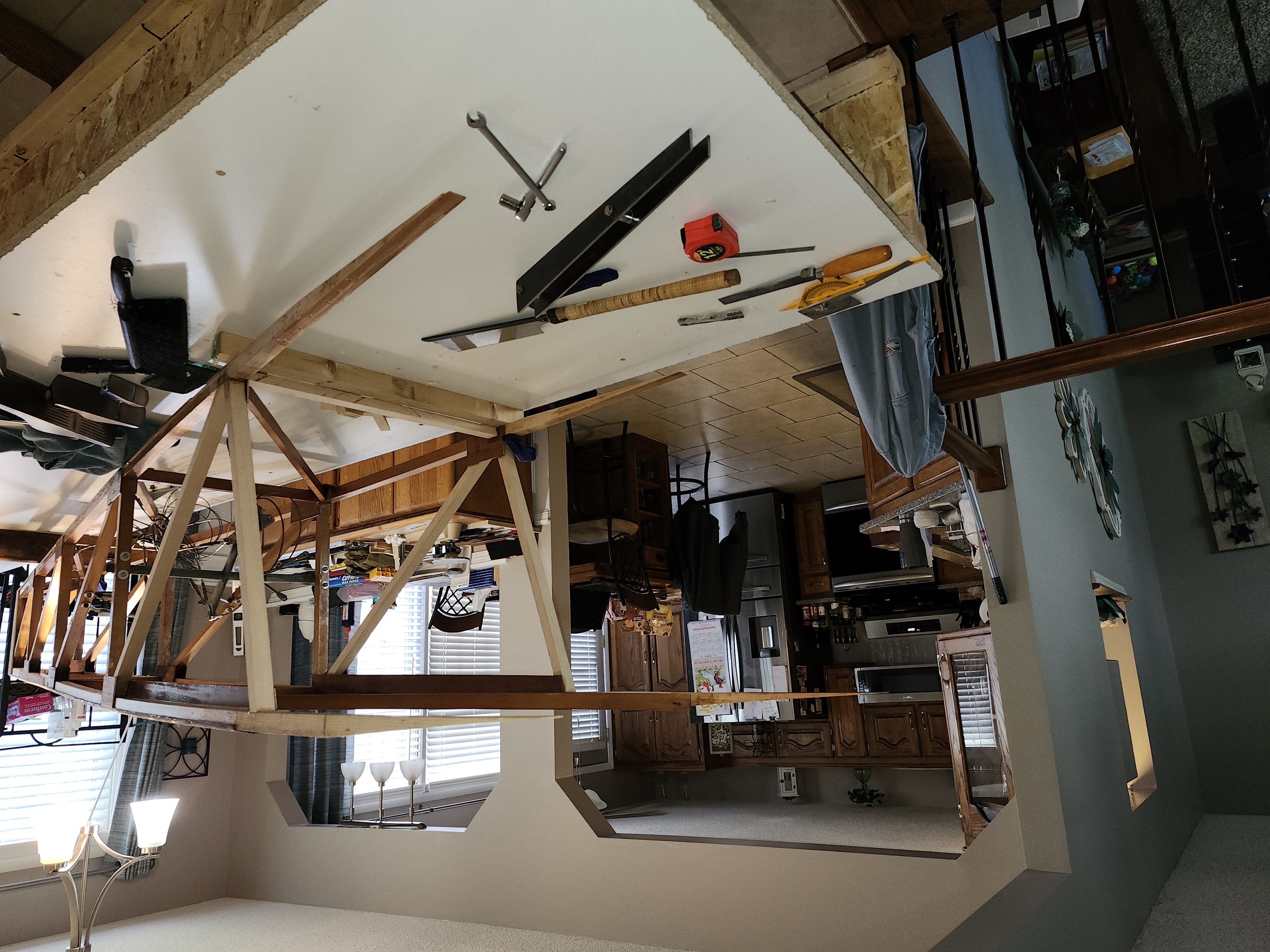

The tail reconstruction is finished except for fairing strips and holes for the fittings.
Re: N34KP's rebuild
Posted: Mon Apr 29, 2024 10:19 am
by taildrags
That's gotta be a great feeling, Richard. I know it was a great feeling for me every time I completed a subassembly back when I was making repairs to my Air Camper. Patience and determination will eventually win the day.

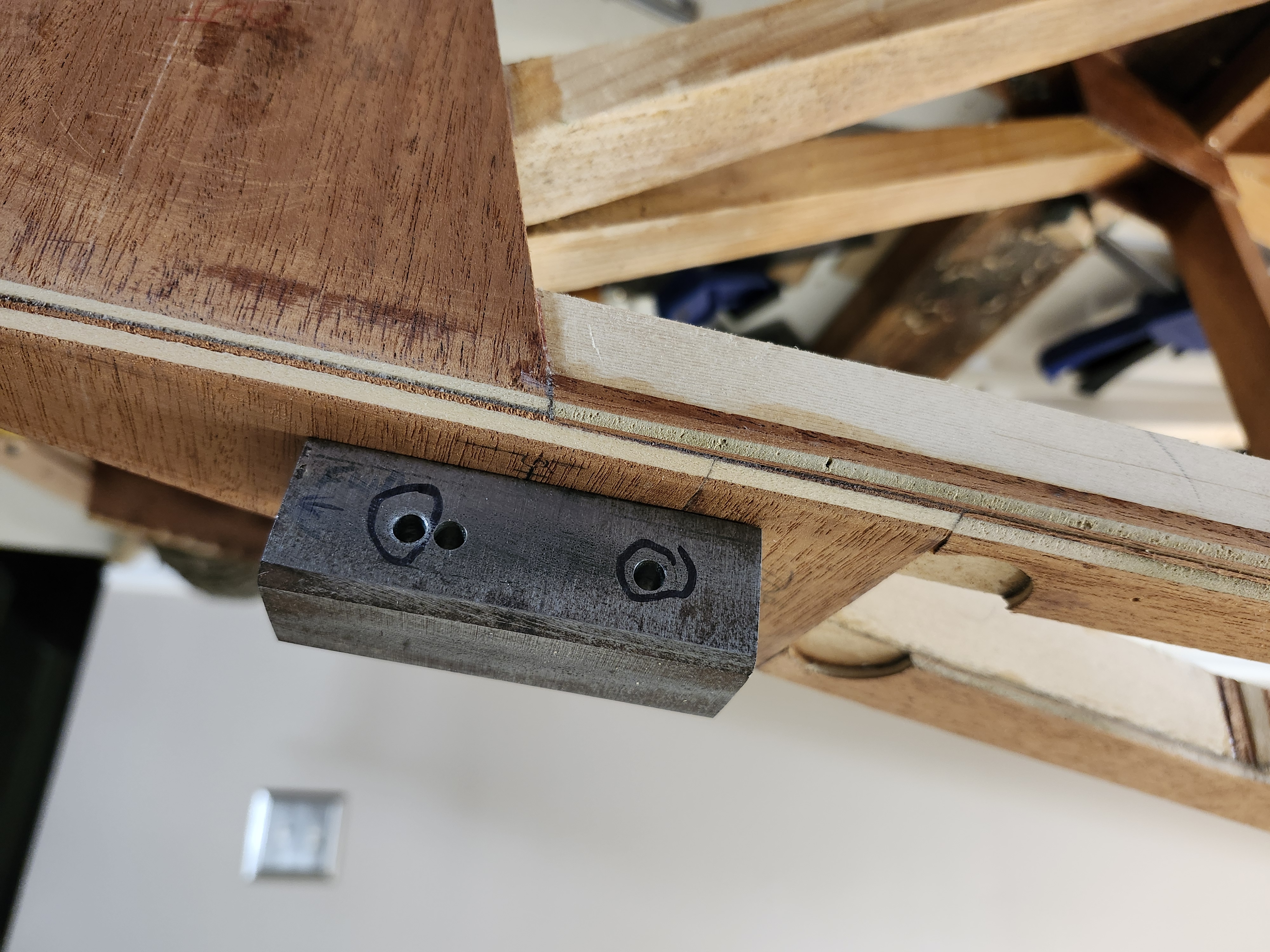

The holes for the forward tailwheel brackets are drilled.

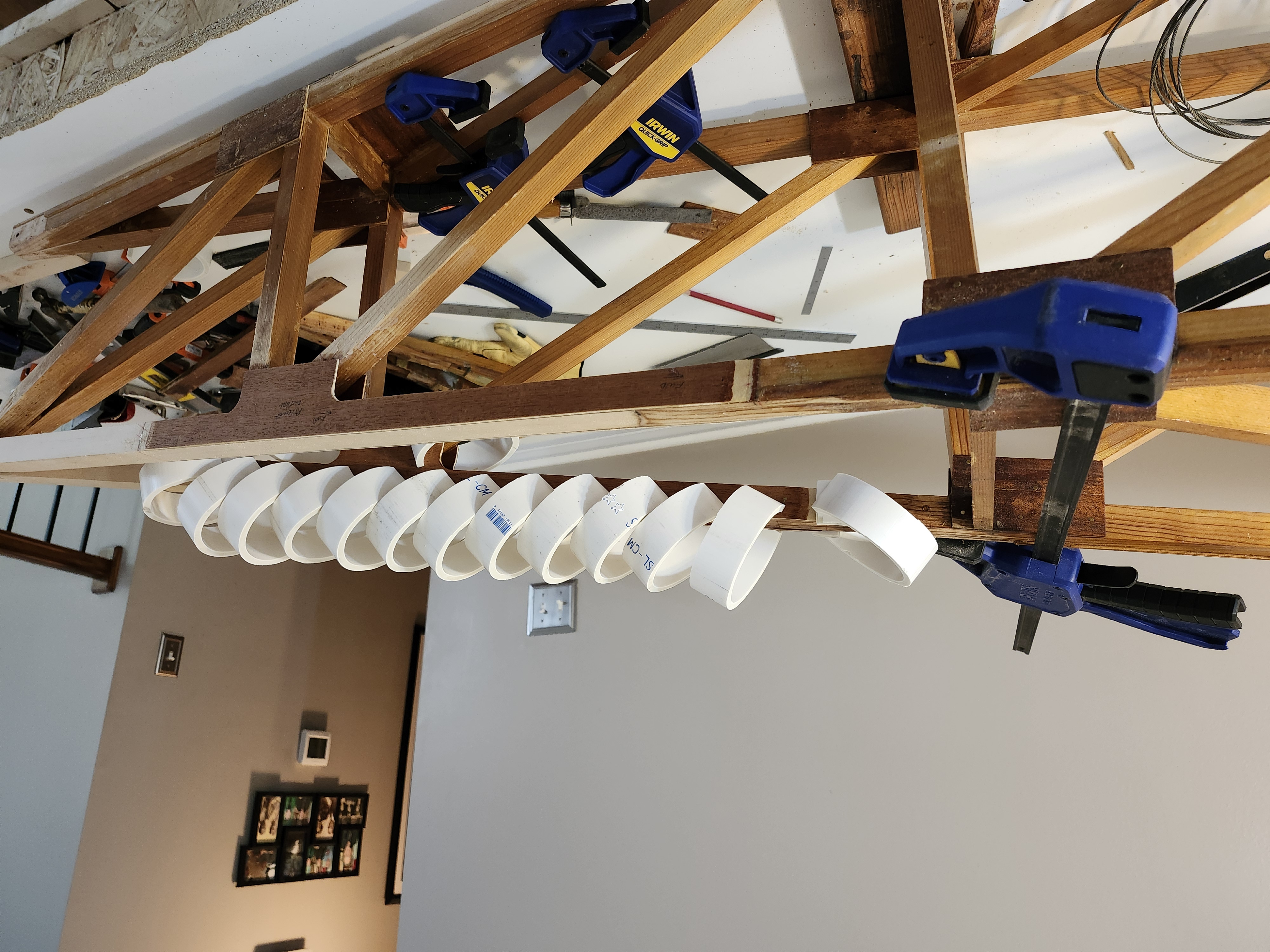

Bending a longeron. It dropped 2-1/8" at the end overnight. 6 lbs of weight hanging on the end.

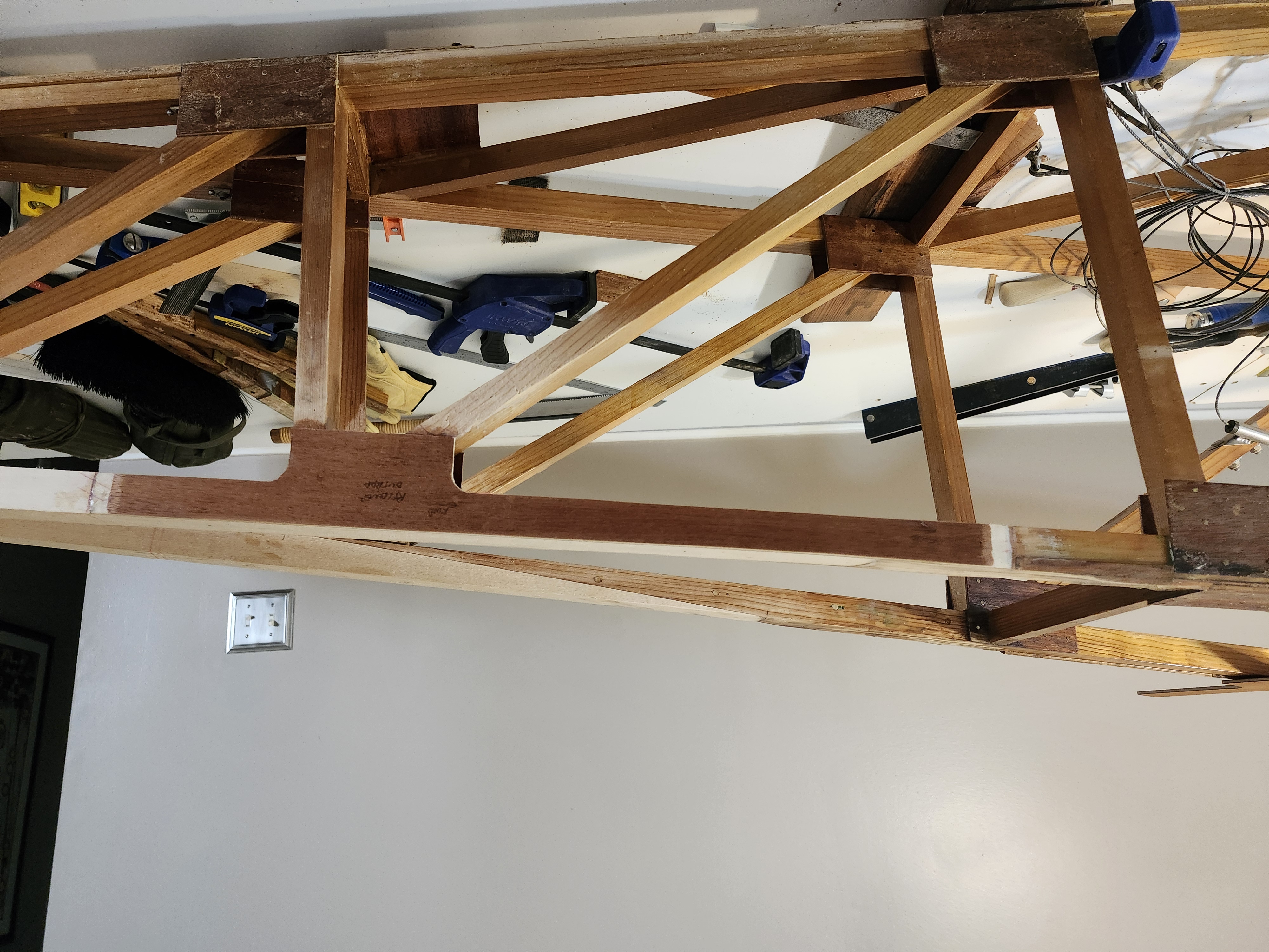

I hadn't worked on the Piet since the third week of June, due to my wife's memorial and my general lack of desire to do anything. But today I started cutting inside gussets. The one shown, inside lower right, has a long one. The gussets for the longeron splice and the station came so close together I decided to combine then. It'll be the same way on the opposite lower longeron.
Re: N34KP's rebuild
Posted: Tue Aug 06, 2024 10:41 am
by Richard Roller
After the clamps and final shaping.
Re: N34KP's rebuild
Posted: Tue Aug 06, 2024 1:13 pm
by Chuck in Indiana
Thanks for the pix! I know sometimes you don't think anyone cares when you don't get any response. This stuff is valuable info.
