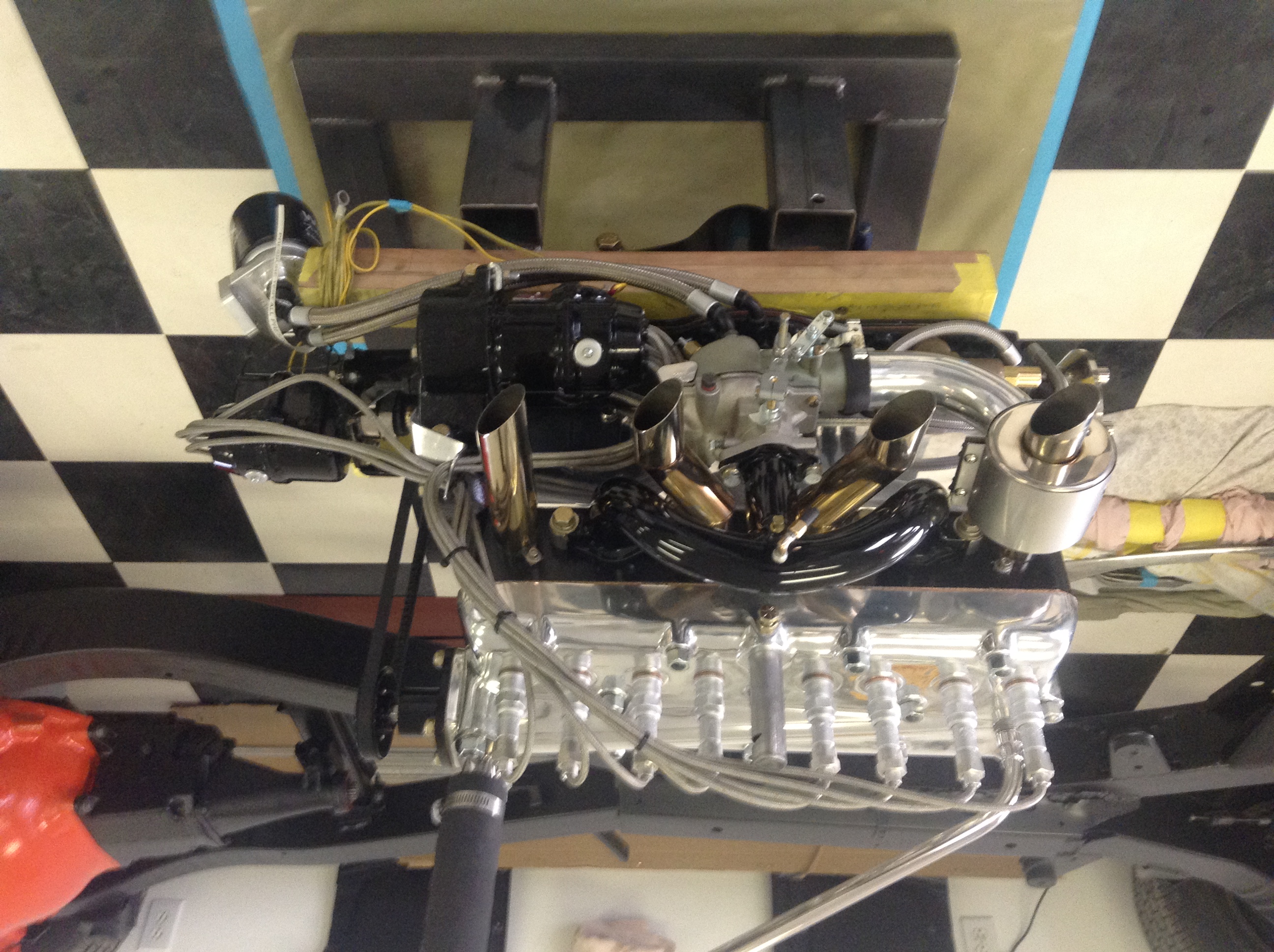

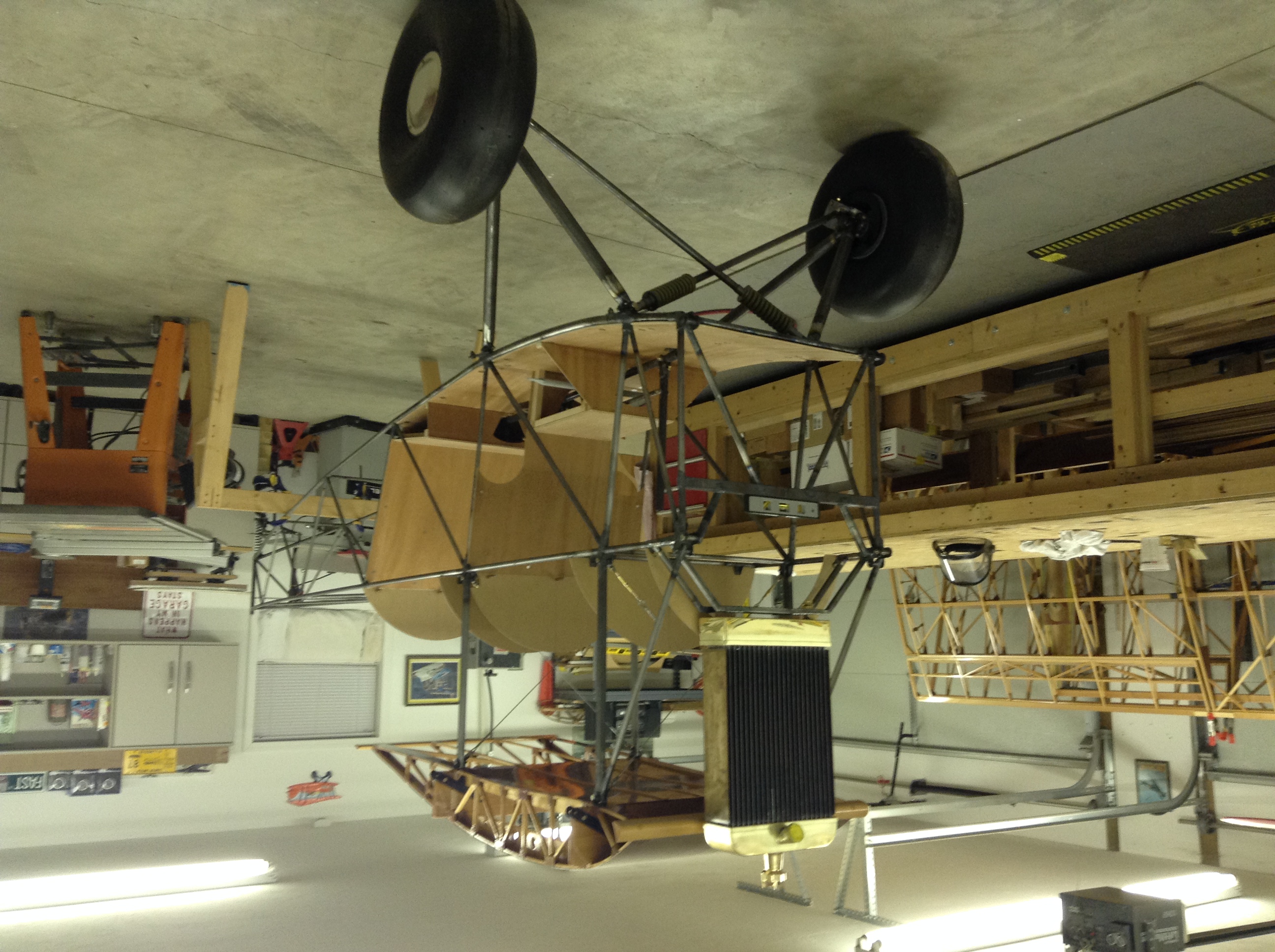

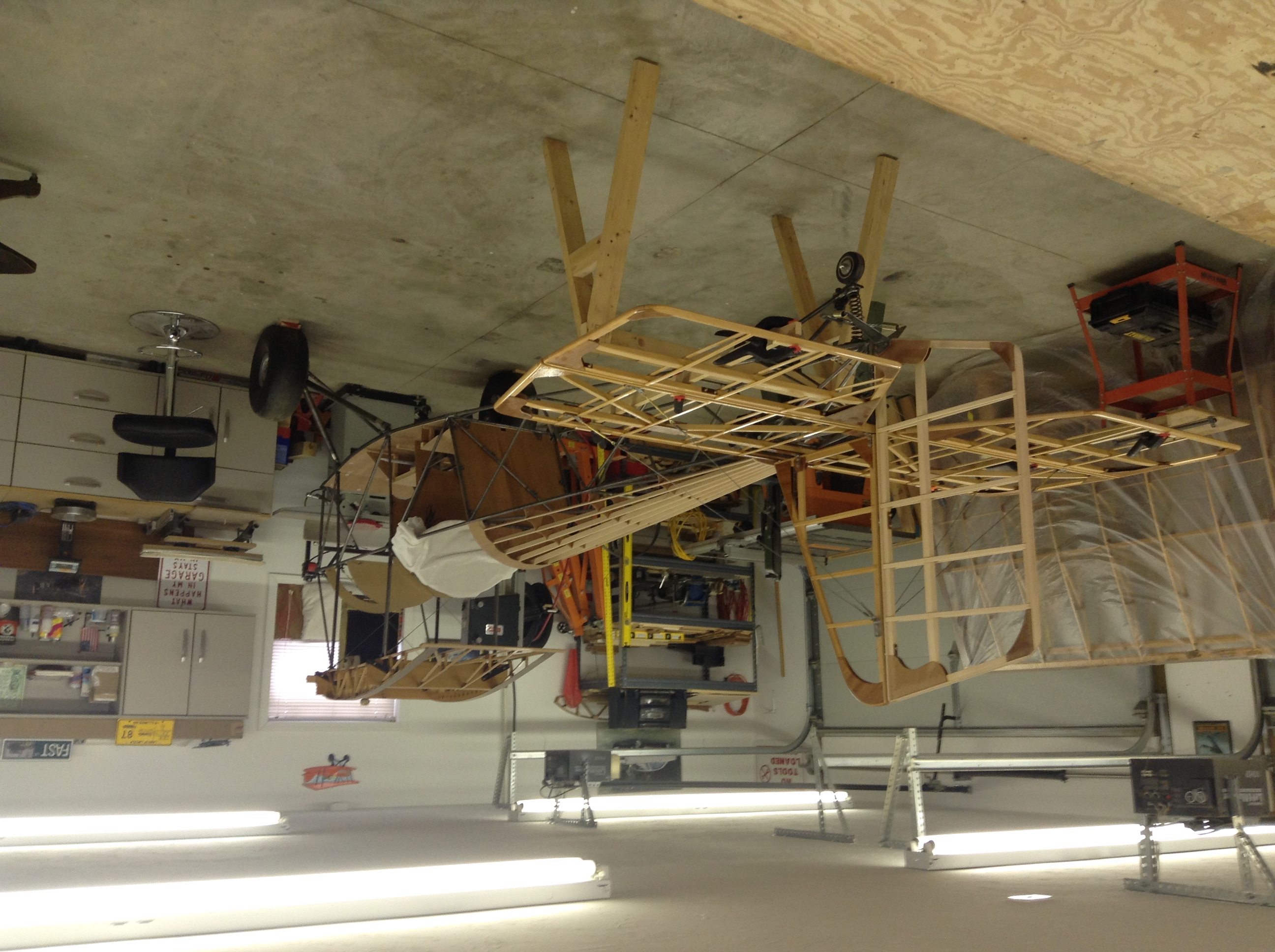

Guess I'll make the first post on progress of my project.
Model A engine ready to go. Diamond block, Scat counterweight crank, Insert bearings, Scat rods, custom made Ross Pistons, Model B cam, bigger valves, pressurized oil system, Dan Price dual plug head drilled for aviation plugs, dual Slick mags, new model B carb., Ken Perkins water pump & exhaust. Was on Dyno making 65hp at 2000 rpm. Could not find a Forrest Lovley radiator, Forrest was nice enough to help me with patterns and I built my own radiator.
Steel tube fuselage per glider manual plans, everything pretty close to plans as possible. Wings finished and ready to cover. Everything is spruce and mahogany. Everything gas welded. Cables wrapped and soldered, hard wire tail brace wires.
