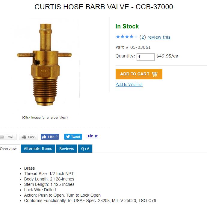

1. External drain - for water testing.
The tank is mounted in the nose over the passengers feet.
Water testing the tank means the risk of spilling fuel in the cockpit..
Does anyone know of a drain with a nipple that can purge the fuel to the outside into a catch pan?

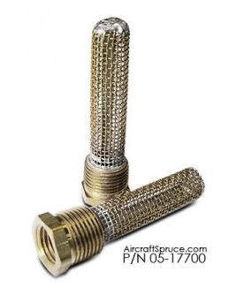

2. Intake Fuel screen. The primary fuel pick up is in the bottom of the tank with NO pre-screen.
How do I add a screen?

2. What type of connection does your fuel outlet hose have to the bottom of the fuel tank? If it's a threaded boss or hub, you might be able to get a standard type of "finger screen" that will thread into the boss or hub and then the fuel line fitting will thread into the finger screen fitting. Below is an image showing what I'm talking about. Be advised, however, that this type of screen is only for fairly large crud, and won't do anything to remove water.

Kenneth; one more thing. If you are thinking of the kind of water drain such as you find in many certificated aircraft where you pull a knob in the cockpit to allow the contents of the lower part of your fuel system to drain out onto the ramp, you might want to rethink that. Yes, you can certainly find spring-loaded valves that are actuated with a knob and cable in the cockpit, but you'll never know what came out of the drain unless you can inspect it, and it is no longer considered to be safe or environmentally responsible to just allow fuel to dump out onto the pavement or apron under the airplane. If you can operate the valve manually (fingers), here's one way to do it with a drain hose that you can route outside the cockpit:
