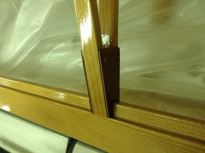

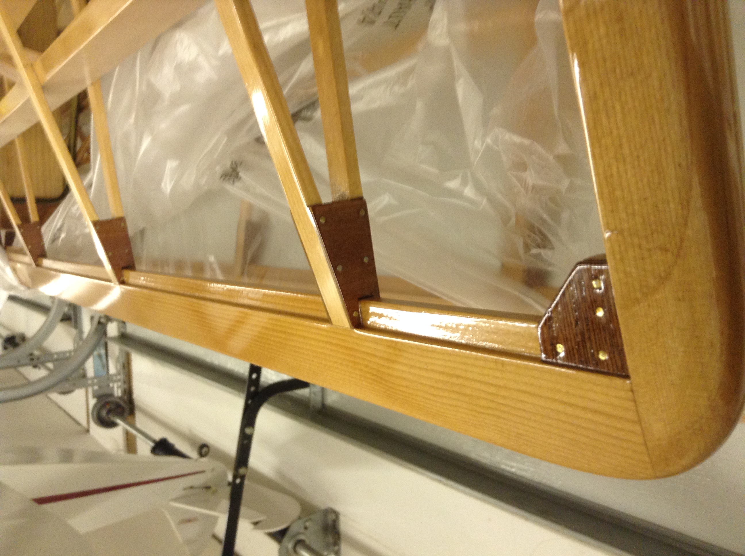

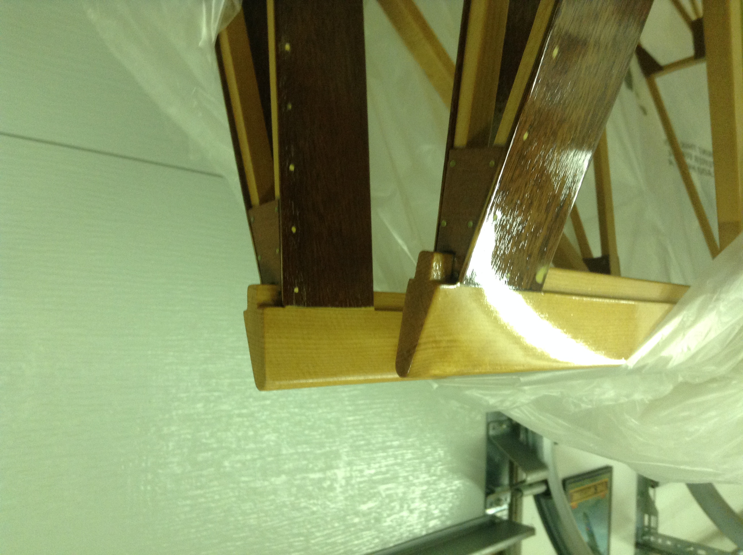

Here are some pictures of my trailing edge. I didn't want any lumps in the fabric with gussets and wanted a smooth transition. Made tongue and grove. Made a jig to hold my ribs and cut slots on router after the ribs were completed. I made a pattern of what I wanted for trailing edge and took some spruce strips to a wood shop that had a moulding cutting CNC machine. They made a cutter to my profile and then cut them out. They came out perfect and straight. It seems plenty strong enough and sturdy.

Rob, I was trying to estimate the size of the tongue on your trailing edge piece. 3/8" wide by 1/4" thick? Would you tell us?
Richard.
Re: Wing trailing edge
Richard; I'll bet you're right, since the rib capstrips are 1/2" wide by 1/4" thick and the tongue on his trailing edge looks just a bit narrower but about the same thickness.
Rob
Posts: 21
Post by Rob »
Yes Richard, it is 3/8 long by 1/4 thick.
