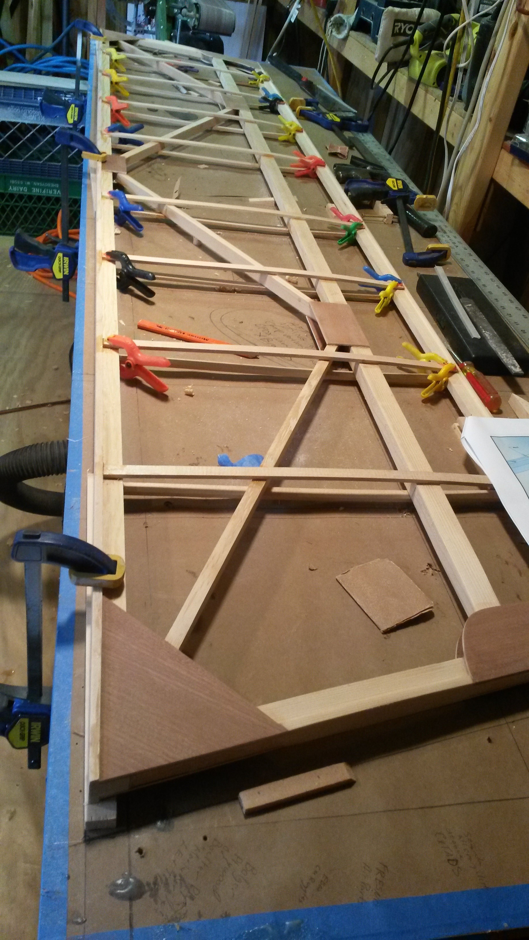

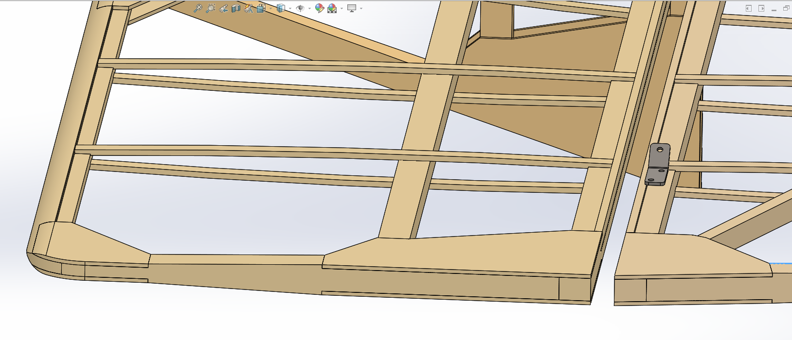

I'm going to be starting the tail feathers whenever the spruce arrives. I think they probably just planted the trees when I placed the order. I'm planning to do mine flush and just have the gusset go to the edge of the beams instead of inside the lips. To get around the different thicknesses called out for the leading edge, trailing edge and main beams I'm planning to taper the beams that go between them. This is easy enough to do with a tapering jig and table saw.

I agree with you, I thought that the wood tail was the hardest part of the plans to understand. Attached some pictures of mine that may help. I think most all of the corner gussets are inset into the rabbited side beams.

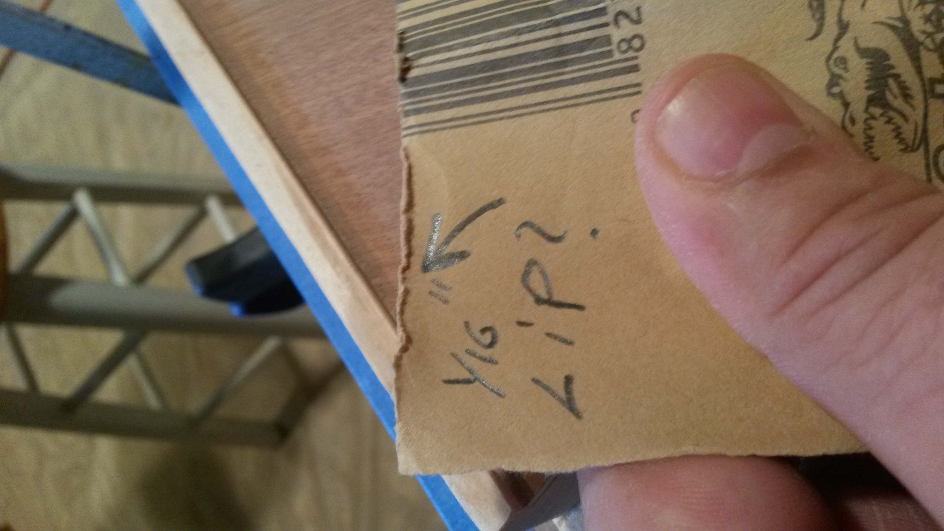

OK, I'm pretty happy with my horizontal stabilizer....all except for the "main beam" or trailing edge. I am left with the 1/16th" lip where the gusset rests inside the main beam rabbet. I didn't want to run the gusset all the way to the trailing edge by removing the rabbet because I didn't want the trailing edge narrower by an 1/8th" (1/16th on either side) where a hinge will be installed. Here's my question. Once covered as is there would be a 1/16 " between the skin and the gusset...is this an issue? Would it be better to add 1/16th ply filler and feather it out about an inch or two and a half forward from the spot where the gusset buts against the beam? Confusing enough? Thanks for any advice...kinda don't want to reduce the width of the main beam.

After pondering, smoking a pipe (tobacco), and mulling it over a nice neat bourbon, I realized the rest of the entire main beam trailing edge has that same narrowish edge, just because there is a gusset plate beneath this portion it shouldn't be any issue. I guess I was concerned with the fabric vibrating against the gusset but I'd have bigger problems if my cloth was that loose n floppy... :D
Colonel Rosa Kelbb
Posts: 719
Re: Tail Feathers Confusion
Sounds like the prescribed medication had the desired effect. The fabric doesn't need to be glued to the gusset but can fly over it with a 1/16" cushion.

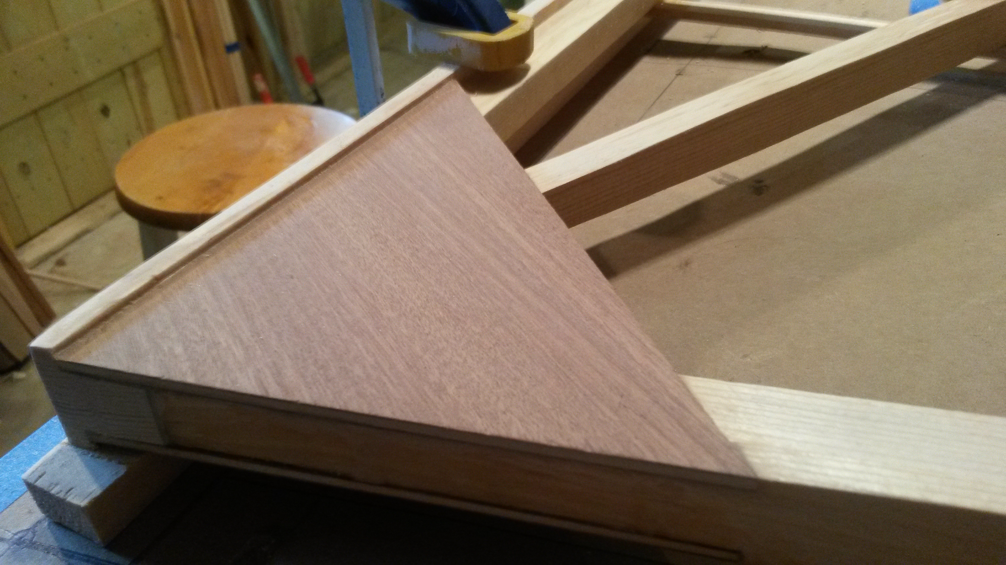

I just discovered what may be the perfect gusset material...if we even need to worry about it.
You're right: 1/8" thick gussets do drop down into the 3/16" rabbit and leave a little lip. Doesn't seem right. But then I grabbed a scrap piece of luan plywood from my scrap bin and discovered that, even tho Home Depot calls it 1/4"...it actually nets out at 3/16". Perfect down into that rabbit. Might wind up heavier back there in the tail area tho. Don't know.
All I can tell you is it fits flush as can be. And where the plans say "3/16 plyboard under fittings" this IS 3/16. Try it...see what you guys think. Post a reply too, wouldja?

Rick....not sure I sufficiently thanked you for your post and the photos. I appreciate it. I agree in thinking the corner gussets are inset into the rabbited side beams. But then what did you do about the difference between the 1/8" gusset and the 3/16" rabbit? Did you sand down the 1/16" lip to bring it down to the height of the gusset (assuming you followed the plans and DID use 1/8") or leave it proud? Your photos look like it's flush. Maybe you used 3/16" gussets?
