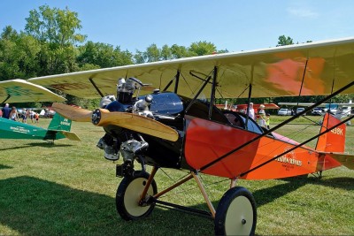

Steve Mather captured 498K in this photo that was taken at the Wings 'n' Wheels event in Warren Ohio in 2015. 5-cylinder 90 HP Lambert radial. Absolutely gorgeous aircraft/engine combination and the cabanes appear to be vertical or nearly so, which would indicate that the weight & balance with this combination worked out well.

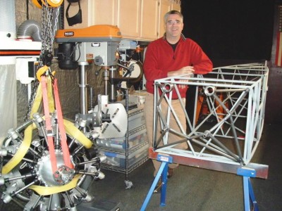

You can also learn a lot from Jake Schultz's steel-tube fuselage Air Camper with 7-cylinder Rotec radial. Jake has posted many more photos of his setup, so search on his name and you should find more.

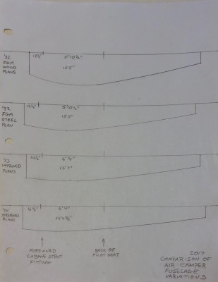

a while ago I drew up this comparison of fuselages. Might be of interest.
Posts: 95
Re: Fueslage Modifications For Diffrent Engines.
I’ve just now noticed a mistake. The measurement from the firewall to to seat back on the steel fuselage should be 6’2-1/2”. Just goes to show that you should question everything you see on the internet!

taildrags wrote: Sat Dec 22, 2018 12:09 pm You can also learn a lot from Jake Schultz's steel-tube fuselage Air Camper with 7-cylinder Rotec radial. Jake has posted many more photos of his setup, so search on his name and you should find more.16.JPG

Posts: 719
Ture: yes, the 7-cylinder Rotec is the R2800. They also have a 9-cylinder model, the R3600.
