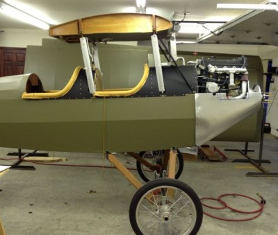

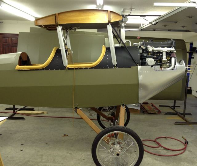

Robbie: also, look at this picture of Chris Rusch's Piet, which has wooden vee legs and large spoked wheels. The plane isn't quite in the level attitude, but notice where the axle centers are relative to wing leading edge, but also notice that the cabanes are swept back a bit. In fact, the cabanes on my airplane are swept back almost 4 inches, which if you had to swing the wing back to adjust the CG on the project plane an equal amount, could reduce the far-aft axle position from 7-1/2" aft of LE to only 3-1/2". It still wouldn't be ideal and should be considered for a rework, but may not be as bad as it looks.

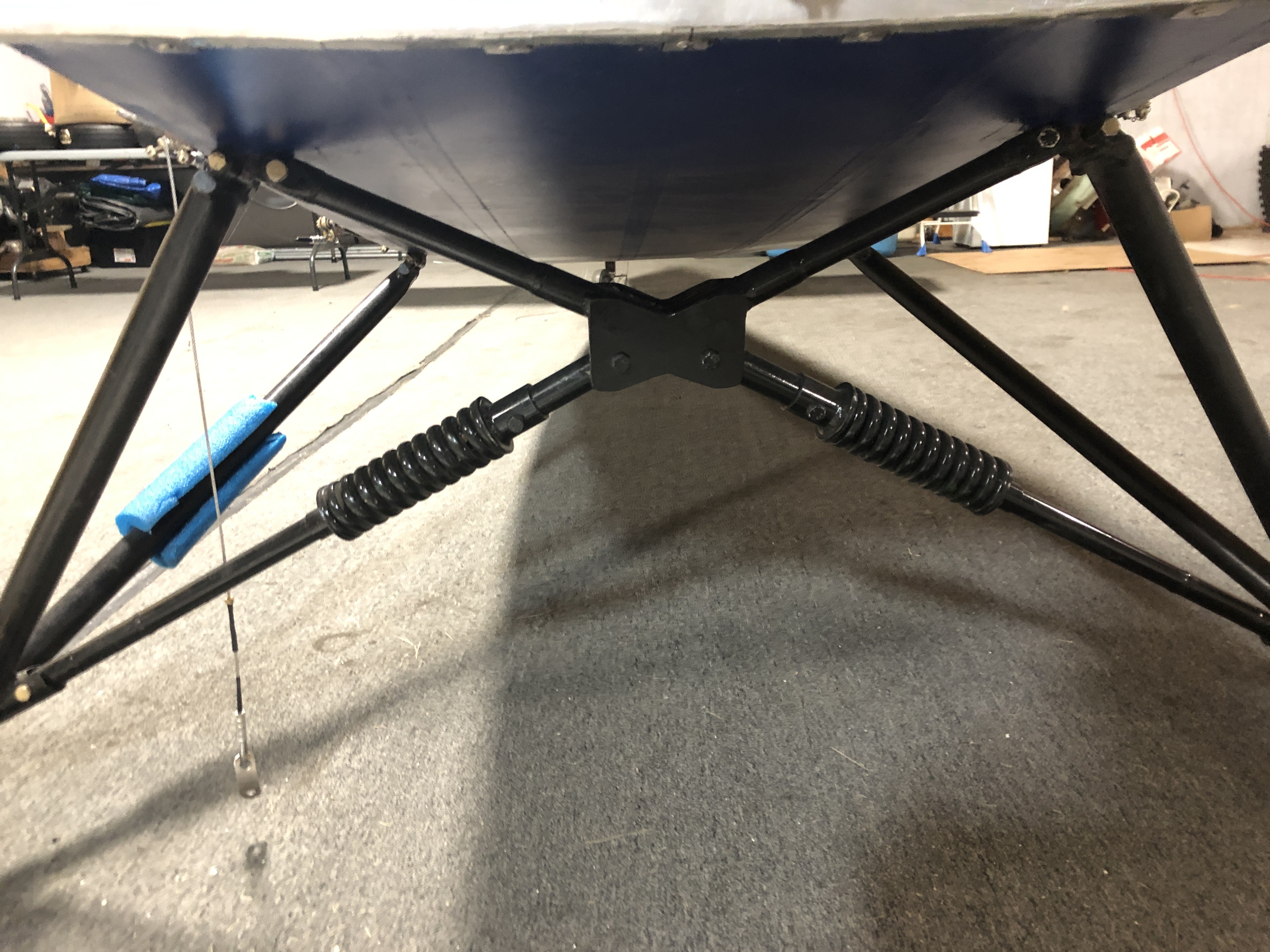

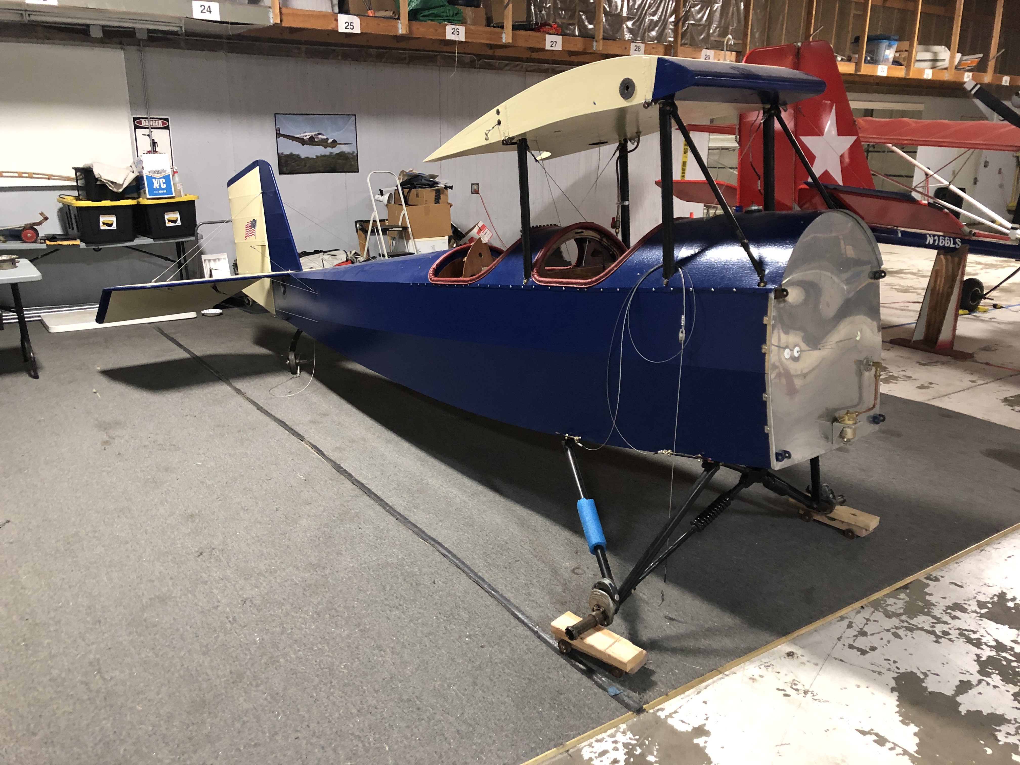

Hi
I had homework to do before replying.

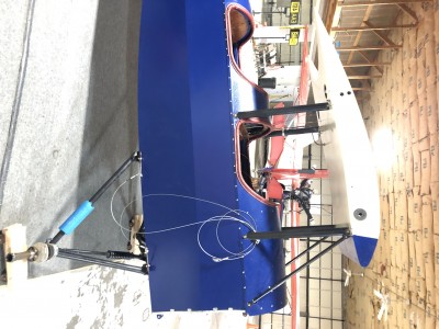

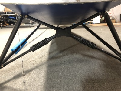

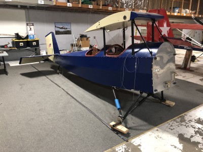

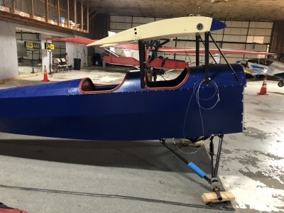

The fuselage is a long version from what we can tell. Attached are the photos I have to at least partially answer what the current configuration is.
As I mentioned in my post, the weight and balance manual emphasized the position of the gear being just aft of the L.E. So this is what caught our attention immediately.
I have to go measure things to give specifics on that. I’ll try to do that tomorrow.

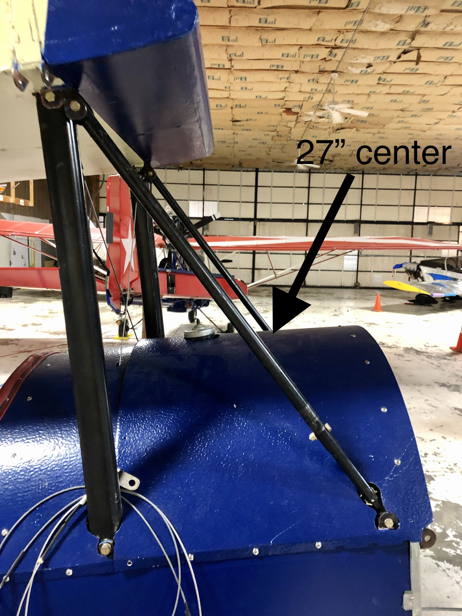

Re: EAA 461 Pietenpol project - questions
Assuming I measured this accurately, it appears to be 27” on center
We believe the fuselage is at or close to 172” long. This is from a measurement and the builders hand drawn notes.
Since we are planning an A-65 engine instead of the Corvair, our big questions are the location of the axles (again, we are referring to the weight and balance manual which we bought from BPA) and the amount the engine mount must be extended.

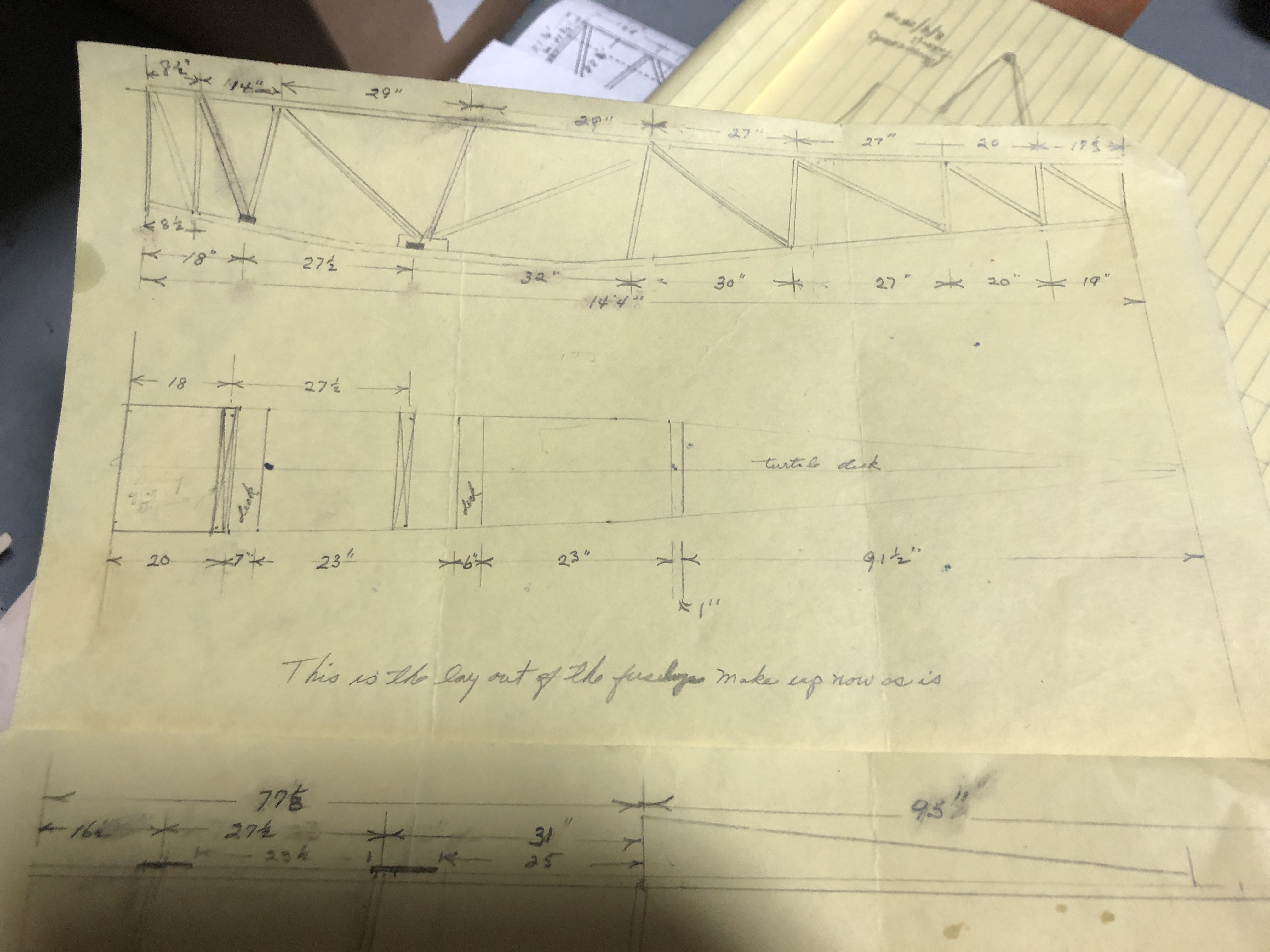

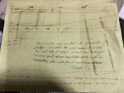

These are the notes we found in the materials that came with the airplane.

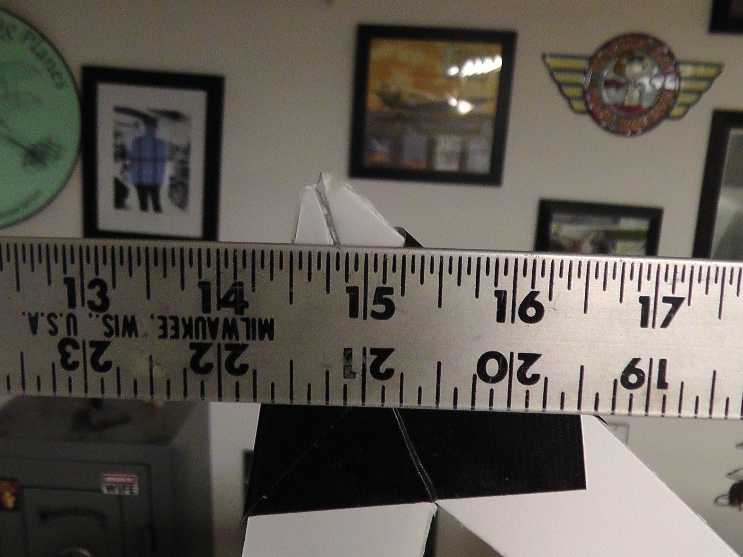

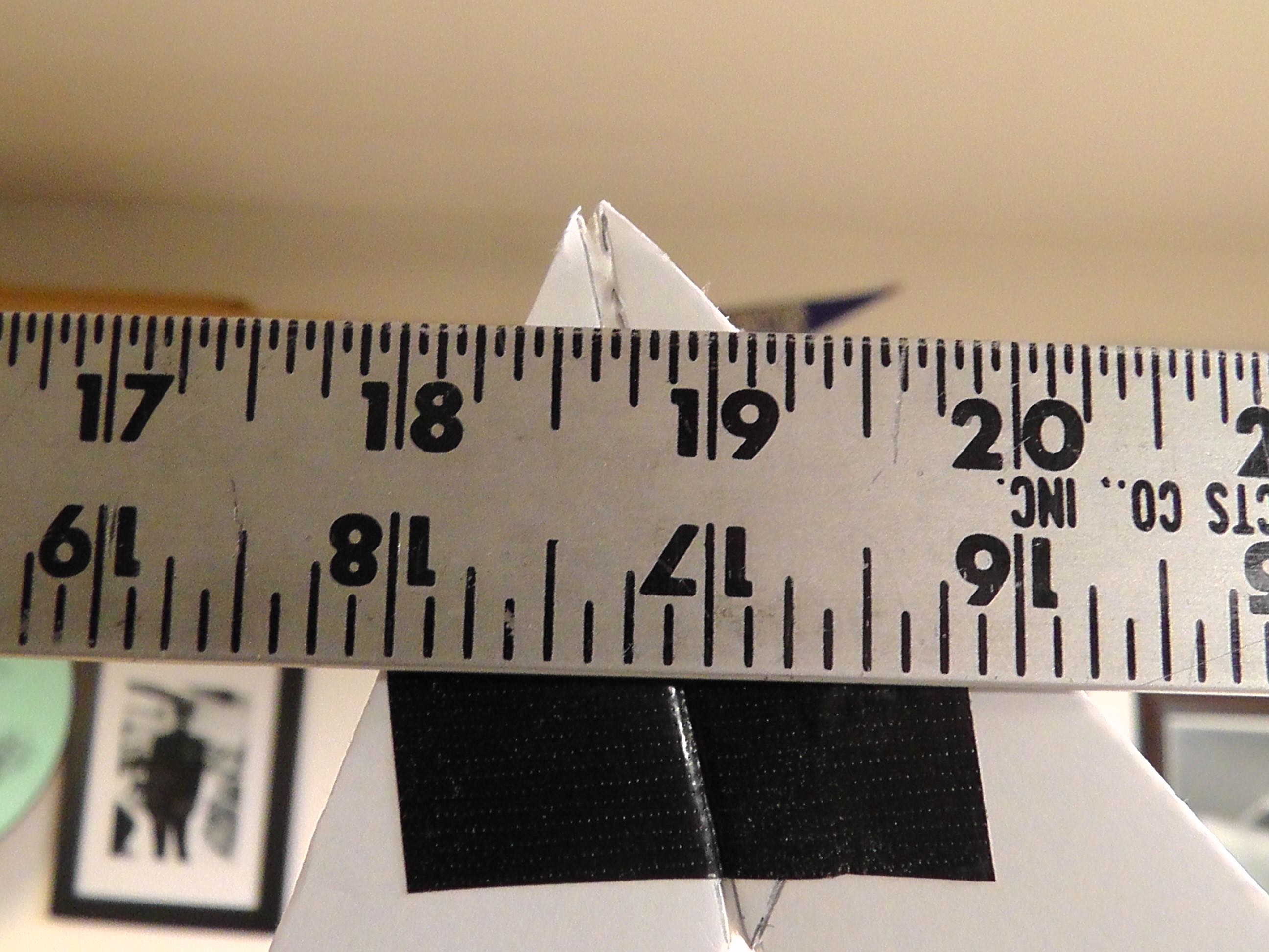

Split gear and long fuselage. How far should the center of the axle be from the firewall? I have a mock-up and I'm looking at about 19".
After review at the West Coast Piet site, I decided anything in the 15" area will work. After adjusting my "V" mock up, it looks like my axle will be about 14.75" behind firewall.
