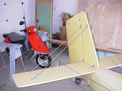

Does anyone in your chapter have a set of plans? On page 7 of mine, the wires from the Vertical Stab to the Horizontal have a common point at the Vertical, one going towards the leading edge, one going to the hinge edge of the Horizontal.
Your plane, in contrast, has two unique wires, one towards the front of the Vertical and the other towards the rear. While I don't know what the exact effect of this may have had on the life of your Vertical Stab, there could have been a destructive vibration that was caused by the two sets of wires.
Please chime in if y'all have seen other Piets with this same split wire setup, as I've only looked at around 30 or so Piets, and I can't recall seeing the wires split on any other aircraft.

Your probably talking about the picture of the yellow Piet.
Take a look at the video above. Our Piet is blue. The wires are per the plans.
