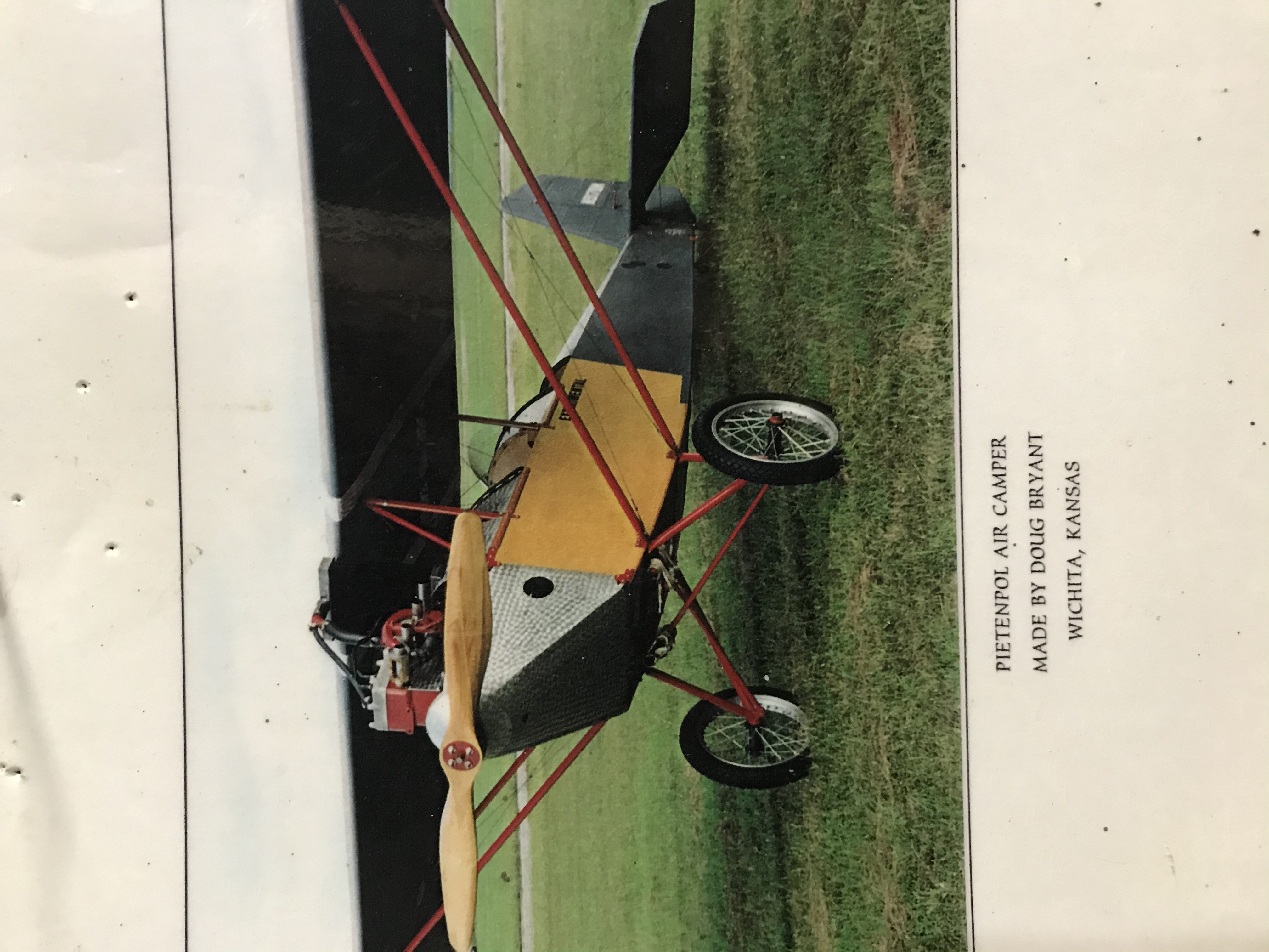

wow! that is a great benefit for the members. i have all the other tools myself but the only swager around here is 50 mi away; not very convenient. i used those barrel swages ln my first piet
