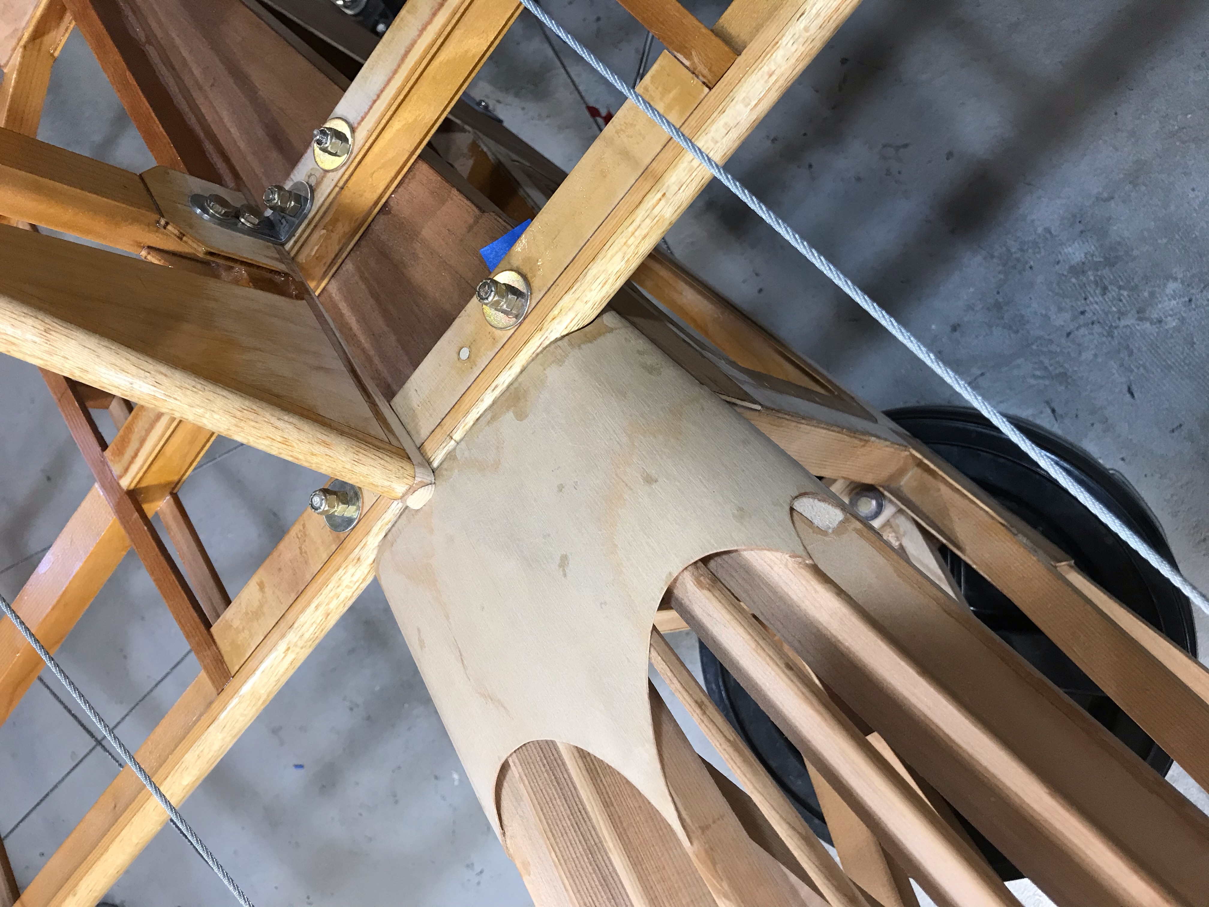

I am using bolts. These are temporary- just holding the tail so I can run the rudder and elevator cables but it's how I'm attaching them.

I built the HS first then drilled the holes.
I used one of these for the holes, but you can make a drill guide pretty easily.
