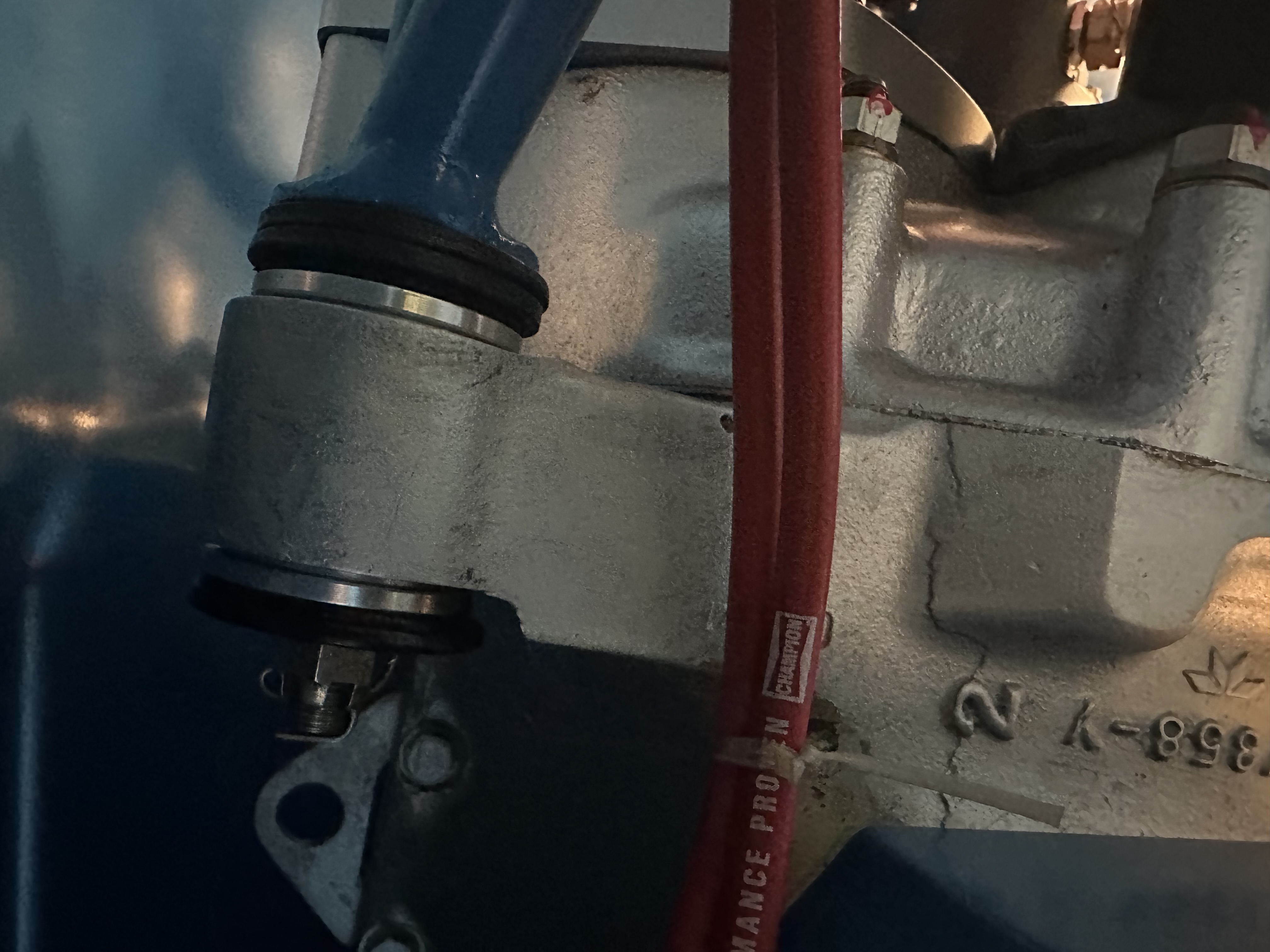

I am fab the 0200 engine mount on section AA on the drawing it shows a 7/16 dia bolt my engineer thinks it is 3/8
This is the mount to the engine bolt. John New Zealand.

I have an O-200 on my Air Camper. Your engineer is correct, they are 3/8”. Download Continental Engine Manual Form X-30010 from the internet. You will find the bolt size called out on page 36.
My O-200 case was built to use very expensive Lord Mount isolators but I was able to buy a set of adapters that made it so I could just use the regular cheap conical ones. I’m not sure if Lord isolators need a different size bolt.

What is that crack all about?

It’s a flaw in the casting mold. The lighting from the picture sure does make it look like a crack though.

Posted: Sat Mar 16, 2024 8:53 pm
by geresh
