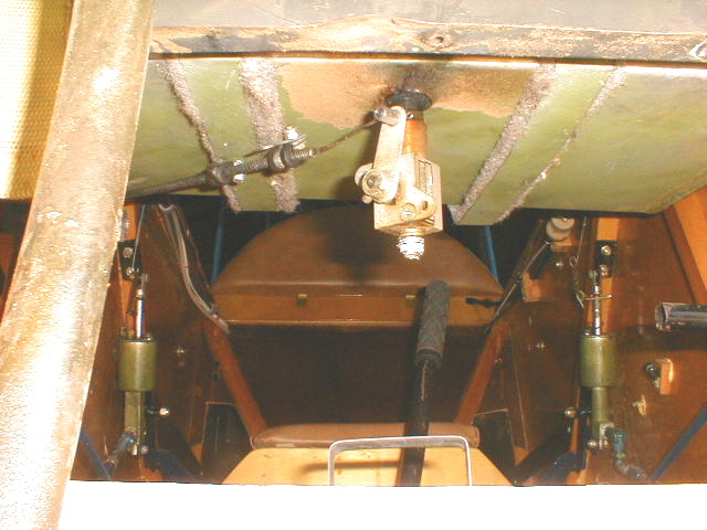

I'll relate my experience with fuel shutoff valves (on-off). Corkyhad a genuine Cessna part on the airplane when I got it. Quarter-turn, plug style.Image at http://www.flysquirrel.net/piets/repairs/P1080006.JPGI made the mistake of dismantling it for cleaning, which was a goodthing because water had taken its toll on the steel spring over time,but the bad part was that it took a real trick to get it back togetheragain. But the bottom line is that despite overhauling it, it weepedfrom the stem and there are blue fuel stains on the front cockpitfloor to show that. I needed to change it but didn't want acomparable Cessna part... $480!!!Next attempt was a quarter-turn ball valve from Lowe's, with male NPTthreads on one end and female on the other. Kind of a polished orchrome finish. I found it in the compressed air accessory sectionand it seemed to be no different from similar valves thatwere rated water-oil-gas and this is a very low pressure application.Price was right. Valve started leaking after about 30-40 hours.Latest attempt uses the brass body 1/4-turn ball valve that bothWicks and Aircraft Spruce offer. It has female NPT threads both endsand I modified the handle by adding a shaped tab to allow the samefuel shutoff cable to act on the handle with proper leverage becausethe geometry was different from the Cessna valve. So far, so good.The valve was probably ten bucks and is a very common configurationfor ball valves but I haven't seen any that small at my local hardwarestores.Oscar ZunigaAir Camper NX41CCSan Antonio, TXmailto: taildrags(at)hotmail.comwebsite at http://www.flysquirrel.net________________________________________________________________________________
