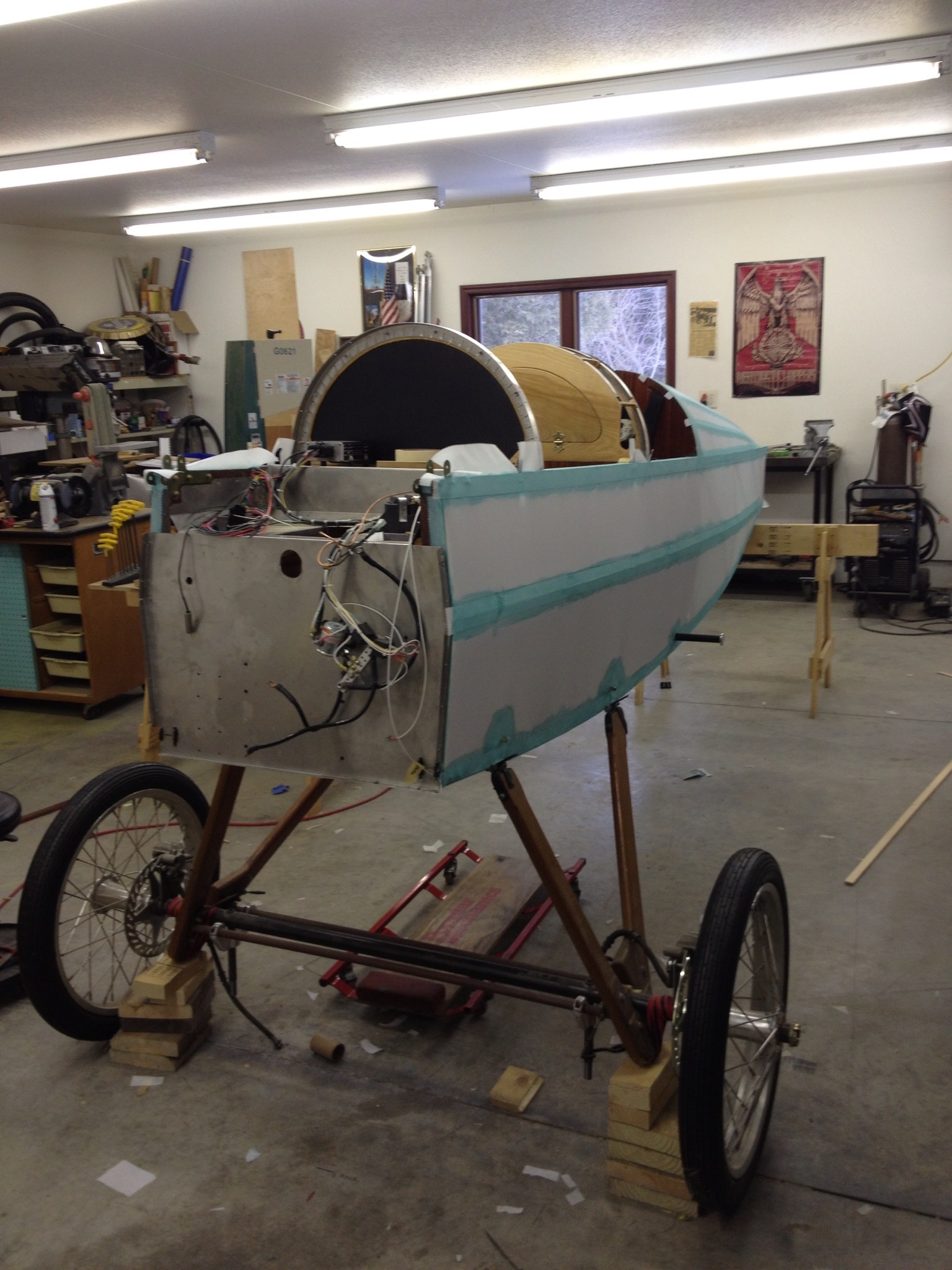

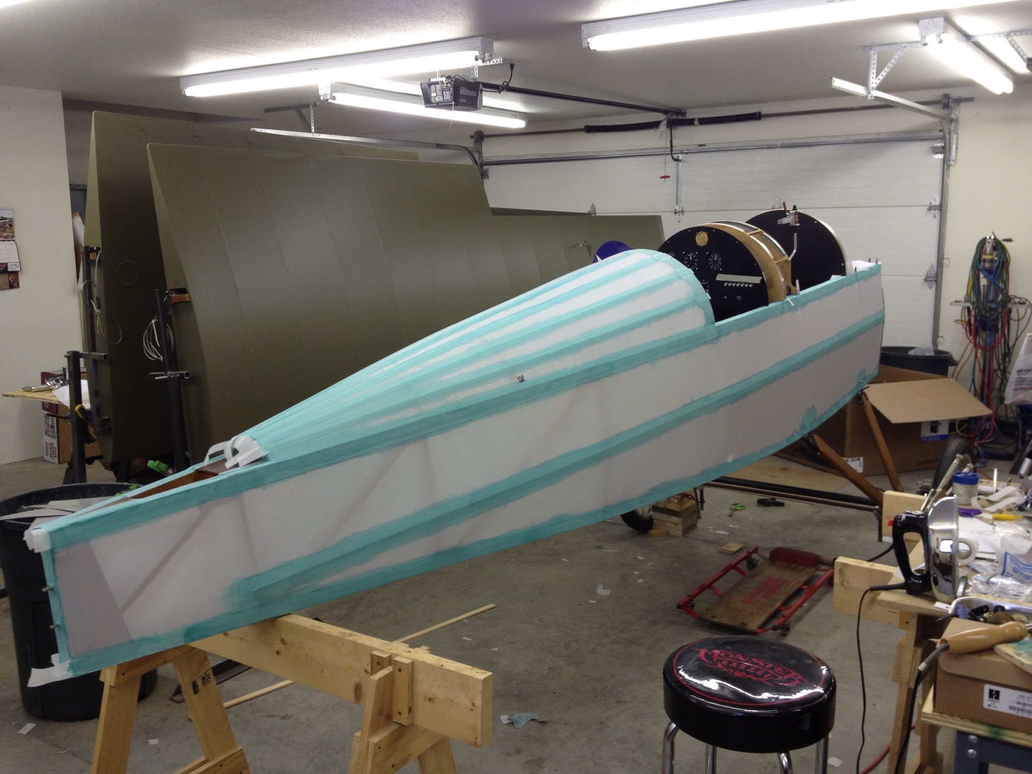

Original Posted By: "Douwe Blumberg"
Finally finished the fuselage this weekend...I had maybe a shot glass full of Ecoglue left from a gallon...came close. Prime it this week and paint the next.Then final assembly! I'm very anxious, as I can see the finish line.--------NX321LRFully AssembledTail assembly and ailerons covered and painted.Wings covered and primed, one paintedMitsubishi PoweredRead this topic online here:http://forums.matronics.com/viewtopic.p ... ttachments: http://forums.matronics.com//files/imag ... __________

Chris absolutely beautiful, I'm jealous!Jack TextorDes Moines, IA-----Original Message-----
