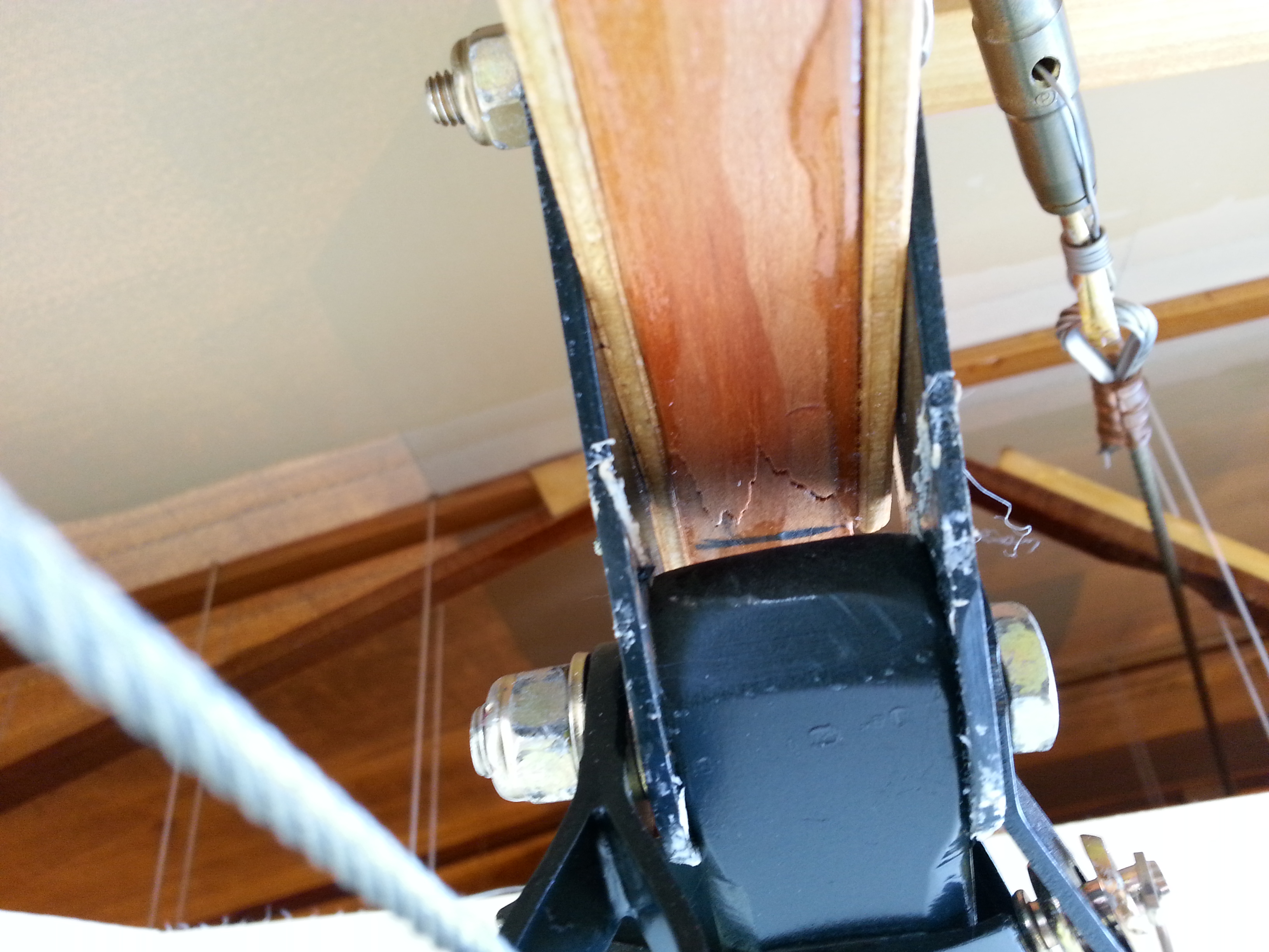

Went for the second flight in the piet today..Takeoff around the patch. . Touch and go. . And on downwind the engine stoppedNot fuel or fire. . But instant stop. .. the oil pressure was a little low butit's a model A Ford. I turned downwind earlier than normal because it seemed like rpm was a little lower.Was 2000.. on the last climb I could only get 1800....So engine out call and landing the opposite direction on the runway. .The tower had basically given me that side. . Parallel runways. Little wind from the right rear. .. not a lot of altitude. .. hit the runway alittle too step. .a bounce. .. wind portion didn't help. . But caught the wingtip..I but off fabric to take a look. Looks like two ribs need repair. .. the rear spar at the strut fitting is cracked..One piece wing. I see a splice and fabric work in my future. . The right wheeltook a beating... and the axel bent at the wheel. . Easy fix. .Read this topic online here:http://forums.matronics.com/viewtopic.p ... ttachments: http://forums.matronics.com//files/2013 ... ___Subject: Re: Pietenpol-List: engine out..

not really... it was loose after landing... the lack of RPM then sudden stop makesme think it got hot and tight. I'll check it out.What kind of oil pressure do you see normally. ? I know the car guys say even5lbs is goodit does suck a little.. not as bad as Douwes repair... i'll get it goingjeffRead this topic online here:http://forums.matronics.com/viewtopic.p ... ___Subject: Re: Pietenpol-List: Re: engine out..

It registers high (maybe 30) when cold, and routinely reads 5-10 lbs when hot. I recall Ken Perkins telling me the story of him landing in a bean field because he was worried his oil pressure was barely reading......turns out everything was OK and normal to resume his journey.When I first flew mine it had a tendency to want to "quit" on final (I only allowed this to happen once, carried more power after that) at low RPM. Now it seems to be better. I am attributing this to tightness.Dan HelsperPuryear, TN-----Original Message-----

Jeff Did your prop survive ? You are fortunate to come out unscathed . Check the Magto see if it moved or grounded, for that quick shut-down. A fuel shortage isa slower engine, but a prime will get you back with a little power.During the period of 1800 RPM could you get the engine to increase by a slightprimer set to the unlocked position? this will run a bit rich,and slower,was itlocked in the off position, during your first take-off, that caused the enginestop ? Look at each spark plug for signs of rich or lean conditions .The last? did you have a problem at full throttle on take off or did you give the Forda quick open throttle just as it started to stop ?Seem the Brain doesn't work as fast when one is in the position of unusual situations,I have been there, done that.Pieti LowellRead this topic online here:http://forums.matronics.com/viewtopic.p ... ___Subject: Pietenpol-List: Re: engine out..

The prop is ok. .. the only damage is the bent axel and the rear spar. Two ribs have a member broken. . My oil pressure was never over 10 psi..Usually around 3-5... but that's what I understood to be normal on the A.I really wonder if a lack of oil In a new engine is the culprit. I'll check everything. . Repair the wood and do it again. .I really like the idea of the A..I've really run it hard on the ground and itsbeenLike a clock. .JeffRead this topic online here:http://forums.matronics.com/viewtopic.p ... ______Date: Sun, 16 Jun 2013 07:26:50 -0700 (PDT)
