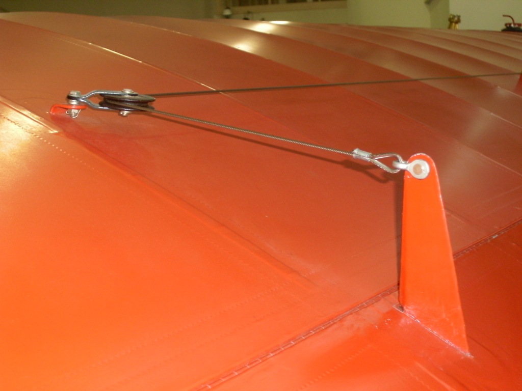

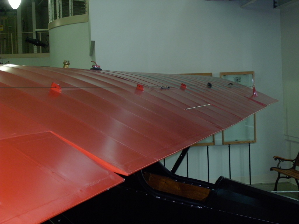

Original Posted By: "Clif Dawson"
Here is the aileron cable routing on the Pietenpol Sky Scout that is in the PortTownsend Aero Museum in Washington State. It is a really fine example of theScout and a really fine museum.--------Jake Schultz - curator,Newport Way Air Museum (OK, it's just my home)Read this topic online here:http://forums.matronics.com/viewtopic.p ... ttachments: http://forums.matronics.com//files/gedc ... __________

Original Posted By: Ray Krause
Jake and Oscar,Thanks for that photo of the Sky Scout, it all looks very familiar. But it doesgive me a good idea on how to make the cable guides. Those in the photo are moreaerodynamic than what I came up with. Guess I have something else to changeand another wasted day for what I have already done! Oh well, it's all fun andgames, that's why building a Pietenpol takes so long.Thanks guys. Any other photos would be appreciated,Ray KrauseSent from my iPad> On Nov 25, 2014, at 2:58 PM, aerocarjake wrote:> > > Here is the aileron cable routing on the Pietenpol Sky Scout that is in the PortTownsend Aero Museum in Washington State. It is a really fine example of theScout and a really fine museum.> > --------> Jake Schultz - curator,> Newport Way Air Museum (OK, it's just my home)> > > > > Read this topic online here:> > http://forums.matronics.com/viewtopic.p ... 690#434690> > > > > Attachments: > > http://forums.matronics.com//files/gedc0528_101.jpg> http://forums.matronics.com//files/gedc0632_304.jpg> > > > > > > ________________________________________________________________________________
Jake,That would be really great! Thanks you so much! I guess you really are as nicea guy as Brian said you are!I changed my rigging on the aileron idler cable to be just like the photo you sent.I'm making cable ferrules just like the ones they used. With the additionalphotos I might change some other things...this plane may never get finished.I guess getting there is the best part of the journey!Thanks so much,Ray Krause843 Jay StreetColusa, CA 95932Sent from my iPad> On Nov 27, 2014, at 12:43 PM, aerocarjake wrote:> > > Ray,> > I shot lots of photos of the Port Townsend Aero Museum's Sky Scout - includinglots of details/closeups. I could put them on a flash drive and send it to youif you get me your address.....> > --------> Jake Schultz - curator,> Newport Way Air Museum (OK, it's just my home)> > > > > Read this topic online here:> > http://forums.matronics.com/viewtopic.p ... 835#434835> > > > > > > > > > ________________________________________________________________________________
