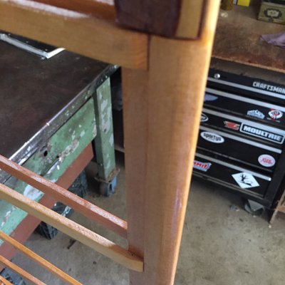

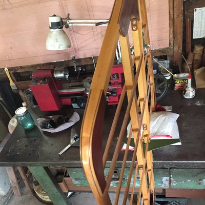

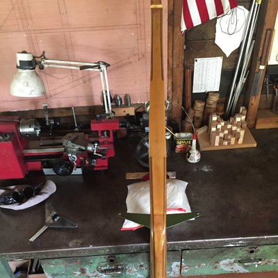

Dan, thank you very much. Your pictures cleared up a lot for me. Your workmanship, too, is a level of accomplishment that I hope to match.
Again, thank you for your time and effort.
Stephen

Dan, I apologize for asking, but I would love to see how you formed the top of the vertical stabilizer.
The craftsmanship displayed in your photos is a level I'll never achieve, but you've given me something to shoot for. I especially appreciate the way you incorporated the gussets in the corners of the rudder. Simply beautiful! And, as I said, your photos really answered a bunch of questions.
Again, my thanks.
Stephen
