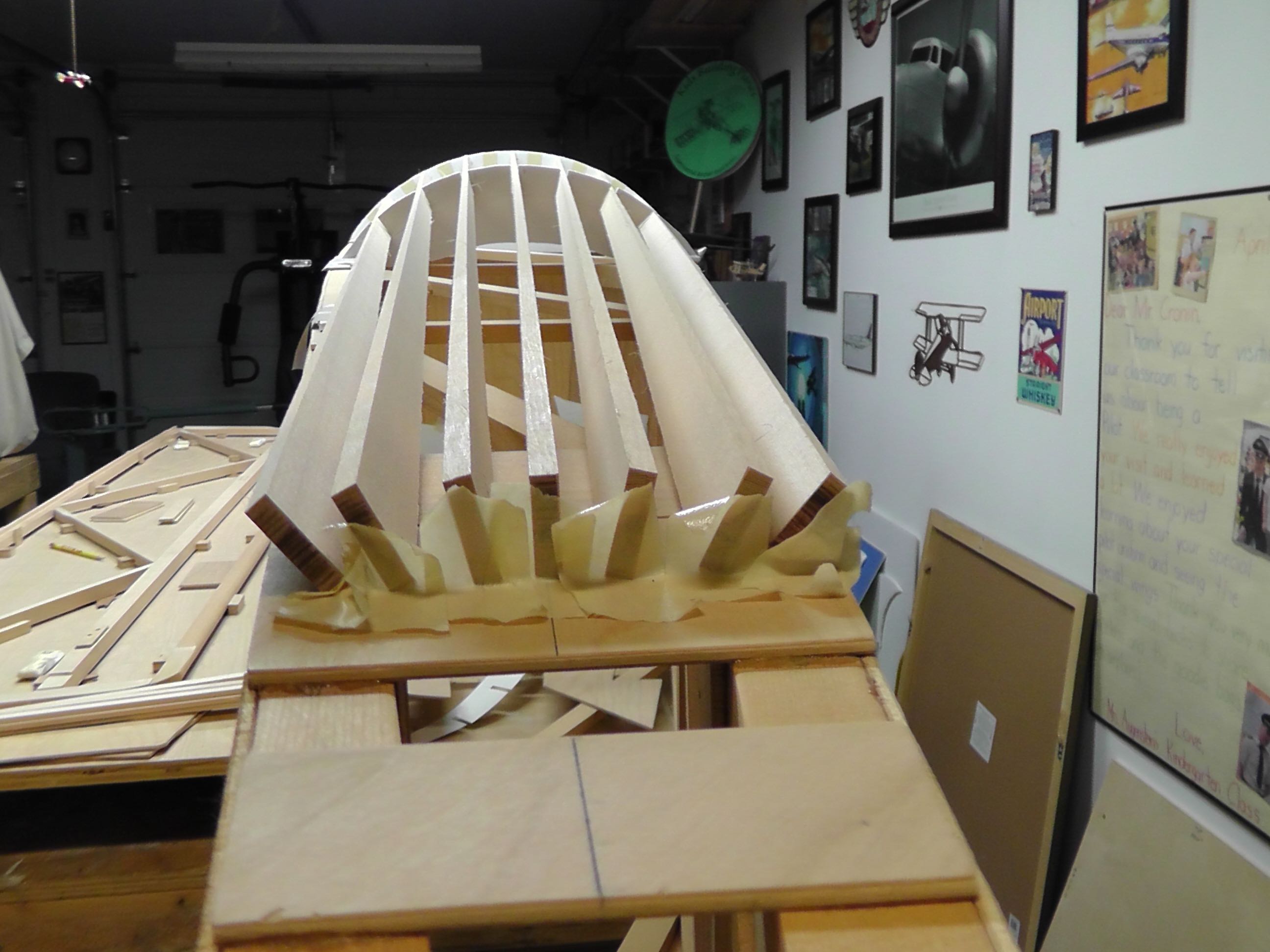

I've laid out the turtle deck. The outboard pieces seem to be higher than the inner pieces. I have some photos here and maybe you can see if I'm doing anything wrong or see a problem. I'm not sure how those outer pieces should be positioned. I don't have the back support there yet. The third photo makes it appear the piece is further back than the other's, but that's just some optical illusion; they all line up Thank you!

looks good to me. this is a place for a little adjustment and variation.

I'd try to pull the tail ends together more to get the stringers to follow the shape of the fuselage.
I also have my stringers angled toward a common center spot in the arc of the formers.

Thanks Doug! Thanks Earl! Some builders seem to wrap a thin piece of wood over those pieces at the back. Is that 1/16" that has been steamed?
- Posts: 73
Re: Any suggestions on my turtle deck
That’s what I used
