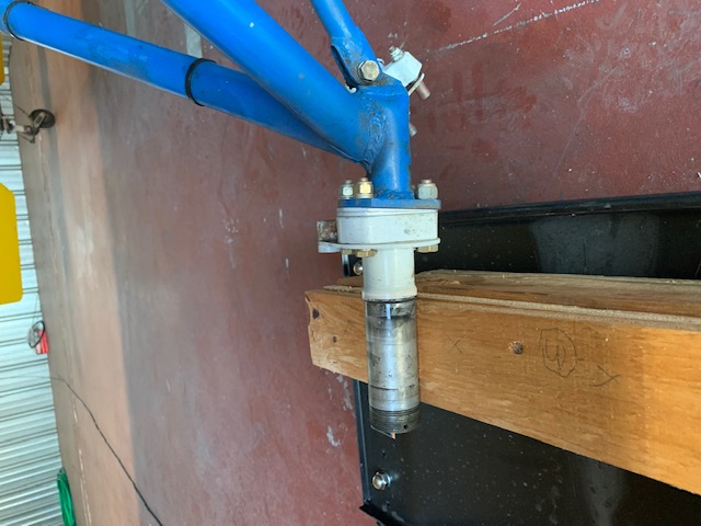

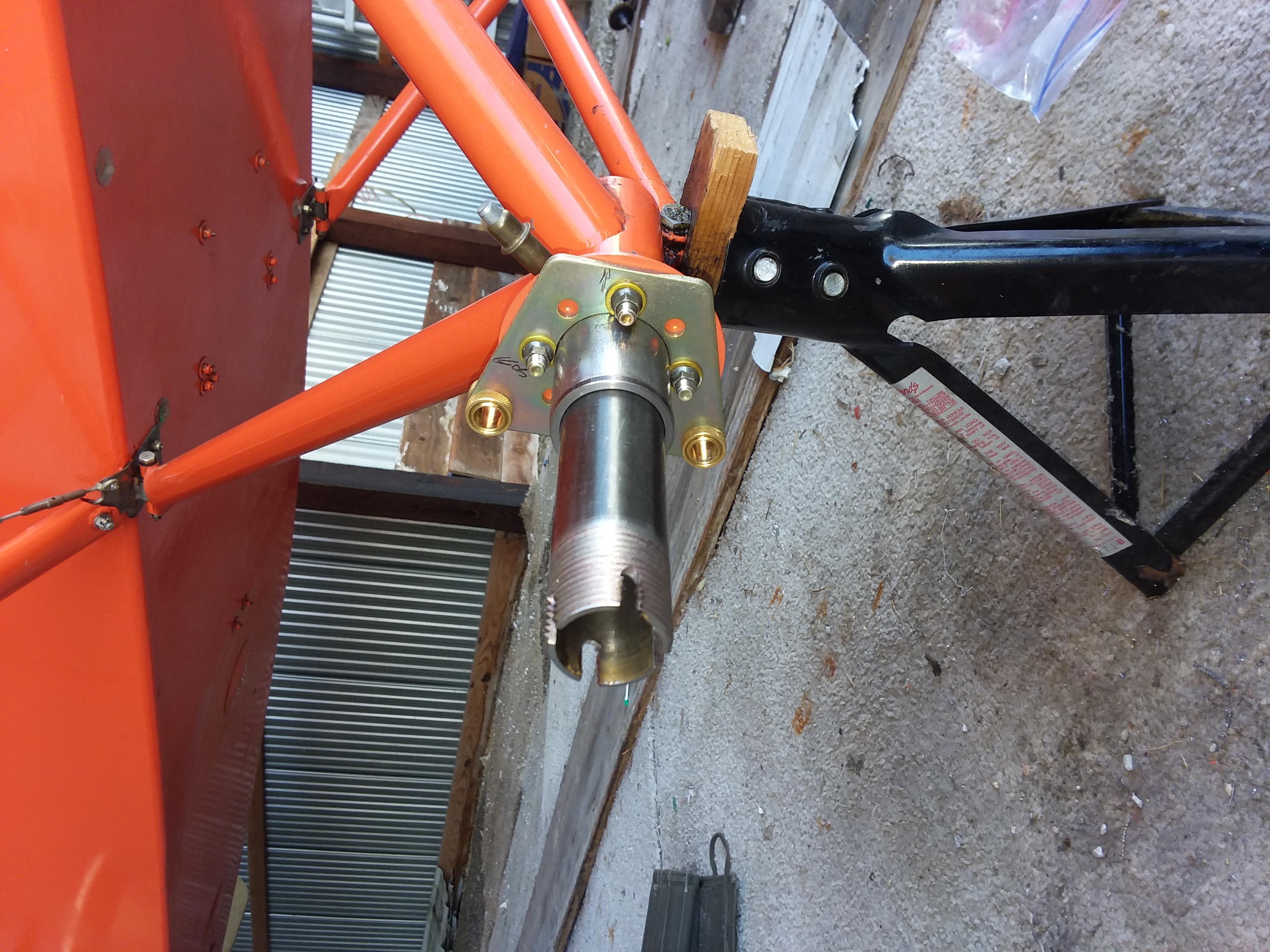

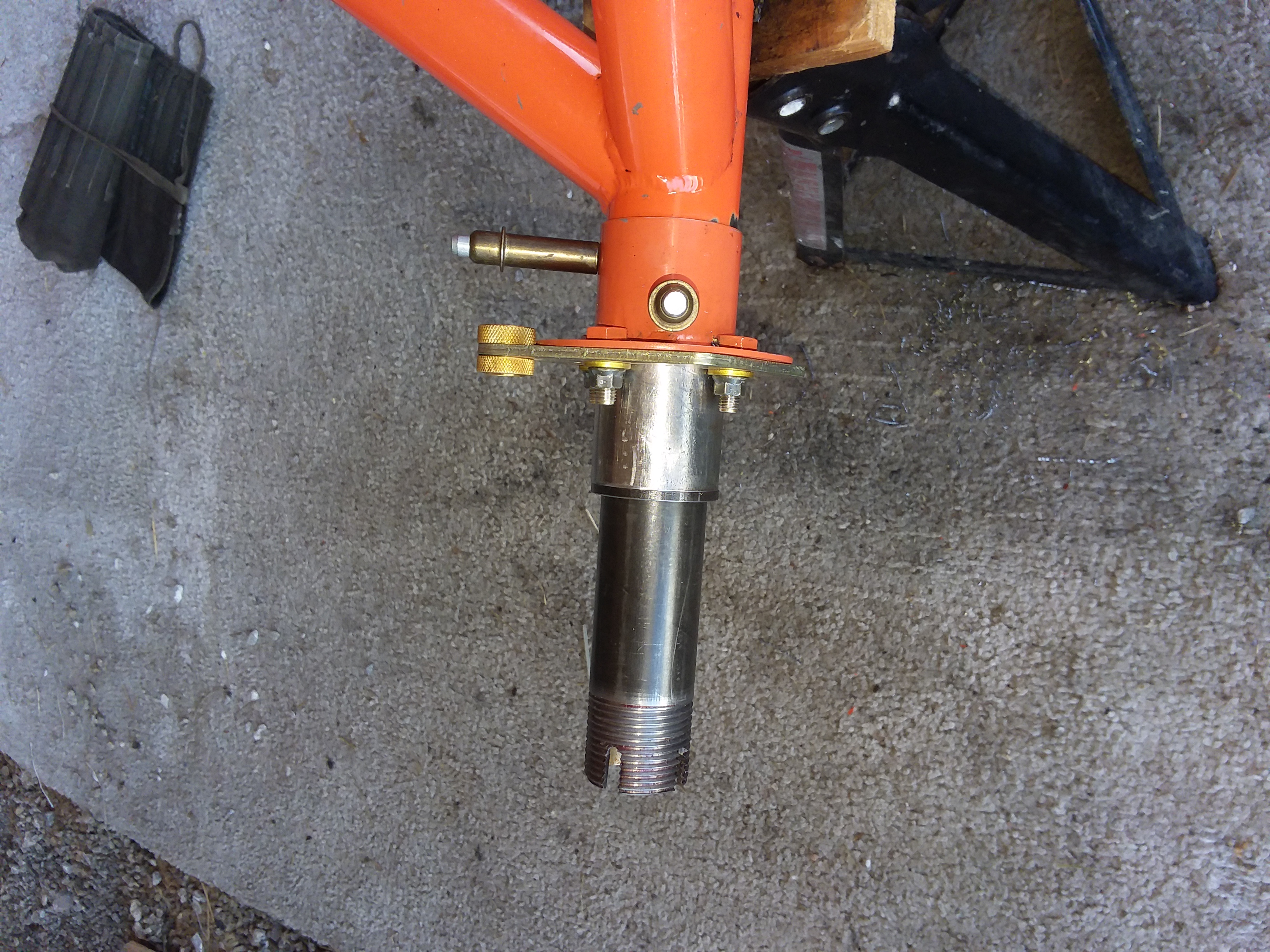

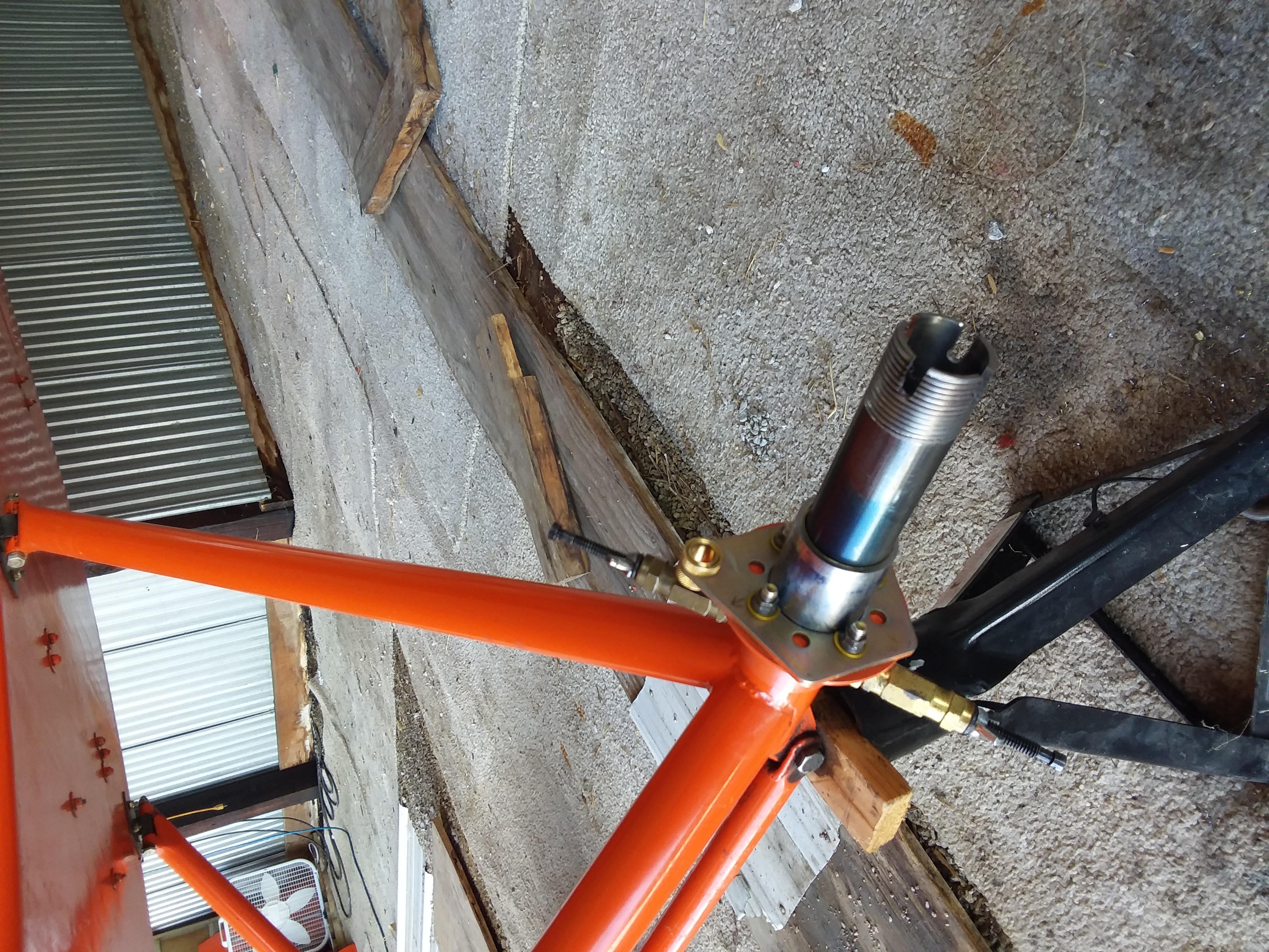

I am drawing out and ordering front gear tubing and axle parts. I am looking at a 600 X 6 weld on axle. The plans didn't accommodate brakes. My question is what to use for the inside collar that has to be welded on and will accept the wheel/brake assembly.

As you'll see from these pix of the starboard and port side axles on my airplane, they are stock items, bolted to matching pads that are welded to stubs that form clusters where the gear leg downtubes and the spring struts all attach. You may not be planning to use bolt-on Cleveland-style axle assemblies, but perhaps setups like mine and Richard Roller's will give you some ideas. Investigating my wheels and brakes, I have found that they are from a Beech Bonanza, so they are more than robust enough to handle an Air Camper. Parts are readily available, although not cheap unless you buy them used/salvaged. You will note that I had to use tapered aluminum shims (which are not cheap) on both sides and for both camber and toe, different on both sides, to get my gear geometry even-Steven and where I wanted the tires to track. I originally flew it with stacked washers between the matching pads instead of actual tapered shims, but that's not the proper or elegant way to get the tracking corrected. It is just about perfect now. -Oscar
