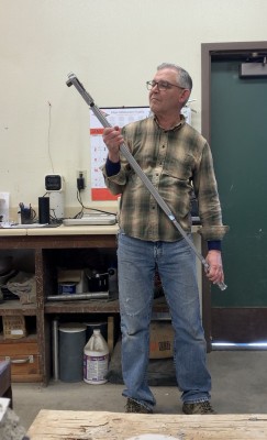

Posts: 719
Re: Specs Please
Yes, that's one way of doing it with a wrench, some spring scales, and a 3 ft cheater bar. That is, unless you have access to one of these (like I do)-
