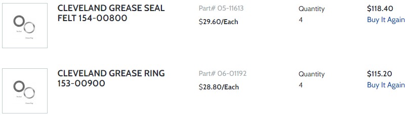

PS, you'll find the thin stainless rings and the felt seals in the Landing Gear section of the Aircraft Spruce catalog, under Cleveland 6.00 wheels. I'll get you the part numbers.
Posts: 719
Re: Bearings for rims (and tire tube)
John: these are the parts that I used on my wheels.

John; just bear in mind that there are dozens and dozens of variations of these wheels out there, some take different parts for different reasons (which I found out the hard way). The parts that my wheels use may be different from yours. And it looks like you already have very decent felt rings and thin stainless rings, no need for new ones, so it's just a matter of cleaning and inspecting everything and assembling once you have your new bearings all greased up and ready to install. I put on disposable gloves and hand-packed my new bearings by scooping them through the tub of grease (aircraft supply aisle at AutoZone), but the auto places also have a little bearing packer gadget that presses grease uniformly through the bearing by pressing down on it. No need to pay for one of those unless you plan to do a lot of bearings ;o)
