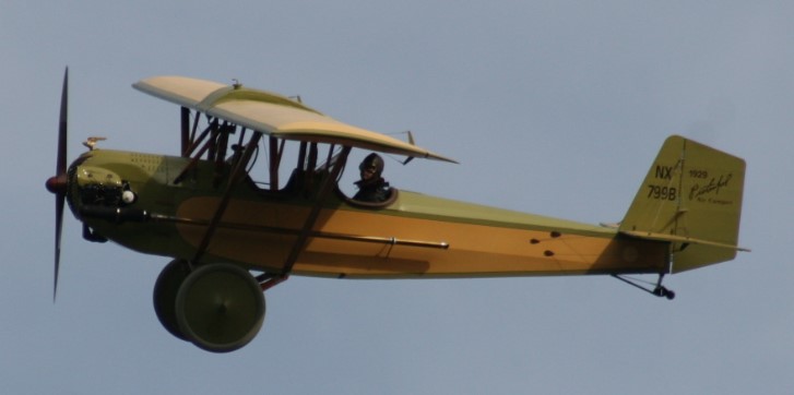

Zoomboy: if you'll scroll down through the topics on this forum, you'll find posts under "Tiger Moth style tank" or something like that. Several builders (Douwe Blumberg; Kevin Purtee) have bumped up the top of their centersection tanks to get increased fuel capacity. Douwe reported that his enlarged tank can hold something like 21 gallons, and the appearance is pretty cool too... like a de Havilland. Doing it this way lets you construct the wing centersection without modifications and that includes the ability to move the wing back to adjust the CG if needed. I think if you increase the width of the centersection, that moves the upper attach points of the cabane struts and removes some of the adjustability of shifting the wing.

Re: Larger centre section
Here's Douwe's:
