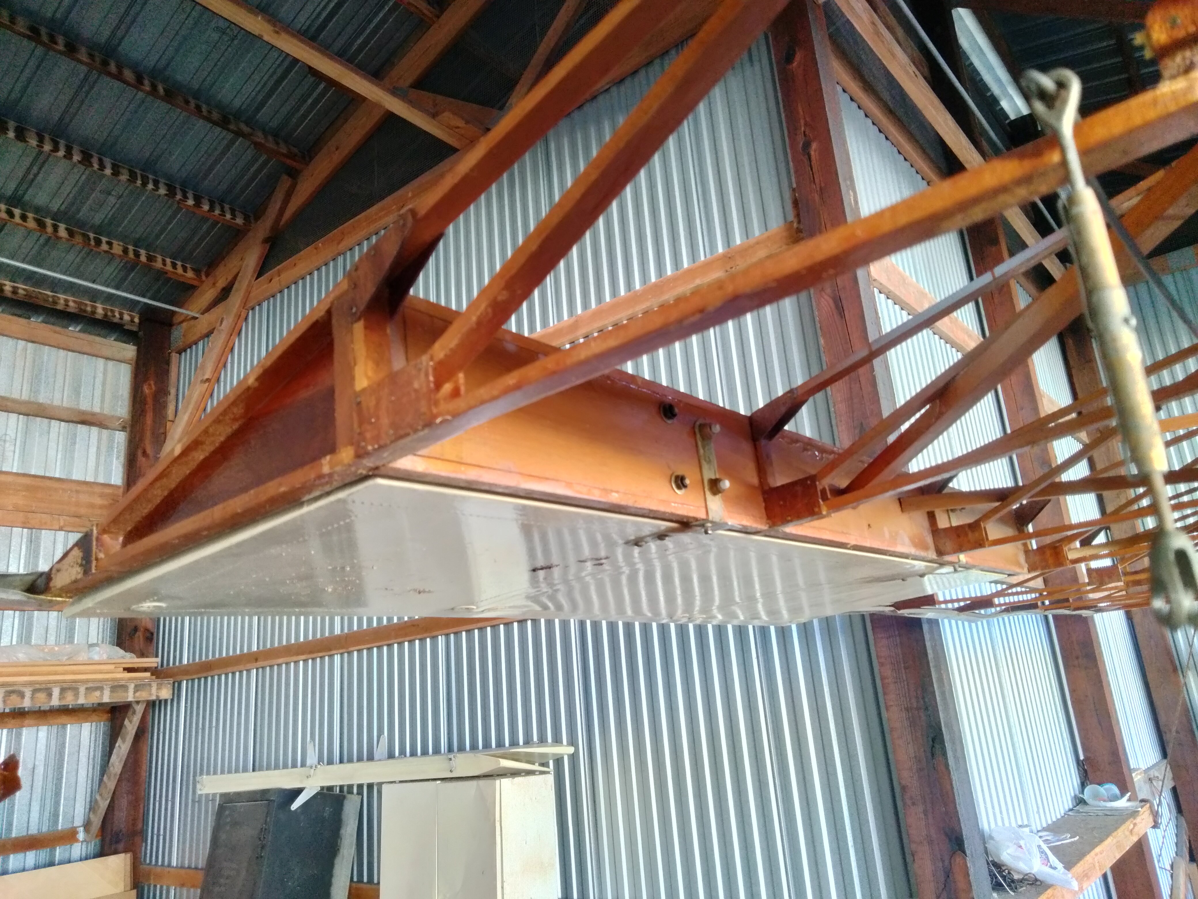

Post by Chuck in Indiana »
While I'm planning a couse of action on building the center section, I've searched here (maybe not well enough) for pix of how people have done the flop. I'm *assuming* There needs to be a sub spar aft of the rear spar strong enough for a hand hold and to hinge the flop from?
Any pix of that construction? Thanks!
Posts: 713
Re: Flop

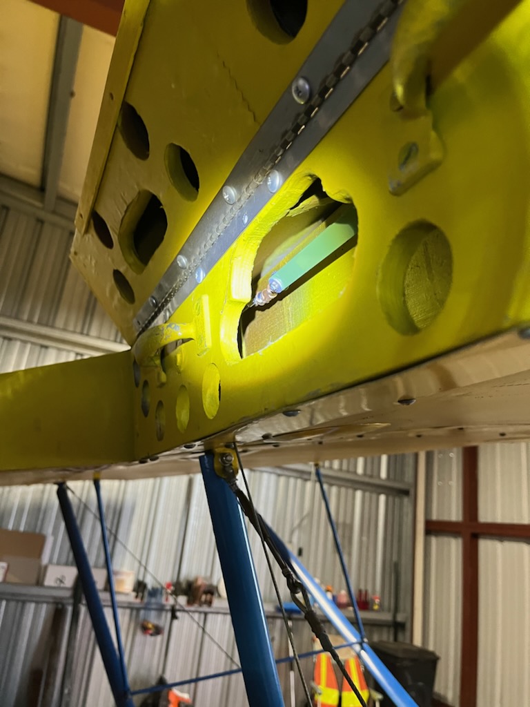

Chuck; a couple of photos of the setup on my plane are attached. It's just as you describe, with a false spar aft of the centersection aft spar, and mine has numerous openings in it for access to the aileron connecting cable that crosses through the space between the aft spar and the false spar. I fabricated a removable link between the port and starboard ends of the connecting cable and in the past it's proven very handy when removing the wings. A turnbuckle can be used in place of the link that I used but they're more trouble and fuss than my setup, which has clevis pins with very simple cotter pins at each end. I've also included a shot from under the wing, showing how that cavity can also be accessed from below.
Note that since the flop itself is entirely aft of the rear spar, it can be made wider than the centersection on the port side to make it easier for the pilot's head to clear, but mine is just the standard width... same as the centersection.

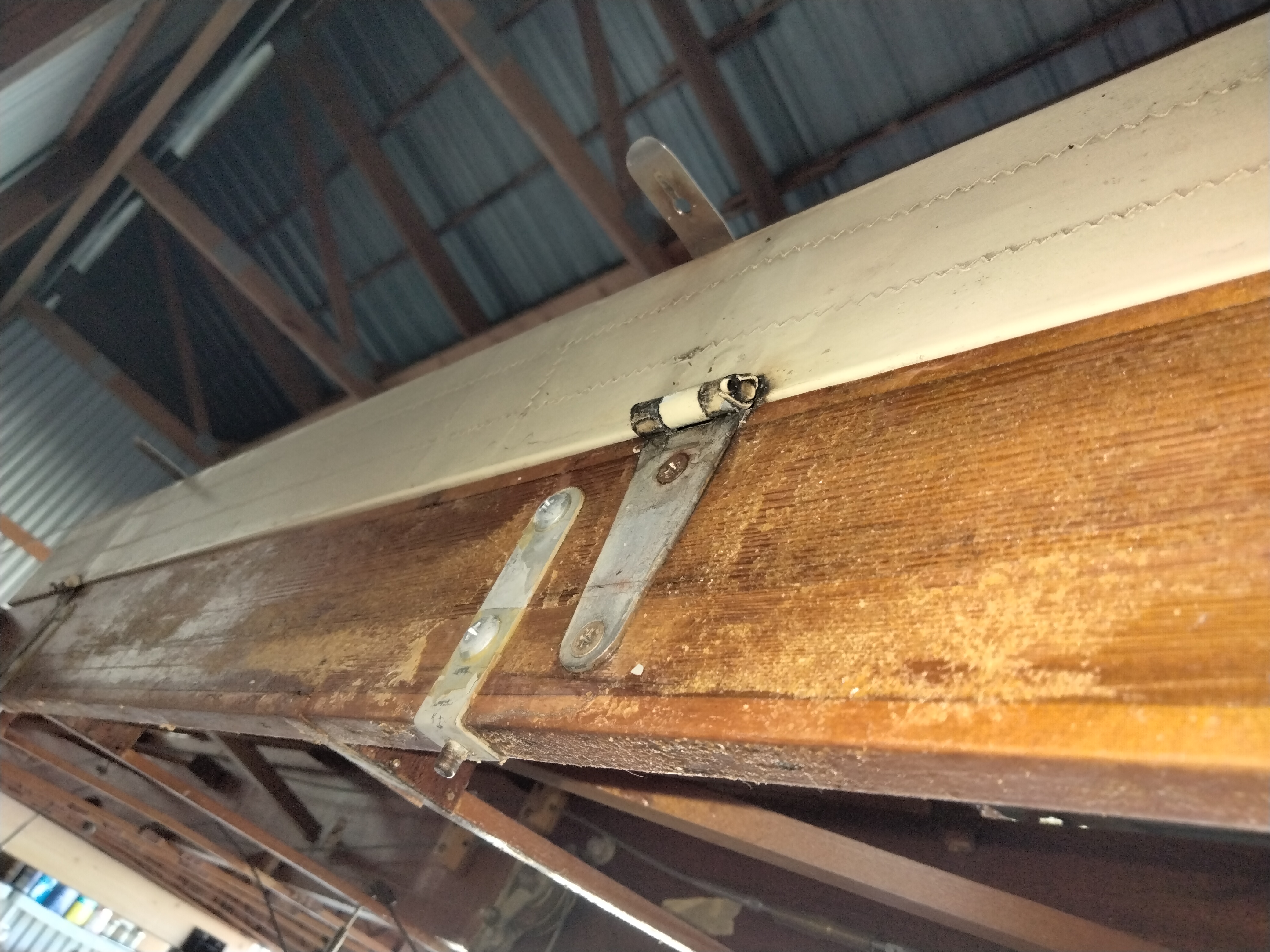

Essentially the builder of my bird copied the aileron spar setup, including location on the rib and the strap style hinges, with the spar piece being one rib bay wider than the center section on the left side. That is for ease of entering the pilots seat. This setup will lie flat on the top of the wing.

Richard's point about the flop lying flat on top of the wing is not only useful, it's important. The hinge on my flop wasn't properly placed when it was installed and I'm too lazy to mess with it, but in short, it doesn't provide enough swing for the flop to go all the way forward to lie flat on top of the wing. No big deal unless a wind is blowing, and in that case it can flop around and pull the screws that hold the hinge in place out of their attach points, or it can flop backwards. In any case, when you fit up your flop, make sure it lies nice and flat when pivoted forward. I wish mine was, and one of these days I'll refit it correctly before it pulls out the hinge screws out or something...
