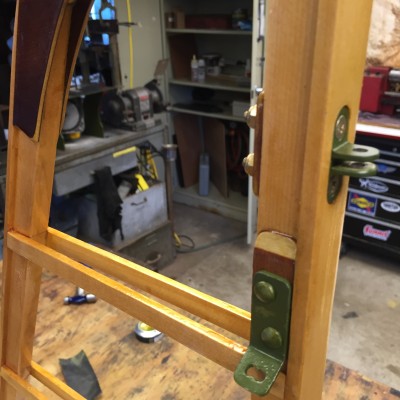

I used #8 MS screws and nuts.
Seems to be working out so far.

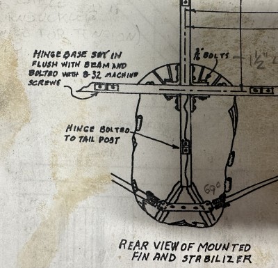

my goodness, right there in front of me, thank you! 8-32 it is.

Just for additional information, here's how the GN1 has the hinges (eyebolts).
