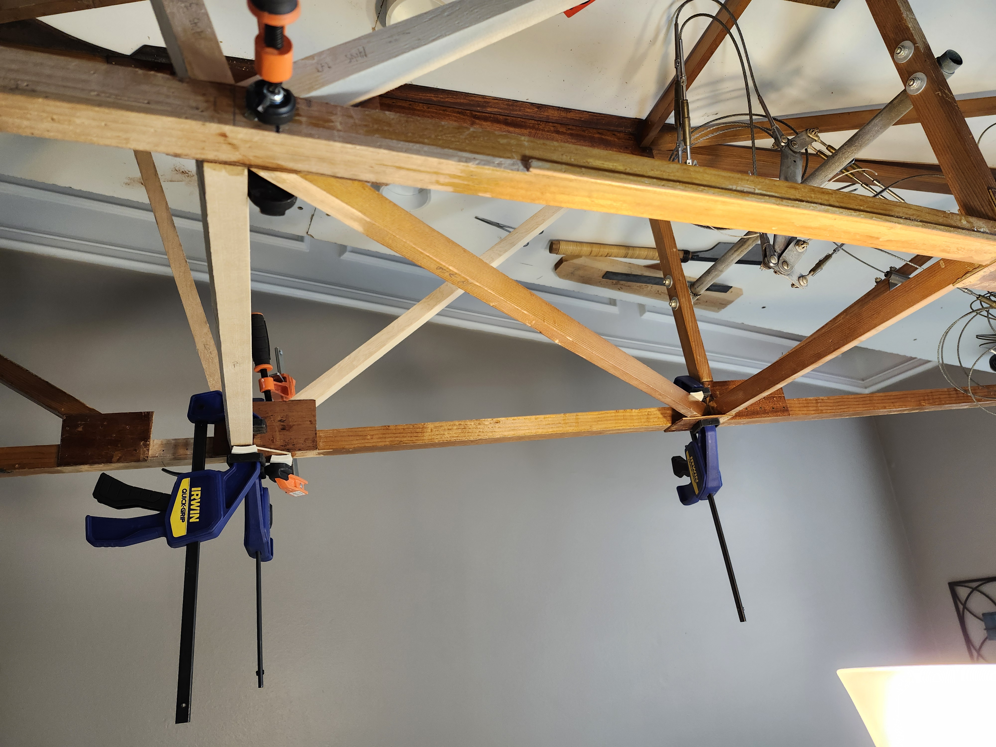

- Posts: 338
Re: N34KP's rebuild
It's been a while since I could work on the Piet. Yesterday I glued in one piece of the left rear cabane station.

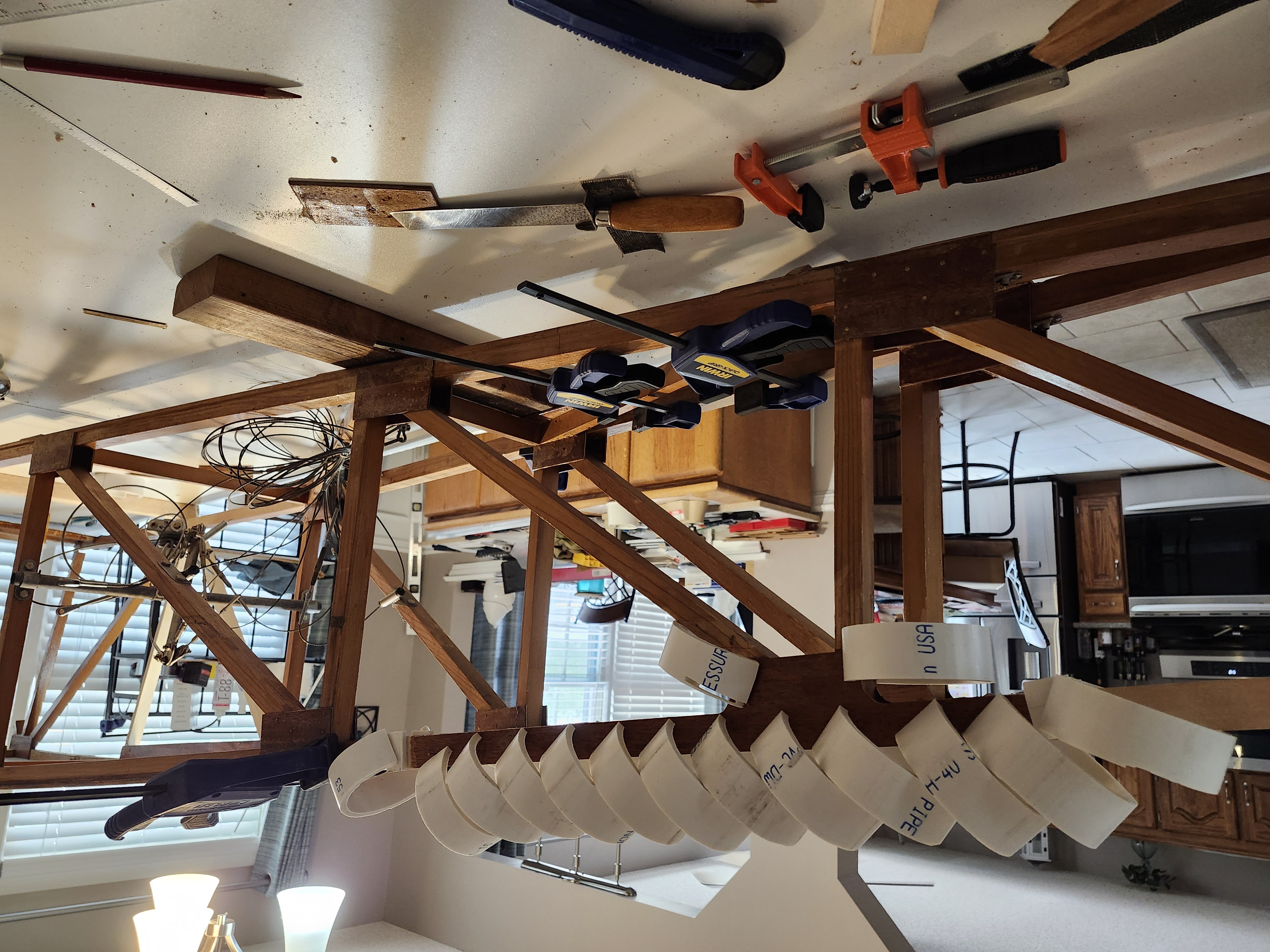

- Posts: 338

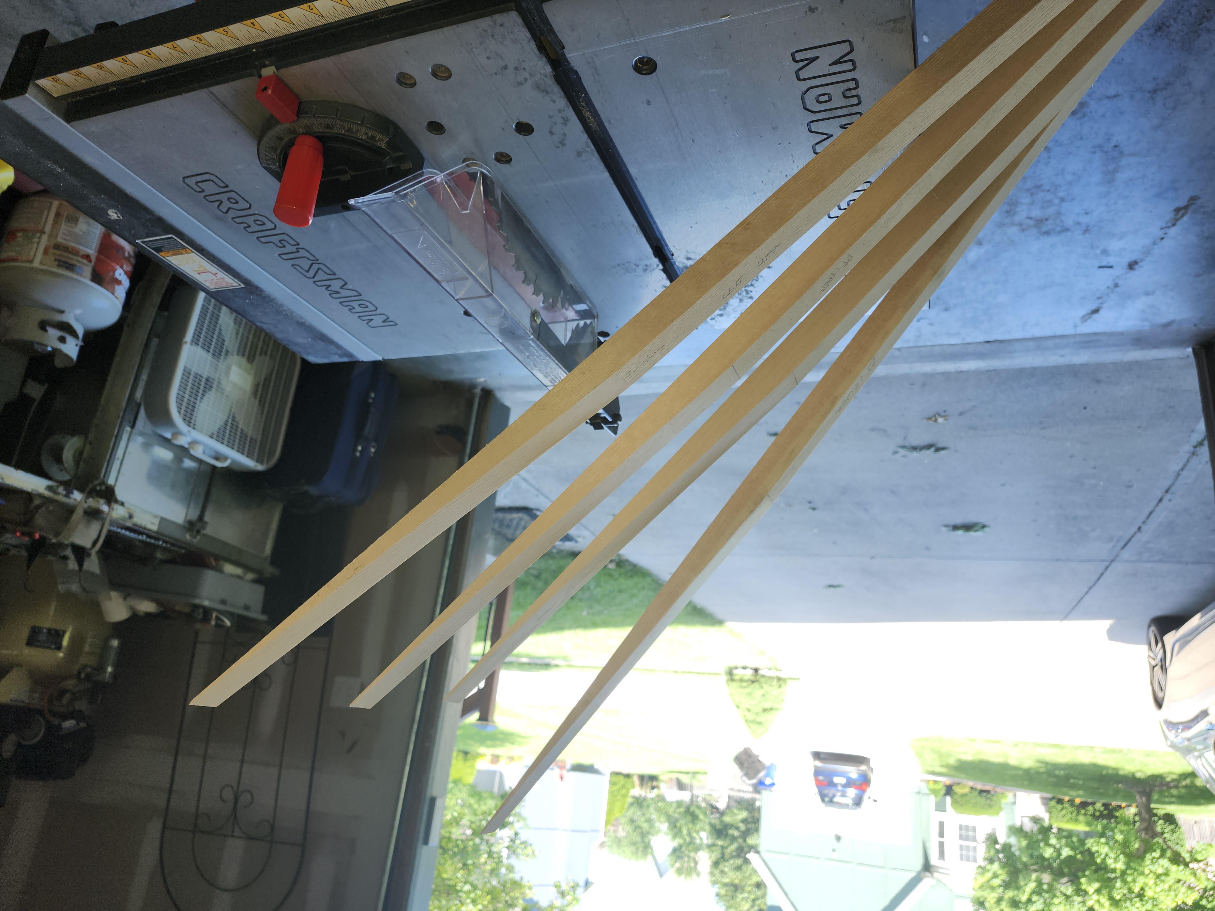

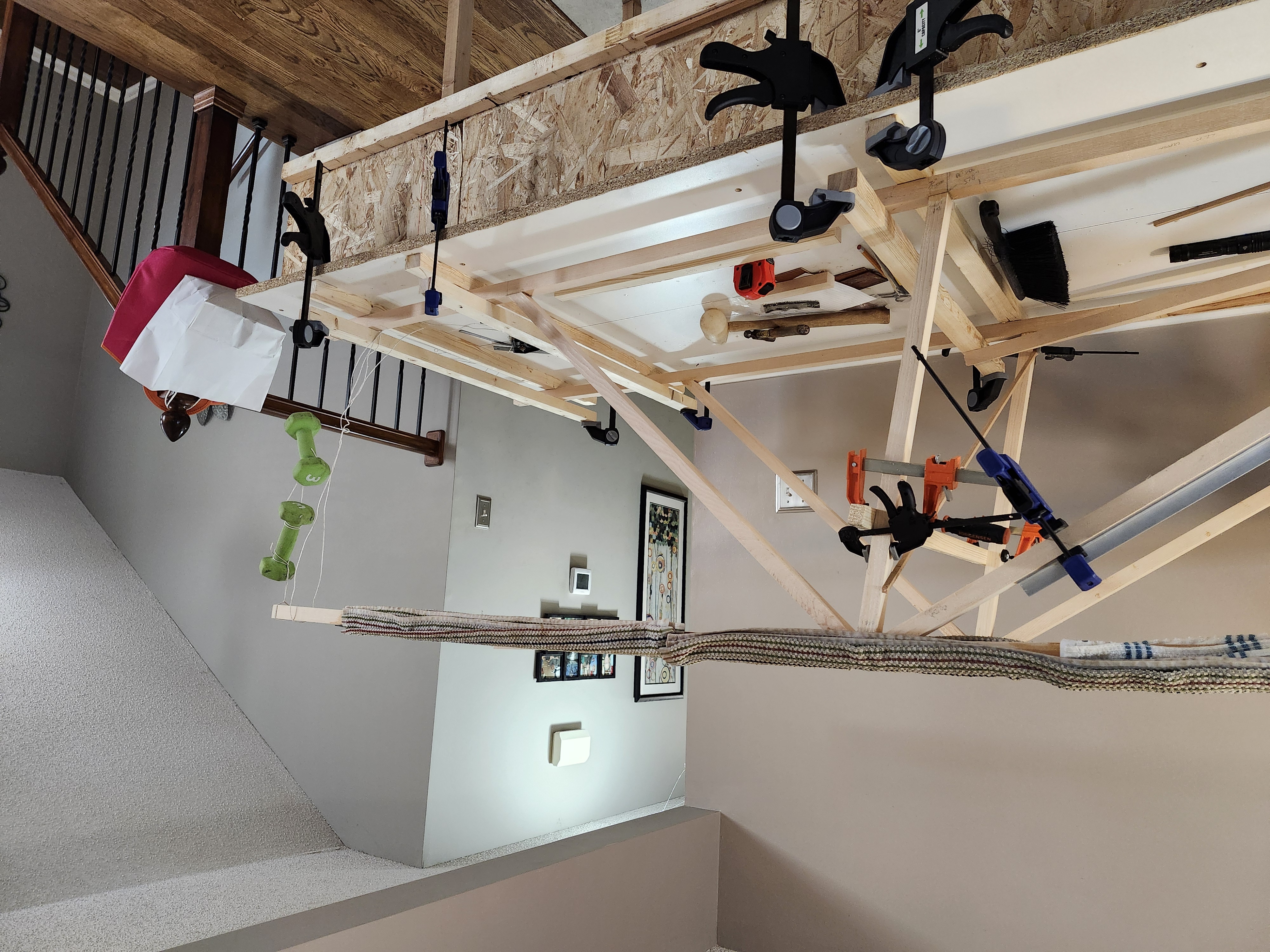

Re: N34KP's rebuild
Bending a longeron. It dropped 2-1/8" at the end overnight. 6 lbs of weight hanging on the end.

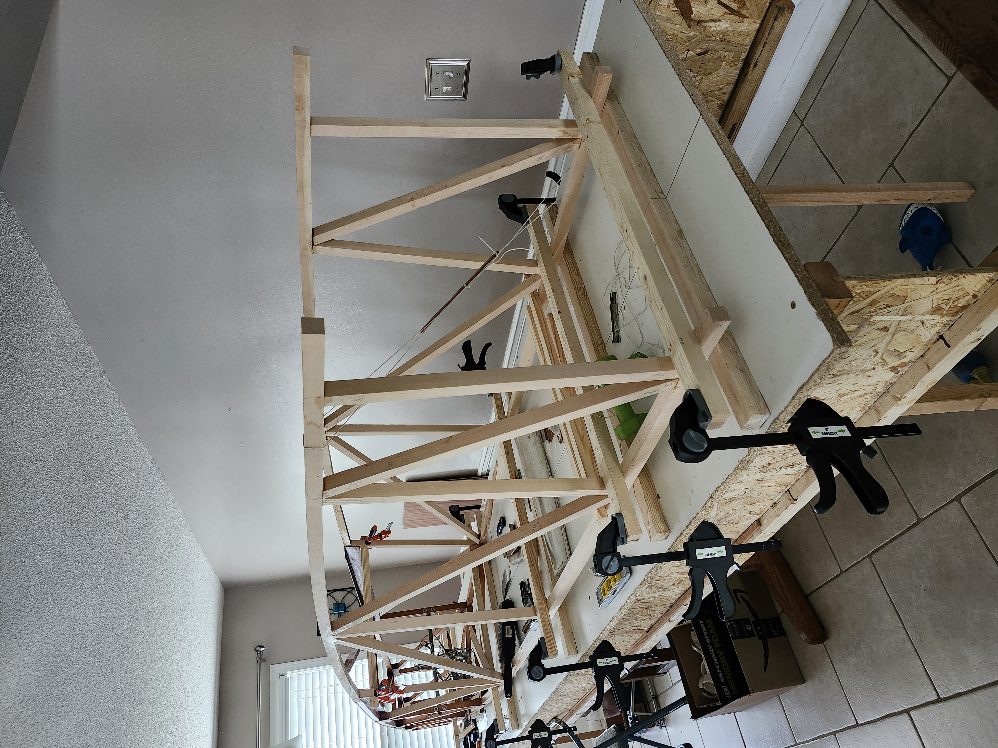

- Posts: 338
- Posts: 338
Re: N34KP's rebuild
Up to the firewall on the left side.

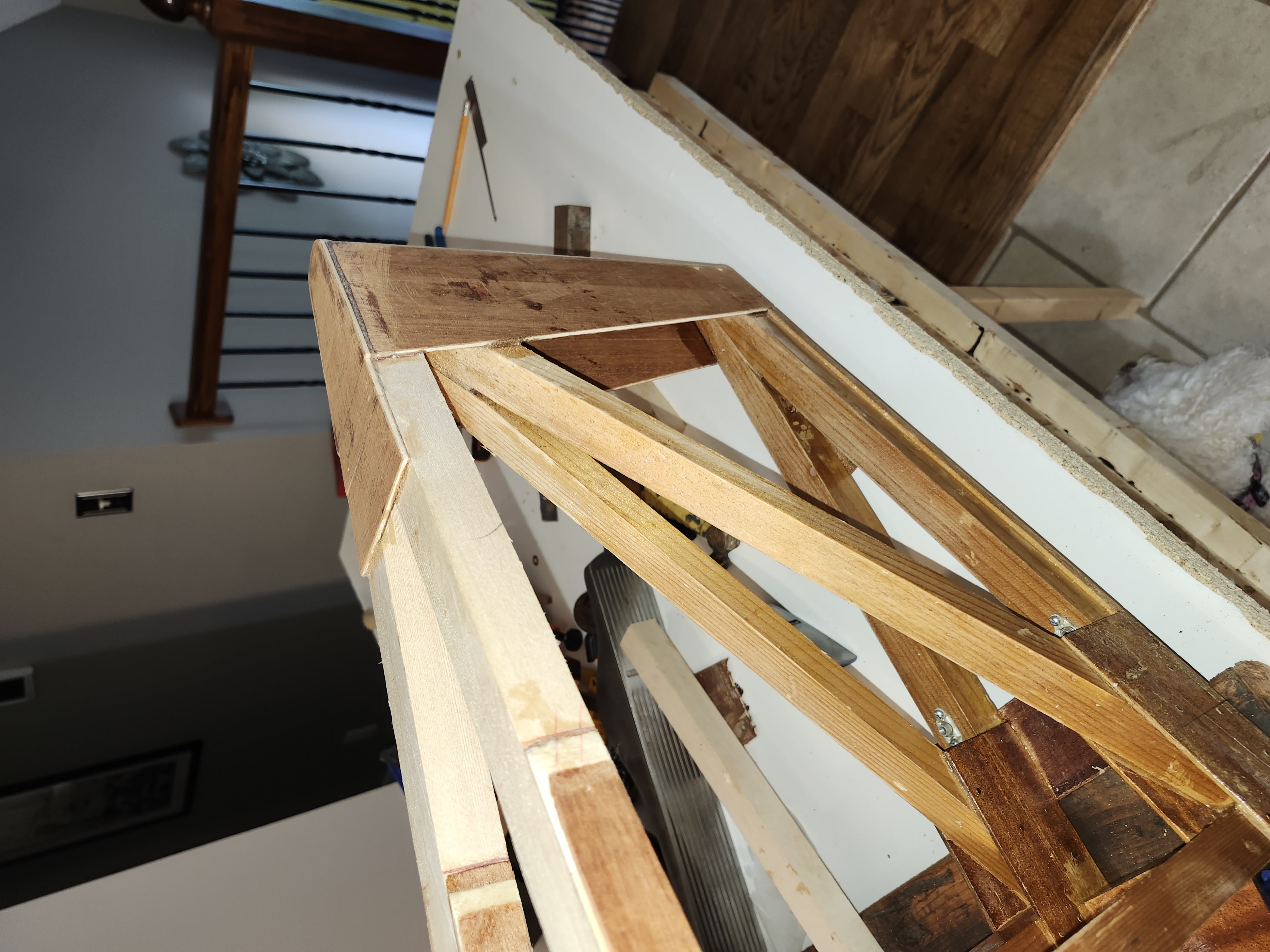

- Posts: 338
Re: N34KP's rebuild
The side trusses are done. Time for inside gussets and station cross pieces.

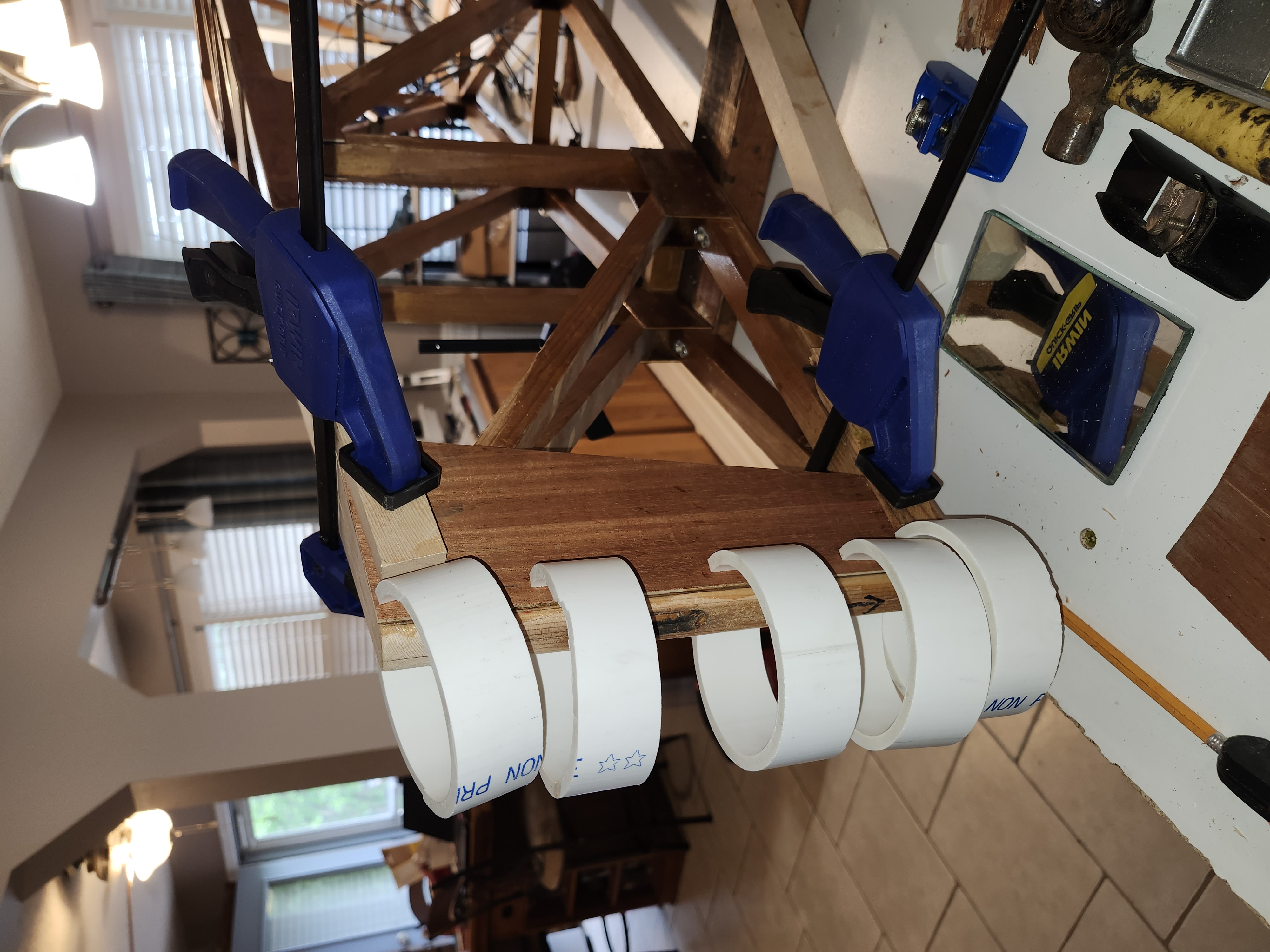

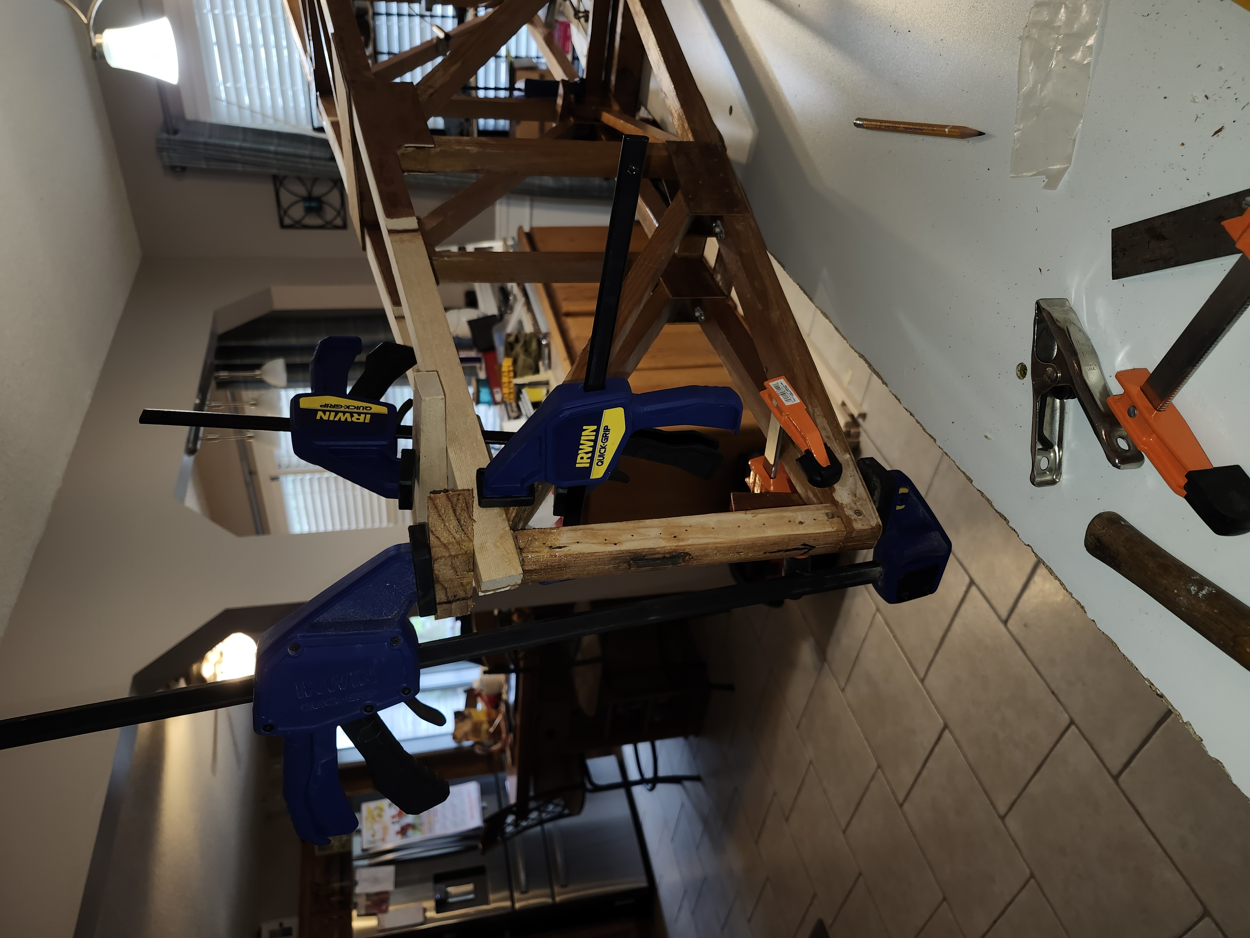

Re: N34KP's rebuild
I hadn't worked on the Piet since the third week of June, due to my wife's memorial and my general lack of desire to do anything. But today I started cutting inside gussets. The one shown, inside lower right, has a long one. The gussets for the longeron splice and the station came so close together I decided to combine then. It'll be the same way on the opposite lower longeron.
- Posts: 338
Re: N34KP's rebuild
After the clamps and final shaping.

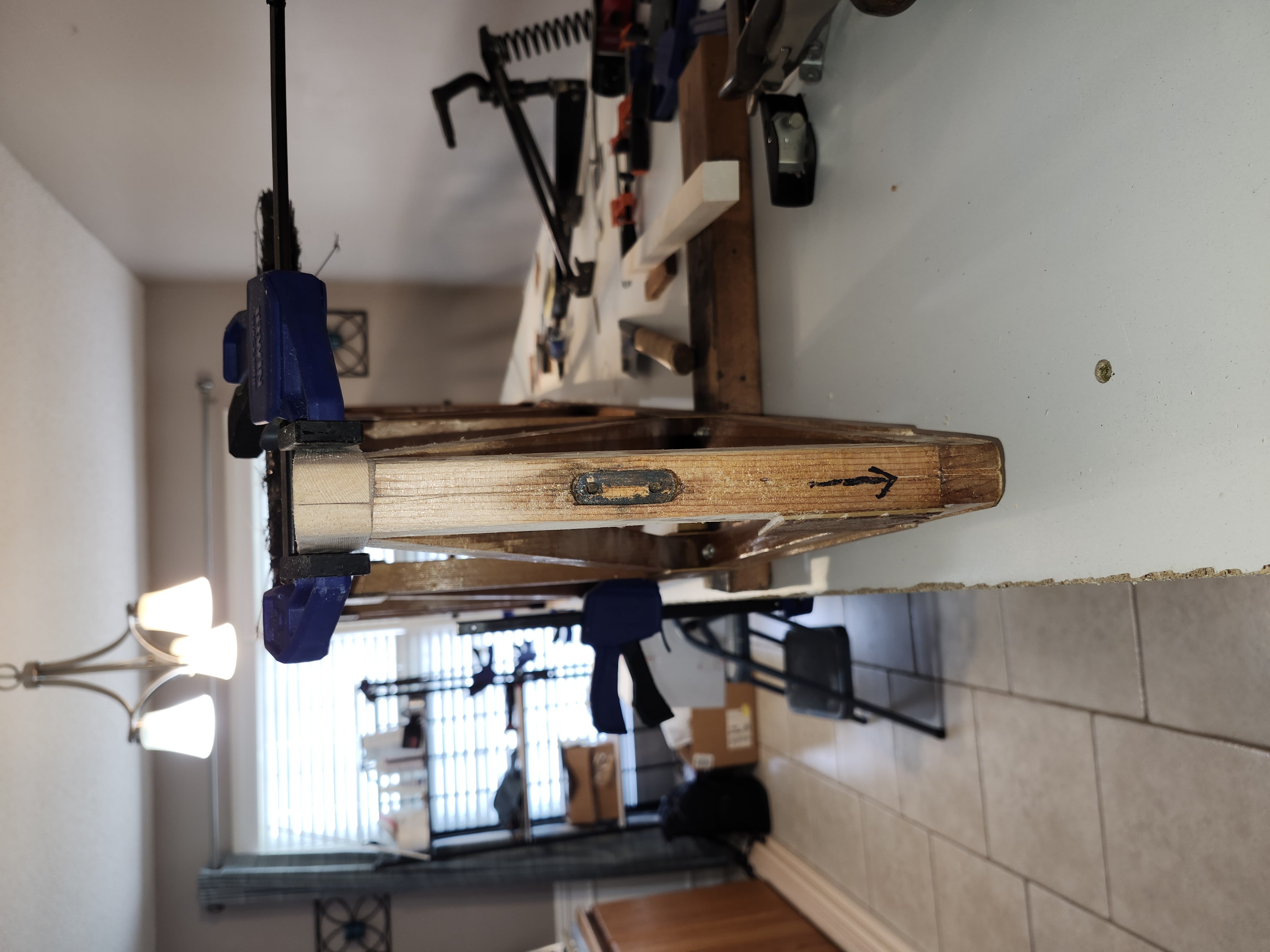

- Posts: 338
- Posts: 338
Re: N34KP's rebuild
I was out at the hanger taking some measurements on the wing. I found something interesting. When Ken built the wing, he did the compression struts in the middle of the wing different. Instead of offsetting the struts with the 1/4" plywood to clear the bottom of the wing fabric, he cut a curve, like the lower center section pieces, flipped the cut out piece over and glued it to the top of the strut.
