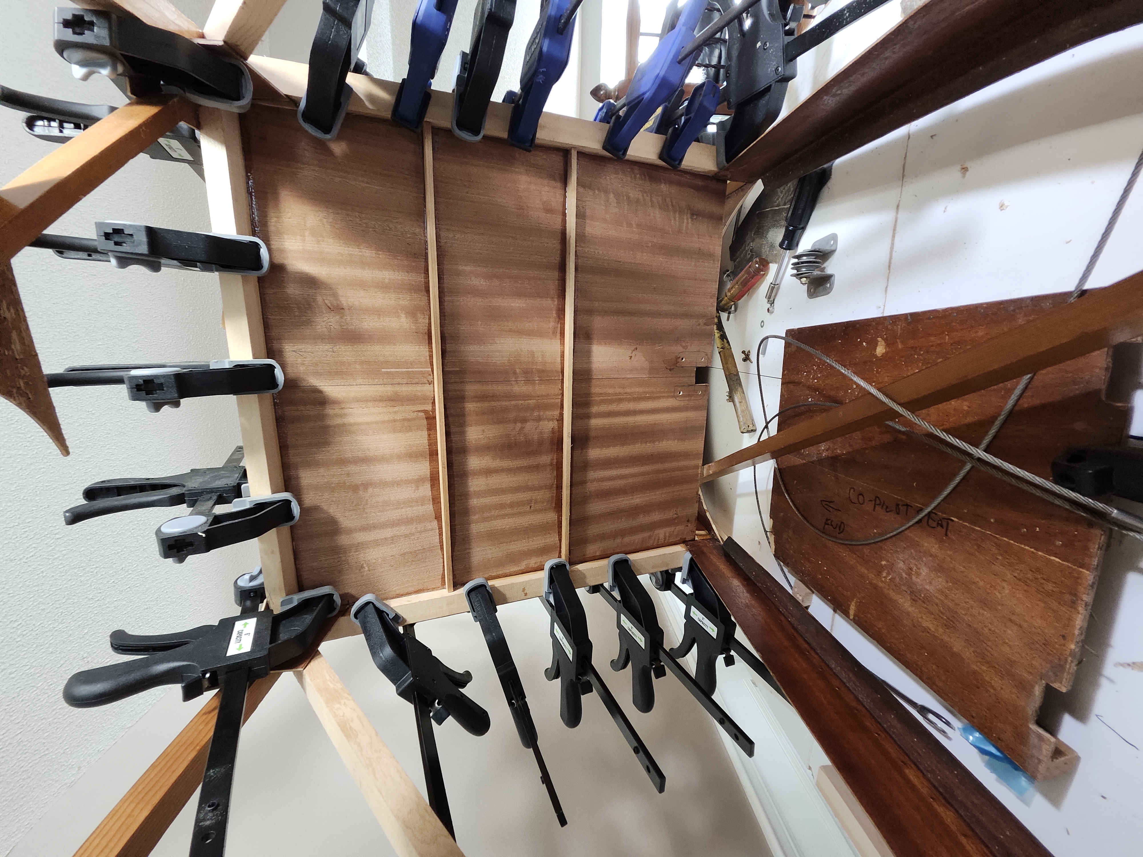

Re: N34KP's rebuild
Center seat support glue up.

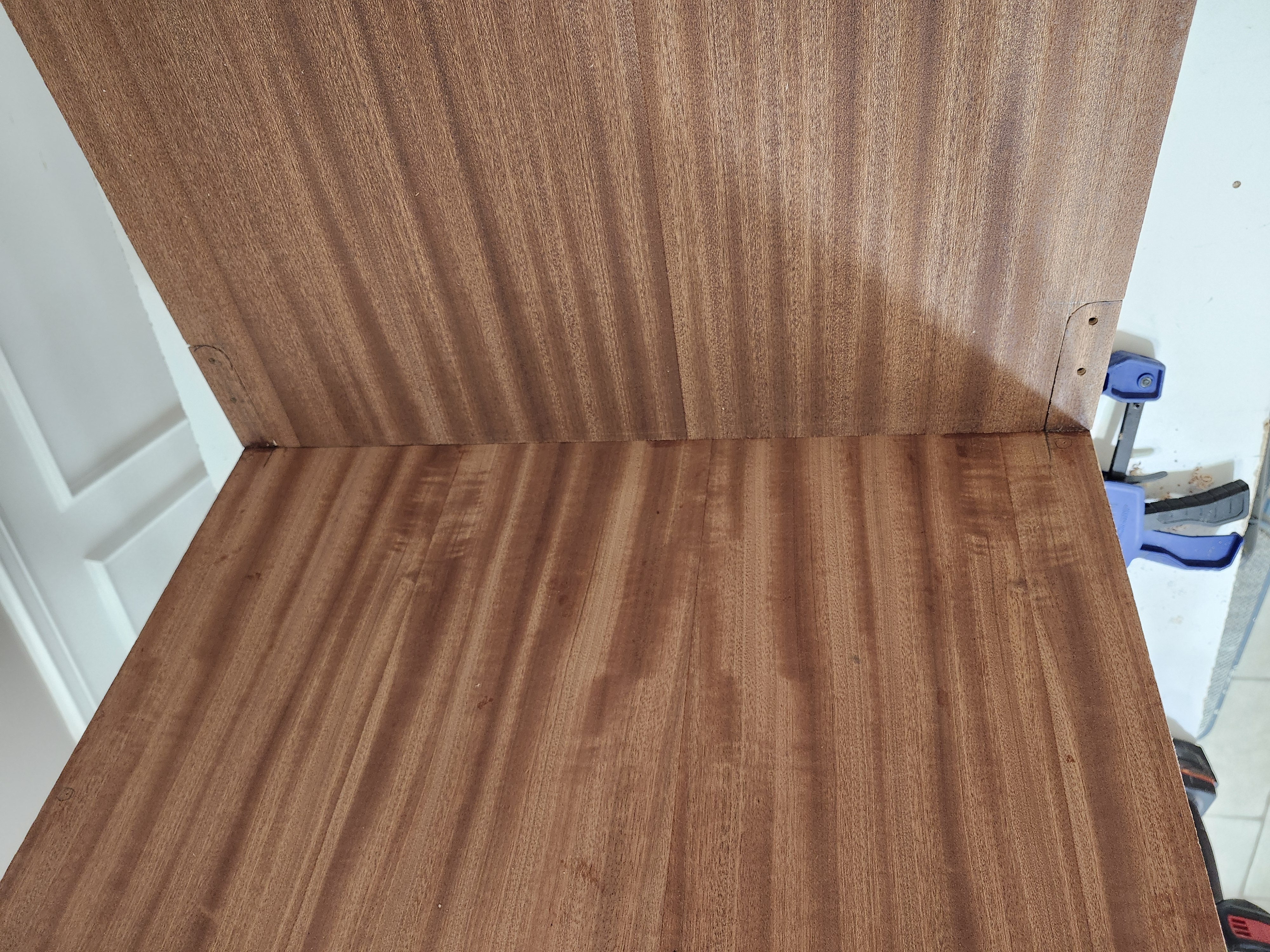

Re: N34KP's rebuild
Trying to get re-motivated on the repair. So, rough cut out and test fit of the rear seat back.

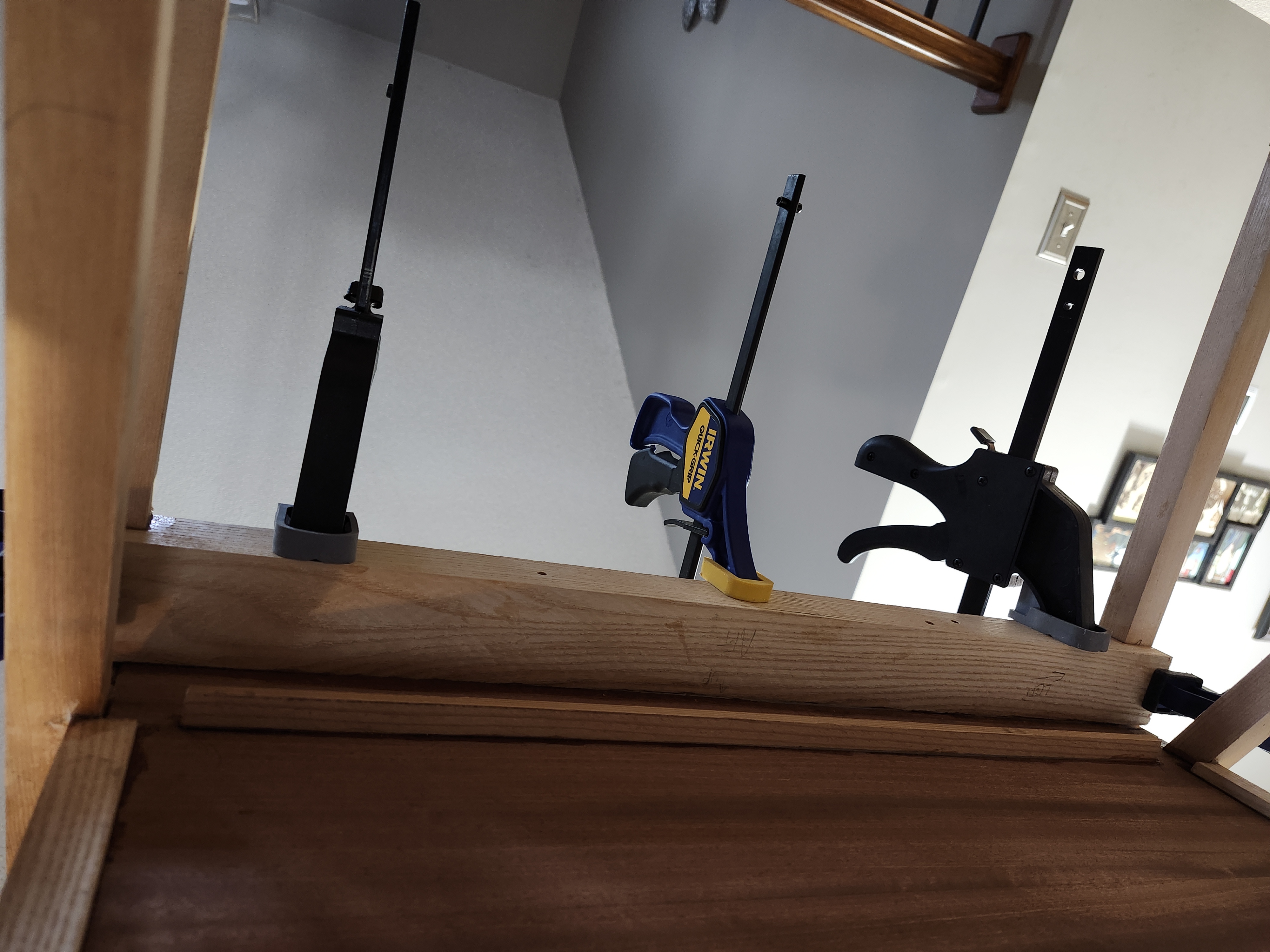

Re: N34KP's rebuild
Gluing in a couple of rear seat supports.

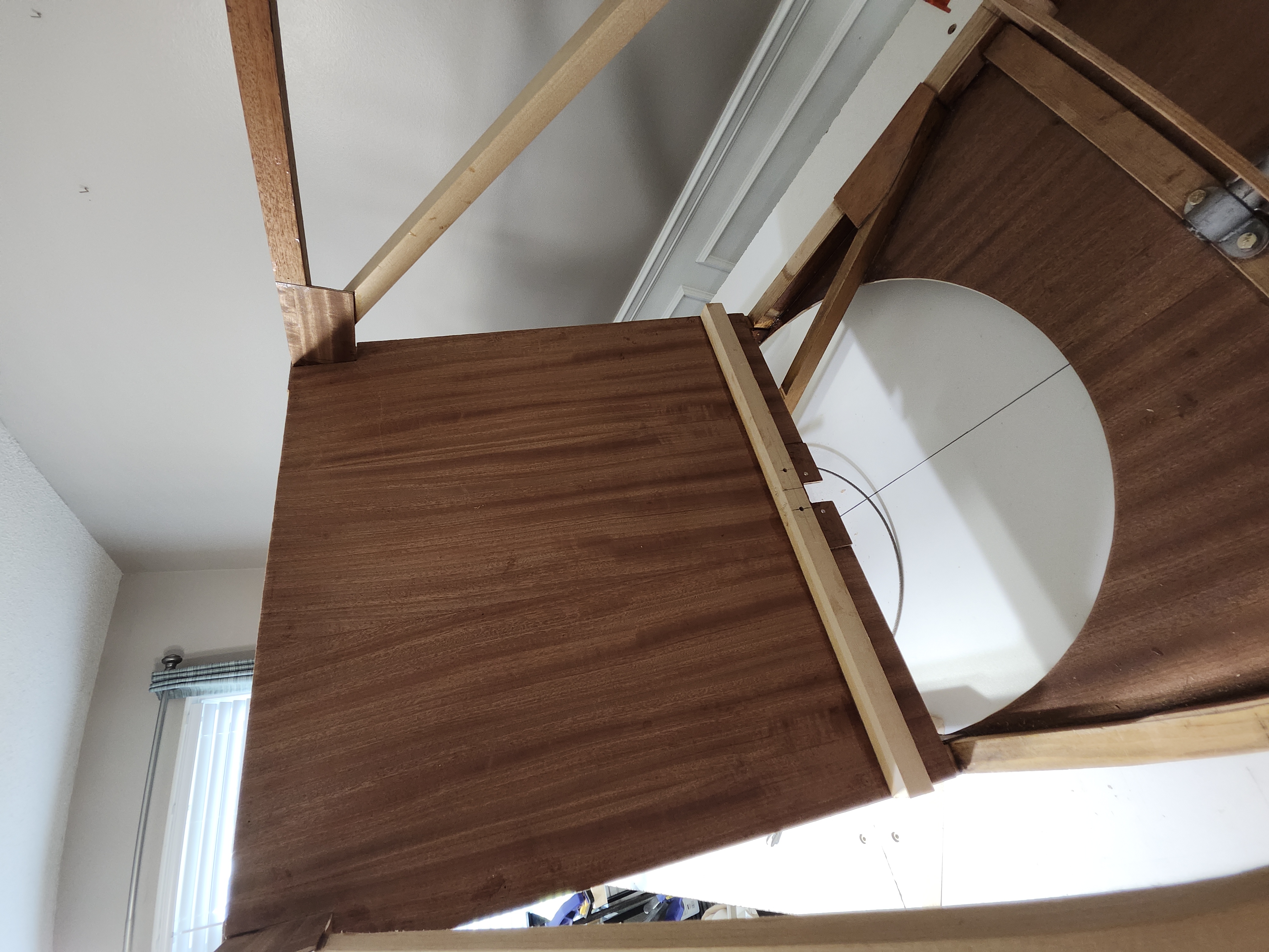

Posts: 370
Re: N34KP's rebuild
So, I decided I wanted the rear seat bottom removable. Measured and measured. Cut out the pieces, glued in the spacers and fit the seat bottom. Looks good. Hmmm. I clamped plywood to the sides. The seat bottom won't clear the diagonals. So rework the seat bottom. Clears now!
